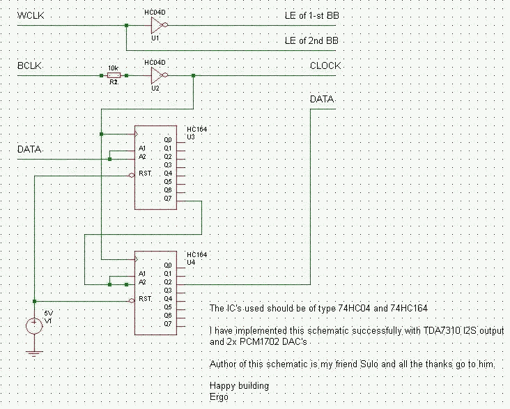

Right at this moment i am trying to connect I2S to two pcm56 dacs.
Want to try and hear this and find out if harmonic distorsion can be lowered (MSB adjust) compared to 1541.
I2S is from SAA7210, clock provided by a P2P version Kwak 7.
Found logic here on diyaudio. I/V is Pedja's AD844 stage.
The problem is i have digital noise and music, have to check glue logic.
Or clock in must be not 2.8mHz (11.28 / 4)
I don't understand why data has to be shifted 11 clockcycles.

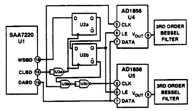

You do realise the circuit is for the PCM1702 ?
This circuit is for 20bit data, PCM56 needs 16bit.
That should work as the SAA7220 can be bypassed for non os.
AD1856 and PCM56 are pincompatibel.

Hi Bernard & rfbrw
Thanks for reply.
Yes i know 1702 is 20 bit, that must be the problem.
Have a copy of the AN207 where you schematic comes from for a long time allready Bernard, found out this works by a "stopped clock" operation. This schematic is intended to use from SAA7220, and clock is then 5.6 MHz, and from 7210 it is 2.8 Mhz. So will use a separate clock with divider to get it working.

When 1541 is connected on 7210 (Nonos) only first 16 bits are readed after WS until 1541's registers are filled to 16 bit, subcode data wil not be used.
I think the AN207 schematic will not work correctly, clock has to be 1.4112Mhz for good operation (0.0441Mhz x 32) WS and LE is now depending/divided on 5.6MHz
It can work correct if pcm56 uses the first 16 bit only as 1541 does.
Have been reading it up rfbrw, indeed those signals are tied together.
From AD's Application Note 207 for operation of AD1856 16 bit dac:
"Bringing latch Enable low after the least significant bit of ANY word latches the previous 16 bits and starts the conversion."
So I2S output of SAA7210 can be used (with subcode data) as long as the timing of LE is at the right moment, after LSB, and with falling edge LE signal for R + L.
I2S has WS signal 1 clock cycle before LSB, falling edge, and 1 clock cycle before LSB for R channel, RISING WS edge.
Simple solution that might work: Keep curent I2S-20 bit PCM logic, tap Data from another Q output on lower 74/164, at the right moment so when LE is just after LSB. Only 1 wire to remove and try them on other Q outputs for both dacs, and listen.
Saa7210->pcm56
Have sound now. DATA R+L is tied on Q6 instead of Q2, this gives the less noisiest output with music. (but still some search noise from cdm on L) One Q output further gives only noise.
Sound of PCM56: very Nonos-like, mids are slightly distorted, think when i listen to it for 2 hours will get fatigued of it (as single 1541 nonos btw) Have to adjust MSB @ -80 dB, but don't think will help much.

Tubee, have you already installed the MSB pot ?
With ( wrong adjustment ) or without ( most PCM56 are very bad in this mode ), sound can be horrible.
Do you have some analog filter ?
Also did you make sure with a scope that your setup is correct.
I have with dithered 1kHz 0 dB no harmonics down to -94 dB which is the dynamic limit of my analyzer.
1kHz -60dB below -60dB which is noise floor without averaging.
No distorted mids 😉
Tubee,
If you are going to connect the PCM56 to the SAA7210 or anything else, why not do it properly ? That circuit is clearly less than optimal for the '1702 nevermind the '56.
