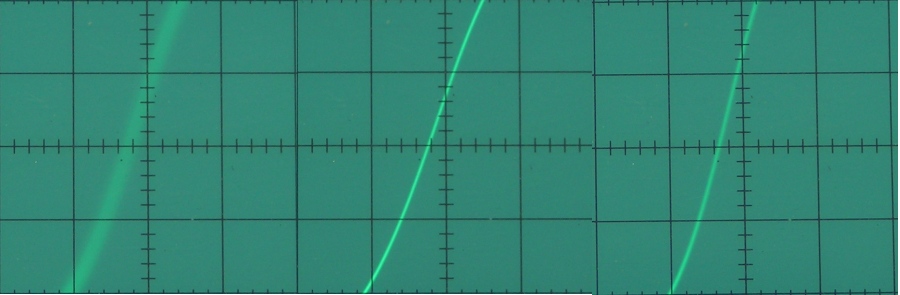

As for the D-I DAC design, the D-I 8 is ready (I/V diff amp module is now modified to accept the LM4562 without adapter socket), the D-I 16 is ready (D-I 16 core is modified to accept 3 X LM4562 without adapter socket). Some delays were introduced by testing and adapting the D-I DACs to the new LM4562 OP-amp, and reducing jitter, but regarding the improvements made, it was worth it.
The added photograph shows what I have been doing lately, the timebase setting equals 5ns/div.
The oscillogram on the left is the BCK output from the PCM2706 chip (USB interface) with extensively filtered power supply and clocked with a low jitter 12 MHz clock, the hazy transient is caused by jitter, lots of it, approx. 1000ps.
The oscillogram in the center shows the optimized shiftregister reclocker output, a razor sharp transient with approx. 10ps jitter, due to the very low jitter, it also appears brighter, that's more like it.
The oscillogram on the right shows a direct I2S output from a Philips transport, when you look closely, it contains more jitter than the shiftregister reclocker output, the transient is a bit hazy and less bright.
I think this was worth investing some extra time, lowering jitter to these extreme low values does wonders to the sound quality of the D-I DACs. Comparing both optimized D-I 8 and D-I 16 with the reference octal D-I DAC with the OPA627 showed how much improvement still could be made.
> It's not a never ending process, the last modifications (LM4562 and reducing jitter) had such a impact on sound quality that I am now finally satisfied with it. If everything goes as planned, all D-I 8 and D-I 16 PCBs will be ordered this month. I will try to add the universal I2S interface PCB too.

Yes the LM4562 sounds much clearer than the OPA627 I used before, it works very well with the D-I system.
Yes, both D-I DACs can be used with ubuntu, I already tested the Rhythmbox Music player and the Banshee Music Player. Both work fine. Make sure you use the FLAC audio format (lossless compression).
The PCM2706, used in the USB/DI2S interface is compatible with both USB1.1 and USB2, maximum sample rate is 48 KHz. No drivers are needed.
Unlike many other USB audio interfaces, the USB/DI2S module's shiftregister reclocker and the low jitter design enable direct I2S performance.

No I don't use PLLs as they still pass the jitter trough to some extent. When the input signal contains a lot of jitter (long interlinks), the PLL can't get a perfect lock and could make matters even worse. A PLL has to lock-in to the received clock signal, and in order to do so, it has to vary it's phase continuously to some extent. That's just what I try to avoid. The PLL circuitry itself also adds phase noise, phase noise is closely related to jitter.
I don't use VCXO (voltage controlled crystal oscillators) because of the very limited locking range. This could cause periodic lock-outs due to tolerances between the clock source and the VCXO causing clicks and pops. The circuitry used to vary the XO clock frequency could also add jitter / phase noise. Another problem is that you will need a separate VCXO for each sample frequency used.
I use either a shiftregister reclocker (combined synchronous digital one-shot + reclocker + specific crystal frequency) or a synchronous reclocker (based on synchronous shiftregisters). A synchronous reclocker can only be used if a master clock is available that runs in sync with the generated digital bitstream (CD transport). SPDIF signals are first converted to I2S (Philips format), then the clock output of the audio receiver is reclocked synchronously (this needs some modding). When there is no master clock available, only a standard SPDIF output, the shiftregister reclocker is used.
Both reclockers have a wide locking range and low jitter / phase noise. They will accept different sampling rates and allow switching between various digital audio sources.
Both reclockers run fully synchronous with the reclock timing source used (master clock from a CD transport or a separate crystal clock). Obtaining and maintaining low jitter is extremely difficult, one single inverter or buffer can increase jitter easily up to 100ps or more. One must tune the design accurately to get a low jitter clock at the DAC chips. Feeding both BCK and data signals to one chip causes crosstalk / phase noise, always use a separate chip for BCK. Same applies for a LSI that outputs both BCK and DATA (direct I2S output from a CD transport), there will be crosstalk. All wires transporting clock / data signals need to be screened.
Once crosstalk is present and the circuitry can't be modified (LSI), the clock signal needs to be synchronously reclocked (with a separate IC).
I also had to tune the clock buffer trigger window and loading to obtain lowest jitter values, then there is the digital power supply. I now filtered the power supply for every single chip separately (short HF paths) in the BCK circuitry. Turned out it's a bad idea to directly connect the VCC / VDD pins together as this dumps the sum of HF energy produced by all chips connected to the digital power supply (long HF paths), decoupling caps won't help much here, even a low noise power supply will be useless now.
