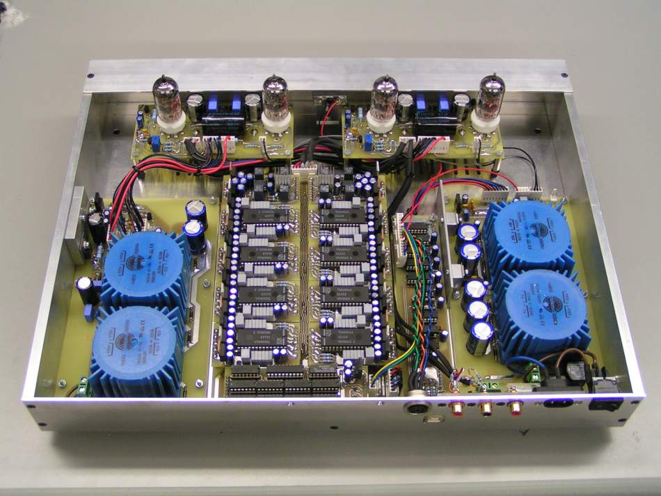

Hi maxlorenz,
Thanks for your compliments [post #1174]
Sorry for not replying quickly to all questions, but as you know, I am working very hard to get the D-I 8 completed.
I made some more pictures of the D-I 8, showing more detail. There are also some new D-I 8 pictures on my website under "kits".
The "format" issue can also be solved solved by using the universal I2S interface. I am already using a similar setup for both my Sony CD changer and satellite receiver. I will give more detailed information about this new module soon. A dual format timing chain won't support the many different formats either, so it's not a optimal solution.

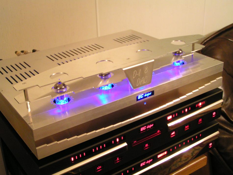

D-I 8 DAC housing photographs
Hi all,
Project update,
Today I completed most of the D-I 8 housing (tube protection grille and top cover). Here is the first photograph. I had to use plenty of ventilation slots to avoid too high temperatures. I fitted heatsinks on the TDA1541A DACs using spring clamps and silver-based heatsink compound, this way the heatsinks can be removed easily if desired.
The tube protection grille is fixed to the top cover, when the top cover is removed, all parts can be easily accessed.

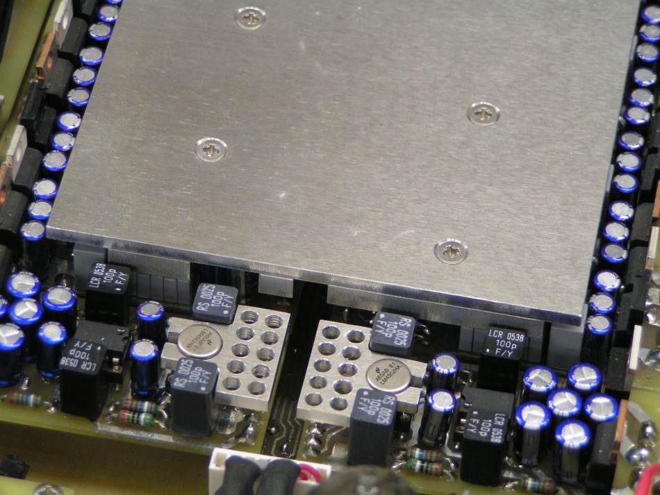

heatsink 1
Hi all,
A picture of the LM4562 heatsink used in the D-I 8, it's milled form 3mm thick aluminum and clamped on the LM4562.
The large heatsink in the back is used to cool the 8 TDA1541A's. About 8...10W of heat is produced here that needs to be dissipated by the large aluminum housing (top and rear cover).

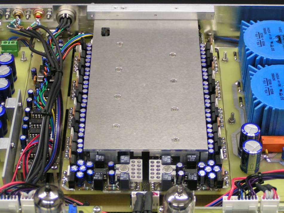

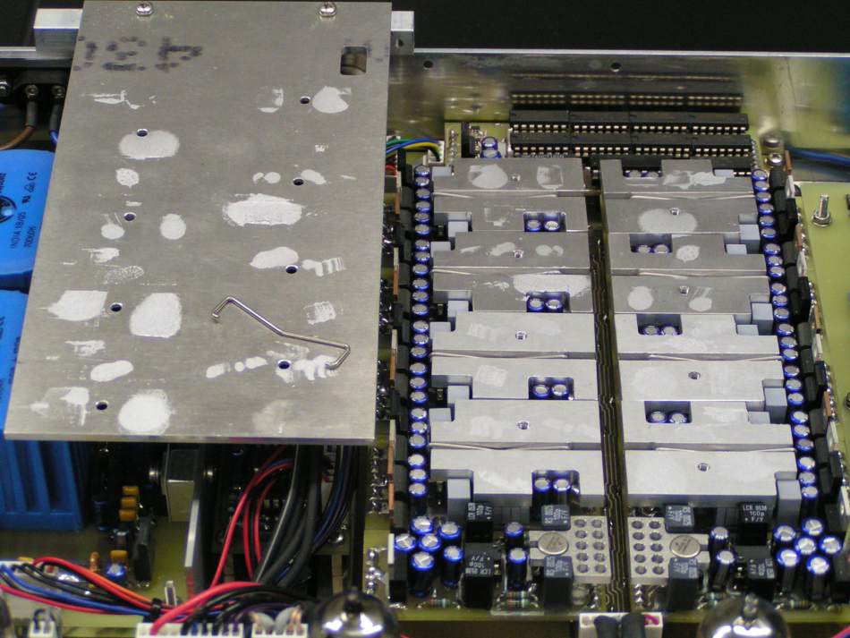

Heatsink 3
Hi all,
A photograph of the disassembled TDA1541A heatsink. There is a separate aluminum block mounted on each TDA1541A module, it's clamped to the chip using a modified sub-D cable clamp. Heatsink compound is used for optimal contact between chip housing and aluminum block.
Next the large aluminum heatsink is mounted on top of these aluminum blocks, again using heatsink compound (I will use more when the heatsinks are annodized). Finally this heatsink is mounted to the rear cover, now the heat from the TDA1541A's can be dissipated on the rear and top cover of the aluminum housing.
This effort results in lower noise / more detail and extended TDA1541A life by keeping temperatures lower. The heat produced is not caused by paralleling nor by DEM reclocking, tests were done using a single TDA1541A, with only 1 I/V stage connected and a 470pF DEM clock oscillator capacitor, heat dissipation was similar.
