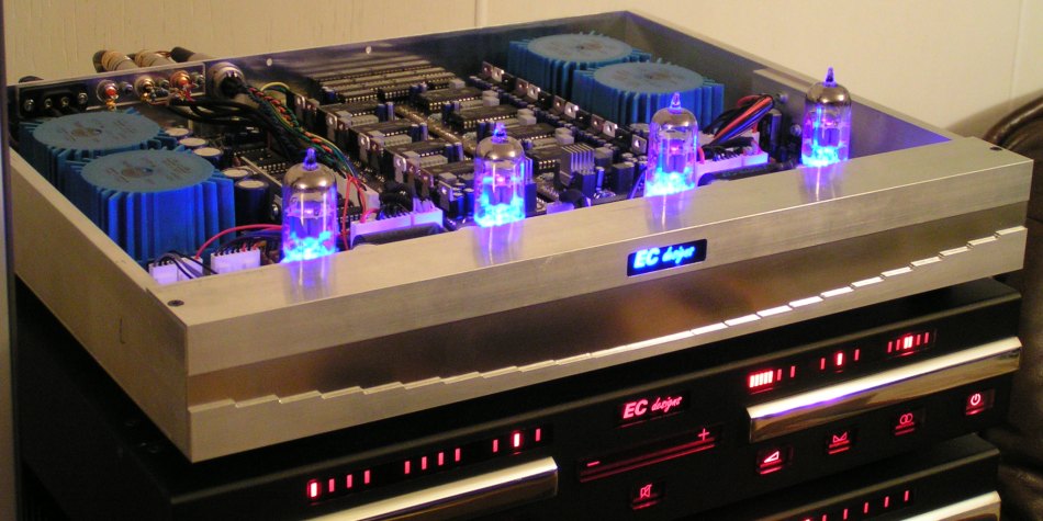

New D-I 8 operational
Hi all,
Project update,
Today I managed to squeeze the entire D-I 8 DAC in a 42 X 5 X 32cm housing! I added a picture of the new D-I 8 DAC, when it was just connected to the large set for testing.
The tube status LED's and logo are blue on this one, but many different colors can be chosen. It uses the same optics for logo lighting. Can't wait to see this one with annodized housing.
I used 25VA torroid transformers as the 15VA ones were not in stock.
Like with the D-I 16, a step pattern is milled in a aluminum profile and a high-gloss stainless steel sheet is used.
The tube protection grid will be something special, I plan designing and milling it tomorrow.
Oh yes, the D-I 8 works fine, and is much easier to assemble than the octal D-I DAC. All PCB's are mounted on the bottom plate. I will make some more detailed pictures tomorrow, showing the new tube PCB's and power supply PCB's. As noted, all power supplies now have skottky diodes to minimize noise. The high-voltage supply uses soft recovery types.
As for the format issue with the CDPRO2, I am already planning to make a SMD based auto-detecting timing-chain PCB that just plugs in the D-I 8, the D-I 16 probably comes in two formats 64 BCK and 48 BCK version. I also plan to buy a CDPRO2 to make absolutely sure it works flawless.
I am also planning to design the new digital interface converter soon, based on the CS8416. This is mainly intended to enable SPDIF sources to be connected the D-I 8 and D-I 16, the interface provides both synchronous reclocking and a shiftregister reclocker for optimal sound quality.
I am still waiting for my LM4562 samples, so I haven't been able to test this OP-amp yet.
