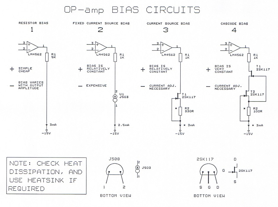

Hi all,
Some replies on comments made:
a333bt [post #1182 #1194]
The bias resistor between the LM4562 and the minus of the power supply will modulate the bias current with the output signal and will pick up noise. I added some circuits that I experimented with, the cascode circuit (2 N-channel FET's and 2 resistors) performs best so far. The 1K series resistor is to reduce the effect of FET capacity
There is room for a fan, but even at low speeds and using the quitest types, the noise of the fan will become annoying. I can even hear the CD player servo noise, thats already annoying.
MGH [post #1197]
Copper conducts heat better, but it's very expensive at the moment and the heatsink needs to have a very even surface. I like the idea of the mesh pattern, but it would also reduce the top cover strength (it needs to support the tube protection grid).
SSassen [post #1198]
The accumulation of dust shouldn't be a problem at all, a DAC like this deserves to be dusted-off, cleaned and the stainless front panel to be polished each weekend. 😀
tubee [post #1199]
The black color should emit heat better to the surrounding air, that's just what I like to avoid when conducting the D-I 8 core heat to the exterior of the housing. So at least the D-I core heatsink will be annodized in a lighter color.
adhoc [post #1200]
Since I am also slightly nitpicky, I will engrave "D-I 8 core" in the heatsink and annodize it with a gold color. 😎

Re: Op-amp class A bias circuits
Here's a suggestion - ground the heatsink. You should be able to figure out what that is for. 😉
-ecdesigns- said:Perhaps this could be a explanation for the exceptional clear sound quality after placement of the large D-I core heatsink.
Hi John, nice class A bias circuits. Have you tried the solution with 2 BC560 transistors and 3 resistors too? How was current stability with it?

Hi tubee,
Thanks for your reply [post #1203 / 1204]
> Yes I tried the current mirror circuit for OP-amp class A bias already, also posted it on this thread, I used a dual PNP transistor from Toshiba (2SA1349). The current stability depends on thermal drift and power supply stability (the current mirror output current matches the input current provided by the 30K resistor, so power supply ripple / noise is also added to the output current).
> No I don't use the Sony player much, after putting the LM4562 in both D-I DACs, it became clear, the iMac (USB) provided the clearest sound with the deepest soundstage. The Sony's direct I2S output seems to be no match for the shiftregister reclocker located close to the D-I core.
> I agree that a (modified) Sony CD changer isn't the best digital sound source, and with the LM4562 errors become audible that are not present when using the iMac as sound source using the same CD image. In other words, the Sony CD changer seems to modify the digital data being read from the CD, before it's output on the I2S.
But even when using the best transports available, read errors can and will occur, forcing the transport to start correcting these. It depends completely on the following circuitry how these errors are handled and if the digital bit-stream remains bit perfect or is altered in some way.
The transport being a opto-mechanical system, will have a limited life-time / wears out. When CD's are gradually being replaced by other media, the CD player will become obsolete sooner or later.
So in my personal opinion the best digital sound source would be a computer, generating exactly the same quality, every time. The data from the HD is buffered in RAM, so even multiple HD read errors or HD read delays will have no effect. It also provides the best platform for future developments.
Basically we only need a low jitter digital bit-stream of one's and zero's, without errors. If this criteria is met, it doesn't matter at all what kind of digital sound source is used.
When using a computer as digital sound source, the sound file can be created using CD paranoia (multiple reads to minimize read errors), or lossless CD tracks (not MP3) can be directly downloaded from the internet (in the future). The file is then stored on a hard-disk and is now fixed, it's integrity will be monitored by the operating system. So no matter if you play this file one time or 100 times, it will remain exactly the same. This is virtually impossible using even the best transport.
The many CD's that can be stored on a hard-disk using lossless compression, also means you have all this music available instantaneously, and can toggle between CD's / tracks within seconds, or create a play list. What's the use of a large CD collection if you can't quickly locate the CD / track you are looking for? The swapping of CD's in a single CD transport also increases the chance of damaging / scratching the CD surface.
When using lossless compression, the file size is approx. half of the original size. Suppose an average CD contains approx. 400Mb of data, this will result in approx. 200Mb / CD. Today HD capacity is rapidly increasing, let's take an average 250Gb hard-disk, this will hold approx. 1000 CD's in lossless format on a single 250Gb hard-disk. That's a lot of CD's! if this is still not enough, one could use a 500Gb drive storing over 2000 CD's!
There are some nice graphical interfaces available for browsing through a CD collection like coverflow. So it's very easy to find your favorite track quickly. This is a very big advantage that's impossible when using single CD's in a transport. The computer can be connected directly to both the D-I 8 and D-I 16 DAC without interface problems, just plug and play.

Hi ak_47_boy
Thanks for your reply [post #1202]
1) Both D-I 8 and D-I 16 will have some minor changes, the PCB's will be modified to accept the LM4562 dual OP-amp instead of the OPA627 single OP-amp, and the D-I 16 power supply filtering will be improved.
2) I am planning to provide the PCB's first quarter of 2007. As noted earlier they will have (thick) flash gold plated traces, a transparent anti-solder mask and black silkscreen print.
3) The D-I DAC should have a control amplifier / buffer placed after it (volume / balance control), with unity gain and a input resistance of approx. 20...100K Ohms. RCA interlink between DAC and control amplifier should be kept as short as possible.
