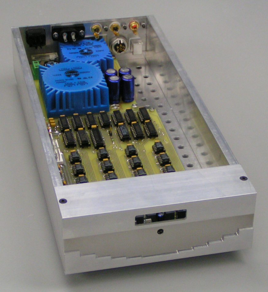

Hi all,
Another photograph of the housing,
The holes at the right are for cooling, the top front panel consists of a milled aluminum profile that's also used for the logo. The high-gloss stainless sheet in the center holds the indication LED, the bottom front panel consists of a milled aluminum profile. A step pattern, similar to the octal D-I DAC tube protection grid is used here.
The top cover will have ventilation slots similar to the octal D-I DAC, this is necessary for optimal cooling of the transformers and the 16 TDA1543's.
Also visible now is the space reserved for the new USB interface (at the right).
The D-I 16 housing measures 32.5 X 15 X 5.4 cm.
The aluminum parts can be annodized in different colors.
Next is designing and manufacturing the new octal D-I DAC housing, it will basically have a similar construction as the D-I 16 DAC housing, but it will be about 43cm wide instead of 15cm.

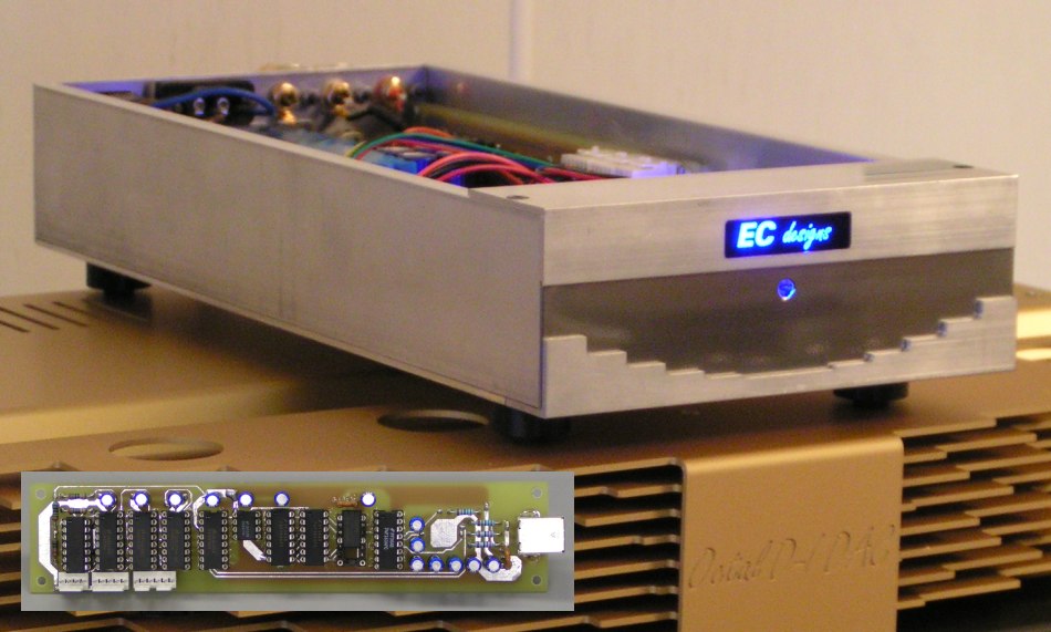

Hi all,
Project update,
The new USB / DI2S module has been completed, it's already mounted into the D-I 16 DAC. There is just enough room for all modules, but I have to route the cables so they don't (partially) block the ventilation holes.
I added a picture of the D-I 16 DAC in action, and a picture of the new USB / DI2S PCB. I experimented with different logo backlighting, I ended up with milling a plexiglass part that distributes the light from 2 LED's, I choose blue LED's, this would combine very well with a gold coloured housing.
As for the D-I 16 sound quality, testing it on the large set in the living room revealed the true potential of this DAC, I listened until deep in the night, very impressed by it's performance. It seems the D-I 16 provides a slightly brighter sound, and the midrange sounds slightly warmer than the octal D-I DAC. Due to the OPA627 I/V stage, distortion is very low. The 16 TDA1543's ran for many hours without cooling, seems to be no problem at all.
The new USB / I2S module works fine, so it can be used in the octal D-I DAC as well, next week I am planning to complete the new octal D-I DAC PCB design, and maybe do some work on the new octal D-I DAC housing.

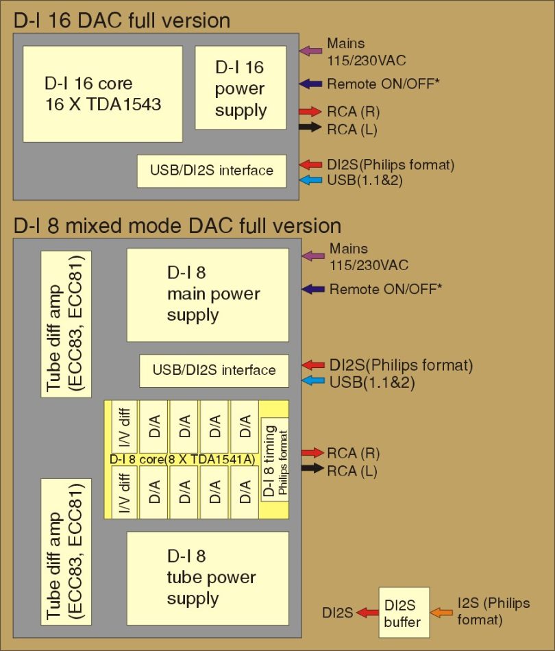

Hi all,
D-I DAC CONFIGURATIONS
I have added a block diagram of the final D-I DAC configurations. The PCB modules are in yellow. So for a D-I 16 DAC full version, only 3 PCB modules are needed.
For a D-I 8 mixed mode DAC full version, 17 PCB modules are needed.
Next there are several different configurations possible, as these D-I DAC's are fully modular:
1) D-I 16 minimum configuration, D-I 16 core + D-I 16 power supply, these can be placed in the transport housing. The D-I 16 core receives the I2S signal directly from the transport, like a CDPRO2 (Philips format).
2) D-I 16 mixed mode DAC full version, now the D-I 8 core is simply replaced by the D-I 16 core, only 6 PCB modules are needed.
3) D-I 8 DAC, the tube output stages are removed, now 14 PCB modules are necessary.
I/O
Mains input, Both D-I DAC's have a setting for both 115 or 230VAC.
Digital inputs, the D-I cores have a I2S input (Philips format), the USB/DI2S adds both a USB input and a differential / balanced I2S input. A separate DI2S buffer PCB module can be used to convert a existing I2S output to a DI2S signal needed for the D-I DAC's.
The universal digital audio interface PCB module can be used to connect SPDIF sources (coax or Toslink), while providing I2S performance using the integrated shiftregister reclocker, or fully synchronous reclocker using a external master clock form the transport. This module outputs the required DI2S Philips format.
Remote ON/OFF, this is a optional input (12V) that can be used to switch-ON/OFF the D-I DAC's with a external device like a control amplifier.
Audio outputs, the D-I DAC internal design is fully balanced, however the external audio outputs are RCA single-ended connections, so they can be connected to all regular audio equipment.
PROJECT PROGRESS
All PCB's have been redesigned/optimized, PCB dimensions are reduced, however some PCB's have to be manufactured and tested before a batch of PCB's can be ordered. This causes delays, but is necessary to avoid errors.
D-I 8 DAC PCB modules will now fit in the new housing.
SOME MORE CHANGES
The D-I design has been optimized even further, all power supplies will have 100V Skottky diodes 11DQ10 (IR) for low voltages and BYV96E (1000V) for high voltages, this will reduce switching noise.
D-I 8 main power supply has been simplified significantly, and has now the same size as the tube power supply
Tube output stage board dimensions are minimized, tubes are now located on the component side.
D-I core audio connector has 2 extra GND connections for easy wiring.
D-I 8 vs D-I 16
What D-I DAC sounds better? the D-I 8 or the D-I 16. The difference in perceived sound quality is marginal, both DAC's will provide exceptional sound quality.
The mixed mode version of either D-I 8 or D-I 16 will give a slightly warmer, more transparent sound. Is it worth adding a tube output stage and tube power supply? yes, if you like the most natural, harmonically balanced sound, this is certainly worth it.
When comparing the D-I 8 and the D-I 16 with the OP-amp output only, the TDA1541A gives a slightly cleaner sound due to the lower distortion, so the D-I 8 could be preferred, even if it has less resolution. But the D-I 16 comes very close, and is preferred if the budget is limited, or a more simple (compact) design is desired.
If you only want the very best, the D-I 8 with mixed mode output and TDA1541A double crowns could be considered.
Another interesting option is using the D-I 16 core in the large housing with the mixed mode output.

D-I 8 vs D-I 16
Hi John
Just a small question. In configuration 1 you say the D-I core receives the I2S from the transport. Some sentences later you say "A separate DI2S buffer PCB module can be used to convert a existing I2S output to a DI2S signal needed for the D-I DAC's". What is the input for the D-I Dac's? I ask because I already have a PCB for USB to I2S conversion, but if the DAC's need DI2S I will have to buy one of your USB -> DI2S boards too.
Many thanks
Erik
Many thanks
Erik
I2S vs DI2S
Hi ErikdeBest,
Thanks for your reply [post #1152]
Well it's quite easy, the input of the D-I DAC core is (single-ended) I2S, the input of the D-I DAC full versions is always differential / balanced I2S. The differential / balanced I2S is necessary when longer I2S interlinks (0.5...3m) are needed like with a external DAC.
The described configuration 1 is intended for placing the DAC close to / in the same housing as the transport, then single-ended I2S will work fine. Some sentences later I referred to the full D-I DAC's that have the integrated DI2S/USB module, in this application (external DAC) the DI2S interface has to be used, so a buffer is needed to convert the transport's single-ended I2S to the required DI2S for the external D-I DAC.
Hi ErikdeBest,
Hi John
Thanks for the explanation. I looked again at the block diagram and now I understand it! It is actually quite clear, probably I was half asleep yesterday.
Although you probably will be working, I wish you a nice weekend!
Erik
Erik
