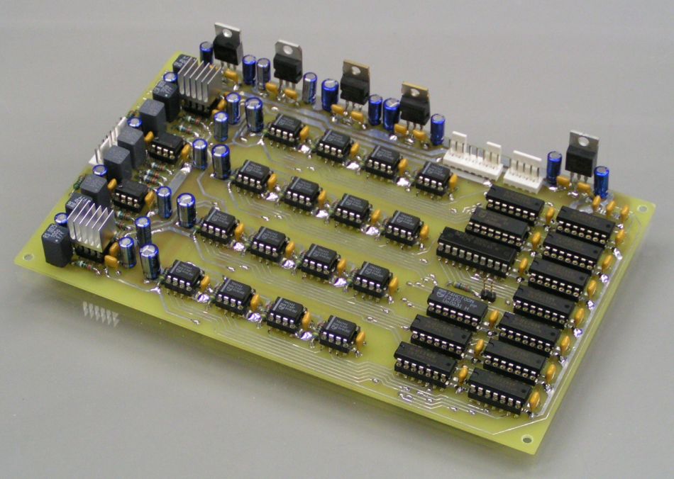

D-I 16 core up and running
Hi all,
An important project update, the D-I 16 core is up and running.
I added a photograph of the new D-I 16 core PCB, it's a complete D-I DAC with timing-chain, UHS buffers, 4 X 4 DAC matrix, balanced I/V converters, diff amp's, output attenuator and power supply regulators. All that's necessary to get it up and running is a small power supply (+20V, -20V, +10V), and a I2S signal.
Today I manufactured the D-I 16 core PCB and assembled it, during testing it appeared to be a zero defect design. Everything worked flawlessly the first time I switchted it on. The PCB dimensions are 11.6 X 18.9 X 2.5 cm. As for the D-I 16 core sound quality, during a 1 hour listening test, it baffled me, now it's very difficult to hear a difference with the octal D-I DAC core using the TDA1541A. I guess it's the extensive decoupling, short traces and UHS buffers that made the D-I 16 catch-up with the octal D-I DAC, and there is the higher resolution enhancement of course.
This D-I DAC is not difficult to build, just a single PCB and only 3 SMD components. It took me about one hour to assemble, and I even had to solder all components on both sides and add 84 via's. The professional PCB's only need to be soldered on one side and is much easier to assemble. The small dimensions also make it ideal for upgrading a CD player.
The D-I 16 core is a cool runner, even the 2 voltage regulators that drive the DAC matrix will run without heatsink. The DAC chips stay cool as well, it only takes about 7 watts! OP-amps included. It ran for over an hour without any cooling.

Hi EC et all,
Sorry for not posted any pictures of my SMD logic tower of EC's timing chain http://www.diyaudio.com/forums/showthread.php?postid=915913. My wife is out of town with the camera until Tuesday.
I have lots of experience with NOS TDA1543 DAC with a single chip. I have 7 that I tweak, different power transformers, by-pass caps, break-in time are the tweaks/changes I make as try to come up with the best implementation.
Lately I went back to the start of this thread and it all made sense and so I ordered parts and started modifying my second favorite DAC. Keeping my favorite as a reference.
I built the timing chain using SMD parts into a tower which is the same height as a tower of 8 TDA1543. I only had enough TDA1543 chips on hand for a quad version, more chips should arrive next week.
I had to order parts for tower but in the mean while I paralleled the 4 TDA1543 chips, changed the IV resistors and soon noticed an nice increase in resolution over a single TDA1543 (odd that it took me so long to try the paralleling TDA1543) And within days this parallel DAC (which prior to being parallel was not my favorite because of smaller power transformers) became my favorite DAC.
Parts from digikey.ca arrive to build the logic tower and a week goes by while I build it:

Hi EC et all,

I place the logic tower which includes buffers/drivers beside the quad TDA1543 tower. Cut WS and Data pins on the DAC tower, buffer/drive the Clock line to the TDA tower and Data and WS part of the logic tower. Attach the logic tower to the DAC tower using the appropriate DATA and WS taps from the logic tower. Power it up and it works. It sounds good. Pull out the old 10MHz scope and look at some 1KHz and up test signals and they look lovely, like no singe NOS TDA1543 ever could.
Over the next 24 hours of listening and A/B between this quad DI DAC and my previous favorite single TDA1543 DAC it becomes clear that the parallel DAC sounded better then the DI DAC. The single TDA1543 becomes the preferred DAC to listen to once again.
The DI DAC sounds jittery or time smeared (same thing no?).
I pulled out the old scope and looked at DATA and WS pins on the DAC chips and also compared to the single chip DAC. To me it all looks fine but is also the first time I have ever looked at WS or DATA signals before. There were differences, for example any signal that was buffered by the tower had higher amplitude then non buffered, for example the bottom DAC chip in the tower was still directly connected to the I2S lines, except the Clock pin.
Tonight I removed the logic tower except buffering the Clock signal and the quad parallel DAC is once again the winner over my single TDA1543 DAC.
Maybe there is a problem with my implementation of the timing chain. With no picture, I know it is hard to tell. I kept the wires short. They are only 2 CM long between the DAC tower and the logic tower. All unused logic pins are soldered to ground. The WS and DATA taps that are waiting to complete the octal DAC are not connected but sticking out in the free air. 2 CM long.
Could it be like Bernard suggests that a DI DAC is more susceptible to jitter then a single TDA1543. To me it makes sense since a single clock cycle is being subdivided into smaller segments and so it would requires a more accurate clock then a non DI DAC to work properly. EC I often wondered why you were going on so much about reclocking the USB I2S signal. To me and my non DI DACs there is no jitter problem that I can hear.
EC would you mind sharing/posting your reclocking circuit so that I may build and try it as well?
Any thoughts/questions anyone?
Anyone with some TDA1543 to sell please message me 🙂
Brent
Hi Brent Welke,
Thanks for your reply [post#1119],
Seems something isn't working correctly as the D-I DAC's I build don't have this problem at all, besides I had two diyAudio members come over and listen to both the TDA1541A and the TDA1543 D-I DAC's, sure they must have noticed something if the output signal was showing the problems you described. But I have to admit I use at least 8 DAC chip's in D-I mode. You could also check the following:
DAC1 receives BCK, WS and DATA
DAC2 receives BCK(inverted)!, WS32, DATA32
DAC3 receives BCK(inverted)!, WS16, DATA16
DAC4 receives BCK(inverted)!, WS48, DATA48
The BCK clock signal for both the timing-chain and the DAC chips must be buffered to keep jitter low. Use the following buffer scheme:
BCK > buffer > timing-chain (not jitter sensitive)
BCK > buffer > DAC1 (jitter sensitive)
BCK > inverting buffer > DAC2,3,4...n (jitter sensitive)
So use buffered BCK signals exclusively.
The 4 parallelled TDA1543's using passive I/V may exeed 25mV AC compliance by far, causing significant distortion, the 25mV AC compliance will always be a big problem using passive I/V's. Don't forget the output current is 4 times higher than your single TDA1543 DAC. You could run a simple test, just parallell the 4 DAC's and supply BCK, DATA and WS to them all (no timing-chain), if the sound doesn't improve, the problem is in the passive output stage.
As for jitter sensitivity, the D-I DAC's are comparable to NOS DAC's as no oversampling is used. I payed so much attention to jitter because as the sound quality keeps improving, the digital sound source (jitter) will become a limiting factor. Sure, like with all DAC's, lower jitter improves sound quality.
If you like I can post part of the D-I 16 output stage.
John
