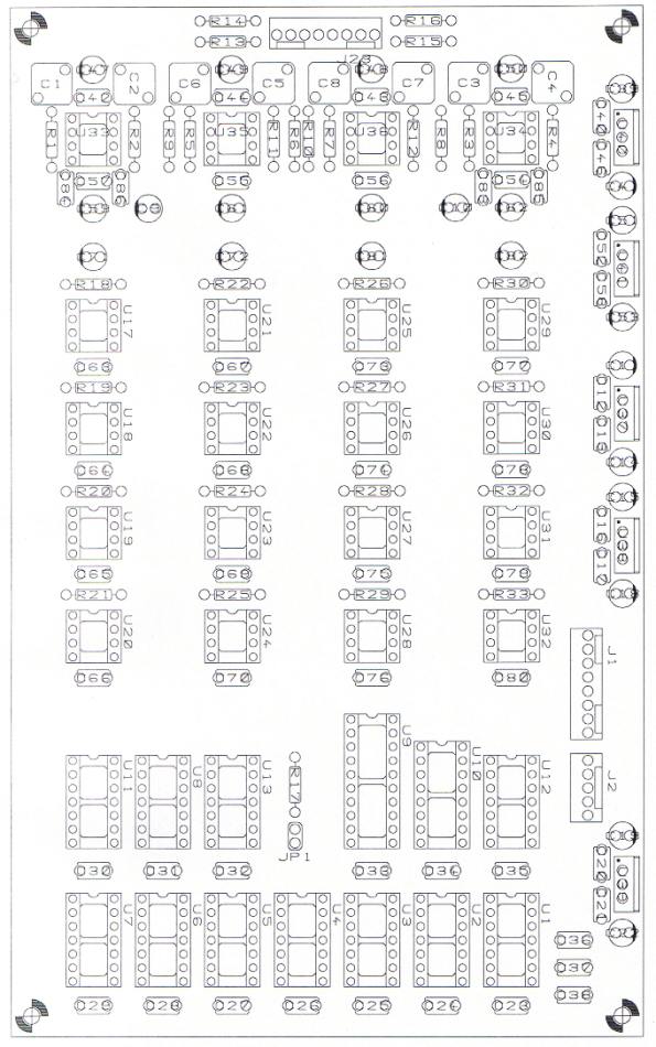

TDA1543 D-I 16 core almost completed
Hi Brent Welke,
Thanks for your reply [post#1090],
I guess you are one of the few people who decided to build a D-I setup, good job! I am very curious about the results. If you use passive I/V and a OPA627 buffer, make sure NOT to invert D32, D40, D48 and D56, just connect all data lines directly to the appropriate timing-chain outputs. There is not much that can go wrong with logic chip's, just make sure the power supplies are connected correctly (polarity) and the voltages stay within specifications.
Since you mentioned the TDA1543 based D-I DAC, I have been developing the small single board D-I 16 core using 16 X TDA1543 and the new timing-chain. The PCB includes power supply regulators, D-I 16 timing-chain, UHS buffers, 16 X TDA1543 in a 4 X 4 matrix, I/V converters (AD843AR) and diff amps (OPA627), all this circuitry is squeezed on a 18.8 X 11.6 cm PCB. In fact this single DAC board is pin compatible with the larger octal D-I DAC core, and can replace the octal D-I DAC core if desired. It uses very little power (approx. 7 watts) and has a unbelievable performance, that comes very close to the octal D-I DAC core. Like the octal D-I DAC core it has a I2S input. It has a Virtual sample rate of 705.6 KHz, theoretical 20 bits and 256X resolution enhancement.
Because it's pin compatible with the octal D-I DAC core, it can be used just the same (with tube output, I2S selector and USB interface).
I added a silkscreen plot of the D-I 16 core, at the bottom is the timing-chain for 16 DAC chips and the UHS buffers. At the right, the 5 power supply stabilizers, in the center, the 4 X 4 TDA1543A matrix. The large space around the TDA1543's has two functions: spreading the dissipated heat more evenly and reducing crosstalk to a minimum. At the top are the OP-amp I/V converters and diff amps. Even the output attenuator (bypassable) is integrated. All chip's are placed on sockets for easy replacement / testing. Jumper JP1 toggles between single ended and balanced mode, so it's possible to use different types of output stages.
PCB routing is completed, but I still need to optimize traces, this might take a few more days as the PCB has to be routed manually.
As for the D-I 16 core power supply, it's a very small PCB with 2 encapsulated torroid transformers (7 watts and 12 watts). The following voltages are needed: +10V, +20V and -20V.
> The new timing-chain was developed to significantly reduce the amount of logic chips needed, this required the use of a PLD (PALCE16V8). It uses Philips format exclusively. Each application requires a slightly different setup, it depends upon the amount of DAC chips used in D-I mode and if a DEM sync clock is needed or not. For example the D-I 16 core needs no DEM sync clock, but needs addittional output signals.
John

A glance at the D-I 16 core PCB design
Hi maxlorenz,
Thanks for the compliments [post #1093]
Before ordering huge amounts of TDA1543's, maybe it's wise to build the standard D-I 16 core first, then just listen to it. If you're not fully satisfied with the sound quality, then you might consider adding more DAC chip's or start modding.
The LM4562 looks very promising, most of the specifications seem to be similar to the OPA627. But the LM4562 is a dual op-amp and has a reasonable price, it's particulary suited for the I/V converter as the adapter socket (2 X SMD OPA627 > DIP8) is no longer needed. Seems this is the part I have been waiting for.
Then about the new TDA1543 D-I 16 DAC, I just completed optimizing the PCB design (I added a picture). The CAD program runs on a ancient operating system called DOS, anyway it has functioned flawlessly for over 19 years now. The layout shown is completely manually routed, trace by trace.
John
