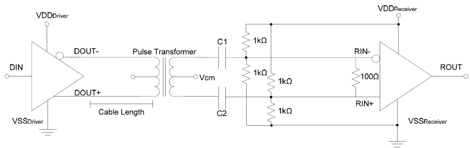

An option is to Gigabit LAN transformers to isolate clocks (use isolated LVDS) but it is not applicable to the data lines.

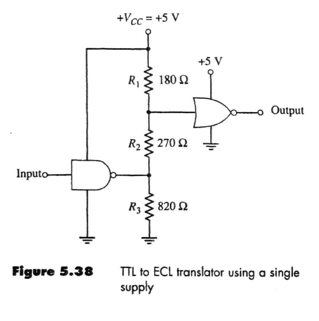

Contemporary types are from the MC100EP series as @ThorstenL noted with other types. This series has single F-F packages, also Differential in-out types also single, that can be advantage for decoupling power supply separatly in each different F per Flip-Flop...
Classic representative from contemporary MC ECL series is single F-F MC100LVEL31

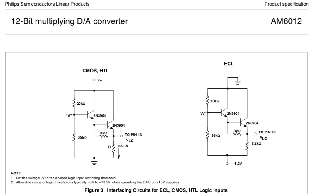

Also I found some diskrete translators from Philips aplication note and other sources that can be illustrative.
So basicaly we have 2 concepts of digital input management.
One with single ended input-outputs classic digital ICs
and other with SE to differential ECL translators following diff. F-F for recklocking.
I must said that even for short distances 5-10cm of differentiial Digital input signals, the sound was somehow better?
I dont know why maybe because zero crossing point relative?
(I used and listen with AM26LS31 / 32 4 x receiver - driver ICs. Not more than 10cm conn. with less termination "force" I think that was 1K load at termination diff. line... I was measuring with scope and this vaue if i can remeber was better than standard low value).
So I would do:
Digital isolation - diff level translator - 2 x diff. F-F recklocking - attenaution to the inputs
I will draw some schs...

Using LVDS with Isolation for the MCK is possible:
Ideally a LVDS receiver directly to PECL, I guess...
But then again we have the issue with a lack of phase-link and needing to get the jittery BCK and DATA into the correct window.

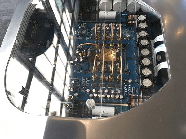

This Photo shows the MCK distribution to the 8 DAC IC's:
