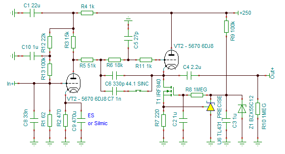

Interesting.Folks,

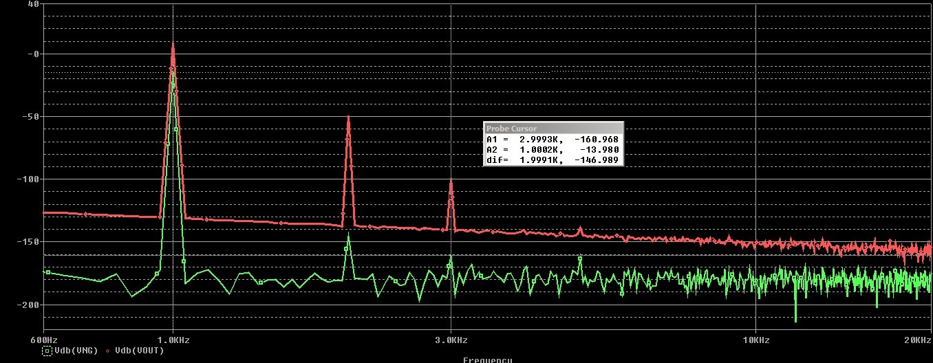

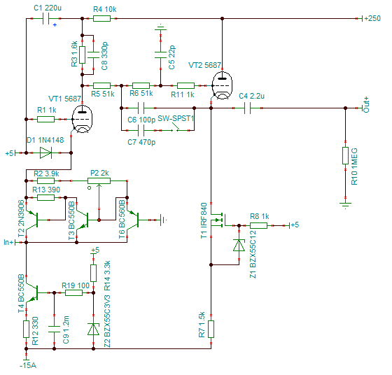

Elsewhere there is an off line discussion on TDA1541 Tube outputs. I quickly threw something into the Simulator. It's based on my experience with many tube based products, but untested and I will not build it myself:
The low gain of the 5670 or 6DJ8 (et al - these two and their variants are very similar electrically, very different pinout) means a bypassed cathode resistor and 62R I/U conversion with offset correction is needed to get 2V @ 0dBFS.
After the gain stage there is a sallen key filter and output buffer.
Optionally (close switch) there is a 3.2dB boost at 22.05kHz in the filter, to equalise the "SINC" (sic) rolloff of the DAC operating at 44.1kHz sample rate.
This filter will also "unfold" (in MQA-Speak) the hidden ultrasonic content encoded in the recording, with a final 3rd roll-off after the peak.
The CCS is feedback type for DC using TL431, but "open loop" for AC. So operating conditions are stable regardless of temperature etc. but the circuit does not rely on looped feedback for AC (> 1.6Hz). The 12V zener diode is turn on protection.

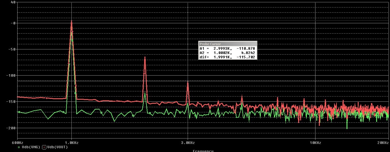

Performance? Well typically "ideal tube", ~0.1% HD at 0dBFS with almost pure H2. That is just the right amount of H2...
Katz's Corner Episode 25: Adventures in Distortion
Noise looks somewhere around -100dB.
I don't see a point of messing with tubes if you find this unacceptable, just an op-amp if you want really low distortion. The OP2156 would be my take, as Op-Amp I/U converter, plus sallen key filter similar to what is shown here.

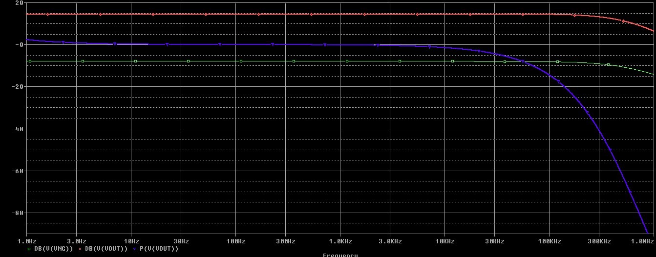

Just recently I take advantage from the feeding the signal to the cathode (low impedance), and put a passive CLC filter to make the low pass filtering, show as active here in this option.
The low impedance of both sides using cathode as the buffer input permits a relatively low impedance CLC.
The good of passive filtering is that it supports a lot of rise time from the DAC, if it wants hehe
Good also if the DAC have a lot or HF gargabe.
The bad, is the mains noise signal picking.
The THD with 2V.... interesting....

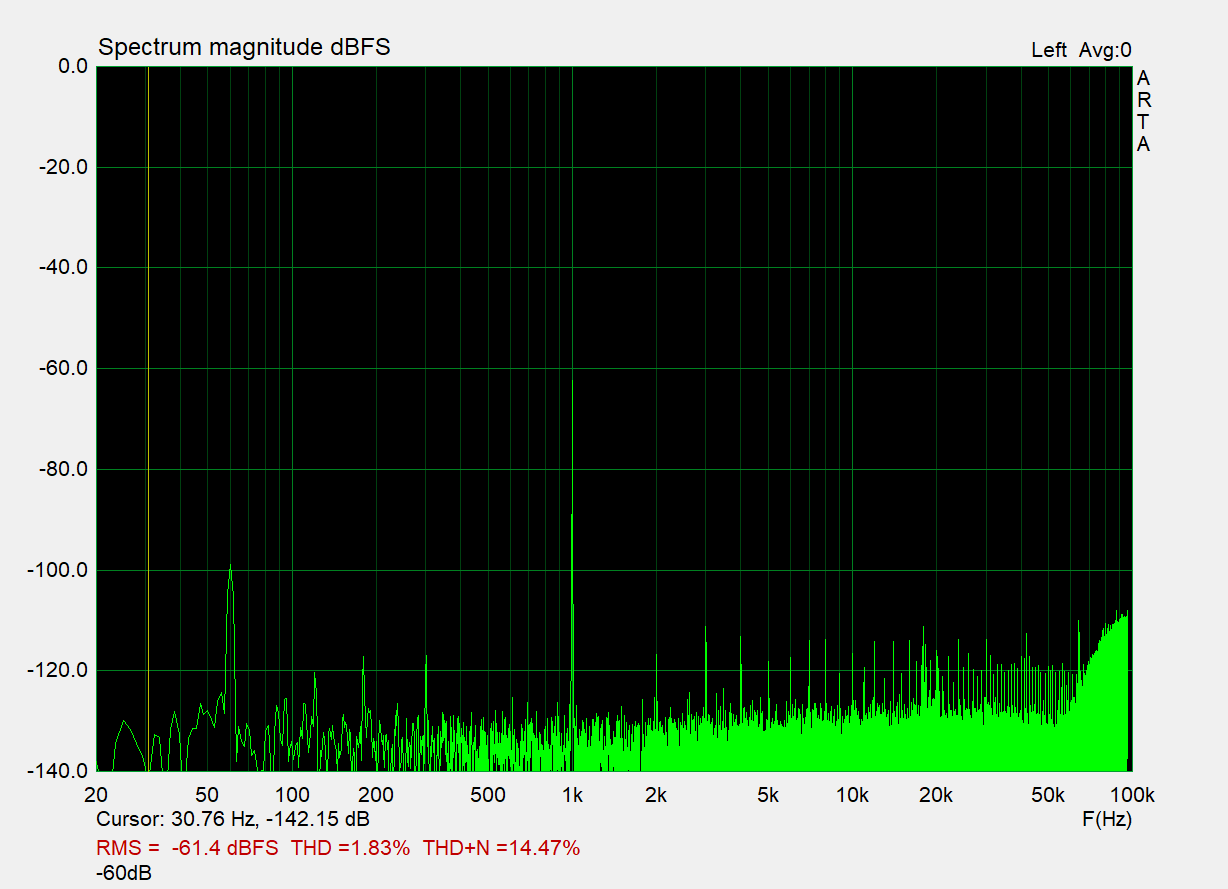

0.1% distortion? Exactly that I achieved with my "not-so-ultimate" TDA DAC, but with submini tubes I mention some posts ago:
-60dB:
Better tube (ones with less Island effect) will have less distortion, and almost no 3H at these levels.

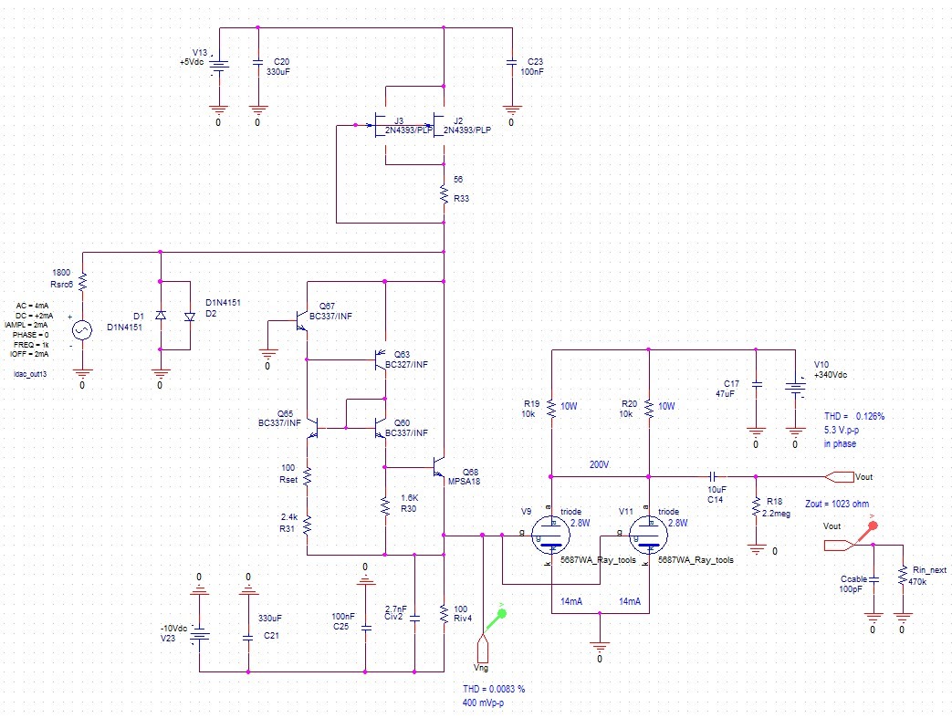

Absolutely, for a pure active loading.It is not easy finding a tube with a cathode impedance in the 10's of Ohm.
One might use something like several J-Fet's (say 3pcs J310 at 7mA each for ~30R input impedance) cascoded with a triode that is happy at 20mA (say 5687)
The defined but not very low gain stage impedance inspired me to the CLC; I detail it here: first, pure R, 68R. The Zin of the tube I used plus it's cathode R are in the vicinity of some 180R (it not have so much gm).
Then I simulated a third order passive filter based on these in and out R of filter, resulting in a 20nF of input C (in parallel with the 68R), then a 1.2mH inductor, then a 15nF final cap. A "pi filter".
The tube Zin is not soo low but helps to define a value for the filter. Is anyway far better than trying to filter it using a eg. line output impedance, like 10k or so. In any case, one can use some 180R for the loading of the filter, and uses it with a normal grid input stage.
People wanting more ultrasonic response can alter the filter parts.
I are under impression, with my listenings, that not seemed to degrade the sound, perhaps even the opposite 🙂 the absence of strong staircase steps in the out makes a easier life for lesser amps... and permits less oversampling if the hardware not permits the highest.
Some people wax lyrical about eg. phono pre using LCR RIAA filter, so why not ;-)

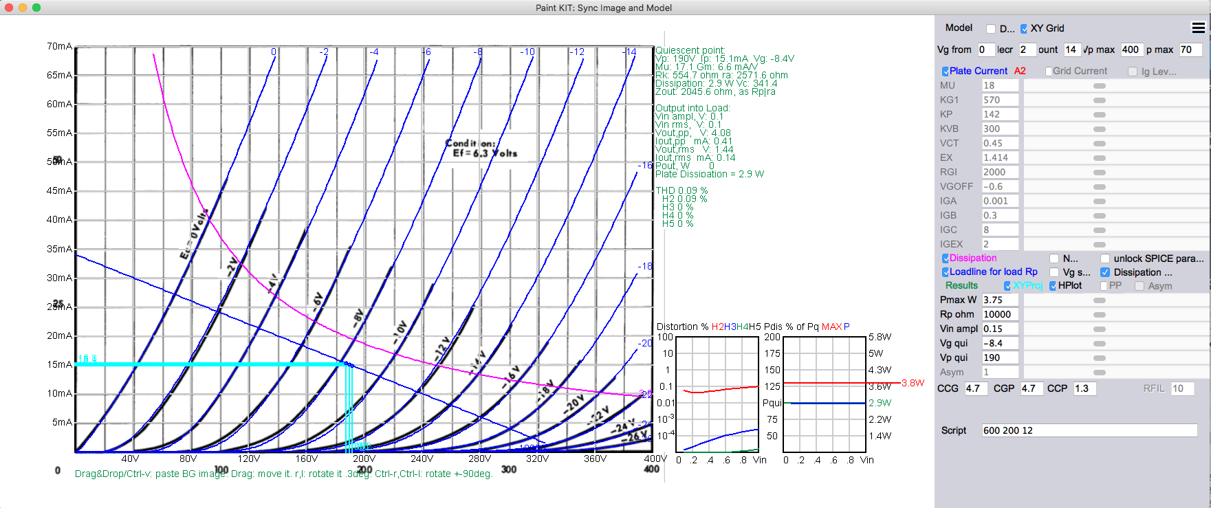

+1 😎There are other tubes that lower HD and we could use topologies that cancel H2, but other than bragging numbers, what's the point?
That is why the -10V neededcascoded with a triode that is happy at 20mA (say 5687)
for options to employ theese kind of tubes,
vith -Ug of about -6 to -8V for good operaton point, and slight more mVp-p @ Riv
because the amplification factor is not huge of still availabele but very good 5687, 6N6P and others...
And with direct negative grid bias, avoiding 3 passive elements, Ccoupling, Rcathode and Ccathode.
They are critical for BW and PHASE, especially Ccathode and Ccoupling...
This is the whole idea what for i designed "negative" branch NPN Active IV stage.
And You can use the -10V point to Vref for internal cascoding of BJT module. Like You did.
Still it is an option for cascoding more than 2 modules vith more negative PSm to acheive more negative grid bias and to employ some DHT triode 🙂
I will send the schematic. From the vital importance is that almost all of these "negative" NPN oriented circuits has very low THD, with lower values of Riv, for 100-200mV of p-p voltage @ Riv
For furthure amplification and PHASE correction with tube amplification stage...
This circuit is OK, BUT why complicate and iduct again automatic grid bias when we have pure negative grid bias?
And unnecessary in existing context, coupling Cin (from negative DC to zero, and then again grom zero to automatic -Ug
with Rcathode...

No, it's not...
This is actually what my original current conveyor was meant for.
Thor
Maybe it was not transparent enough.No, it's not...
I think that this way is more simple, efficient and low thd.
And employs -10V of dac supply unit.
Negative grid bias can be slightly adjusted by varying the Io trough the IV and Riv.
Also more important that phase is 0deg, and with one tube (parallel sections) output resistance is about 1K.
5697 is set to high voltage, in linear region, with moderate current and not exceeding maximum values. Rload-s of 2x10K should be 10W rated for beating the heat inside the box.
Other tubes also are welcome to employ with adjusted settings.
there are 5687 anode curves and model parameters that I made, pretty close match. Also matched with 5687 wersion curves...
2 Pspice models: one Raytheon other CFP. Very similar You can use each one...
Code:
* Created on 04/21/2024 11:12 using paint_kit.jar 3.1
* www.dmitrynizh.com/tubeparams_image.htm
* Plate Curves image file: 5687WA and 5687 Raytheon
* Data source link: Raytheon PDF datas
.SUBCKT 5687WA_RAY_tools 1 2 3 ; Plate Grid Cathode
+ PARAMS: CCG=4.7P CGP=4.7P CCP=1.3P RGI=2000
* 0.7P added for socket capacitnaces
+ MU=18 KG1=570 KP=142 KVB=300 VCT=0.45 EX=1.414
* Vp_MAX=400 Ip_MAX=70 Vg_step=2 Vg_start=0 Vg_count=14
* Rp=100000 Vg_ac=2.55 P_max=3.75 Vg_qui=-4 Vp_qui=124
* X_MIN=46 Y_MIN=23 X_SIZE=838 Y_SIZE=588 FSZ_X=1686 FSZ_Y=739 XYGrid=true
* showLoadLine=y showIp=y isDHT=n isPP=n isAsymPP=n showDissipLimit=y
* showIg1=n gridLevel2=n isInputSnapped=n
* XYProjections=y harmonicPlot=y dissipPlot=y
E1 7 0 VALUE={V(1,3)/KP*LOG(1+EXP(KP*(1/MU+(VCT+V(2,3))/SQRT(KVB+V(1,3)*V(1,3)))))}
RE1 7 0 1G ; TO AVOID FLOATING NODES
G1 1 3 VALUE={(PWR(V(7),EX)+PWRS(V(7),EX))/KG1}
RCP 1 3 1G ; TO AVOID FLOATING NODES
C1 2 3 {CCG} ; CATHODE-GRID
C2 2 1 {CGP} ; GRID=PLATE
C3 1 3 {CCP} ; CATHODE-PLATE
D3 5 3 DX ; POSITIVE GRID CURRENT
R1 2 5 {RGI} ; POSITIVE GRID CURRENT
.MODEL DX D(IS=1N RS=1 CJO=10PF TT=1N)
.ENDS 5687WA_RAY_tools
* Created on 04/21/2024 10:53 using paint_kit.jar 3.1
* Plate Curves image file: /Users/zoran/Desktop/Model_Paint_Tools/Graph/
* Data source link:
.SUBCKT 5687_CSF_tools 1 2 3 ; Plate Grid Cathode
+ MU=18.36 KG1=555 KP=128 KVB=300 VCT=0.7 EX=1.4
* Rp=12000 Vg_ac=3.05 P_max=3.75 Vg_qui=-6 Vp_qui=160
* X_MIN=56 Y_MIN=35 X_SIZE=996 Y_SIZE=691 FSZ_X=1830 FSZ_Y=838 XYGrid=true
.ENDS 5687_CSF_tools
And there is cascoding for "outside" more negative Power supply, and more negative grid bias for other types of tubes. In this example 2A3 is used because of low Ri and low Zout.
-15V of DAC power supply used for reference voltage for added identical cascode module.
-30V (or another -15V but cascoded to existing PS is additional outside power line.
THD is very very low...
PSRR is also very low in tube part.
Phase is 0deg...
The system showing pretty much the same results with other CFP NPN topologies of this concept.
The main goal when i was interested in this is to use some DHT tube for additional amplification after active BJT circuit, and to be open to adjust for manu different tubes.
Phase is 0deg...
