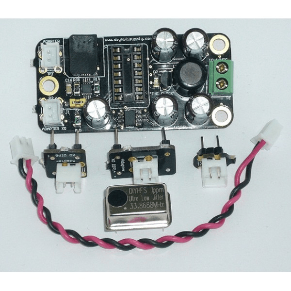

Back when I designed a clock PCB for diyhifisupply I made a footprint for a combo that could take 2-pin XH or SMA.
Thor
