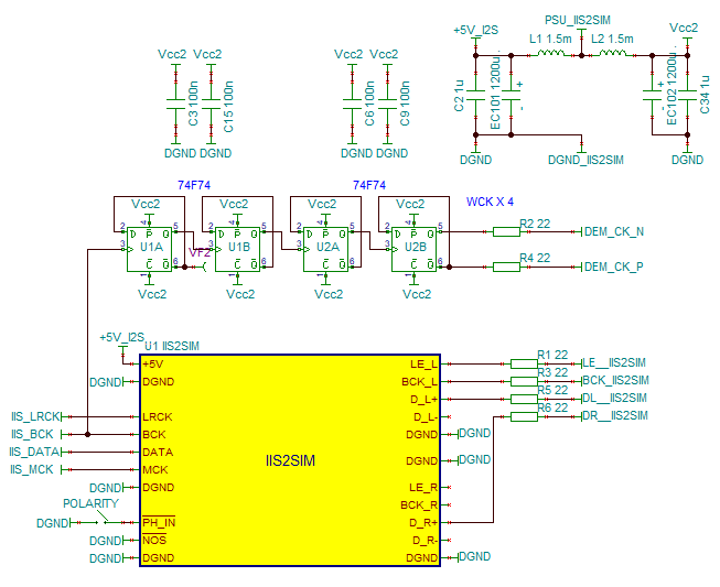

Differential DEM clock. As now all other inputs are high level, I guess we should include the DEM circuit.
Some small corrections for consistency...
DEM Clocking & IIS2SIM conversion (using ALIExpress Module):

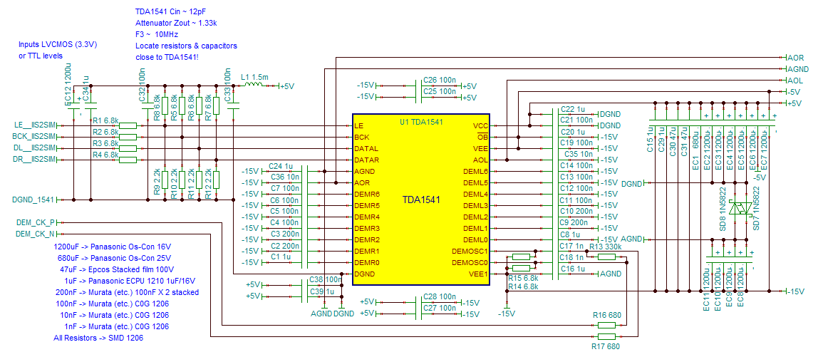

Okay, after sleeping on this a bit, it's really, really bad practice to rely on a components parasitics for a fundamental circuit function. Moreover parasitics that are input signal variable and not documented.
So instead combining a high impedance signal conditioning network at the TDA1541 input pins, we need to make the network lower impedance and add lowpass capacitors. Sadly this now means circulating currents from, the CPLD become large enough to be a problem at over 1mA PP per line for each input, at up to BCK frequencies.
So a really solid ground plane with at nest 5inch or so distance between source or multiple larger diameter coax screens must carry this current. No ribbon wire etc, allowed and coax if of significant length must be correctly source terminated.
It might be better to place the whole signal conditioning at the source end and make it matched impedance for the coax or traces to TDA1541, but that blows up the "core module" concept.

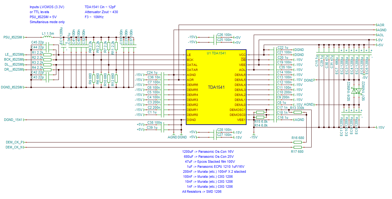

Anyway, on second thought, we end up with this:
Alternatively, placing the same attenuator/slew rate limiter circuit at the source we would use values scaled to give ~50R out (240R series/270R to 5V / 75R to GND / 220pF).
The very high impedance Attenuator circuit from the earlier can likely also be used, but it may need adjusting the resistances to either higher or lower for correct operation.

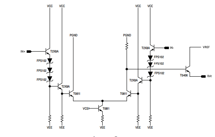

But it will not be part of the CM Logic running of +5V and it seems also clear it has no job on the DEM current sources.
So all I can make out is tail currents for the bit-switches, which need to be pull to 0V or a little below in order to kill current leakage from the bitswitches.
Normal CM Logic will not go much below ~1.5V, the tail CCS is usually biased with two diodes.
So there are likely level translators and current tails to -5V.
Each bit switch with level translation from PECL/CML may look like this:
Vcc = +5V, input is from standard CML.
Vee = -5V
PGND = DGND/AGND, not sure which
With a total of five diode drops in the chain, the +1.4V at the buffer transistor emitters become -1.6V at the base of the bit switch transistor.

Why are You drifted from the 174.6KHz DEM pins decoupling Cs? You decreased the values?n a components parasitics for a fundamental circuit function

Which type of Flip Flop for recklocking You recommend based on the internal structure to match the ECL type inputs?
For DEM oscilator pins this is the "74F" series?
Which series for inputs, before attenuation?
Well, PECL with level shifters and / or attenuation makes the most sense for everything, PECL with 1.6V PP differential swing can probably be coupled directly into the oscillator pins via suitable capacitors.
I will use these simply because they are not CMOS and I want TH Parts for that.
PECL MC/SY100 etc. if SMT is used but that needs a lot of changes to the Attenuator/Slew rate limiter.
What I show assumes a standard LV CMOS (3.3V) 8mA pin as driving source.

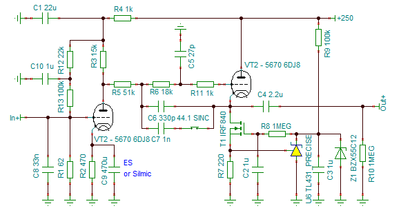

Folks,
Elsewhere there is an off line discussion on TDA1541 Tube outputs. I quickly threw something into the Simulator. It's based on my experience with many tube based products, but untested and I will not build it myself:
The low gain of the 5670 or 6DJ8 (et al - these two and their variants are very similar electrically, very different pinout) means a bypassed cathode resistor and 62R I/U conversion with offset correction is needed to get 2V @ 0dBFS.
After the gain stage there is a sallen key filter and output buffer.
Optionally (close switch) there is a 3.2dB boost at 22.05kHz in the filter, to equalise the "SINC" (sic) rolloff of the DAC operating at 44.1kHz sample rate.
This filter will also "unfold" (in MQA-Speak) the hidden ultrasonic content encoded in the recording, with a final 3rd roll-off after the peak.
The CCS is feedback type for DC using TL431, but "open loop" for AC. So operating conditions are stable regardless of temperature etc. but the circuit does not rely on looped feedback for AC (> 1.6Hz). The 12V zener diode is turn on protection.
Performance? Well typically "ideal tube", ~0.1% HD at 0dBFS with almost pure H2. That is just the right amount of H2...

Noise looks somewhere around -100dB.
I don't see a point of messing with tubes if you find this unacceptable, just an op-amp if you want really low distortion. The OP2156 would be my take, as Op-Amp I/U converter, plus sallen key filter similar to what is shown here.
