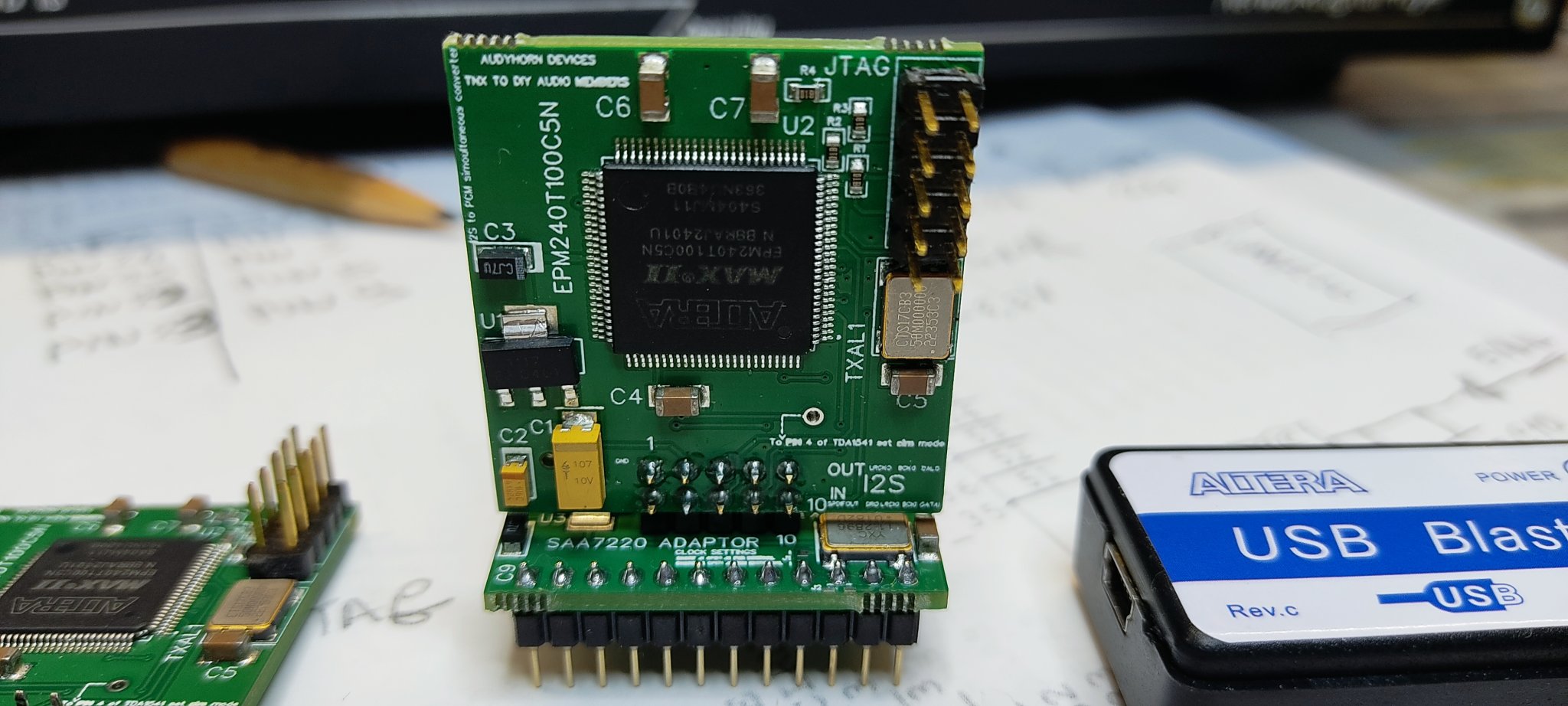

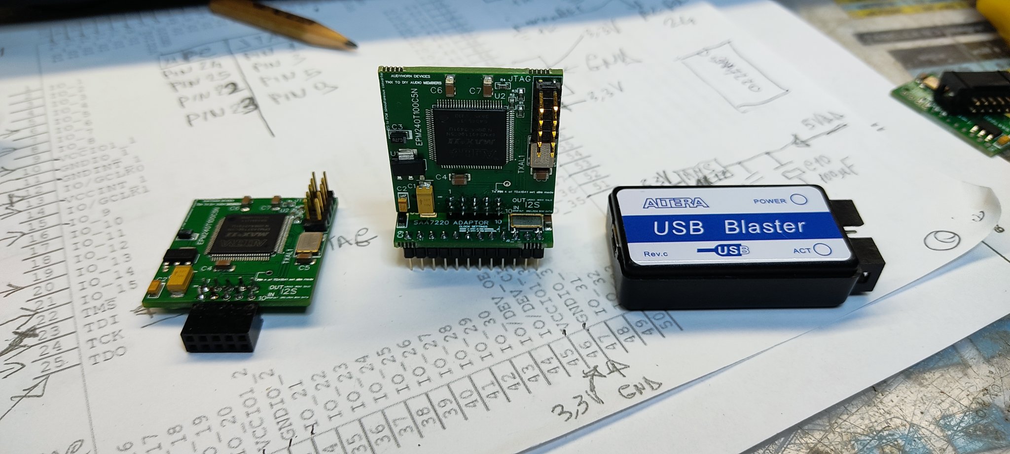

I have these Chinese CPLD boards, so yes, I expect to use simultaneous mode. Not because it's magic (correct input signal conditioning is the "magic") buit to get 384kHz capability.
Thor
Ok, so you had not the time to check if the sim mode programation (datasheet) is working with the new pins routing.
Indeed no magic but the only way to get 384 K hz. Also it has more resolution also in NOS mode, certainly because speed divided per two or maybe what happens inside the chips ! I dunno. Difference are obvious, and more with late Taiwanns I found (in my setup at least : 15 bits stop clock s sim mode from the 1.1 I2S to PCM from IanCanada, slaved by a MasterClock (Crystek or Laptech SC-Cut)... non upsampled in my setup.
I am looking forward to know if that works with the new pins alocations about the sim mode according how it is made on the original datasheet (pin 26 to 28)
Certainly needs a reclock after... or maybe slaved already ?In case you are thinking of a nos/os system, I could make my latest Saa7220 pin compatible work available to the community. It features CPLD technology with code written by @miro1360 .

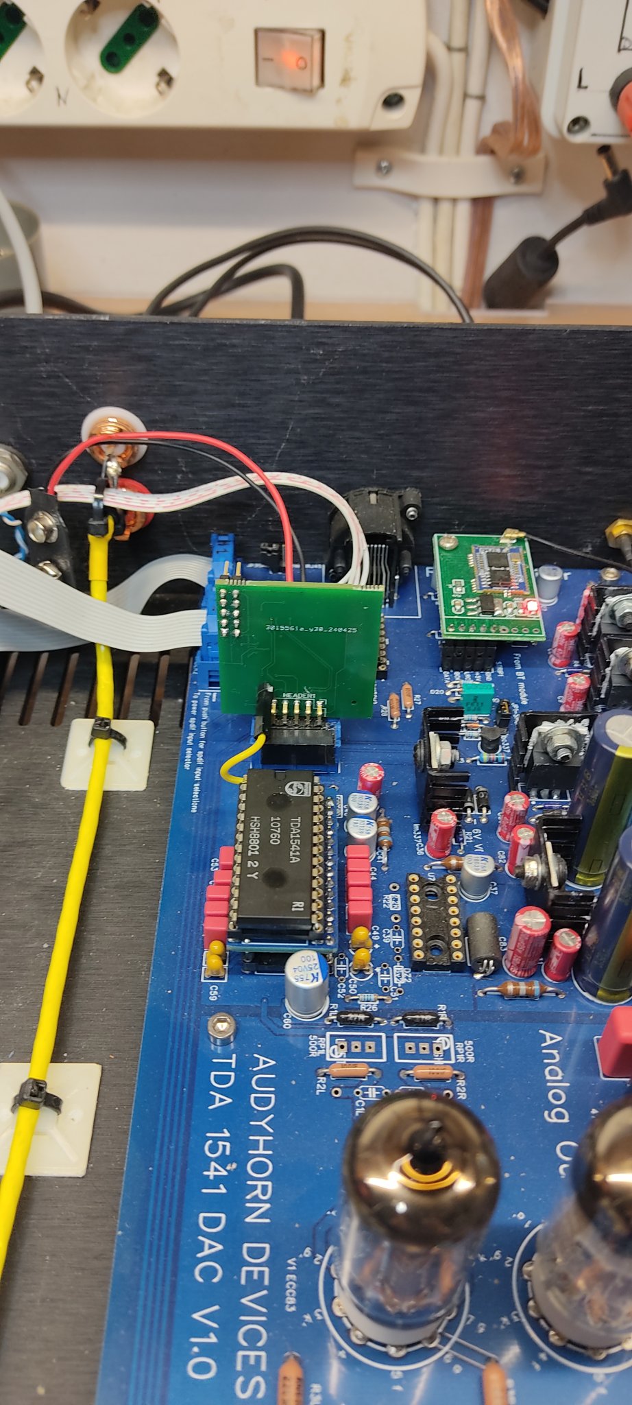

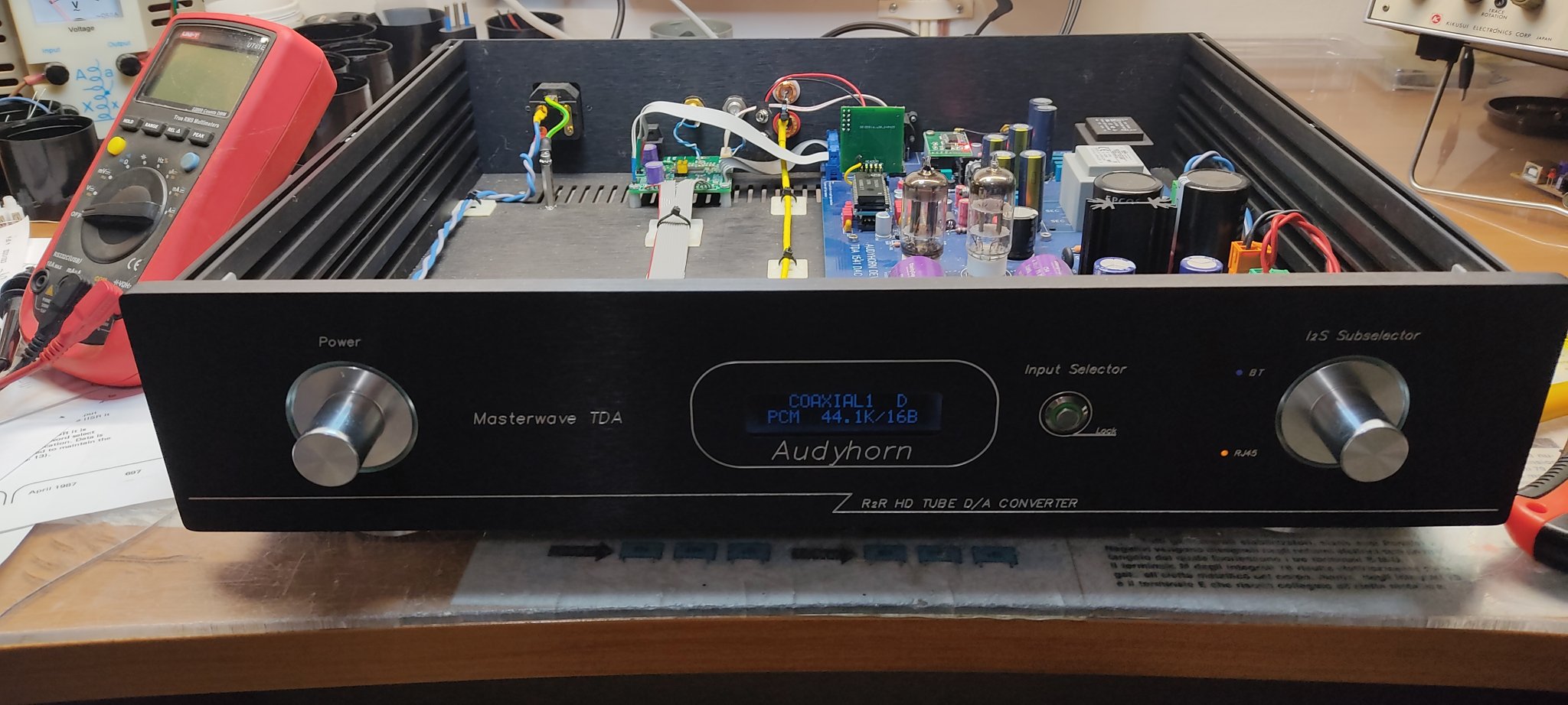

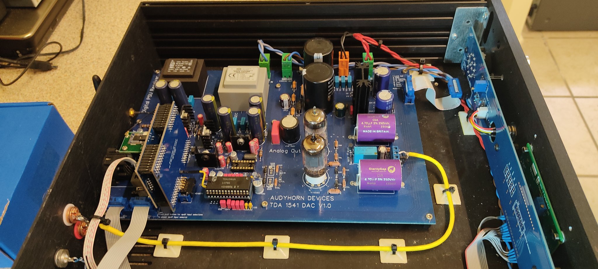

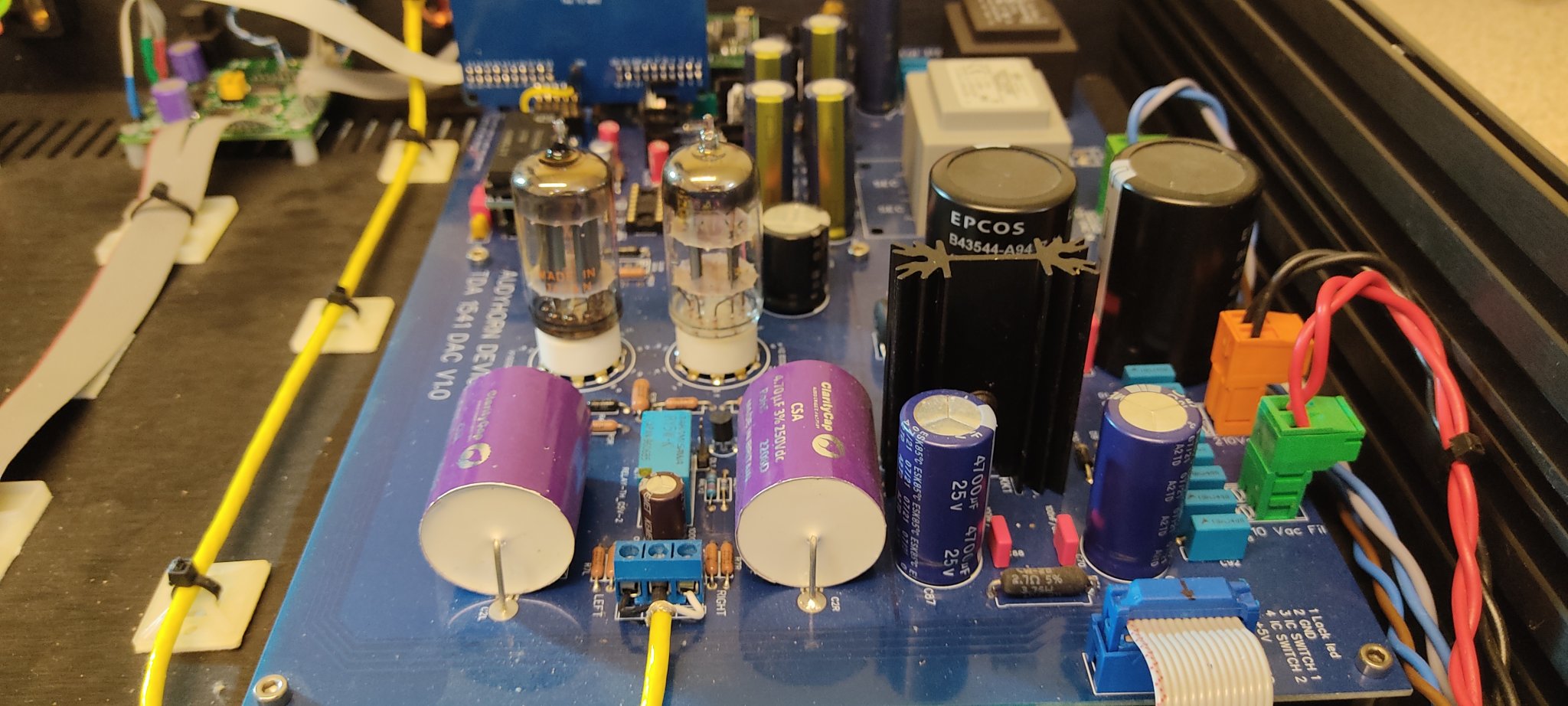

Some things strange to me on the blue board . Congrats for the tiny green cpld layout 🙂 .
Blue board : 12AX7 tempting for the high Mu as I/V but chineese or russian made nowadays ????
Black holko metal film : good if the NOS ones (not the nowadays remade)
RN55 resistors : a pita : it dulls and smooths everything, as a strong spice as to be used with a lot of care or it kills music. Do use RN60 instead. (or Yageo 0.1%)
Clarity Cap CSA : can be good or not related to wht is outputings : The MR & CMR are verry neutral and way better but the price ?! I like Tin foil from SCR here or MIT RTX (NLA).
Are the cab with blue K from Kemet or ???? The Reds are Wurth ? (no experience with them); but the blue alumin canned polymer very differ from brand to brand.
And I do not say it sounds bad : equilibrium between parts choice and layout is something strange as it is related IME with how is sounding the rest of the hifi devices... But when the sources is precise and neutral it is easily showing the rest of the hifi devices + room choices...

There is no "new pin routing".
All that changes is how precisely we decouple pins.
The standard methode links both grounds and decopuples everything to ADND/DGND which we know causes problems.
The difference between taking a non-polar DEM capacitor directly to -15V instead of taking it to AGND where the current then must return to -15V via the AGND to -15V power supply is subtle. It doesn't change actual operation, just where unwanted noise ends up dumped to.
Now the specific input mode you select simply determines how the input latches forming the input shift register load data from input pins. That's basic logic. It of course remains unchanged.
Lots of magic incantations.
Have you applied signal conditioning to the various signals?
There is no change to functionality at all. Link pin 27 to 26 to set SIM mode, connect the correct pins.
Most important, limit the slew rate of the input signals, to not exceed the slew rate of the PNP input transistors and limit the voltage swing to little enough to not drive the input differential pair into cutoff.
Do this and all noise difference between IIS and simultaneous mode disappear, because the noise disappears, as the source that caused the noise to appear is deactivated.

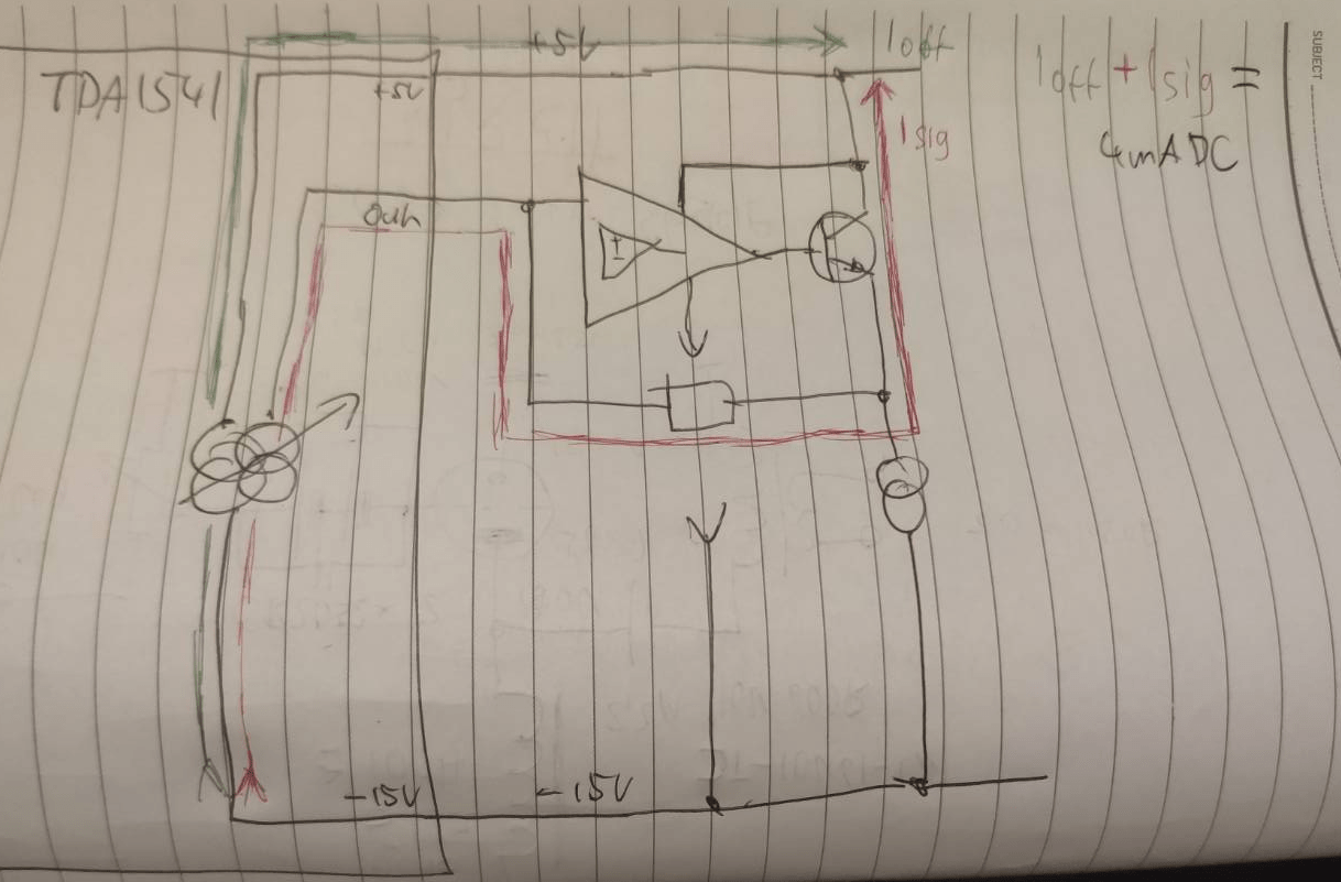

Anything analogue must be star-grounded (returned) to -15V, NOT AGND.
While this DOES include the analogue output current, this cannot be done directly.
The AOL/AOR pins need to be kept at < +/-75mV (preferred < +/-25mV) difference from the AGND pin.
The current then must somehow pass through the current to voltage conversion resistor to give output voltage and then return to -15V.
If (say) using an Op-Amp I/U converter, the Op-Amp keeps the inverting input at "AGND", the signal current must flow through the feedback resistor, which is the actual I/U conversion resistor. The current then flows into Op-Amp output and from there to the relevant PSU pin of the Op-Amp.
Obviously the +V powersupply and -V powersupply ONLY of the I/U conversion Op-Amp should be shared with the TDA1541 (yes, +5V and -15V!). This suffices for 2V RMS using modern OPA's. By sharing the power supplies all current loops are shared.
A genuine TI OPA2156 from Mouser (too many fake OPA1656 out there) is an excellent choice here and makes a VERY credible I/U converter with good sound using TDA1541.
A servo Op-Amp should be used to control a CCS from +5V to AOL/AOR, drawing around 2mA and servo adjusted to "null" the I/U conversion output.
Active or passive filters can then follow without extra DC blocking. Other options have been discussed in this thread.

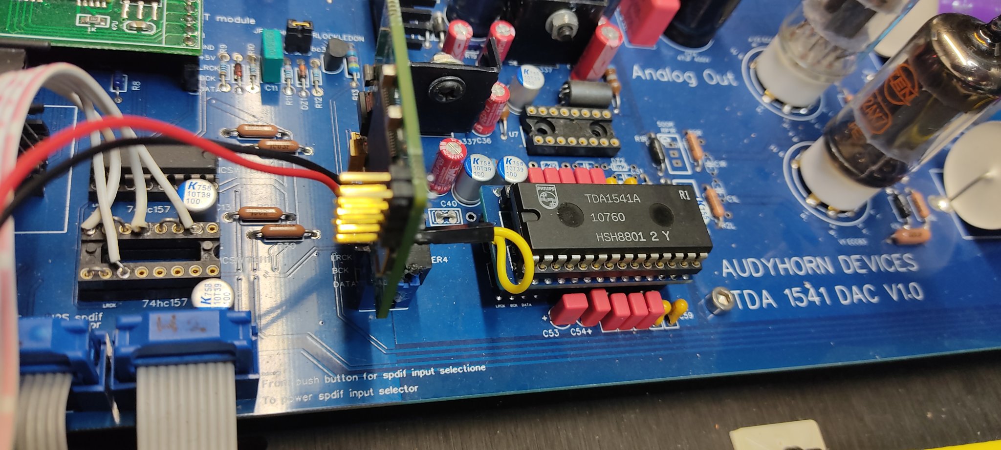

Thor
PS, Actually all I'm discussing is about minimising noise sources on the TDA1541 as well as anything causing HD. And I am looking to do it in a fundamental way, ground up, not using hacks or workarounds.
Thanks, I was not confortable with that as 26 was not feeded from outside anymore.
Of course pin 26 is fed from the outside. It has to. It still wants -5V @ 45mA.

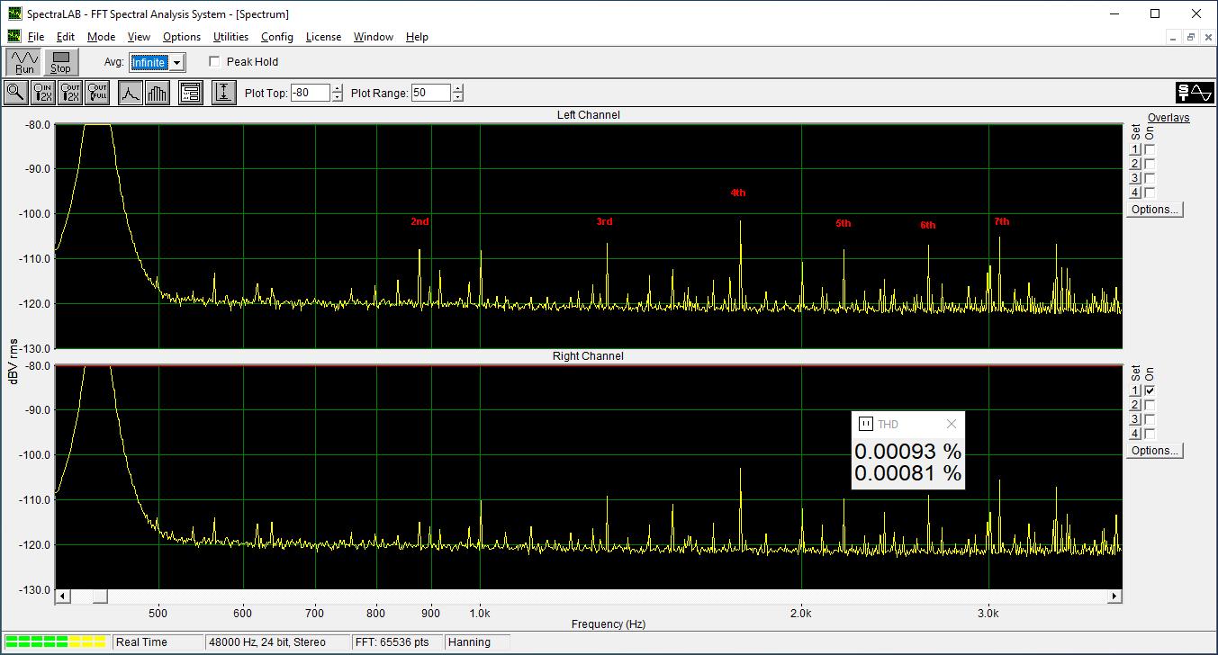

Perhaps better visible on this magnified FFT spectrum. The fundamental is 437.875 Hz. The 1 kHz and multiple peaks are probably due to the digital generator, ignore them. I haven't implemented the input signal conditioning yet, I am curious what improvement it brings.... where are the harmonics onthe graphs, please ? Are they the main peaks with overshoots in betweens (the small peaks) ?

Here I show an external pass transistor and CCS added to an Op-Amp (say NJM2068).
Signal currents in the TDA1541 originate at -15V and are split into variable currents, one of which is sent to +5V and the other to out and the sum of these two currents is 4mA.
If we do not send the signal current to +5V, but elsewhere (e.g. separate +15V), this current needs to return to somewhere where we also send the current from +5V, via imperfect supply decoupling capacitors.
Ultimately the two split currents need to reunite and flow as DC into the -15V pin.
