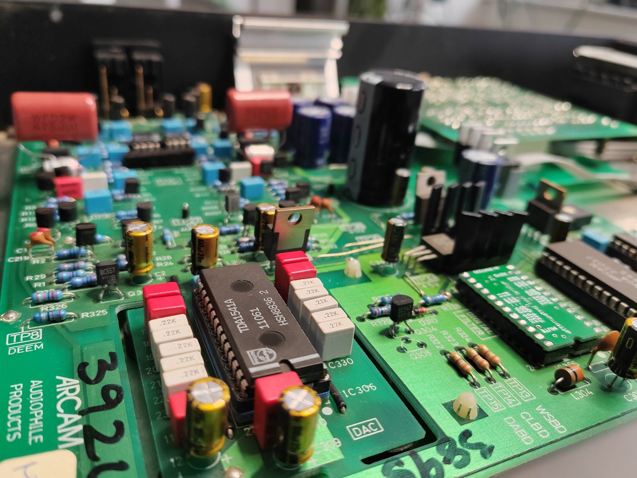

I have a arcam delta blackbox which utilises the tda1541a.
So far I've recapped it and NOSd it with the grundig DEM mod which I really like the sound of.

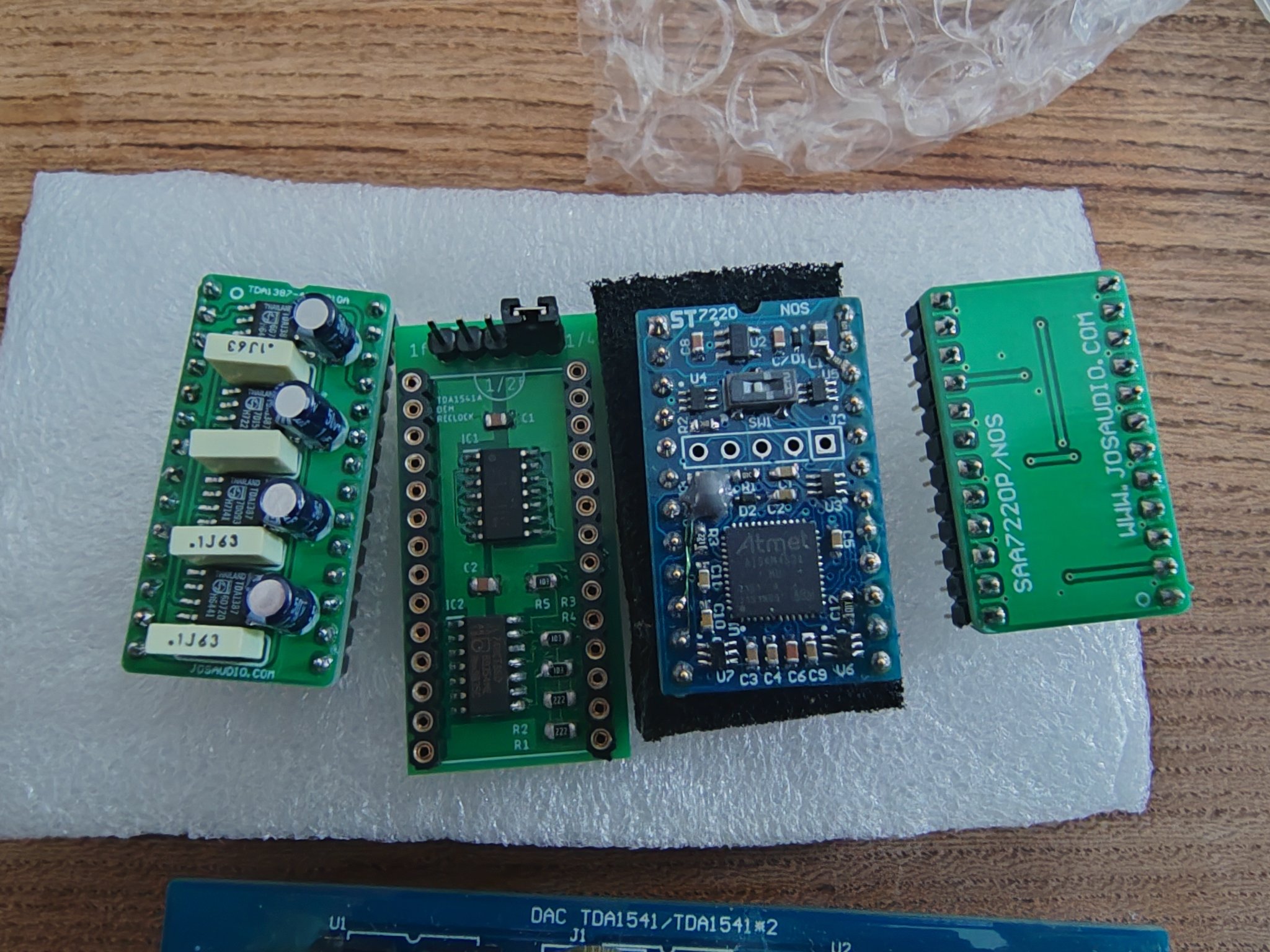

I tired various modules.

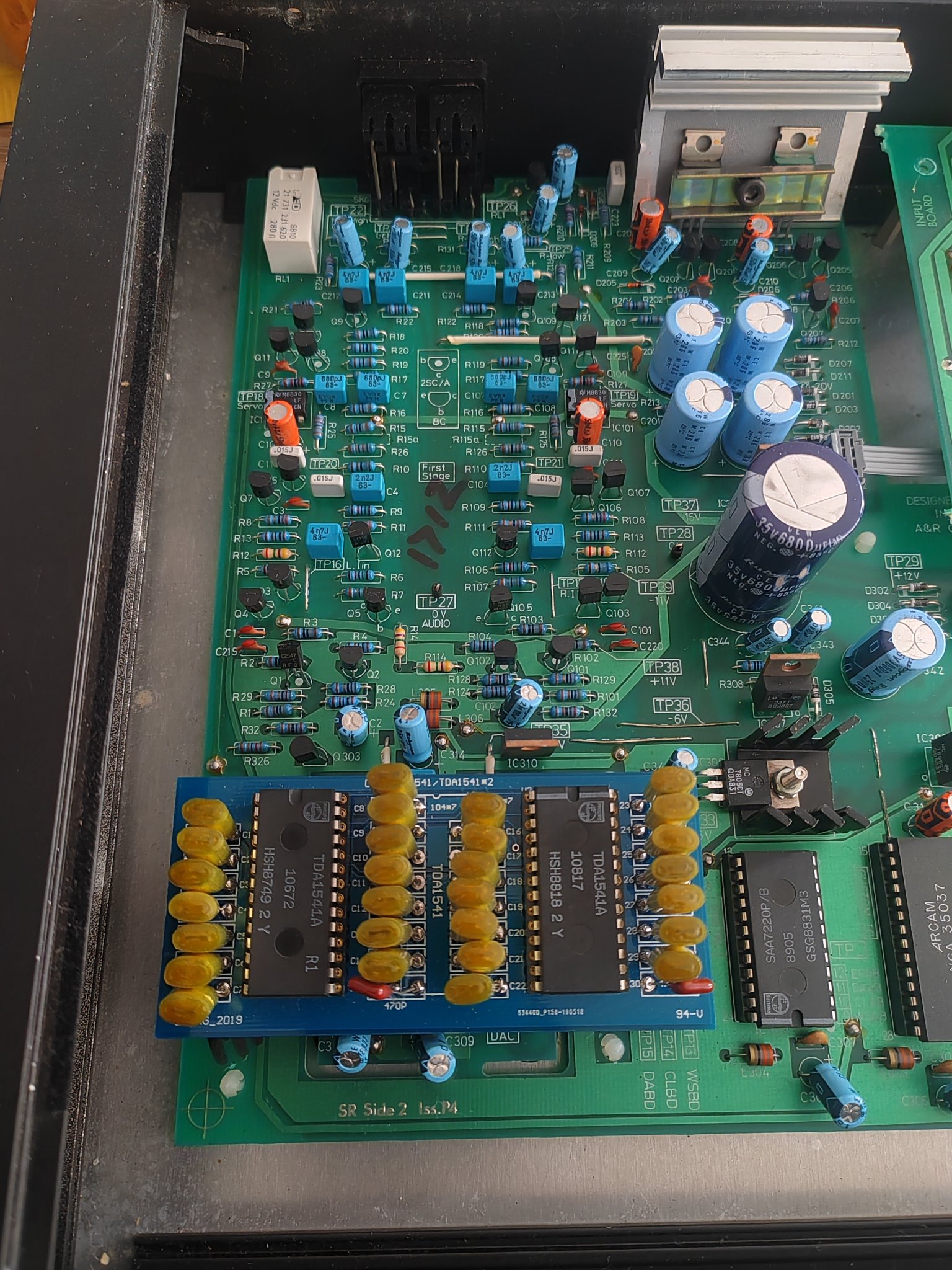

I've also been playing with parallel boards (this is a dual grundig dem parallel board).

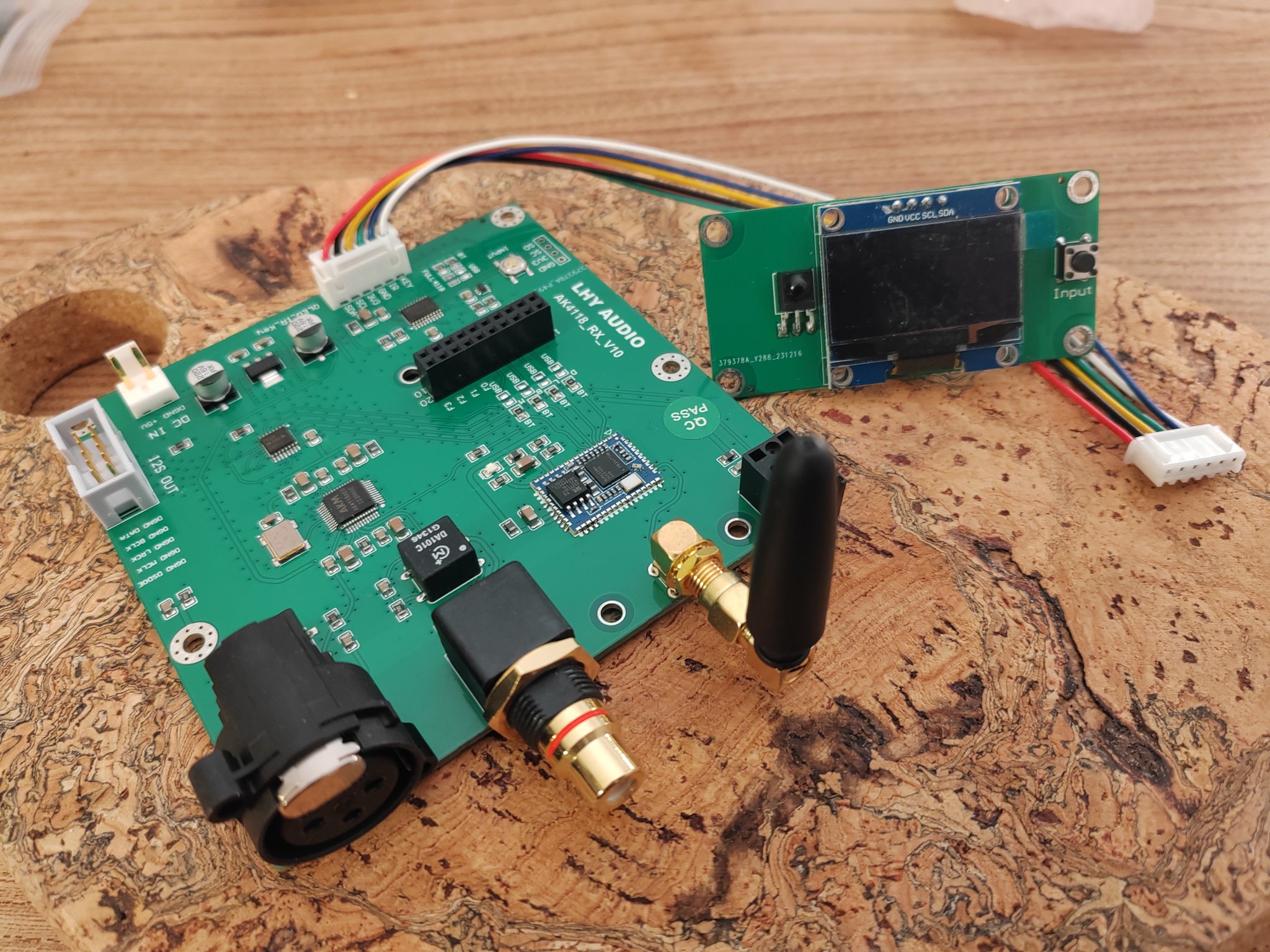

My next plan is to use a modern input board which allows Bluetooth, optical, AES, coax etc at 24bit 192khz.

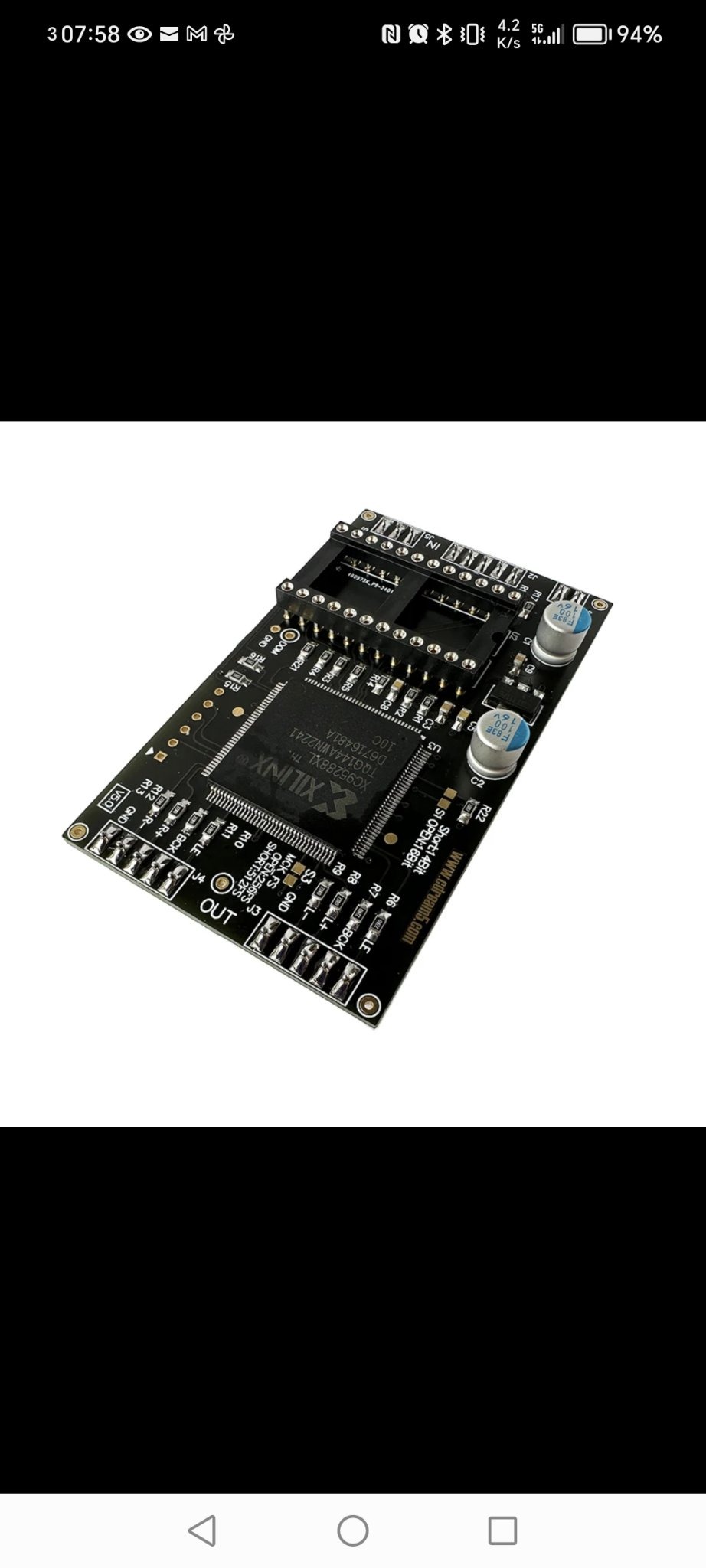

£30.29 16%OFF | SAA7220 TDA1540 /TDA1541 Format Conversion Driver Module NOS/OS Switching 384K/24bit for Raspberry Pi
https://a.aliexpress.com/_EwJEkMt
My next though was to use a format convertor module, but this had led me down a rabbit hole now.
Can I use this module to drive a pair of tda1541a in parallel? Or is it better to use it on balanced mode.

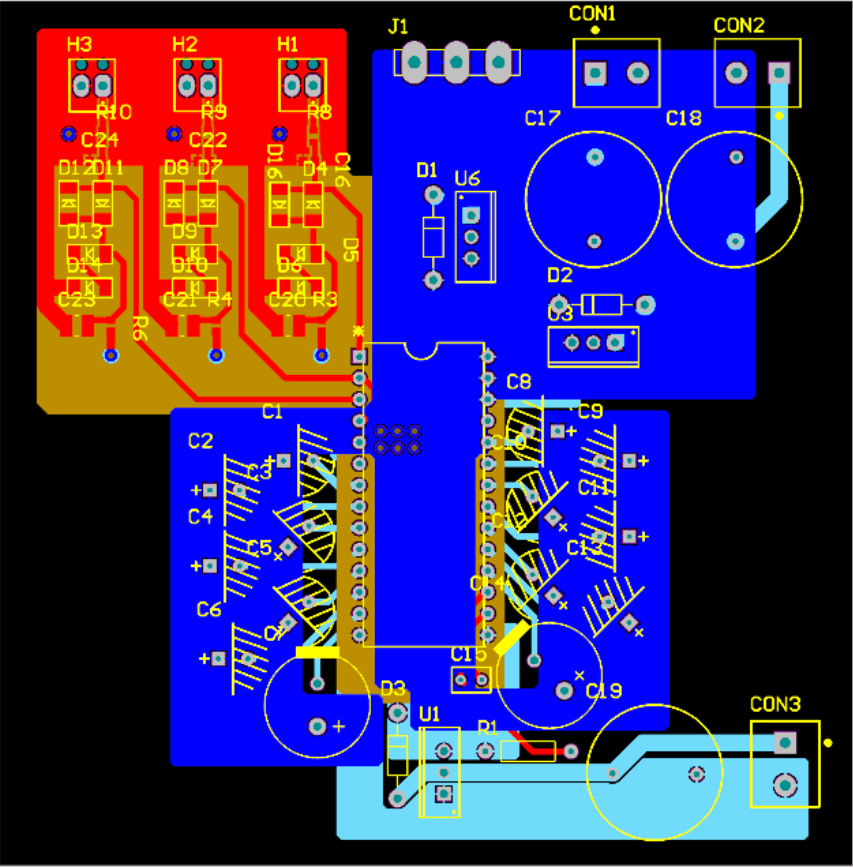

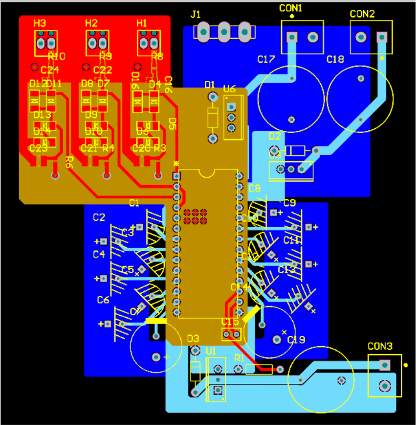

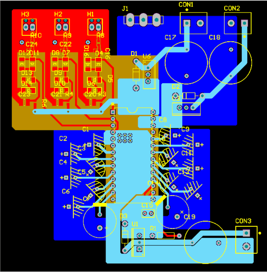

Hi all,

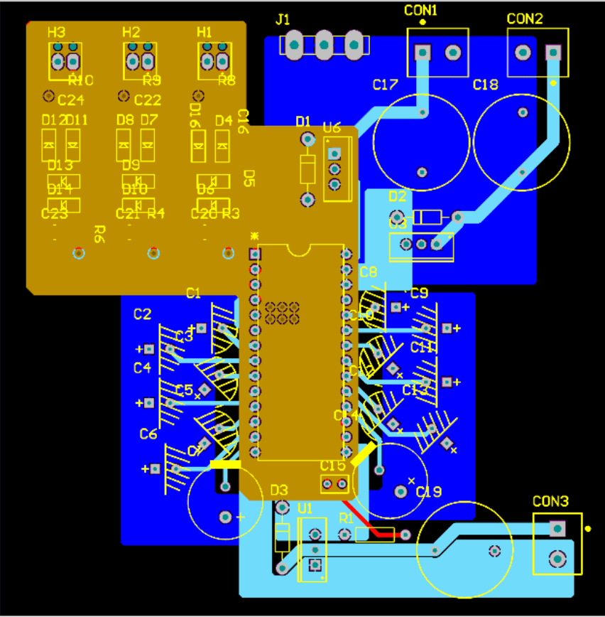

I have attempted, first time ever, a 4-layer PCB design using CircuitMaker. It's clearly inspired by MV Labs and some of the Thorsten comments.
TOP Layer (Red) - Digital Signal: Input attenuators (MV Labs versions), DEM cap + res tracks
2nd (Brown) - DGND: DGND plane, GND of the input attenuators (thorugh 3 vias), pin 14 and pin 5 (together with 6 vias it connects all GND planes)
3rd (Cyan) - Analog signal + Power: +5V, -5V, -15V, GND for -15V connected to pin 5, DEM cap tracks
Bottom (Blue) - AGND: AGND for +/-5V and DEM caps, formed in a sort of a star connection to minimize crosstalks. Connected to DGND and -15V GND via 6 vias around pin 5 (there is no via stitching option in CircuitMaker hence it is what it is).
The only thing I could not route were the outputs. Will solder high purity Cardas litz directly from the TDA1541A pins to the output (J1), where output resustors will be soldered.
Comments very welcome!

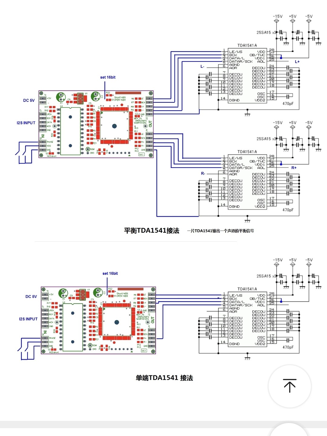

HiCan I use this module to drive a pair of tda1541a in parallel? Or is it better to use it on balanced mode.
I use probably the same manufacturer model board. Long time ago
white one like in this example.
https://www.aliexpress.com/i/1005001614539604.html
I tried the boards in NOS mode without SAA chip.
(SAA7xxx OS filter needs a separate additional 12V power supply)
If You want NOS mode You have to pull out the SAA chip and connect the in-out pins under the chip on the PCB...
Board was working very well with I2S to TS14 bit mode up to 384KHz for TDA1540
Board was working good with 16bit for TDA1541A i think that was up to 192KHz.
But it is not for the ballanced mode. It has only +DATA L and +DATA R lines
You need inverters for data lines for balanced line. IF You want it...

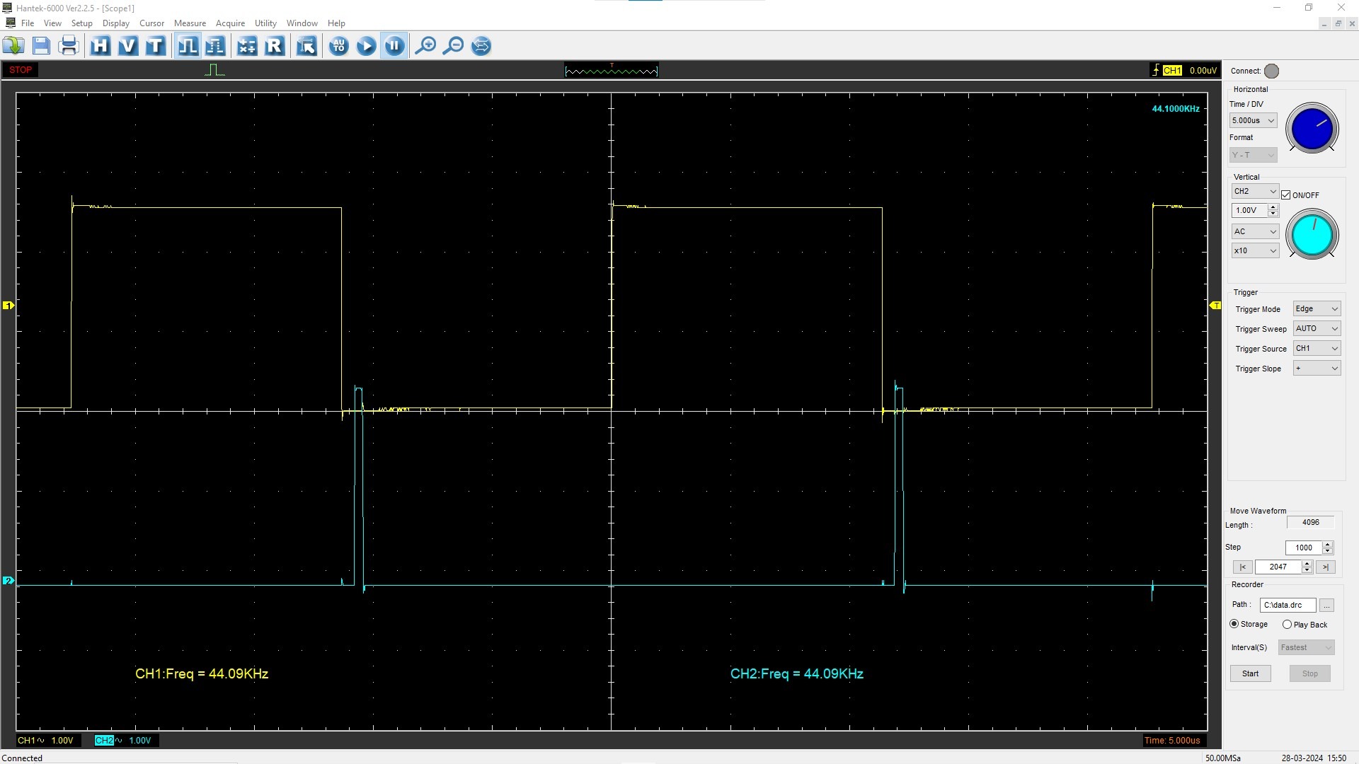

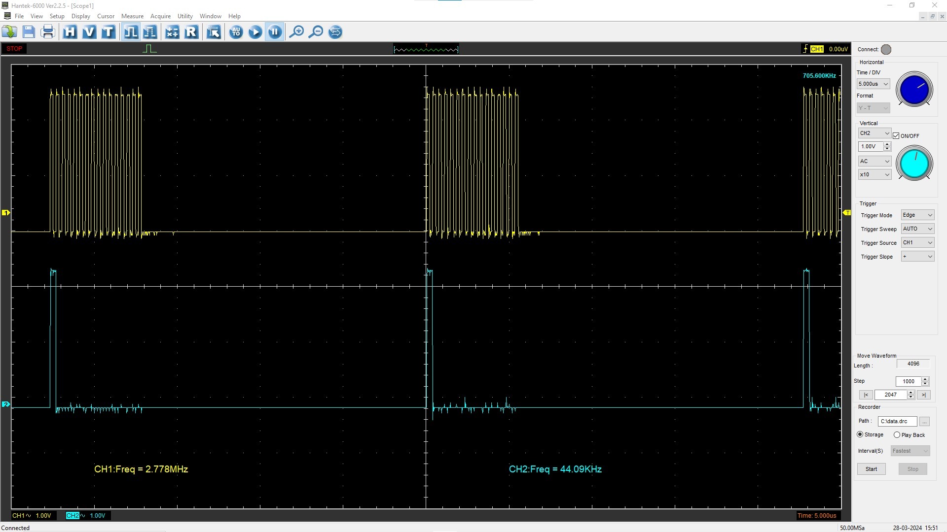

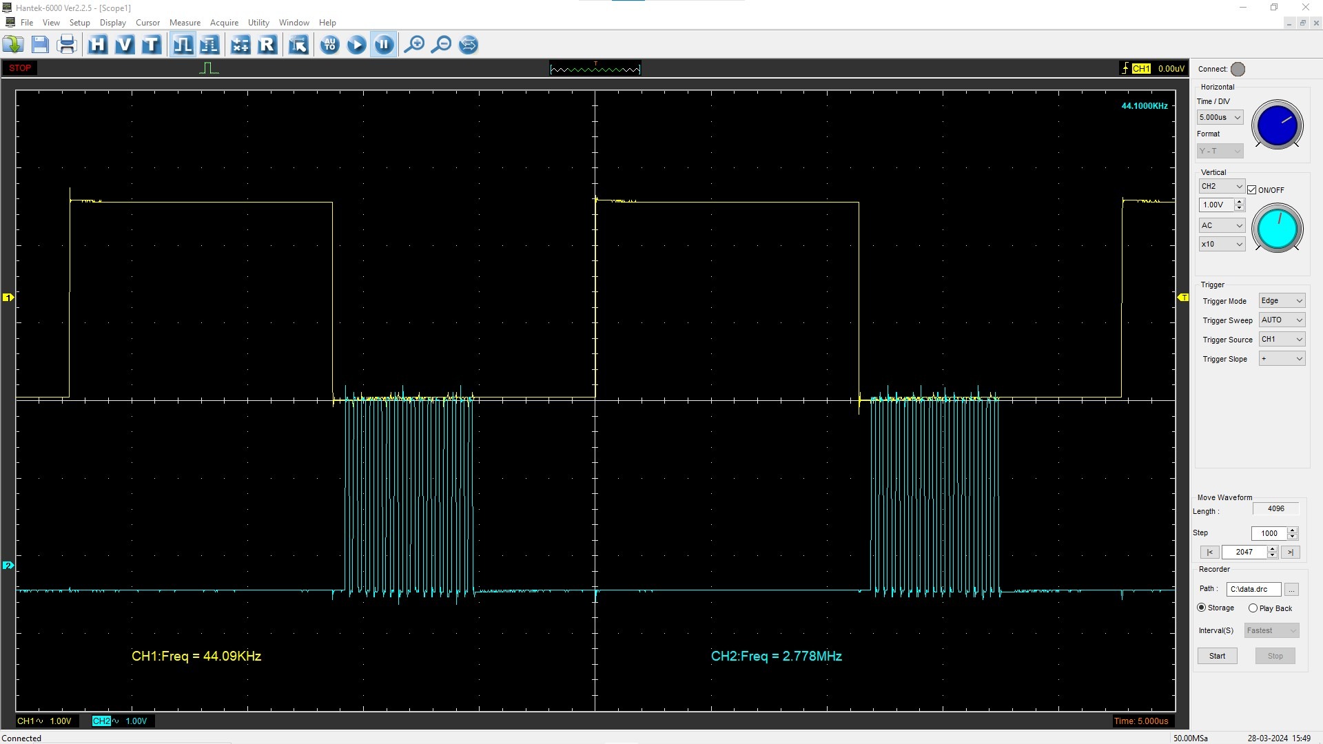

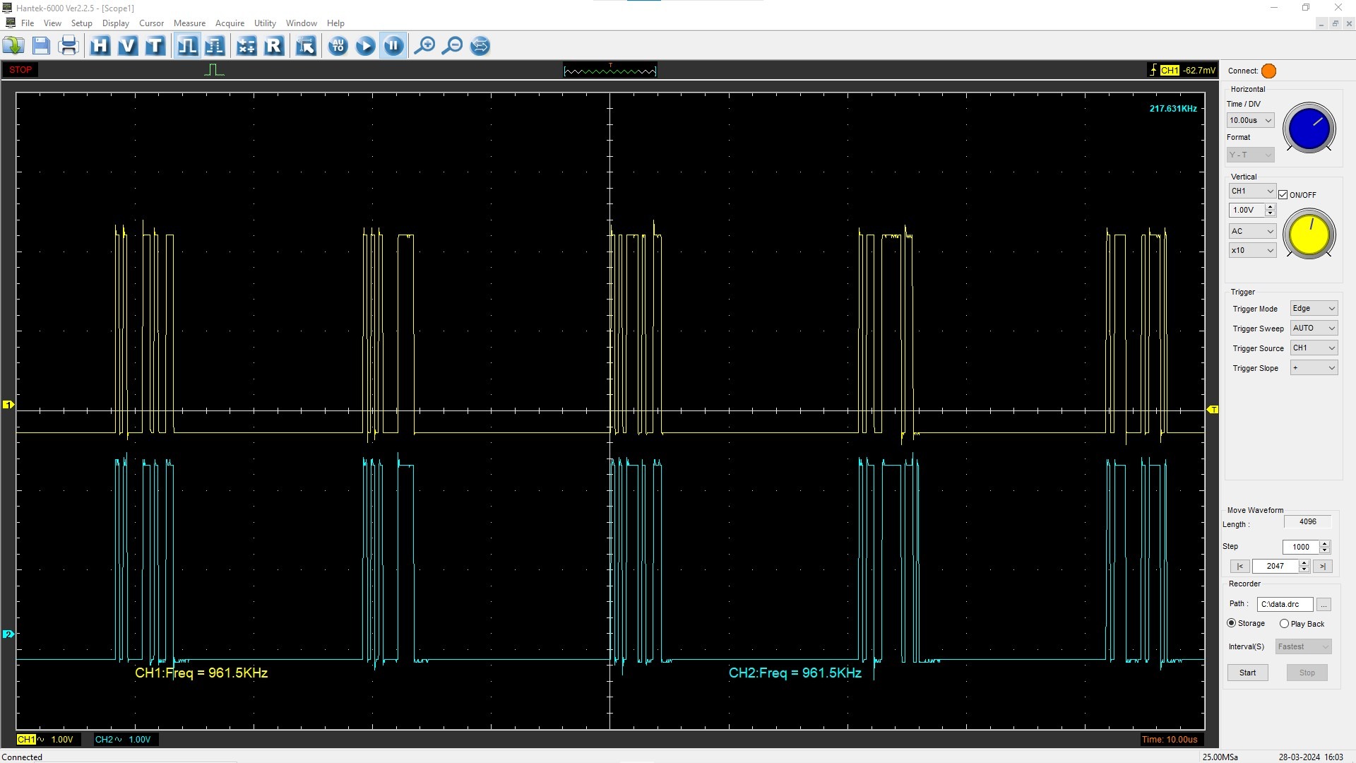

I received the new 4 layers board today , build it and test it this morning , I have this measurement for the moment
first image is left + right channel with 1 khz signal
second image is bck + lrck
third image is lrck + left or right channel without signal
fourth image is bck + left or right channel without signal
the schematic is the one John gave us in 2018 : I2S to simultaneous
I dont know where this bit is from when there is no signal ??
It is MSB inverted.
When no signal all bita are "0"
in TS format MSB is inverted so, the MSB goes from 0 to 1.
