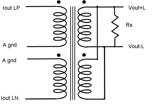

@batteryman Pls advise a novice: Are bifilar primaries necessary to neutralize the DC offset with dual balanced TDA1541's? Or the balanced connection will cancell the 2mA currents?
The main reason for bifilar windings is to cancel common mode noise and of course offers a x5 or x10 step up so no further amplification or filtering is needed. There is really no point in using a non bifilar wound transformer.
The balanced connection can't cancel the 2ma offset because this is not biploar - flows to ground from each dac so you would need to nullify it with a preset from +5v.
I had a thought as to whether a suitable common mode choke might work as a filter (once the 2ma offset has been nulled)?
Ah ok, thanks. And you cancel it with out of phase connected bifilar primaries (wit the center tap to the ground)?The balanced connection can't cancel the 2ma offset because this is not biploar - flows to ground from each dac so you would need to nullify it with a preset from +5v
One DAC will have inverted data so no need to worry about the transformer.
Just connect as below.
Ok, so you cancel the DC flux by the primary connection. You mentioned data inversion on one DAC. This is how you achieve your balanced operation? Or you split I2S?

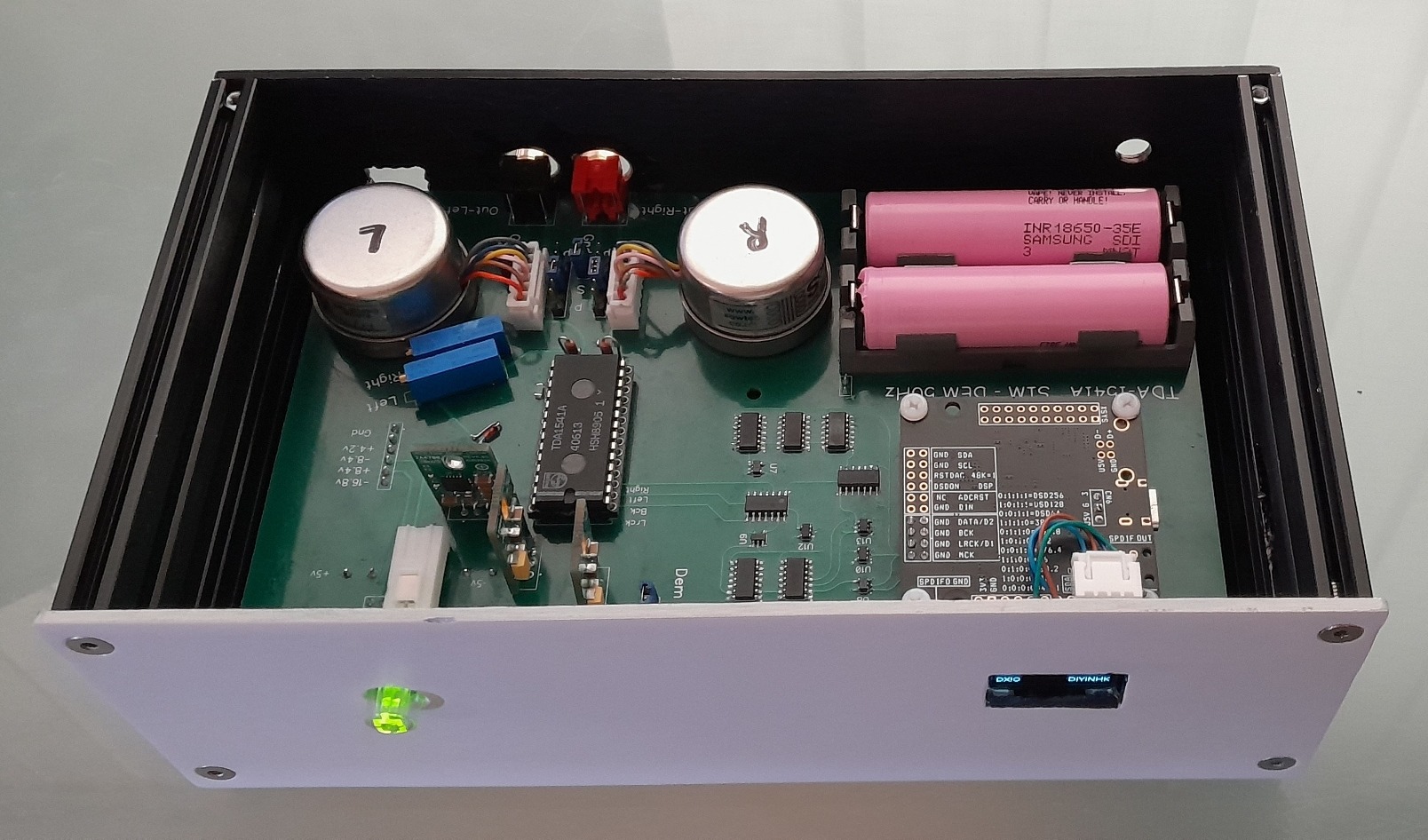

Here it is 🙂
Finally the all thing is in its box , dac batteries are mostly under the pcb , charging post at the rear , one for each voltage , 10 to 15 hours of listening before charging
for the moment I/V resistor are Vishay RN55 47.5 ohm , it's difficult to choose between type of resistor , metal film , carbon , wirewound , etc
a wonderful DAC to listen , highly detailed , superb stereo image , it has tone color ( timbre ) as natural as possible , especially voices , silences are stunning
well , a must have for every audio enthousiaste 😎
