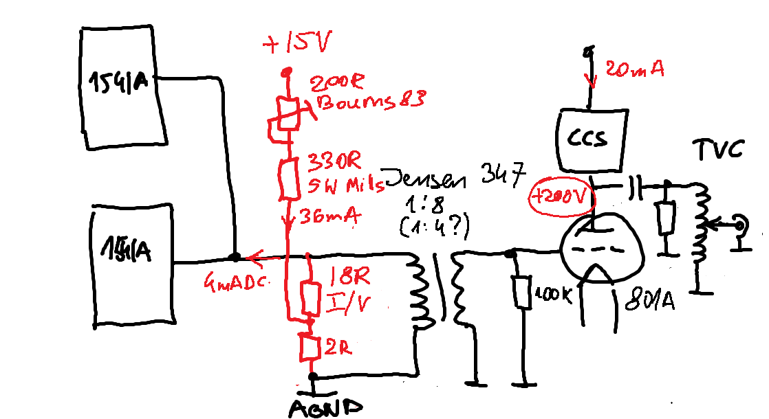

I think I have finally figured out what I want to do:
The tube stage is Bartola 801A that has been up and running (wonderfully!) as a preamp since last summer.
1) Parallel TDA1541A; motivated by findings of audio enthusiasts from early 2000's, e.g. Andrea Galavotti or AquaBlue TDA1541A
Balancing would not give the DC cancellation, my Jensen SUT unfortunately is not bifilar wound so balancing would just require extra circuitry in the digital domain with own problems and uncertain reward. I already have the PSU ready for 2 chips so why not try paralleling.
2) Passive I/V with John's DC cancellation scheme from post #7981 adopted to the situation, coupled to Jensen 347. My first guess is about 18R, giving
72mVmax before the transformer and 0,576Vmax at the grid. Although SUT should stand it (specs say -10dBu=0.35Vmax@20Hz), this may be too much gain but the parallel connection allows to experiment with very low I/V values, below 10R, which give low harmonics: MVLabs IV selection I can also try connecting SUT secondaries in parallel to make it 1:4.
3) I need raw voltage for the +15V and this is my headache now as I don't seem to have a free line anywhere and -15V line is wher the offset current sinks to so cannot use it, right?
4) Another, more crazy idea is to follow John from #7981 and make use of the +200V that I already have at the output tube:
We discussed it also here #7574. I guess what John ment with CCS being grainy was using just CCS to output pin, while here I'd have both CCS and 50k resistor. For some unknown to me reason in the previous discussion in 2020 I opposed connecting the DAC AGND to the tube ground, which killed the HV bias idea, but I can't find any good reason why I did so. Both DAC and 801A stage will share the same housing, all the connections are short, internal runs so connecting the grounds shall not be a problem.
Comments welcome 🙂

The DC nulling device must be separate for every TDA output , that means 4 output in your schematic , all TDA output are different ( +/- 15 % ) , you should consider that fact in drawing your schematic
and when in parallel , because of that fact they interact each other if you don't solve this "problem" , paralleling device is not as simple as its seems 😉
making measurements shows it very precisely 😳

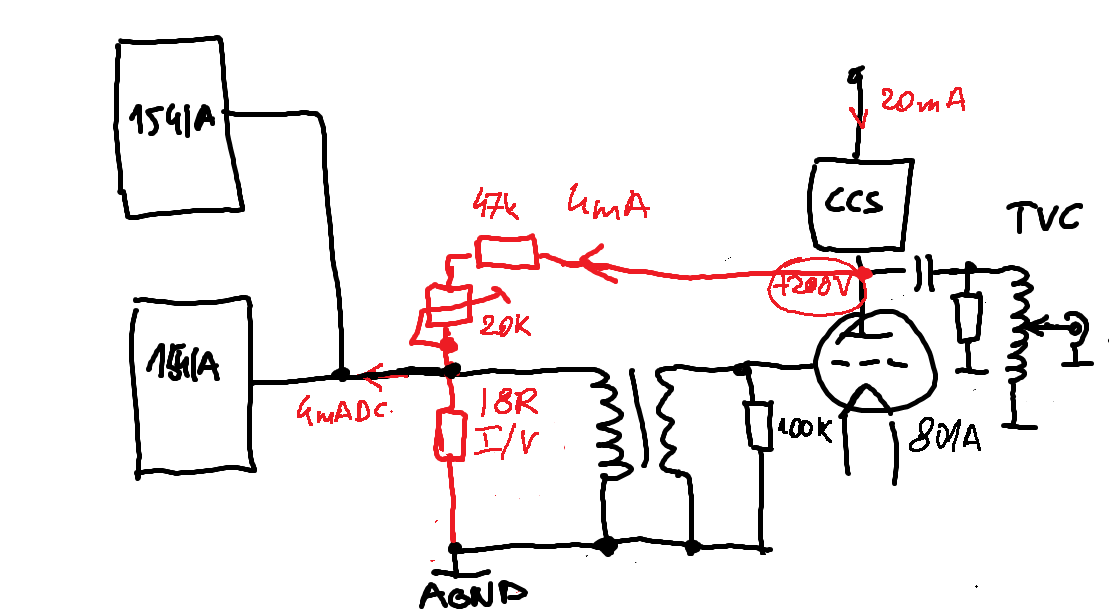

Feeding the 4 mA offset current from the tube anode does not look like a good idea. It is essentially a negative feedback. If that is your goal, OK. I use a simple jFET constant current source from +12V (2N3819 + a selected resistor between G-S).
the first way of biasing is OK.I think I have finally figured out what I want to do
I will post formulas for this EC design concept of 2mA biasing.
But You should adopt sch for each dac unit to be adjusted separately after temperature stabilization.
Or You can use simple JFET CSS for EACH dac unit, as @Icsaszar referred.
Second with taking DC voltage from HV part, after isolation transformer, is NOT a good way to go.

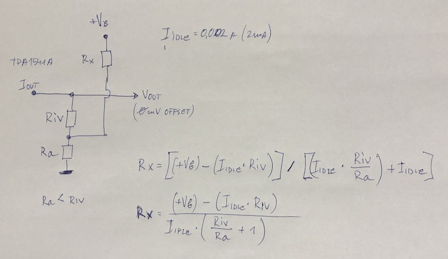

This is the right formula to calculate this @ecdesigns biasing and Riv concept
img_5902-jpg.1004599
from post
#7,993
Ra<Riv
but not commented how smaller, for Riv=18R 10% value is Ra=1.8R or 2.2R standard value...
Mind the currents in Rs could be higher.
Best way is to simulate.
Example for each DAC unit sch
Vb=+5Vdc
Ra=3.3ohm
Riv=36ohms (in parallel 18ohms)
Rx=206.9 ohm (total to adjust)

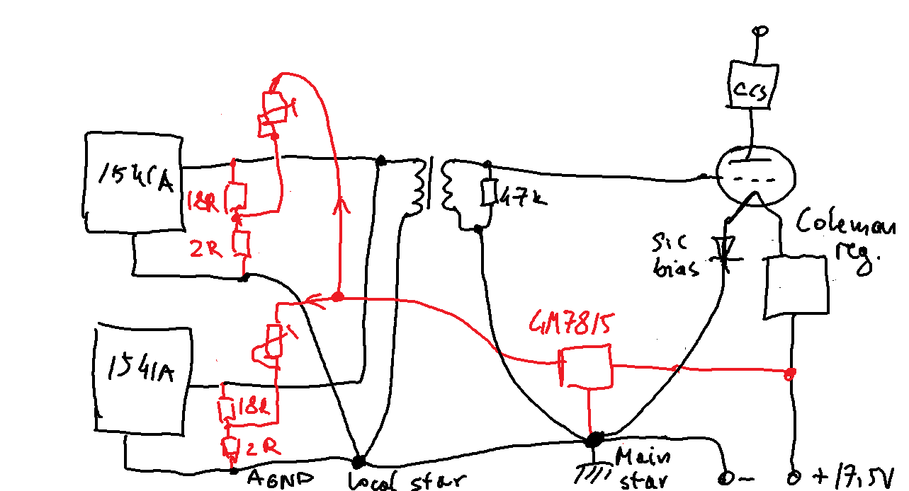

Thank you so much for the replies, especially to Zoran for the detailed analysis! Hvala vam!
1. Point taken re individual biasing of each DAC. I understand it's also good to close the output current loops locally. I'd also reduce the total Riv twice and make it 18R per chip to appreciate lower THD at the lower Riv
[however I remember someone, possibly Galavotti, reporting that low Riv sounds a bit weak; prob. it's like with a cart loading - fine tune by ear].
2. Point taken re +200V, feedback is not what I wanted. I need to get the biasing voltage from the existing sources as my construction has no free space for an extra voltage line 🙁
3. I have 17,5V raw to power the Coleman regulator for the 801A filament + SiC bias. The total current is about 1.25A. I can take 40mAdc bias from there. Any downsides? Any possibility of Coleman reg interactiong with LM7815? There is still some feedback loop but hopefully very weak. The new drawing is below.
4. Grounding becomes ambitious. One idea is to have a local star ground around the DAC's, connected to the main star ground of the whole assembly. Probably keeping the GND's isolated would be better but since DAC and 801A are in the same alu box, the DAC gnd connects to the box anyway to appreciate screening (all the PSU's are in a separate box).
5. SUT - as I wrote before, Jensen states -10dBu max@20Hz which, if I'm correct, translates to 0.35Vmax (or 0.69Vpp), so the level looks safe. As for the reactance reflected to the primary..hmm...this would probably be the case with any xfrm. In particular with Sowter 1465. I doubt 1465 has much lower capacitance (primary is bifilar wound) and still ppl seem to have v good results (e.g. fabrice63).
6. The pot at the output is actually Slagle's autoformer. It is there at the out for a reason - the preamp drives about 6m long interconnects, I wanted appreciate higher current capacity.
Comments welcome as always 🙂

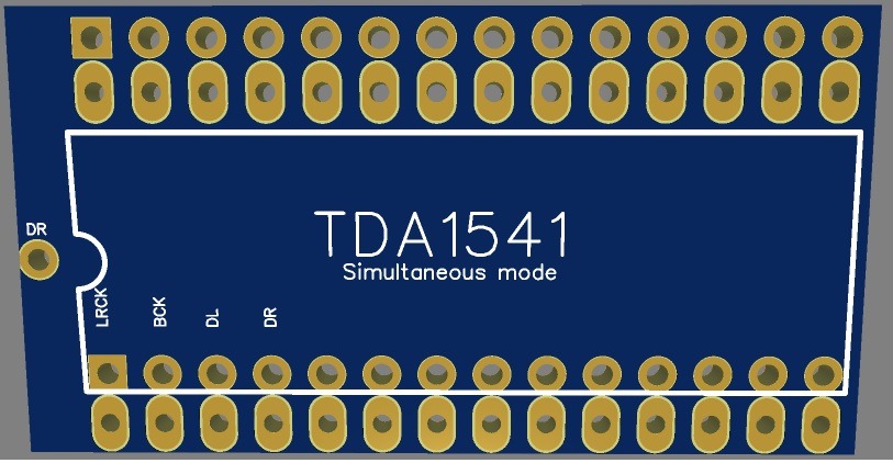

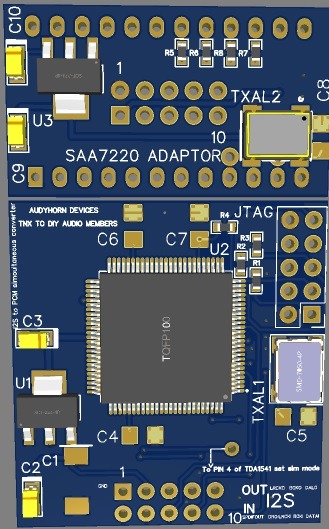

Hi Guys i'm working for a I2S to PCM Converter Board EPM240T100C5N
Thanks @miro1360 for his good heart and the CPLD code.
This Kit should allow you to get TDA1541 in simultaneous mode in CD player and also get spdif out from the SAA7220 adapter.
I also planned a TDA1541 adapter.
The Saa7220 adaptor should work also as a Simply plug and play replace of Saa7220 filter for a NOS mode...It have inside a clock for need for CD player. Will only be necessary to make some jumpers on it and eliminate the original clock network by lifting some leads.
Gerber file are avaelables...now we need the new firmware for SPDIF performance outputHi Guys i'm working for a I2S to PCM Converter Board EPM240T100C5N

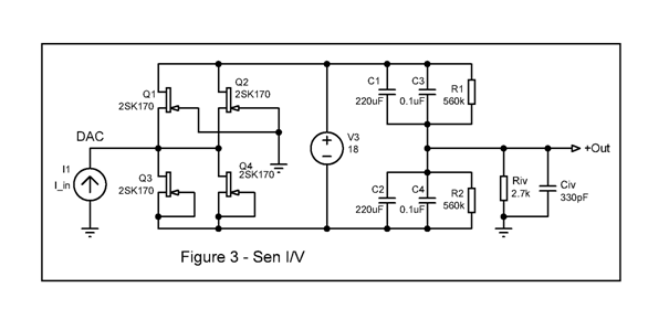

First of all the outputs are in parallel, so you only need one contra current and one Rload . Kirchhoff first law. No need for two, making things difficult to trim. if the 7815 is followed by some real nice RC filtering it seems ok to try out. I would also pre-load the 7815 directly at the output with say 100mA and not have it output only a few mA. I see no further issues, but I might oversee it…

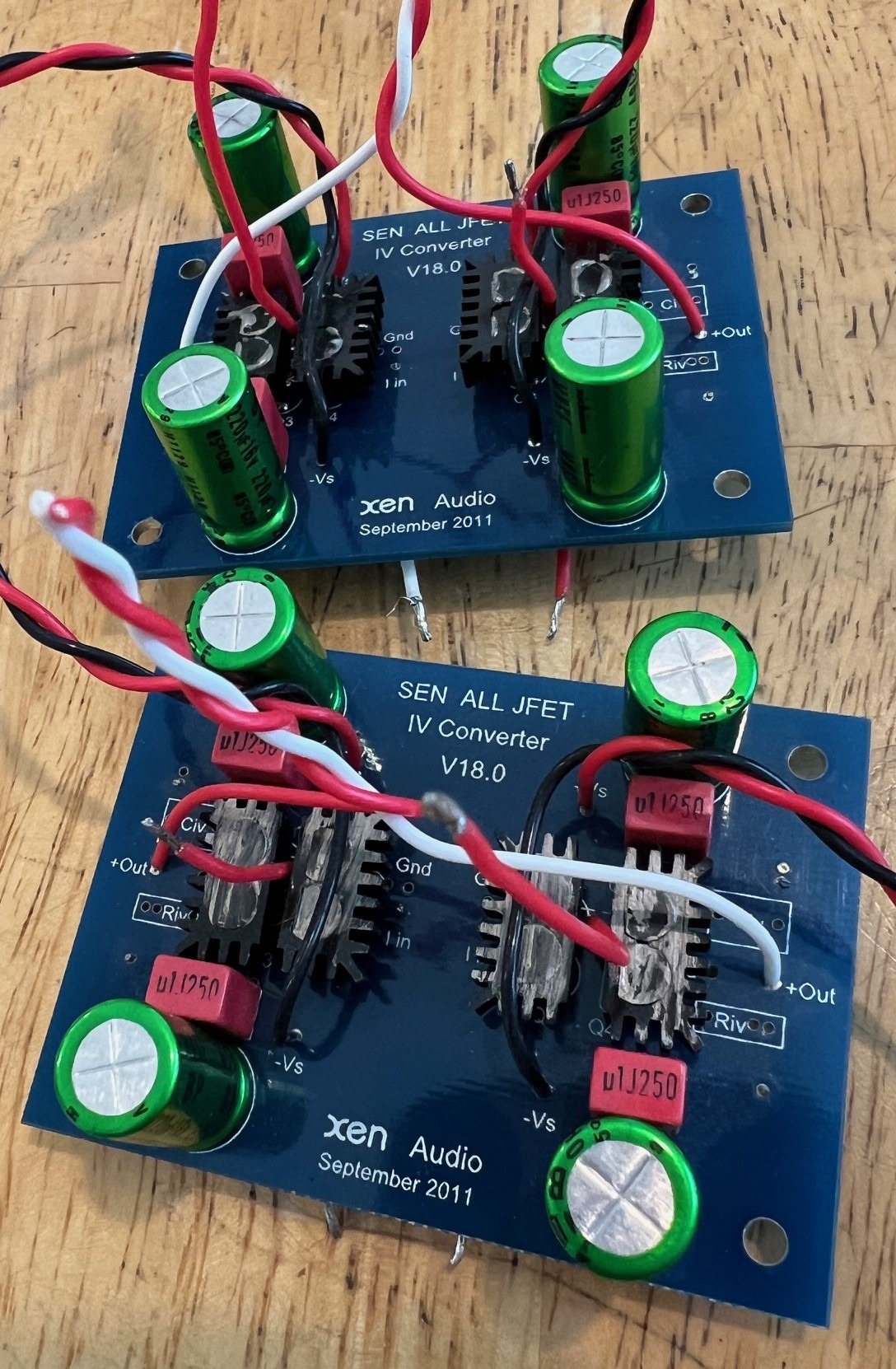

I’ve been using the current offset of the tda as a bias current for the output stage, as per Thorsten Loesch (Gomes stage topology). Don’t have measurements but sounds good…Guys, no comments on my idea of biasing the output from the filament 🙂 ?
Has anyone used a SEN IV stage in a balanced config for a dual mono or at best a dual mono with parallel a TDA1541A based DAC? I acquired this a few years back and did not use it. It was hooked up to a TPA Buffalo II so I have not yet checked if the component values are setup for that Vs the original schematic. It was wired for the RiV and Civ to be offboard up towards the XLR connector. I know one board fully populated will support one balanced channel. What I'm not sure of yet is
1. What are the values I need for RiV and Civ for a dual mono or at best a dual mono with parallel TDA1541A based DAC.
2. Do I need coupling caps after the IV output to block DC offset, if so what values? (I use a Sonic Frontiers Line 1 preamp)
3. What connections go where?

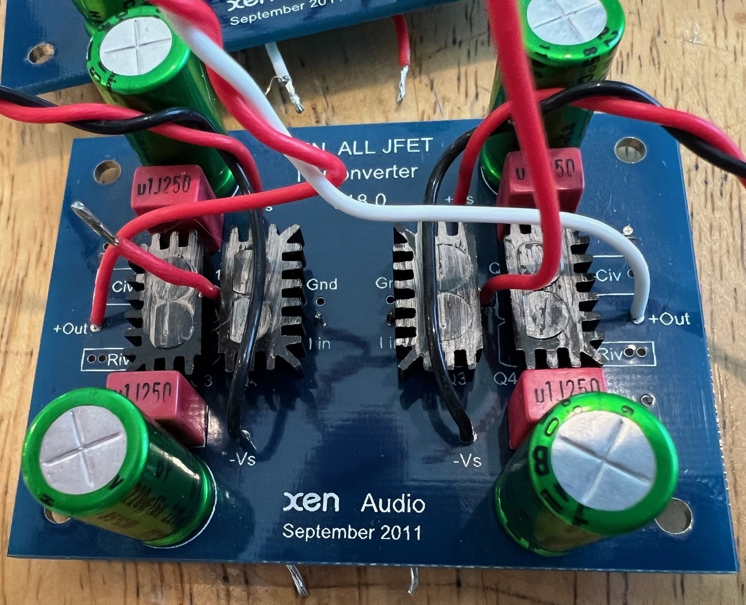

I have or will have two different ways to go with PCB's. I have @batteryman 's dual mono board to start (this has no output stage). I have also ordered four D3 boards from @ryanj (these have an output, but can be left unpopulated). The plan it to build each one and compare the dual mono setup. I'll setup a temp workboard so that I can just get it running then pick what sounds best in my system at that point. Amy help or insight would be great
When you say 'dual mono' do you mean balanced or just parallel? (balanced is best for common mode digital noise cancellation)
I used 4x 75r IV, no capacitor but balanced into Sowter IV transformers so the offset is not an issue.
