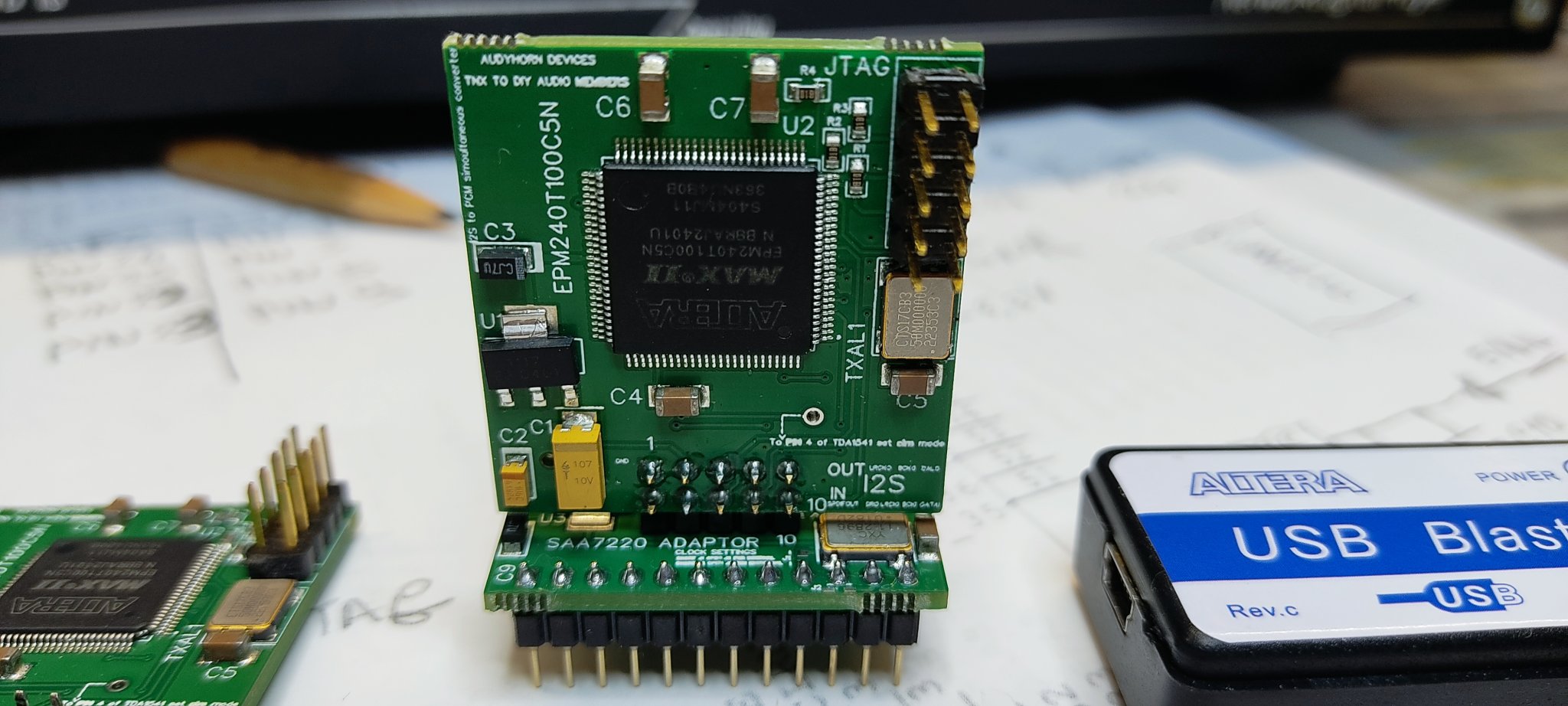

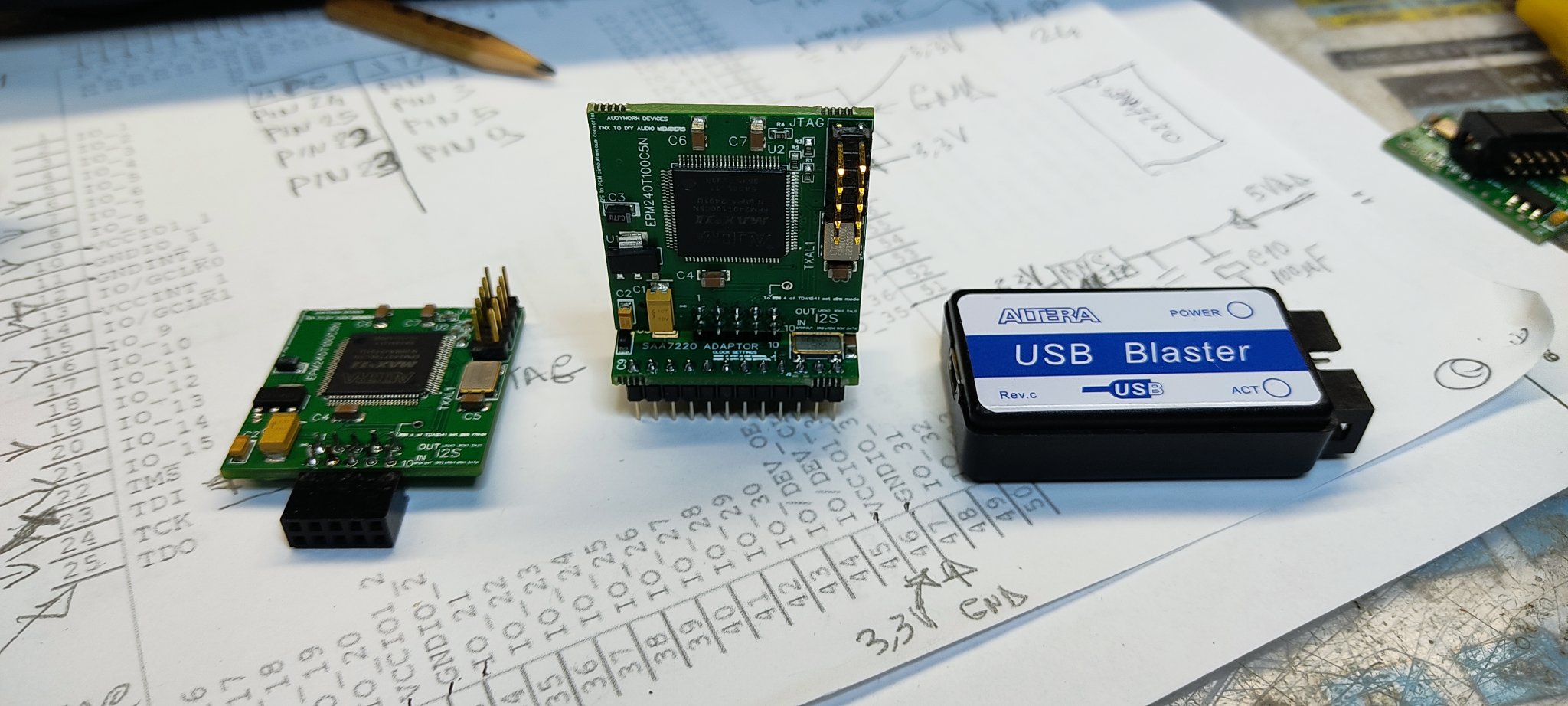

L'adattatore Saa7220 dovrebbe funzionare anche come sostituto semplicemente plug and play del filtro Saa7220 per una modalità NOS... Ha all'interno un orologio per la necessità di un lettore CD. Sarà solo necessario fare dei ponticelli su di esso ed eliminare la rete dell'orologio originale staccando alcuni cavi.

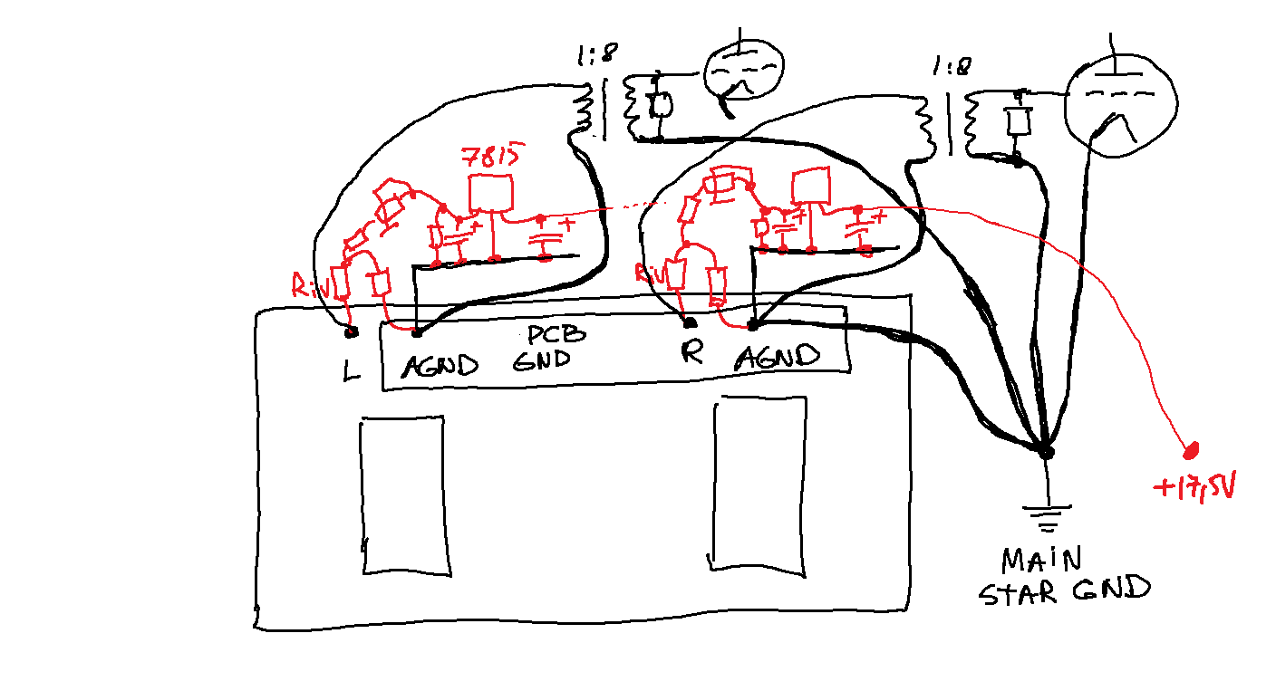

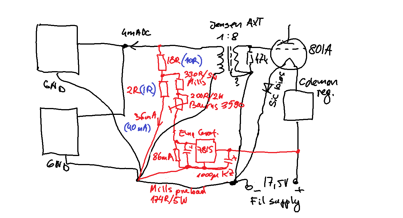

While waiting for my PCB's to arrive, here is take two on the filament bias of 2x1541A, taken from the 801A raw filament supply (L-input supply, RCR filter). The parts specified according to what I have/want. In particular, I want a wirewound Bourns 10x potentiometers. Costly item but they are close to the DAC outputs. I'm still trying to figure out if there is any dangerous loop/feedback formed here or not. Two versions of Riv calculated: 18R and 10R.
Ground routing is headache, trying to separate the signal and the 15V biasing supplies. Here is an idea, the worst is the link between the PCB GND and the main start GND of the whole assembly. It carries both the signal and the currents of the 7815's and the surrounding caps. But since the tubes are referenced to the main GND, I think the volatge drop on this link is out of the signal loop. Comments/criticism welcome 🙂

Look closer - 18R + 2R is the IV
Yes, someone did advise but I do not see much merit in having individual biasing at each chip if the outputs are connected together anyway as pointed out by dddac. If you have any arguments, I'd be happy to listen and consider.
It is not. It is injected, or actually the voltage offset, through the lower 2R resistor. It's John's (ecdesign) idea, which is supposed to be better than connecting the output to +5V pin via 2.2k resistor. Ideally, the +15V supply should be separate but in my situation (the 801A pre is assembled and running) I don't have extra place to make another supply, hence I'm trying to use the raw filament supply.
If you make measurement of your setup as it is once completed , and I am sure you will do and post , the distortion figure will tell more than I and dddac will do 😉
@fabrice63 you never really answered my question as to what biasing scheme you have (no idea why you are so cryptic about your design which you made with a big help of the community here). But looking at your PCB, it seems you have simply a multiturn pot to +5V, which you later supplemented with a diode. This is a different scheme than the one I'm considering so your observations may or may not apply here.
@batteryman Yes this is also an option but I have to contemplate which one better "screens off" the 7815 from the signal path. IIRC the R_pri of my SUT is 3,5R.
read post 8603
the schematic is not important here , if you don't want your build having a lot of distortions you MUST give every TDA output its own biasing circuit , it means two per chip or you follow the dddac instruction and you will see by yourself , I am trying to help not to bother 😎
my scheme is two 1 k multipot in series with two 2 k resistors , one for each output , take care in choosing your multipot and resistors the place is very sensitive
