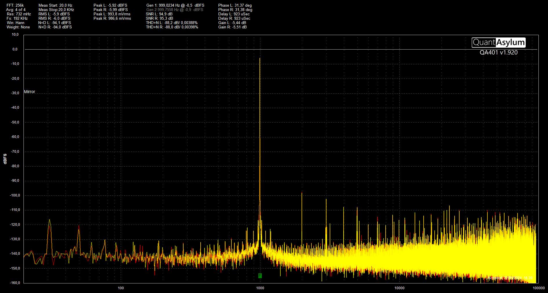

I set the I/V resistor at 50 ohms , it seems to me to be the sweet spot of it , here is the measurement :
trafo ratio is 1:18 , so chip output is 50 mv rms
the transparency of that DAC is amazing , voices and instruments plays like real , the stereo imaging is as wide as possible, tones are so subtils , the balance between low and high is perfect , nothing more nor less
it will be very hard to do any better in an passive setup as it is , with no filtering at all
it has been a great venture , thank's to John from EC-DESIGN in the first place who gave me the start with he's genius ideas , and all of those who cares 😎

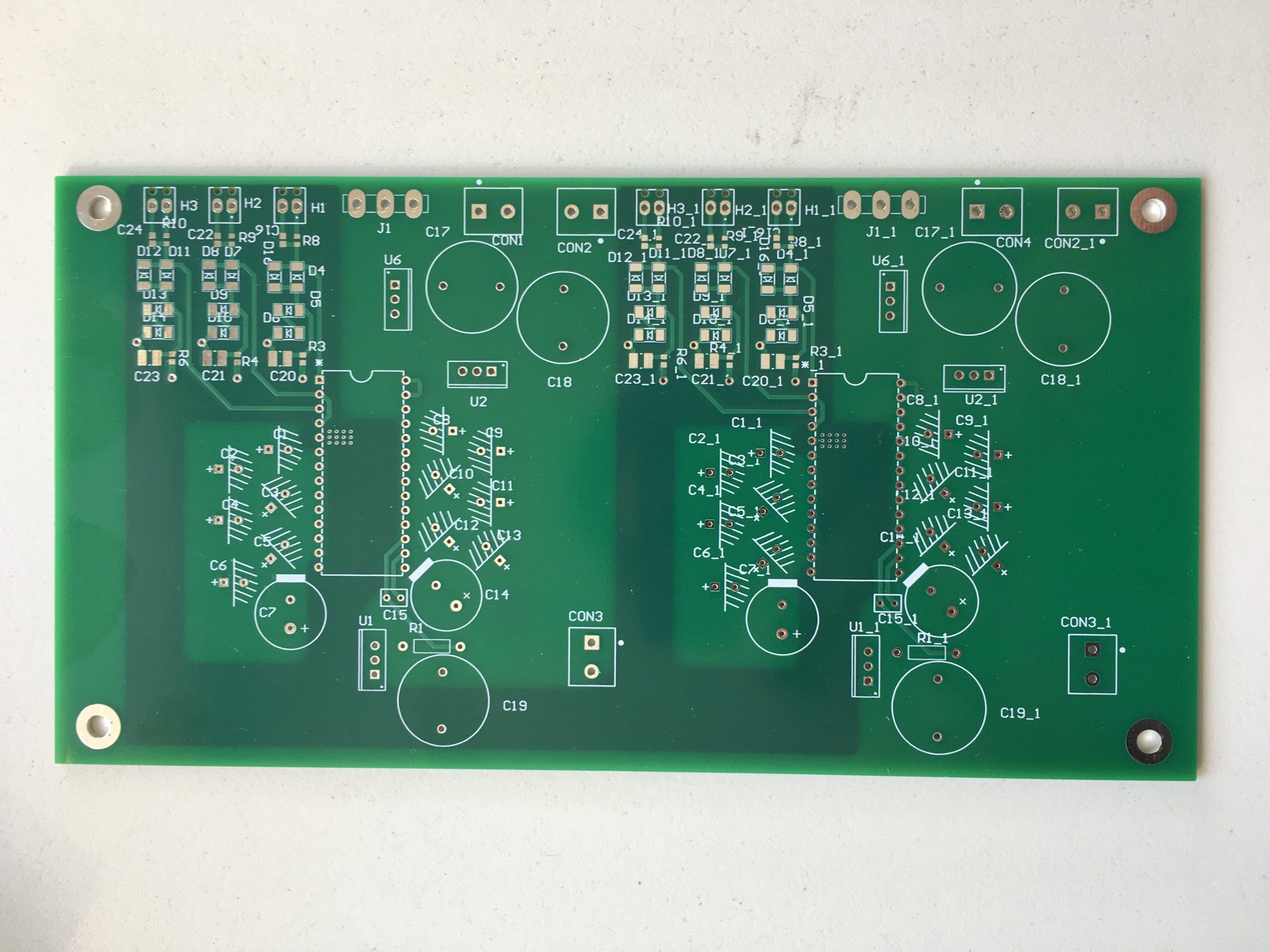

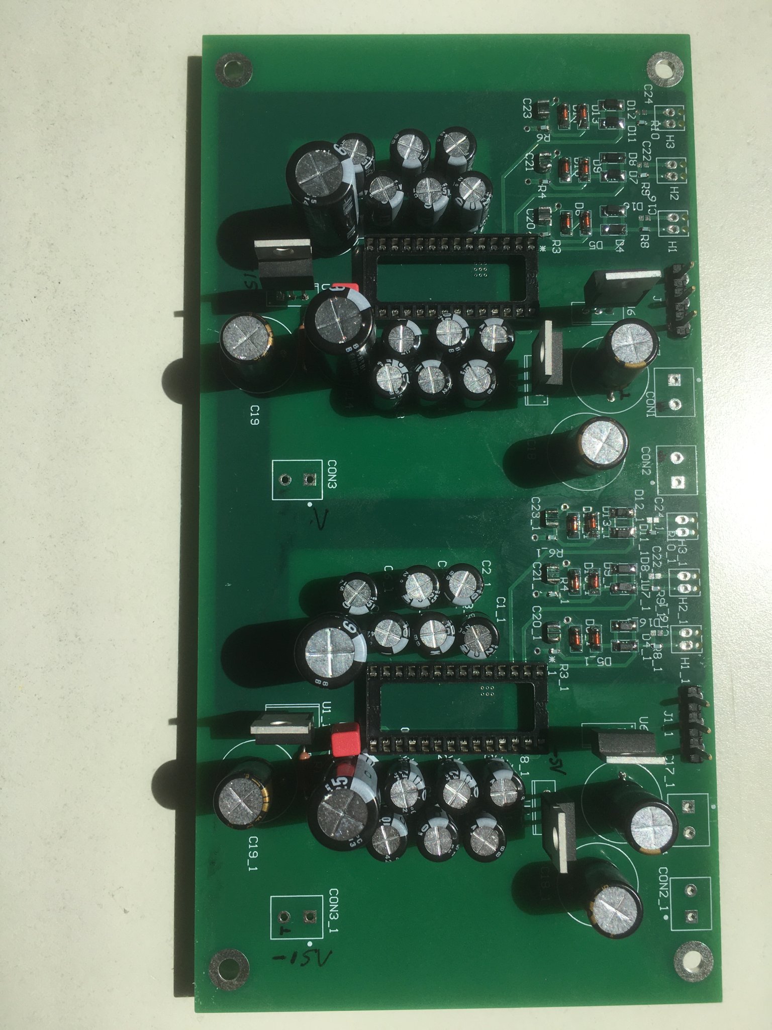

Board almost populated, few small parts left. Soldering SMT, esp 0603 form factor „partisan” way with normal iron was a darn challenge 😀
I wouldnt be an analogue guy without some point to point job 😉

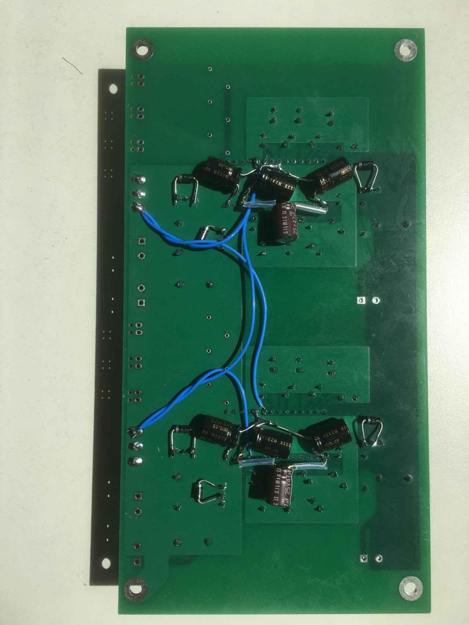

Decouplers - Nichicon KZ and Elna silmic ii between -5 and -15V. The i/v resistors plus biasing still missing

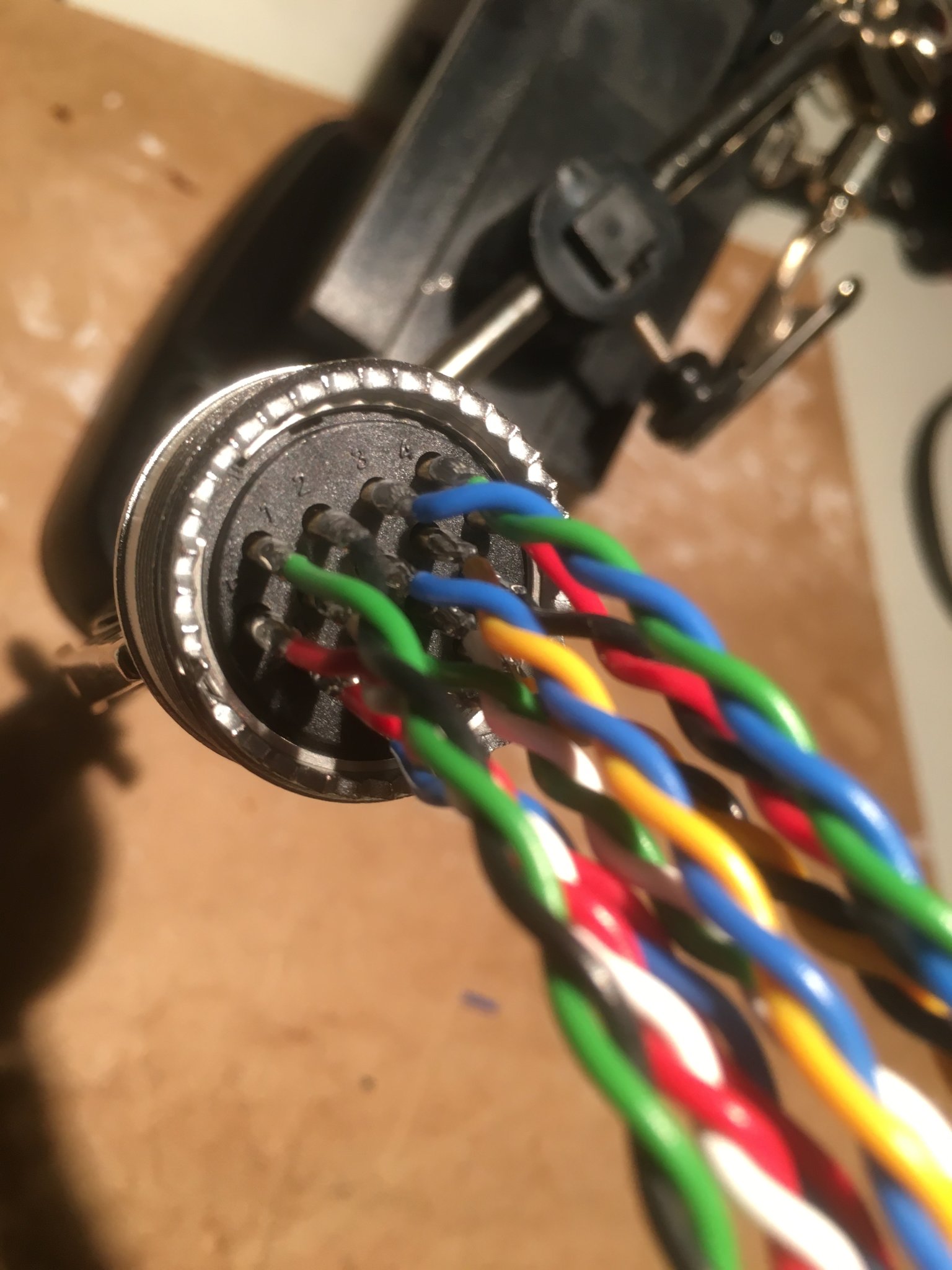

The most tedious part-16pin diy umbilical cable:

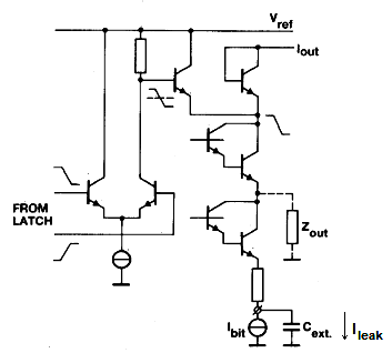

The basic idea I'll call "slow/DC Style". This is based on a few realisations.
1) The actual current sources that determine the output current of the DAC are formed by a (likely temperature compensated) Darlington cascode transistor, a resistor and the external DEEM capacitor. I bit does not determine the instantaneous current.
Image Credit Philips/MV-Audiolabs
The charge in the capacitor is the averaged bit current from the DEEM switching. SO AS LONG as the capacitance value is large enough to "hold" the average compared to current outflow, the circuit is completely self adjusting and accurate, but needs a number of cycles to get to a stable condition.
So small value capacitors need fast DEEM switching, large value capacitors allow slow DEEM switching. In fact, to quote a clear assertion by MVAL:
"If we connected [an] ideal capacitor having infinite capacitance and let it reach averaged voltage, DEM circuit could be stopped entirely!"
There is however a bit more to DEEM clock frequencies than meets the eye immediately. The DEEM circuit's switching frequency invariably "breaks through" into our audio output. You can see it at MVAL's site. The key "breakthrough" frequencies are actually Fdeem /2 & /4, not Fdeem itself.
Breakthrough is at low levels, but to reach reliable inaudibility, I think we require a DEEM frequency that fulfils the following strictures:
1) Fdeem must be either greater 20kHz x 4 (> 80kHz) or less than 20Hz x 2 (< 40Hz).
This ensures that the DEEM switching frequency subharmonic breakthrough ends up outside the audible range. Too low a frequency the DEEM switching becomes audible as low level tone! MVAL also observes that modulation at ~ 3-4Hz is most audible/objectionable giving a "wow & flutter" feel, so Fdeem/4 > 4Hz.

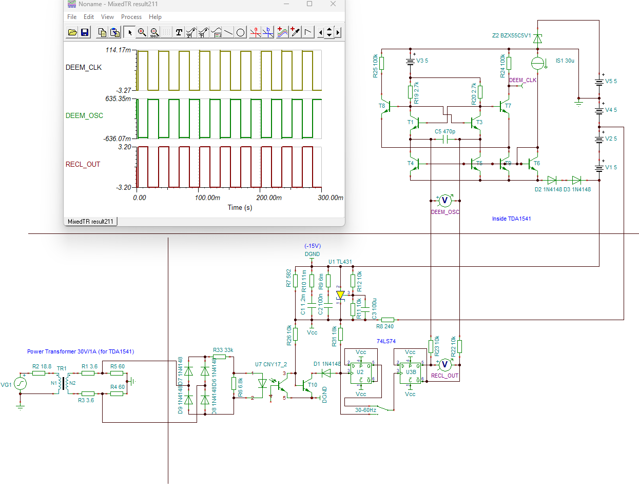

3) If using Fdeem < 40Hz interactions and interference with Fmains must be considered. Having a free running oscillator will cause beat notes with the mains frequency. In MVAL's example, if we have 50Hz and 48Hz we generate a 2Hz Beat note, the level of which depends on circuit linearity.
The likely best option is to synchronise with the mains frequency which itself has very good stability (otherwise the "grid" does not work, multiple generators must link together and must be frequency and phase-locked, or huge blind currents will flow causing breakers to trip). Generators weighting many tons and spining fast are very stable in terms of rotational speed.
It is easy to get frequencies of Fmains X 2 using a few diodes, an Optocoupler and an extra transistor to square the signal. Use any classic documented differential direct coupled DEEM injection. Maybe like so:
However we may still wish to fulfil the Fdeem < 40Hz stricture.

Let's look at this picture again:
Vref = +5V
So our output current flows towards +5V, because Philips, instead of making the DAC output balanced "wastes" the unused DAC current to +5V.
But where does all the current flowing in Cext come from? It comes from Ibit and Ibit comes from -15V. We can review this schematic, which is reverse engineered by a eastern european gentleman. Not 100% accurate, but it get's most things right.
First, the main output current loop is -15V to +5V. Preferaby we make one complete power supply, shunt regulated, tapped, making sure that no current escapes.
The signal current from AOL/AOR must return to +5V.
All DEEM logic current generation, analogue references exist between AGND and -15V ONLY.
HOWEVER DEEM decoupling capacitor current returns to -15V. If, because of vestigial "RF" design ideas we first return to AGND, we contaminate the reference pin. Hence the criticality often remarked of sending ALL DEEM capacitors returns ONLY to AGND and the critical decoupling to the -15V pin. If this is done correctly Kirchoffs laws makes sure AGND if the kelvin point, but really, the DEEM Pin currents need to go to -15V. So just connect them there!

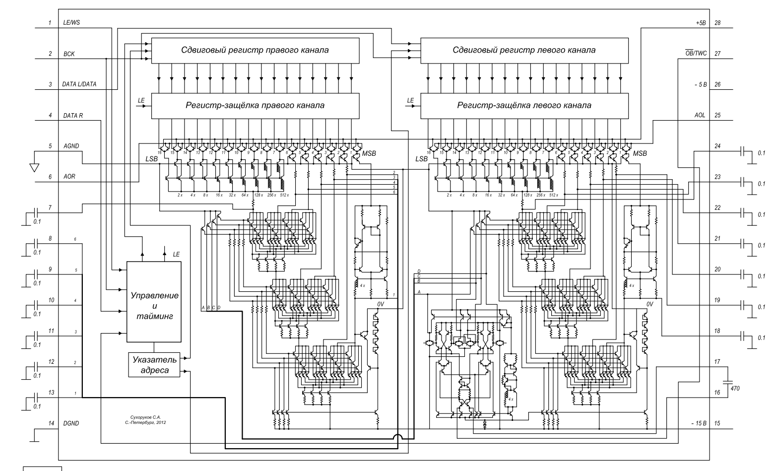

+5V (and -5V) are not purely digital pins. However the logic is described thusly by RJvdP:
"In the internal digital part a low-voltage swing unsaturated current-mode logic (CML) is used for speed and low-interference noise."
This means nothing saturates, everything is differential (non-standard ECL in effect) and we get very little logic noise, usually at 2 and higher harmonics (differential circuits in their linear operation). So the logic in use can get contaminated mainly from the digital inputs where logic can be saturated. We prevent this by applying signal conditioning to prevent that.

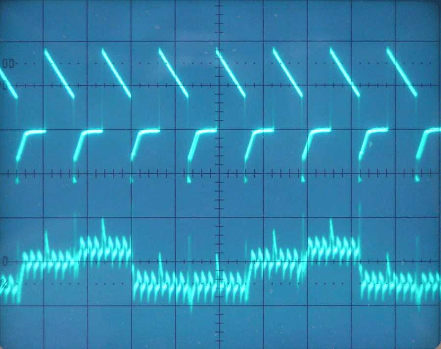

John Brown showed precisely what comes out of our DEEM decoupling PIN's. DEEM clock is 384kHz. There is digital feedthrough. But more crucially we see very narrow spikes each time DEEM switches. Noise on these pin's ranges from these narrow 10...20nS spikes caused by the DEEM logic switching (and this is not related to the DEEM frequency, only to the transistors switching speed) to the bit clock and other glitches at every 8th bit clock.
That's pretty broadband and above what our big electrolytics can handle. So we need a -15V plane under the TDA1541 to which we can return this noise using our usual film/ceramic/whatever capacitors. An AGND plane should be below the -15V plane and should also have similar decoupling between AGND & -15V (priority decoupling for high frequencies).
