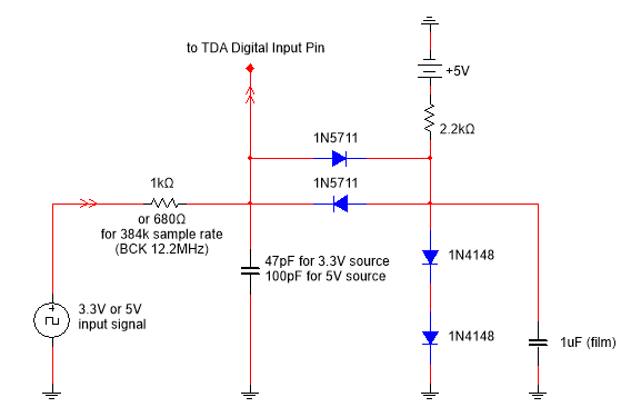

In the parallel topology, what is the optimal way to use the I2S attenuators? I plan to use the MVLabs circuits (below), which I assumed individually for each chip (so 6 attenuators in total). The driving chip (CS8414) will see them in parallel on each of the 3 I2S lines. Is that a right use, anybody knows?

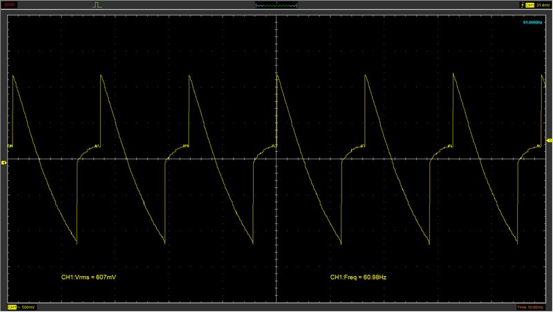

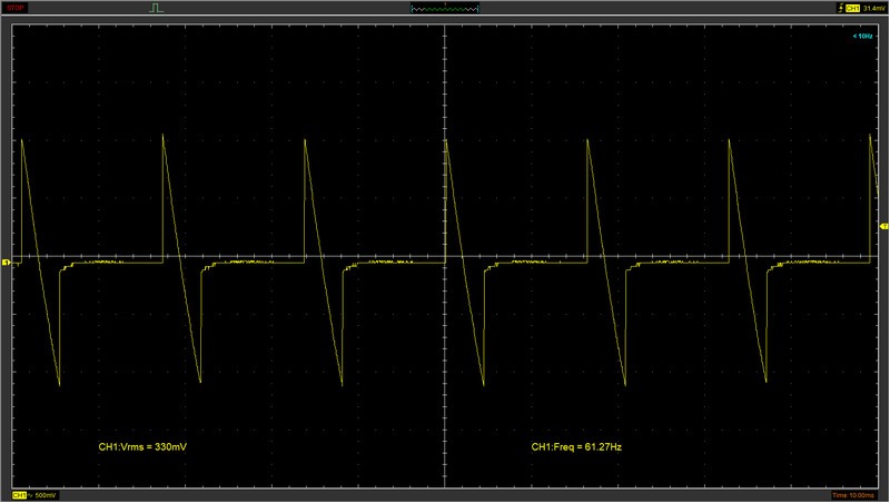

For those who like to know/see what the dem signal look's like at the scope , here it is :
seems that the frequency is not 50Hz but 61 ish Hz
at pin 16
at pin 17

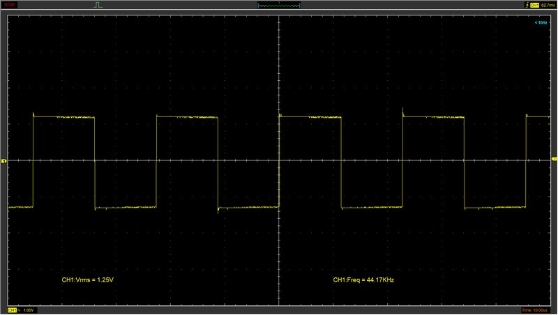

and this is LE at the TDA's pin while the DAC is running , nice and straight 🙂 :
In the parallel topology, what is the optimal way to use the I2S attenuators? I plan to use the MVLabs circuits (below), which I assumed individually for each chip (so 6 attenuators in total). The driving chip (CS8414) will see them in parallel on each of the 3 I2S lines. Is that a right use, anybody knows?View attachment 1310416
One thing that comes to my mind is to decrease the input C by half and increase the input R by 2x in order to keep the RC constant seen by the driving chip the same for parallel connected 1541A.

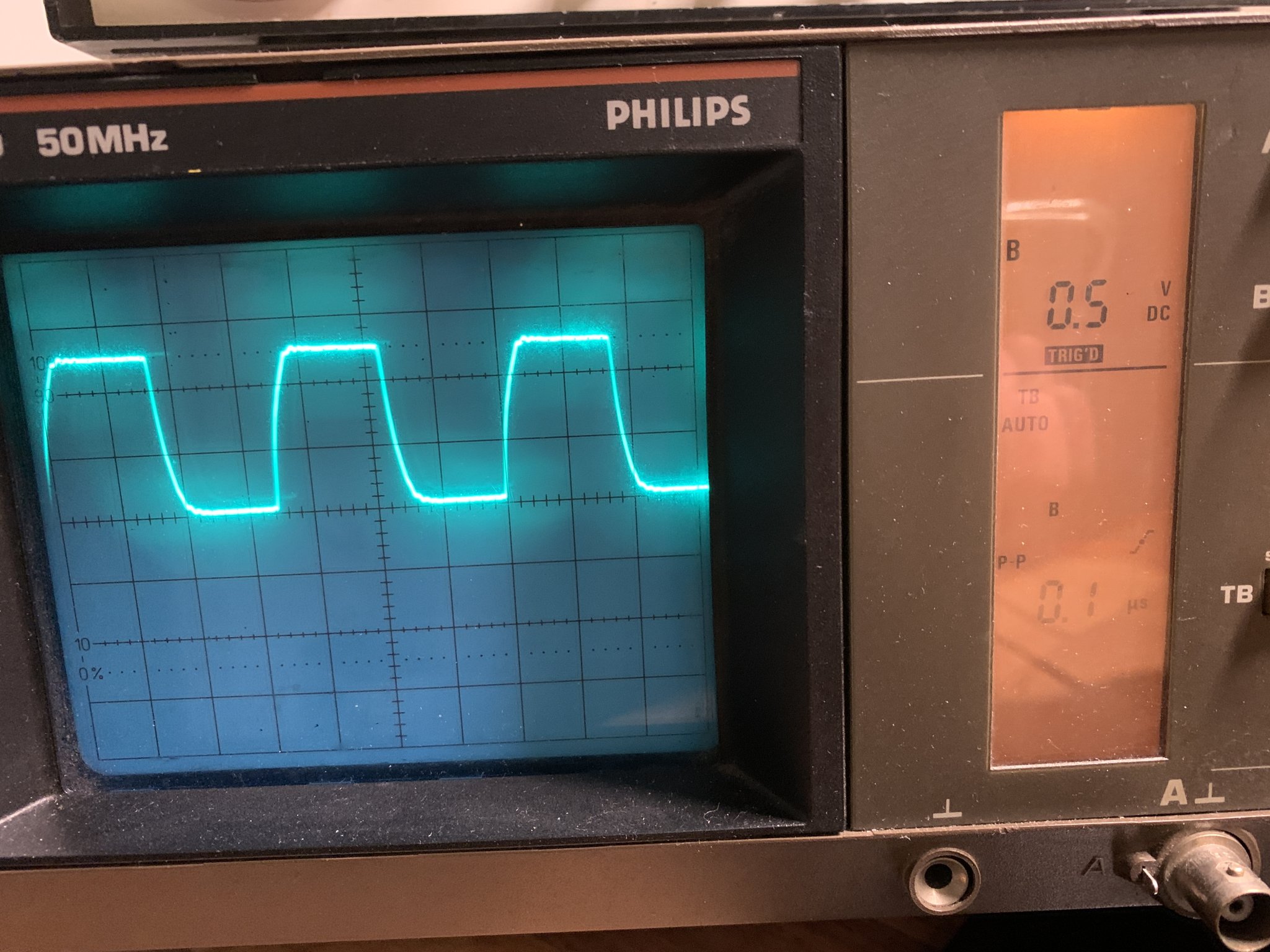

Does anybody have a scope picture of a ‘broken DEM’? I’m getting severe distortion on the output
suspects:
DEM (running at about 666khz), but the trace looks fine as far as I can recall what a normal DEM trace should look like. Also looks like the trace posted above.
Or too much attenuated BCK signal, but I don’t really understand why this would lead to sound but heavily distorted (would expect no sound at all). Attached image is pin 2…
The source is a squeezebox hooked up via i2s - it used to work but now doesnt... I verified and the SB is still working through its analog out, so the i2s data logic is not the problem. The TDA is also still fine (at least I swapped with a second one which shows the same problem)...
direct wire, 10cm long.
BCK gets injected into the SB from a master clock.
Data/WS are retrieved from the SB.
Interestingly I had a similar problem 10 years ago (documented in this thread in 2012), which turned out to be over-attenuation of the i2s signals. I've now re-measured and upped the BCK signal to approx 5Vpp, to no avail unfortunately. Getting noise/distortion (can't hear music really).
I'm quite at a loss as to how this happened suddenly... supply voltages are ok, i2s signals seem ok (can't verify if the logic is correct). Will probe around some more and maybe bypass all the gimmicks in reclocking and signal conditioning and see what happen..
