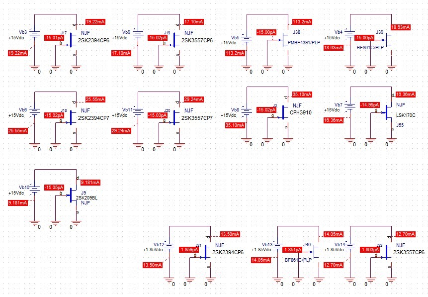

I spot something that might be of help. The lower JFET in the tube cathode is incrementing almost the exact about 13.5mA of current.
In reality J-Fets Idss varies from sample to sample. 2SK2394 is rated as 10mA - 20mA.
As HD depends on Transconductance, adding a P-Channel FET in a compound feedback pair would do more for less Iq than parallel J-Fets.
Then adding a folded cascode....

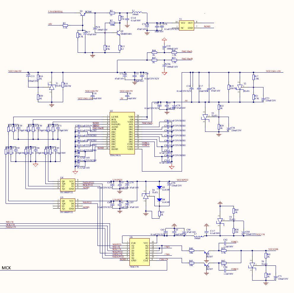

I see everyone here in topic prefers simultaneous instead of i2s. And yours is i2s, have you changed your mind about that over the years?
It was never tried. However given how the logic in TDA1541 works, I do not see any mechanism that would create a benefit, IF the inputs do not saturate. But I also see no drawbacks from simultaneous mode.
Logic part of the circuit is very simple in your schematic, i like it a lot for that, so i'd follow it to the letter, and since there is no output part, i'll leave that for experimentation as addon board. I'd only use usb input, so jlsounds i2soverusb board, clocks are on it, so difference would be to connect tda osc pins with appropriate cap value.
The AMR Circuit has a MCK input, it's marked CLK/174:
It reclocks all signals. There are also other clocks derived via CPLD (not shown) that are supplied, 174/6 & 174/3. These depended on sample rate, as the original design included Non-OS and 2X & 4X Oversampling.
174/3 & 174/6 are the TDA1541 DEM Clock and need to be opposite polarity, you pick the actual speed.
I would nowadays replace the 174 with a 574, it's "flow-through" layout if easier to implement a nice layout.

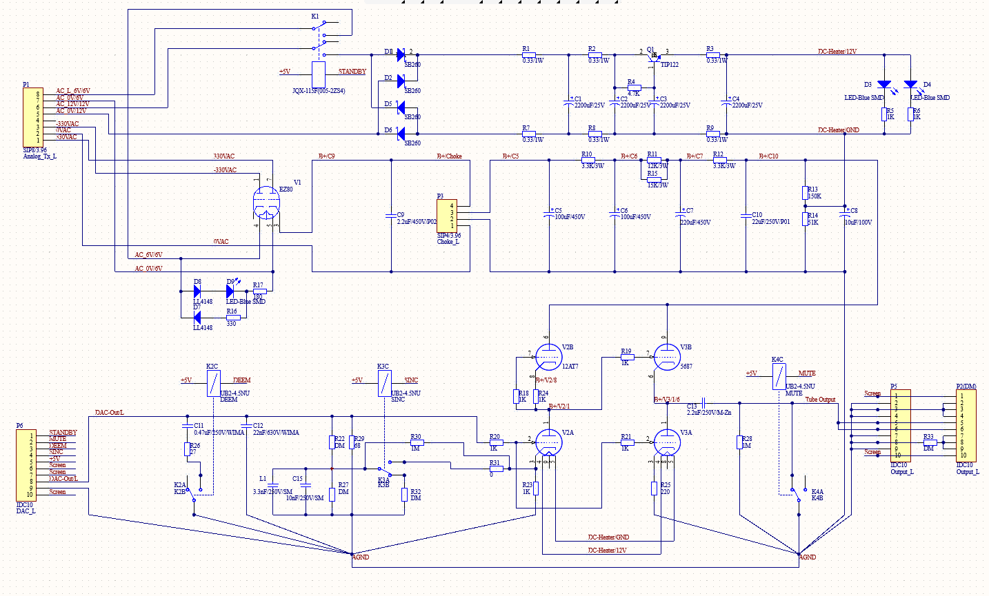

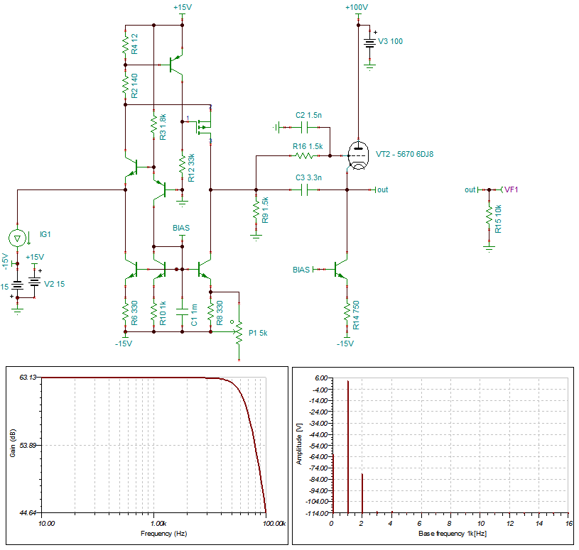

The Analogue Stage looked like this:
The 12AT7 is really a standin for 6072A, but these are too rare NOS to use in production.

Yes off course, I will check what Idss is for specific fatory spice model.In reality J-Fets Idss varies from sample to sample. 2SK2394 is rated as 10mA - 20mA.
But I am think that is more than 15mA? I will report that.
OK I can add folded cascode branch, but that will made topology a bit more complex, sure it will be interesting to have a look at these sims 🙂

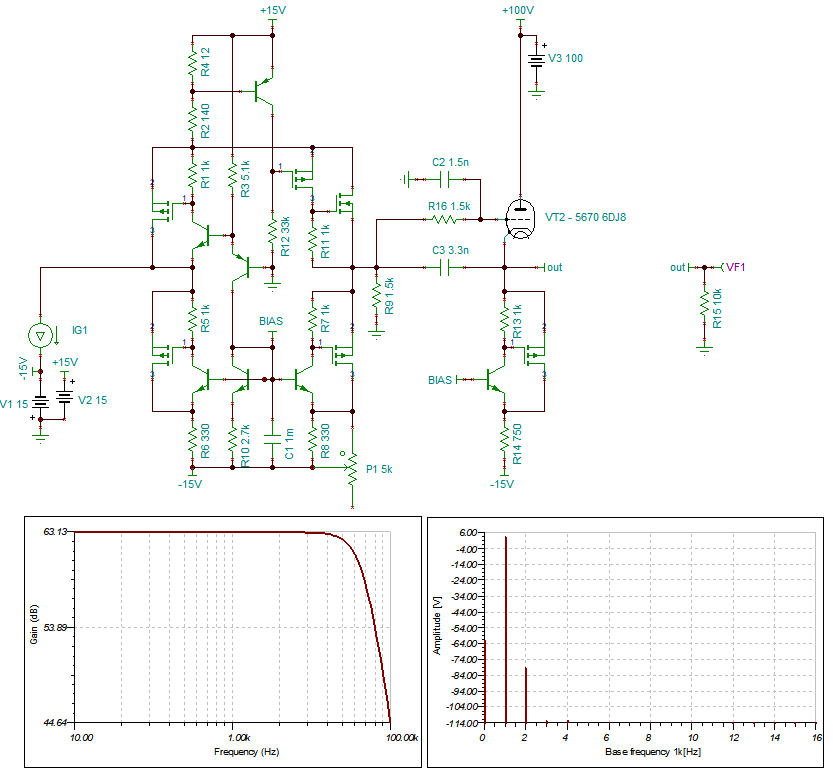

PS, filter is dimensioned for SAA7220B/C digital filter, tube buffer into 10k significantly increases H2 (over a J-MOS Sziklai) and instead of the adjustable resistor it really needs a servo, intentionally omitted, as are the active part numbers, they are not exotic, but all SMT.
SNR simulates 100dB unweighted.

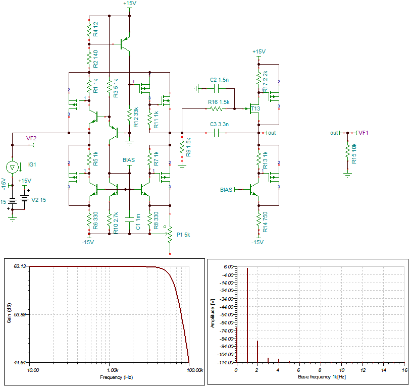

I put togrther some less complex circuit, single ended without complementary parts, but (at least) on the paper, is interesting to try?

Sure. Anything is interesting to try. For comparison, without Sziklai HD is up a lot:
With J-MOS Sziklai Buffer instead of Tube, HD is down with H2 below -90dB:

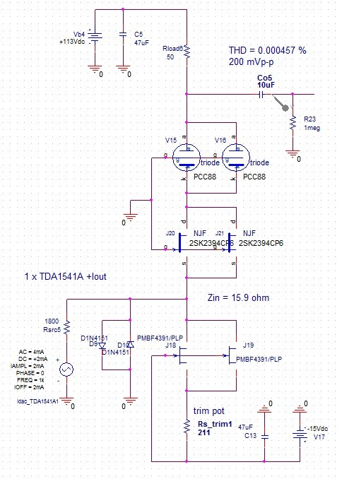

First some for IMHO optimum SE (JFET-Tube), with very low distortion, low output res, medium input res. But with "natural" harmonics transfer 🙂
I put the PCC88 but it could be ECC88 and every other same type.
On the pic is for 200mVp-p as source for additional tube amplifing section and back the phase to 0deg.
One interesting simple all jfet topology. With only 2 types of jfes in existing production. Again very good to excellent harmonics transfer and huge noise floor.
(Power for all devices is almost equally distributed so there is no overheating.)
Power supplies are +- 15V already present in TDA1541A...
With 4 times paralleled jfets in cascode modules, Zin is about 6.8ohms.
It is not sa problem to set 0mV Io input to dac at least in PSpice...
Zeners could be repaced with LEDs or Rs or something else...
Circuit behaves more less the same with 500 RIV for 2Vp-p output, only some voltage points should be corrected without much effort... 🙂

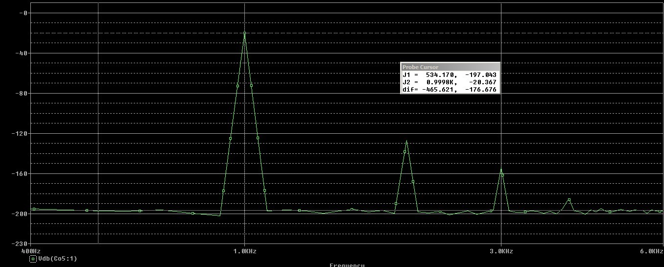

This FFT is from 10ms durtion and 0.1us step. Previous was with same dur. BUT with 1us step
I will post the version with a tube END biased from -15V power branch.
I used 1619 tube.
