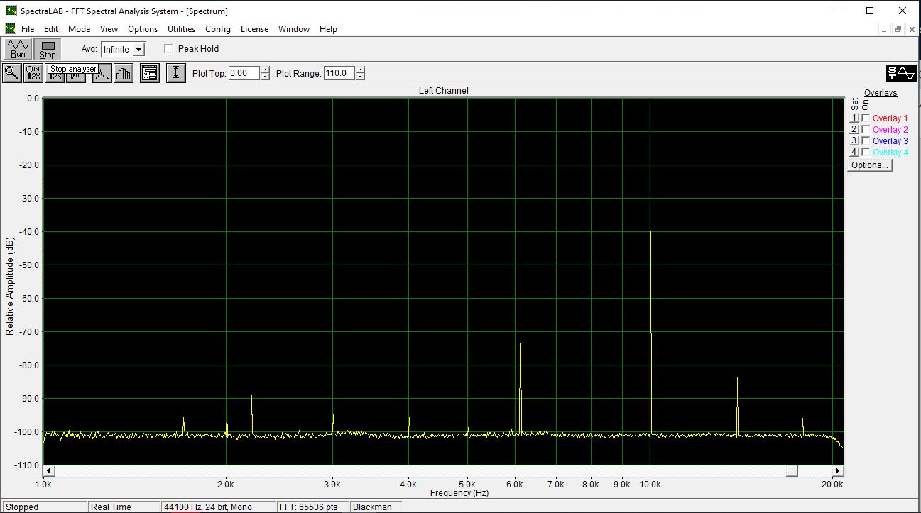

Nasty things come at higher frequencies, but there is no analog reconstruction filter at the DAC output. 6kHz -20dBfs, 10kHz -40dBfs, 10kHz -60dBfs.
Sorry guys, attached is the correct 10kHz -40dBfs spectrum, apologies for the mistake.

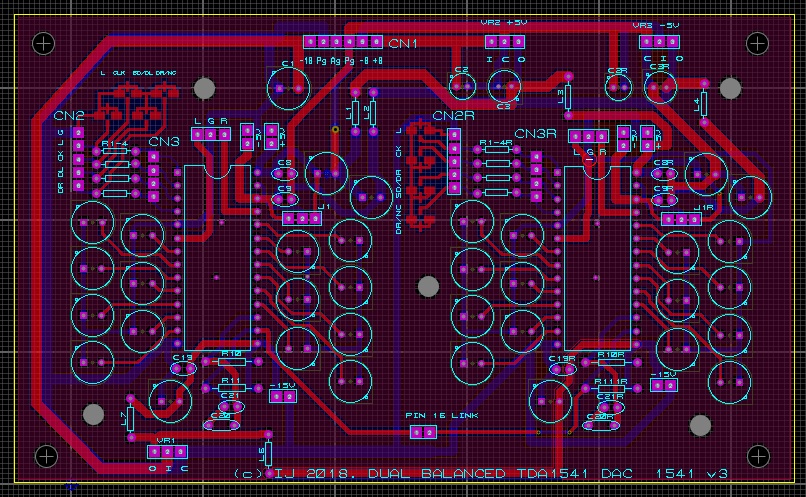

UPDATED DUAL TDA1541A PCB
I have almost finished the few modifications to my original pcb with the following changes:
NO SMD PARTS except the optional UFL sockets.
Jumpers to change from TWC to Simultaneous mode.
Pins for connecting battery power to each dac power pin directly.
Stacking of the boards with the upper pcb being the 'master' supplying data and power inputs, and signal outputs linked by long pin strips and sil sockets on the underside. (may be useful for a balanced ECD Signed Binary configuration)
U.FL pads added for direct connection to data source eg IanCanada's I2S-PCM board.
-15V regulator moved closer to the dac pin.
You can of course use external power by linking the in and out pads of the regulators.
Jumper to link pin 16's of the Dacs'
Low frequency dem clocking (with ECD's permission.) designed for 3.5mm pitch Nichicon UFL very low leakage capacitors.
Provision for small inductor, ferrite bead or low value resistor (10r) in the supply to each power pin.
Provision for low value resistor (eg 33r) in the data lines .
The dacs are separate and do not share data lines and there is no on board I/V.
Board size is 150 x 90mm 1.6mm FR4
Available in about 3 - 4weeks Please pm if interested and I will post a group buy. Price will be my cost price + postage & packing.

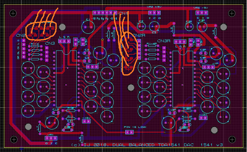

Hi Batteryman,
Looks good. I could use it for my I2S board
A few comment if I may:
It could be hard to the to the DA SD UFLs at CN2R between the caps.
It would be easier for interconnection to have all UFL's in line parallel to the top or bottom edge
Hi Batteryman,
I will look into that, but best to fit the UFL connectors first.
