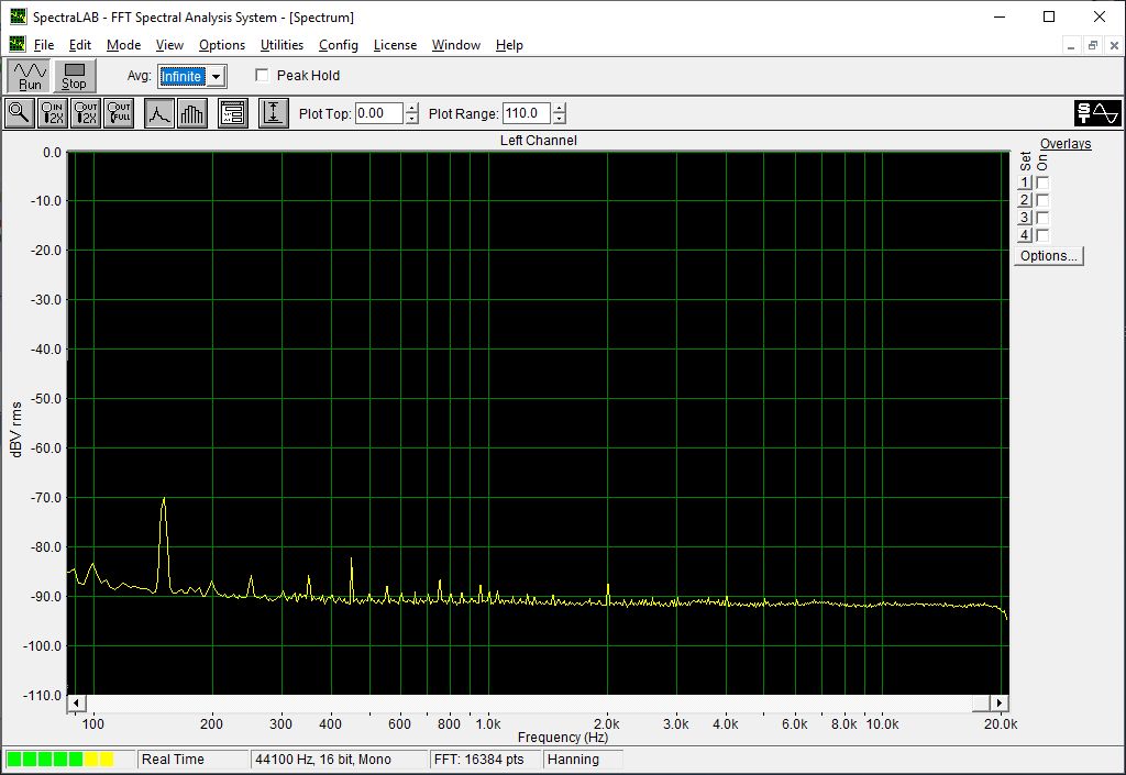

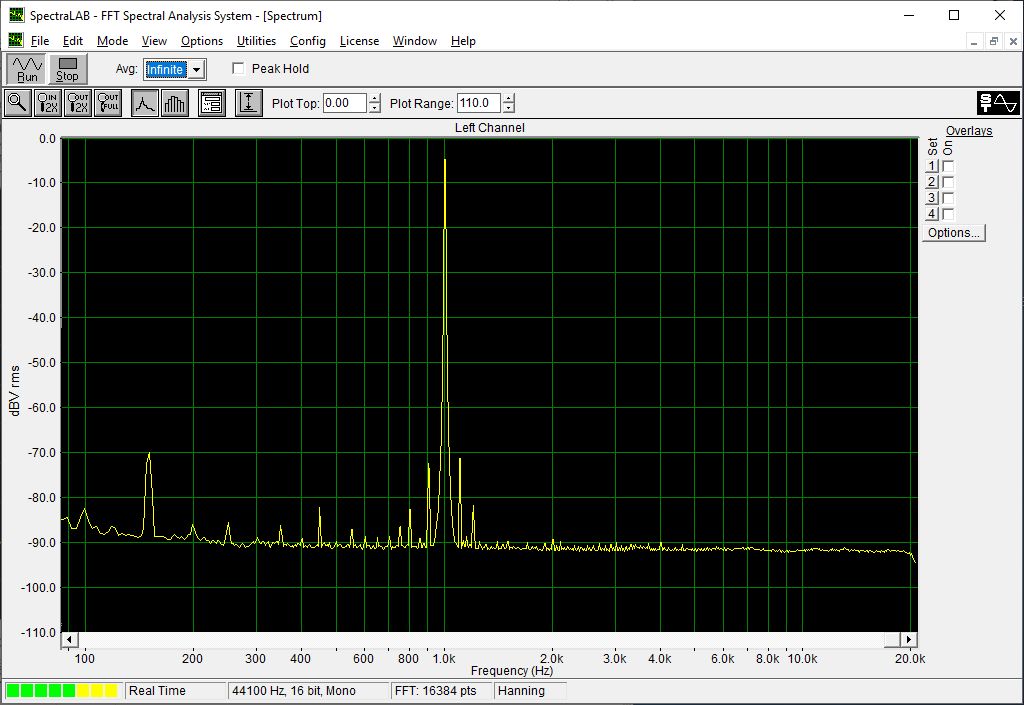

Spurious peaks were caused by some earth loop (same computer was used for signal out and signal in on two different USB interfaces). Attached is the baseline and 1kHz 0dB with separate PCs (analyzer not calibrated). Overtones disappeared, but I can't go below -90dB noise floor.

-90db is low enough surely? Are you in an anechoic chamber!
The background noise in my listening room is about 30 and normal listening volume is about 90, and maybe 100db on peaks so I wouldn't notice if my snr was better than about 75db. (unless I was using headphones)

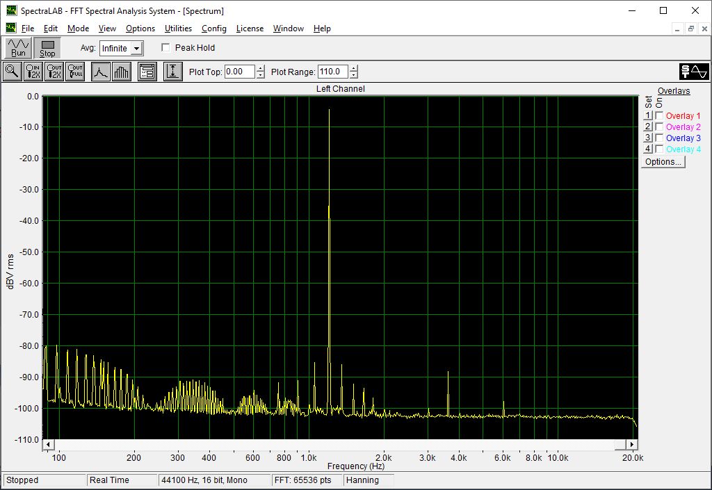

This is the best I could do with REW Generator 1200Hz -3.0dBFS RMS dithered signal. FFT size 65536, Hanning, infinite average. 3rd harmonic is -84dB.
100Hz anomalies and sidebands are probably due to ground loop or soundcard.

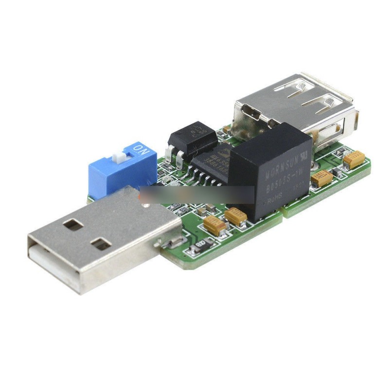

Spurious peaks were caused by some earth loop (same computer was used for signal out and signal in on two different USB interfaces). .
A good USB interface, like that ADUM4160 isolator, not only serves for listening but also for other critical data handling in USB devices. Not perfect but better than nothing.

Thanks for the hint, I ordered one. I will report on the results.
You're welcome. 🙂
As I like to complicate my-self, I ordered years ago several PCBs from this gentleman:
https://www.circuitsathome.com/adum4160-usb-isolator-assembly-guide/
This allows to configure it as you please and try different flavors of VRegs. 😉
As I said, not perfect but much better than direct USB connection soundwise, save if you have a Mosaic DAC, hehe.
I have not used it for other tasks, though. I forgot to mention that there might be speed issues, depending on the task. Look for high speed transmission compliant devices.
Best wishes,
M.
I have an ADUM160N 6channel isolator and some soic to dip adaptor pcbs so I can try it between the ebay usb-i2s interface and the I2S input on IanCanada's FifoII.
I have also decided I prefer the sound with the transformer primary centre tap disconnected instead of to either ground or having current fed in to cancel the dac's output offset.
