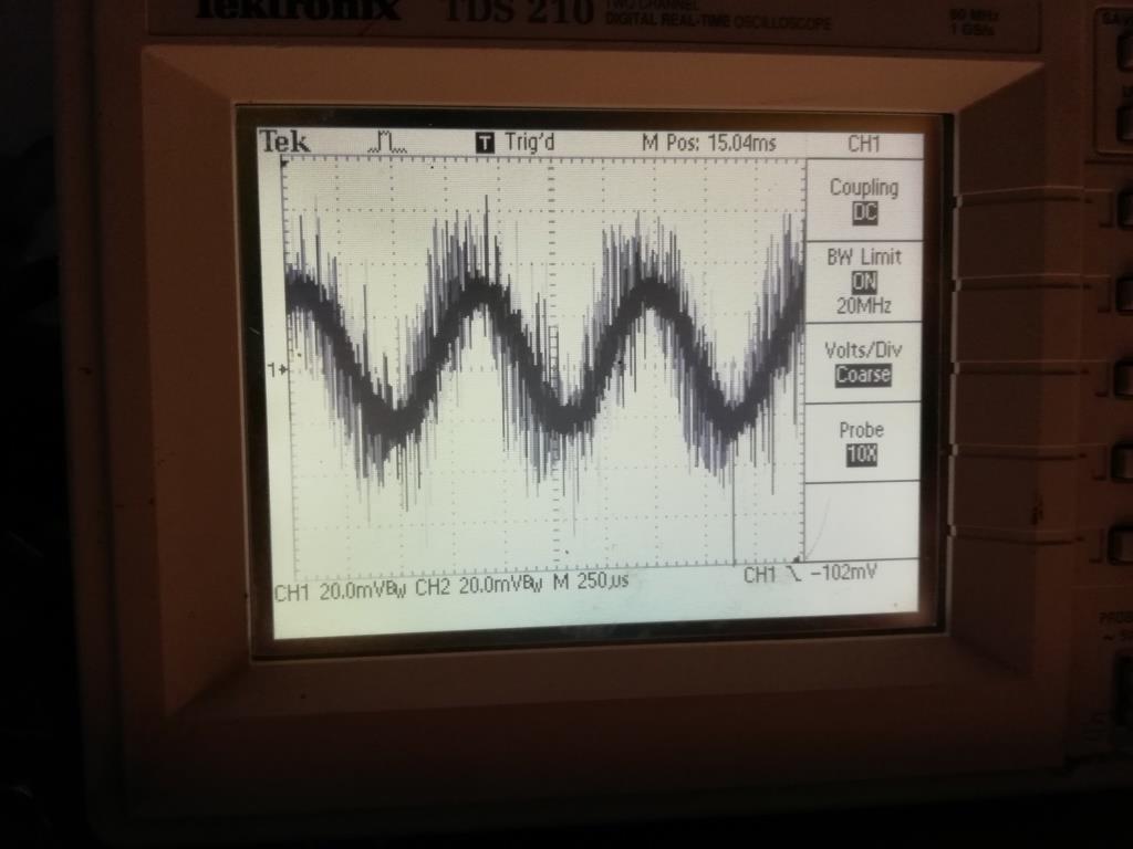

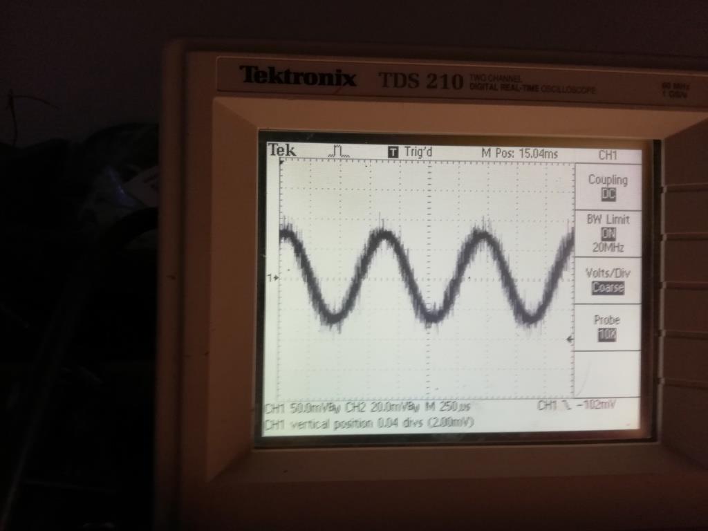

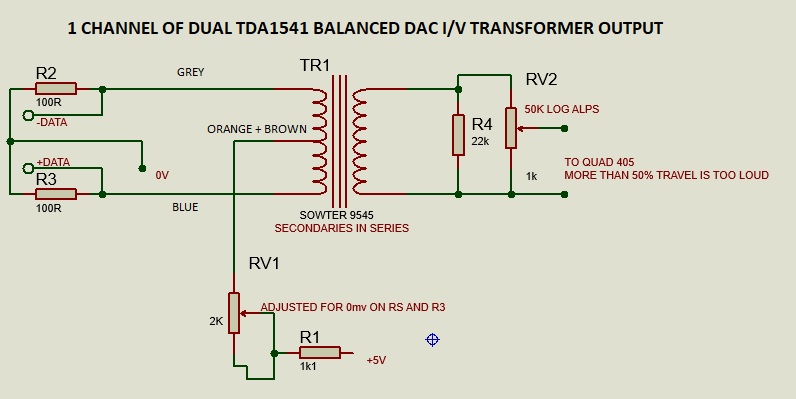

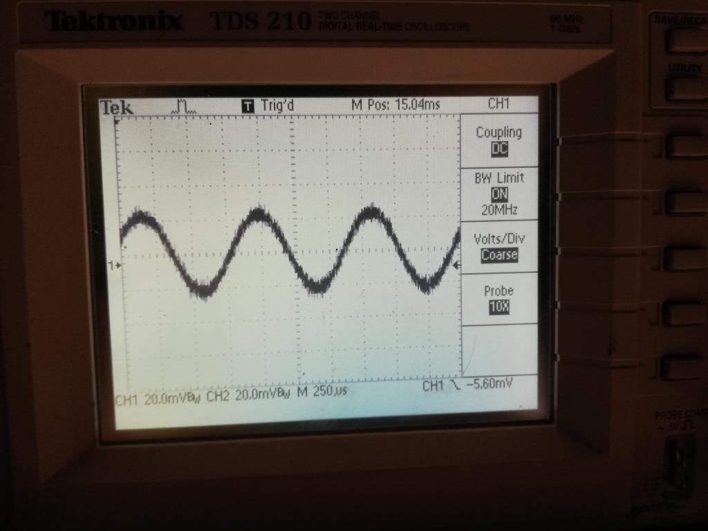

Latest I/V output
I connected the centre tap to +5 through a 1k resistor and 2k preset and adjusted this so the voltage across the 100R I/V resistors was 0.0mv.
I must say the sq is hard to fault - solid and deep bass - any more would be overpowering in my small listening space.
The treble is equally good with no harshness, grain, glare or excessive brightness.
Overall totally untiring to listen to my 'test' CDs (and odd mixture of 'blasts from my past' - Chris Rea 'Road to Hell', Waterboys 'Fishermans Blues', Mussorgsky 'Pictures at an Exhibition', various Handel, Alison Balsom - 'Sound the Trumpet')
I also retired my Martin Logan Aeons as they are about 13years old and need new electrostatic panels at a cost of over £2000. They were replaced warily with a pair of Yamaha NSF51 floor standers which had received excellent Amazon reviews. I was very surprised how tonally similar they are to the Aeons and free from the expected boom boxiness. Imaging isn't as three dimensional but is still excellent. Overall a bargain for £189.
Tomorrow I will connect up the sig gen and scope....

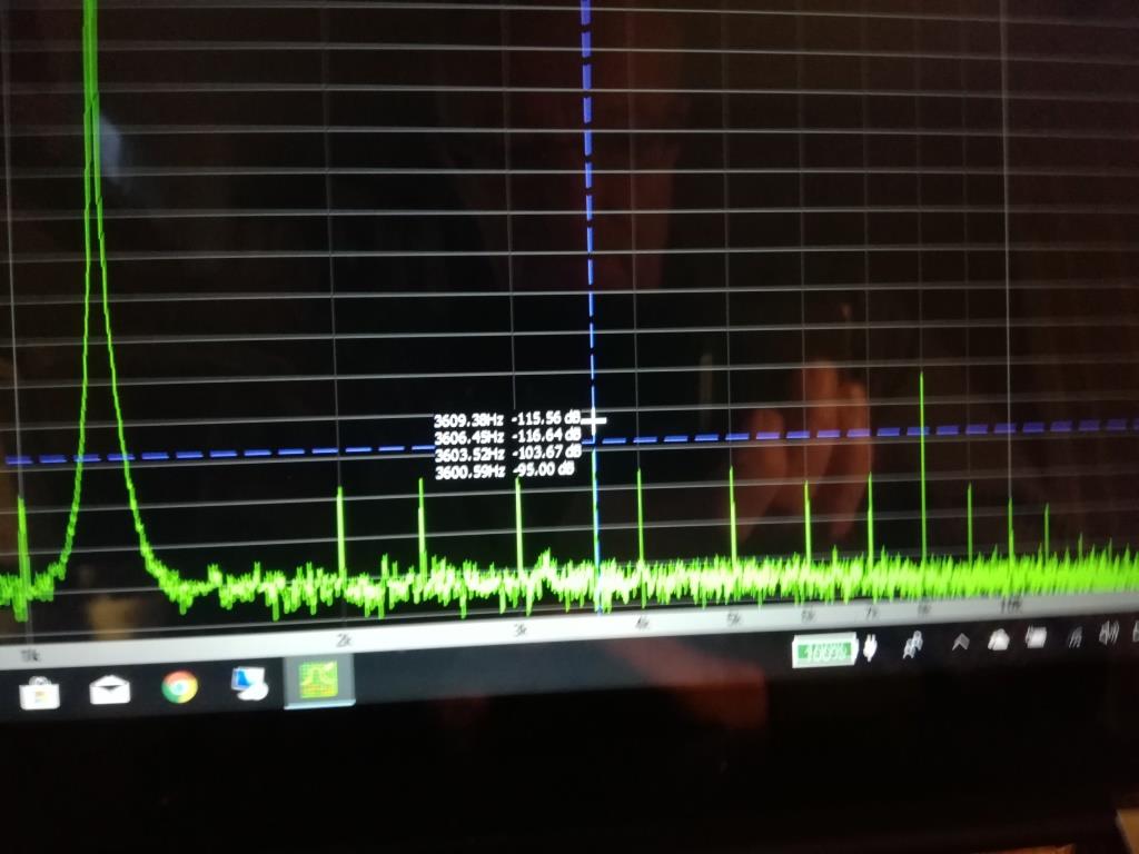

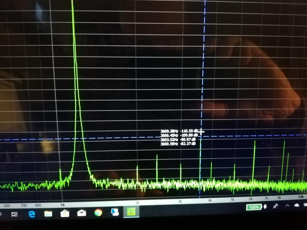

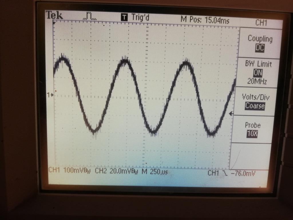

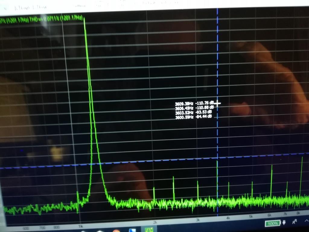

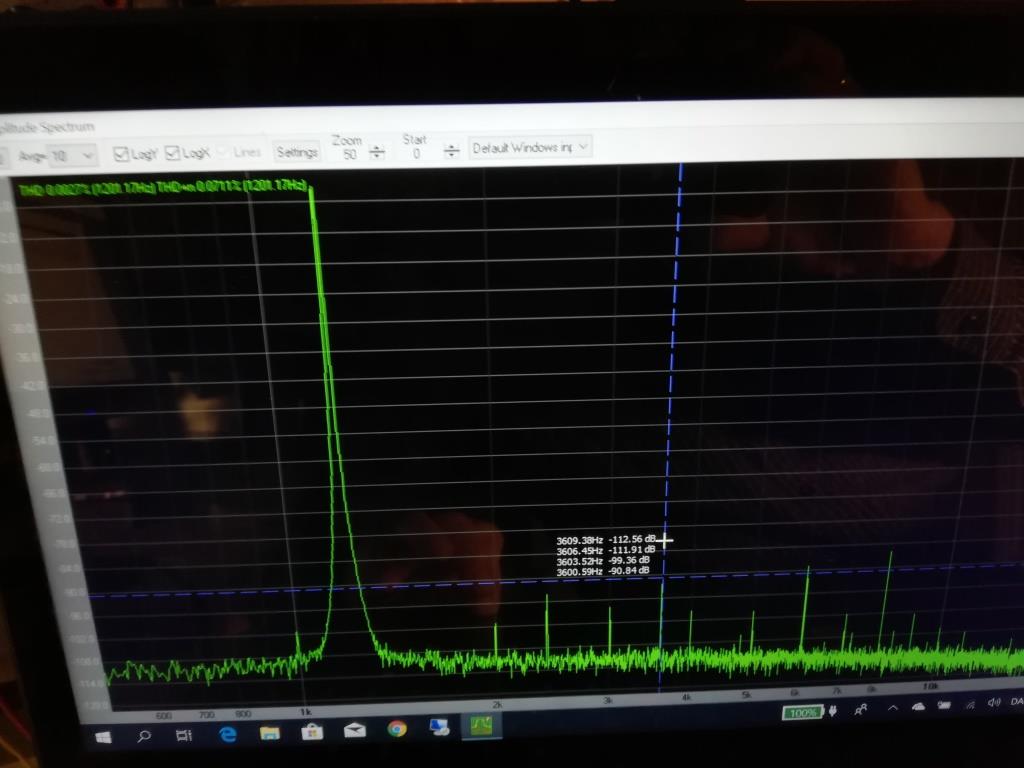

Has anyone been able to measure the distortion caused by not meeting the + -25mv specification?
I must say that my dac is sounding better than its ever done since I fed in a current to the CT and adjusted it to 0mv at the dac output pins. I'm sure it also sounds maybe 3db louder which could be due to ALL the dac current flowing into the transformer instead of some going through the I/V resistor? (which are still connected)
However I was looking at the spectrum of a 1Khz sine wave at -10db (as used on previous testing) and there was no 2nd or 3rd harmonics visible and distortion was around as low (.2%) as grounding the CT, but there were two significant spurious non harmonic spikes at about 5.6K and 8.5Khz @-40db which were not present before. I haven't yet investigated what has caused them. They did not seem to be amplitude related and there are no switching spikes on the signal - its completely clean.

Yes even with +/- 100 mV pr. tda1541 the biggest harmonic (third) is more than 87 dB down (1,2 Khz 0dB digital). 2. harmonic is even lower.Has anyone been able to measure the distortion caused by not meeting the + -25mv specification?
If you lower the output (reduce the I/V resistor) you get even better 3. harmonic (< 95 dB) , but John says the perceived sound quality is worse. He actually started out with saying that you had to obey the +/-25 mV compliance and used OPamps as I/V stage to ensure low I/V impednace back in 2007 (!) but found later that the TDA1541a sounded more relaxed and natural with a higher I/V impedance, in spite of the higher 3. harmonic distortion. Still > 87dB att. of the 3. harmonic is a very decent number IMHO.
The THD figure I measure with 0dB digital and 47Kohm on the secondary (equals a 65 Ohm Riv on each TDA1541A) is 0,0063 %! Not too bad and this is @ the output of the DAC/PREamp/volume control.

Here are some measurements taken today.
Pic. 1&2
This is with 47Kohm as secondary load, that corresponds to a 145 Ohm between the two TDA1541A and is then a Riv of 77 ohms. The output from the two TDA1541A is +/-400 mV that is +/- 200 mV per TDA1541. The actual Riv is apparently a little higher (100 Ohms).
3. harmonic is 84,44 dB down
Pic.3&4
This is with 2Kohm as secondary load, corresponding to 6,17 Ohm between the two TDA1541A, The output is now reduced to about +/- 25mV. about +/- 12,5 mV per TDA1541A
3. Harmonic is now higher (-77,17) but this is probably because of the transformers now relatively high DC resistance. Se later.
Pic 5&6
R load is now 10Kohm and this is apparently some sort of sweet spot.
R between the two TDA1541A is now about 31 Ohm and voltage +/- 75 mV (+/-37,5 mV each TDA1541A). As can be seen the 3. Harmonic is now < -90 dB.
Pic 7&8&9
In all previous measurements, putting the resistor on the secondary side of the trafos measured a little better than placing a Riv across the primary side, but not when using a low value, so the compliance could be met.
I tried to measure with a low Riv (9,25 Ohm between the TDA1541A Riv 4,65) directly on primary side and high load resistor.
Now 3. harmonic was - 82 dB (pic 8)and fell very rapidly as I reduced the digital level to -5 dB (pic 9). In all the other measurements the level of the 3. harmonic was reduced with the same amount as the level.
Pic. 1&2
Pic.3&4
Pic 5&6
