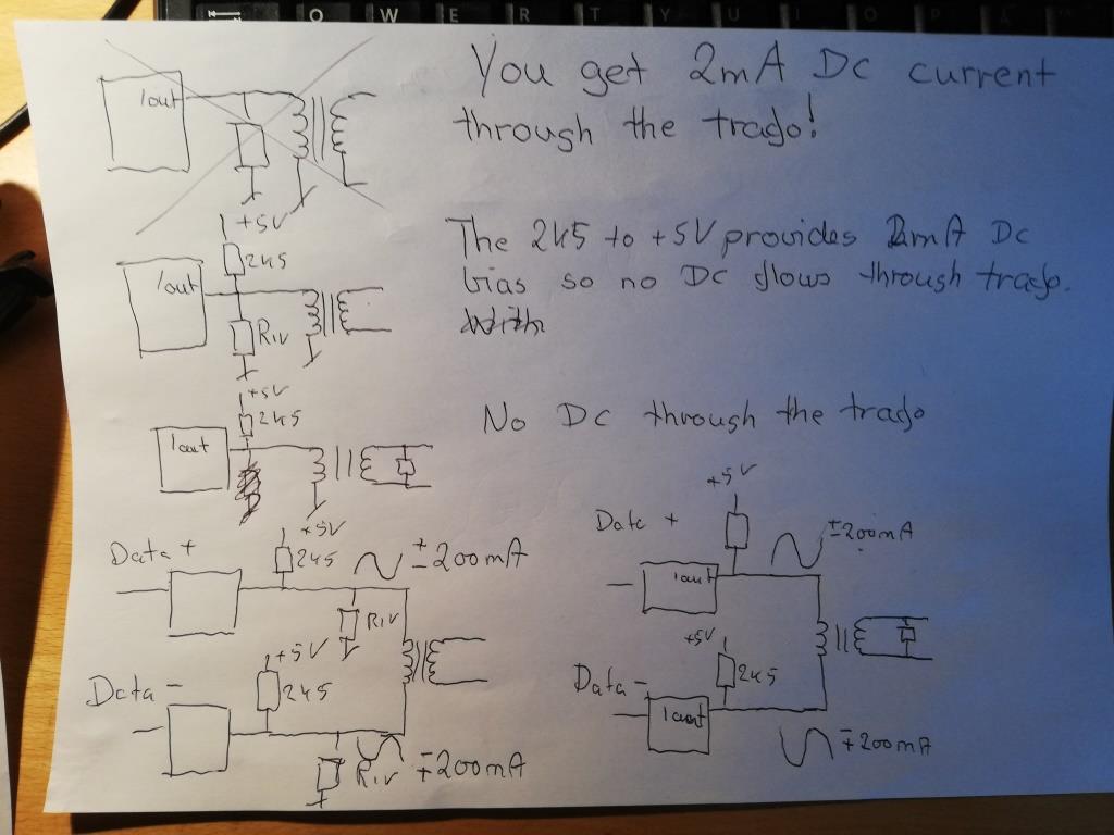

Take a look on the different ways to make I/V conversion.
In Pic 1 the first case shows a normal Opamp I/V conversion also known as virtual ground. The Opamp makes sure there is no (well almost no ) AC or DC at the Iout from the DAC. In the case of the TDA1541 you get 2V DC out of the Opamp with 1KOhm R and +/- 2V AC.
Second case passive I/V conversion: With 100 Ohm Riv:
You get -200 mV DC @ I out and this is overlayed with +/- 200mV AC.
So the Iout swings from 0 V to -400 mV and this causes elevated harmonic distortion from the TDA1541.
Third case passiv I/V with bias and 100 Ohm Riv:
The 2K5 to + 5V makes sure there is no DC current through the 100 Ohm Riv as it provides the 2 mA (5V/2K5 ) to the DAC.
Ac wise the 100 Ohm and 2K5 are in parallel, but this is insignificant so the AC @ Iout is +/-200 mV and this is much better for the TDA1541. Philips recomends no more than 25 mV (I guess RMS so P-P is 1,4 x 25 x 2 = +/- 70mV) for lowest distortion.
Now in pic 2 I show the different trafo cases:
First is a no go with the kind of trafos we are dealing with, as they are without air gab and therefore will magnetize the core, if exposed to DC current.
Second case:
To avoid DC through the trafos, there is a 2K5 resistor to +5V to make sure Iout is @ 0V DC. With a very high secondary loading of the trafo, Riv is again determining the AC voltage @ Iout = +/- 200 mV. With a 1:10 trafo 100K as load resistor will result in a 1K impedance in parallel with the 100Ohm Riv...
Third case:
Still a 2K5 to +5V to avoid DC through the Trafo.
Now in the case of 1:10 trafo if you use a 10 Kohm resistor as load for the trafo, this will be transformed to a 100 Ohm impedance @ Iout. As there is no DC at this point the DC resistance is of no importance here. AC wise the DC resistance is in fact in SERIES with the 100 Ohm transformed from the 10 KOhm load resistor. And it is part of the loss in the trafo..
Fourth and fifth cases:
This is what batteryman an I am working with presently.
In the fourth case the 2K5 bias resistor are not necessary form a DC flow in the trafos point of view, as the DC potential is the same (-200mV with 100 Ohm Riv) but we get into the same situation with the max swing (0 v to -400 mV) at both the Iout causing higher distortion.
The two Riv are acting as a 200 Ohm impedance between the two Iout resulting in +/- 400 mV from Iout+ to Iout -
The fifth case shows how I am doing it.
Here the 2K5 Ohm to +5V is necessary as there otherwise is no DC path for the 2mA bias required by the DAC (remember the DC potential is the same @ both + Iout and - Iout) .
Now if you load the secondary of the the trafo (1:10) with 20Kohm you get an AC impedance of 200 Ohm between the two Iout. Exactly the same as the fourth example.
I hope all this can help clean up the picture and remove misunderstandings.
Please do not be too harsh on me, if I have made some mistakes underways :p

It is the AC impedance that is important, not the DC resistance. There is no DC flowing through the trafos.
It is the AC signal current through the DCR which performs the function of IV conversion. AC impedance is the same as DCR for a resistor. AC impedance of a transformer varies with frequency.
So you see what you write cannot be correct.
WRT comment re 25mV and datasheet, this is DC voltage compliance, 25mVDC, and not an vRMS value or anything else.
These are fundamental misunderstandings which have gone unchecked.

So please tell me why the ac voltage across a trafo with 3,3 Ohm DC resistance is +/-200 mV with +/-2mA AC going through it? Ohms law is not valid any more?.
Ac impedance of the primary of a transformer, within its working frequency and with a non reactive load on the secondary, is NOT varying with frequency. The impedance is the load resistance divided by the ratio between primary and secondary squared!

The trafos DC resistance is a few ohms but the centre tap (if present) needs to be fed the +2ma offset cancellation current from a low resistance source such as ECD's suggested circuit, not from a simple 2k resistor.
I think Sowter would have advised the I/V resistor could be dispensed with if it was not needed with either of their current output DAC I/V transformers but testing will probably shed light on the effect.
Concerning the compliance, you might be right, though :)
Yes you are right but I believe, this is only if the source resistance is very low. Whereas without an I/V resistor, its not?

My notions on the output compliance was wrong. Here are ECDesigns explanation of why I measure higher THD without the bias .
But Sowter does in fact do that:
