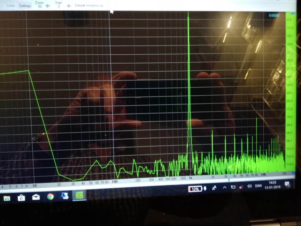

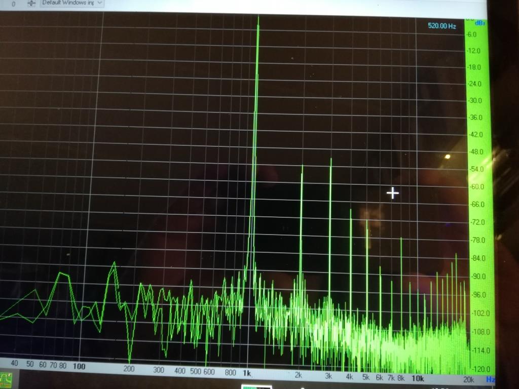

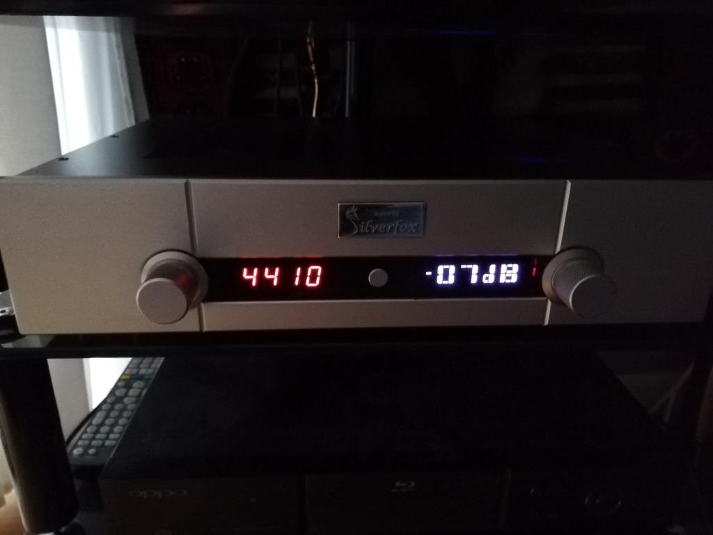

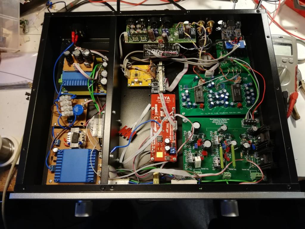

Now I have modified my DAC/Preamp so it now consists of 2 TDA1541A in balanced simultaneous mode.
First picture is of the DAC/Preamp open, where you can see the dual TDA1541a board and the small Sowter transformers. The Preamp/vol consists of bruno putzeys balanced preamp with Maya controller. Inside is also a second DAC that eventually shall feed a subwoofersystem.
From the next picture, you can see the front with the leftside display displaying the sampling frequency.
I was a little disappointed by the sound at first especially when the digital signal was high.
The main difference between how the DAC was before the modification, besides the fact that it is now balanced, is that before I had to bias the output from the TDA1541A to avoid DC flowing through the transformers. This is not necessary when two outputs are feeding the transformer.
BUT! When the TDA 1541A is loaded by 100 Ohm and have no bias, the output is ca. -200mV DC and if you to that add the AC when outputting 0dB digital , the output peaks at around -400 mV and this is too much for the TDA1541A. It will start to increase distortion. I have attached two pics from a (pretty noisy) PC spectrum analyzer, The first is with no bias and the second is with 2 mA bias.
What I did was to remove the four 100 Ohm resistors and the transformers from the outputs, and connect a trimpot from +5V to one output and trim it to 0 V DC and the measure the value, just to be sure. It turned out to be near 2K4 witch I had in my collection. I then reinstalled the 100 ohm and connected each of those to a 2K4 going to +5V and then reconnected the transformers .
It is quite obvious that bias is indeed needed when operating the TDA1541A with a 100 Ohm I/V resistor. If you lower this value considerably, you can do without the bias.
