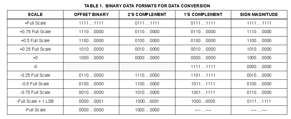

Thx, but I already have two of your previous boards. It is actually one of them I use with the sowter , so it will be quite easy to populate the other half to make it balanced. The reason I have two of your boards is , that I would ultimately like to run the TDA1541A in balanced signed magnitude mode and this calls for 4 TDA1541A..
What advantage does signed magnitude give over offset binary and how will you produce it?
According to Intersils'c table below, it appears that 0 can be 1000.000 or 000.000 so presumably the changing of the MSB at zero signal levels gives some audible benefits? (how do you hear them if the signal amplitude is zero. since once it increases even by '1' the msb is either 0 or 1)
