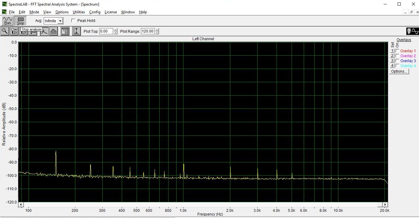

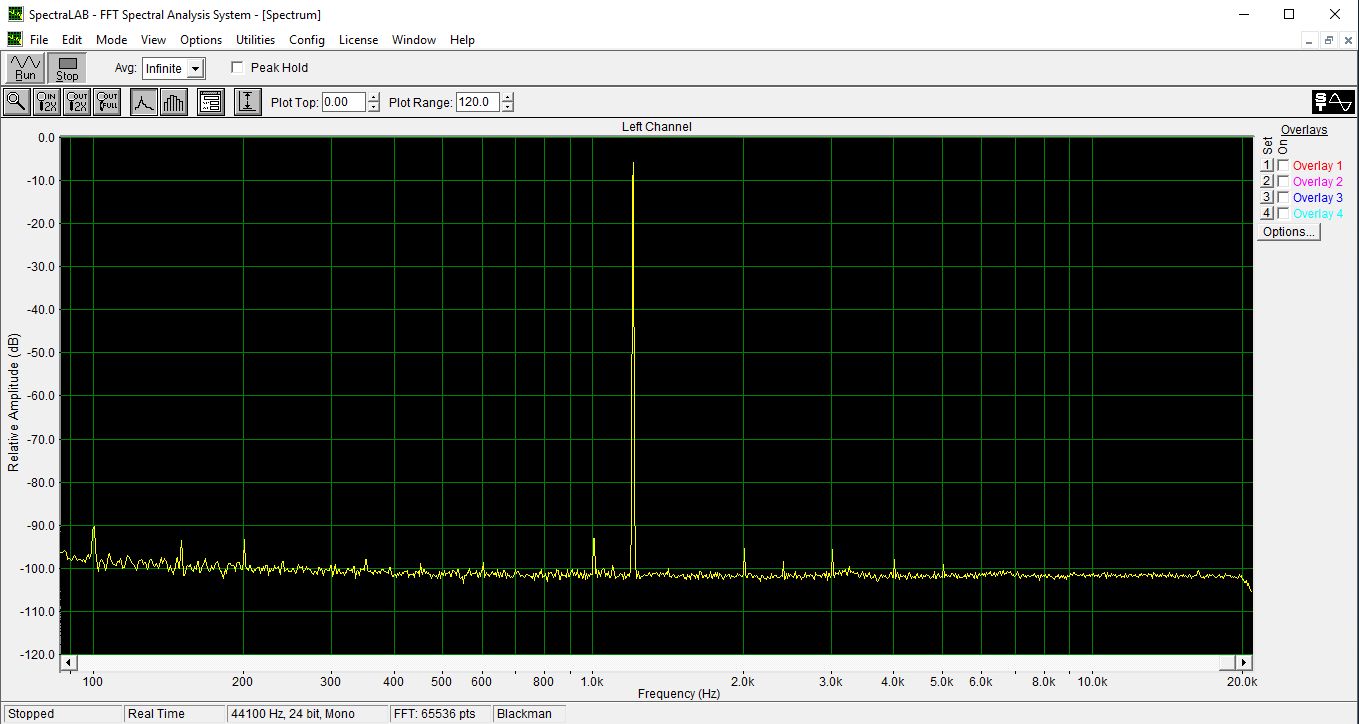

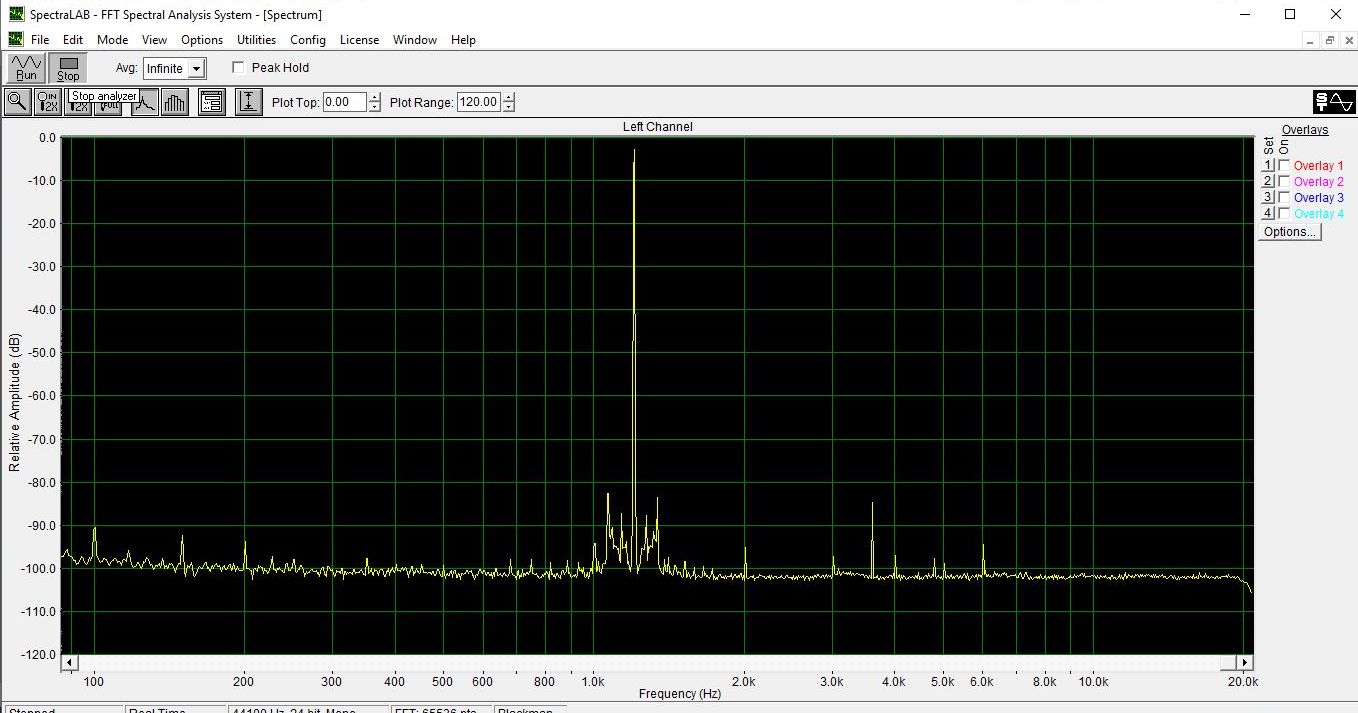

I repeated my previous FFT tests, this time powering the external USB soundcard from batteries, and powering the USB/I2S adaptor from external wall plug (there is an onboard stabilizer). Signal source: REW Generator 1198Hz, -6dBfs and -3dBfs. I used different computers for signal generator and analyzer. First picture is the baseline, second is 100R I/V resistor, -3dBfs, third is 100R I/V -6dBfs, fourth is 50R I/V -3dBfs.
3rd harmonic is visible with 100R, but it disappeared in noise with 50R I/V resistor.

They look good to my eyes but what happens at 10Khz and at lower levels?
I'm thinking of the claimed increase in distortion caused by not adhering to the 25mv output compliance. (the 3rd harmonic with 100riv is still around -85db and won't be audible but does it increase more at lower levels and higher frequencies?)

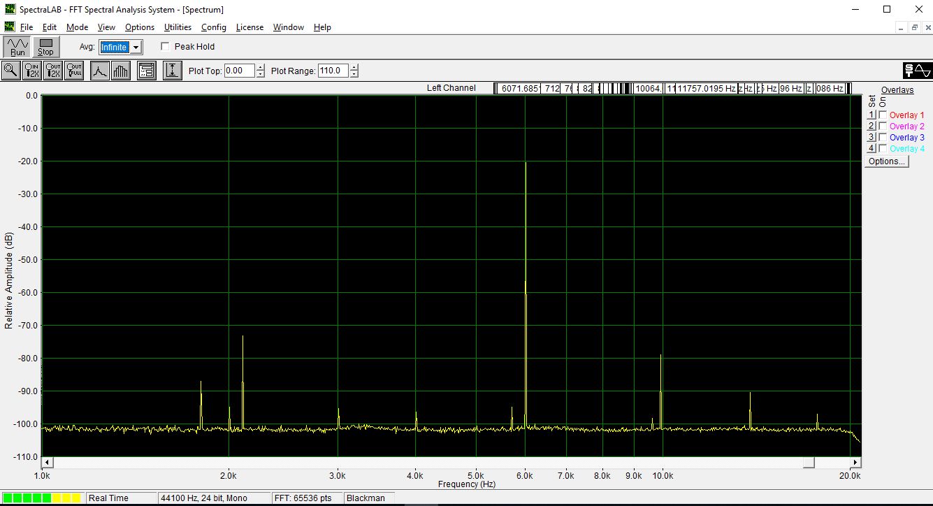

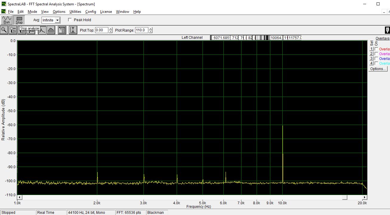

Nasty things come at higher frequencies, but there is no analog reconstruction filter at the DAC output. 6kHz -20dBfs, 10kHz -40dBfs, 10kHz -60dBfs.
