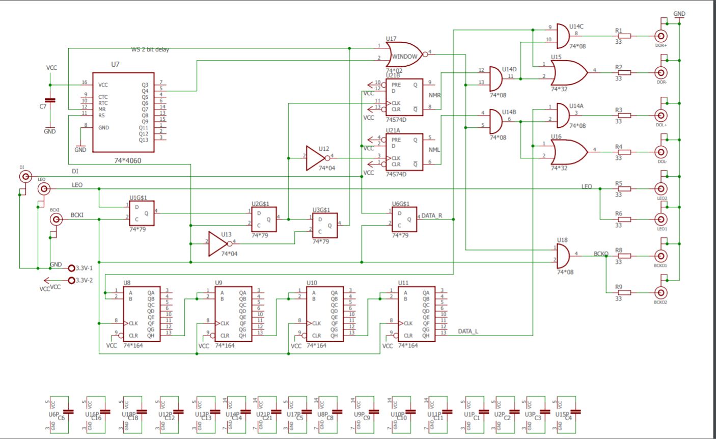

Board schematic
Here is the schematic of the board I did according to John's post Building the ultimate NOS DAC using TDA1541A
View attachment i2s-tda-nodac-v1.pdf

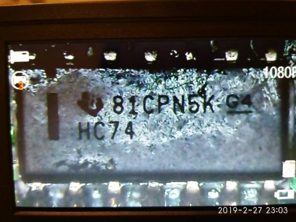

Hi xaled
This chip should work on 3V3 supply but depending on BCK frequency there might be a possible problem.
You could try faster logic like the 74LVC74, 74AHC74 or 74LV74 (SOIC).
When the 74xx74 receives supply voltage, 1.5 BCK delayed WS and DATA signal are within specs, and preset & clear are both connected to 3V3, these flip-flops should work.
Also consider the possibility of a solder bridge, interrupted trace or defective chip.
I2S to signed magnitude converter
Xaled was kind enough to send me one of his PCB he made for the I2S to Signed magnitude converter that ecdesign had developed and kindly shared with us here .
It looks like there is no problem with using the SN74HC74 Xaled had specified instead of the two LV1G80 FF from the original schematic. There is one little error (Xaled pointed that out to me ) on the PCB (U12 is missing connection to VCC) but easily corrected.

I think a solution could be to add an AND gate to the DOL- and DOR- with the window signal from U17 pin4 on the other input.
Any comments from John?

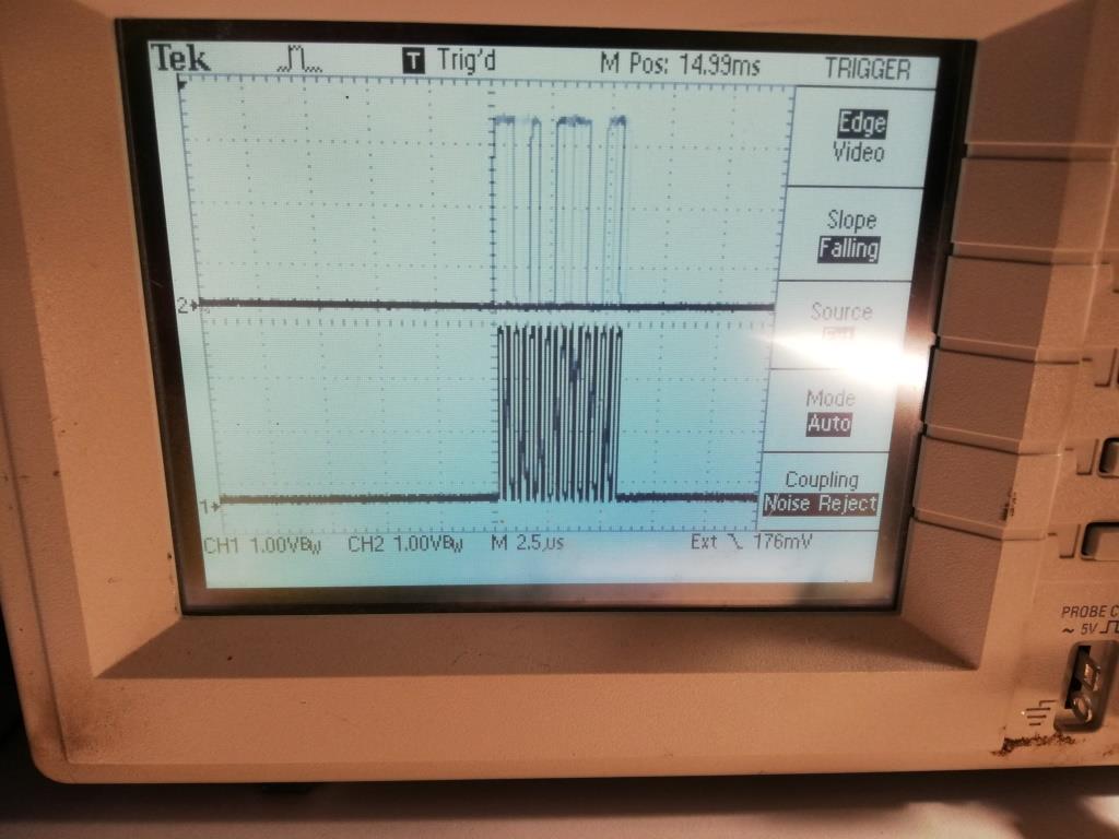

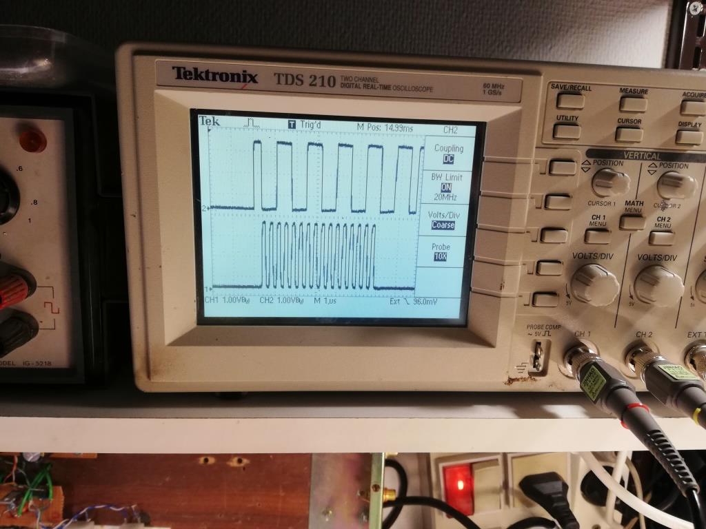

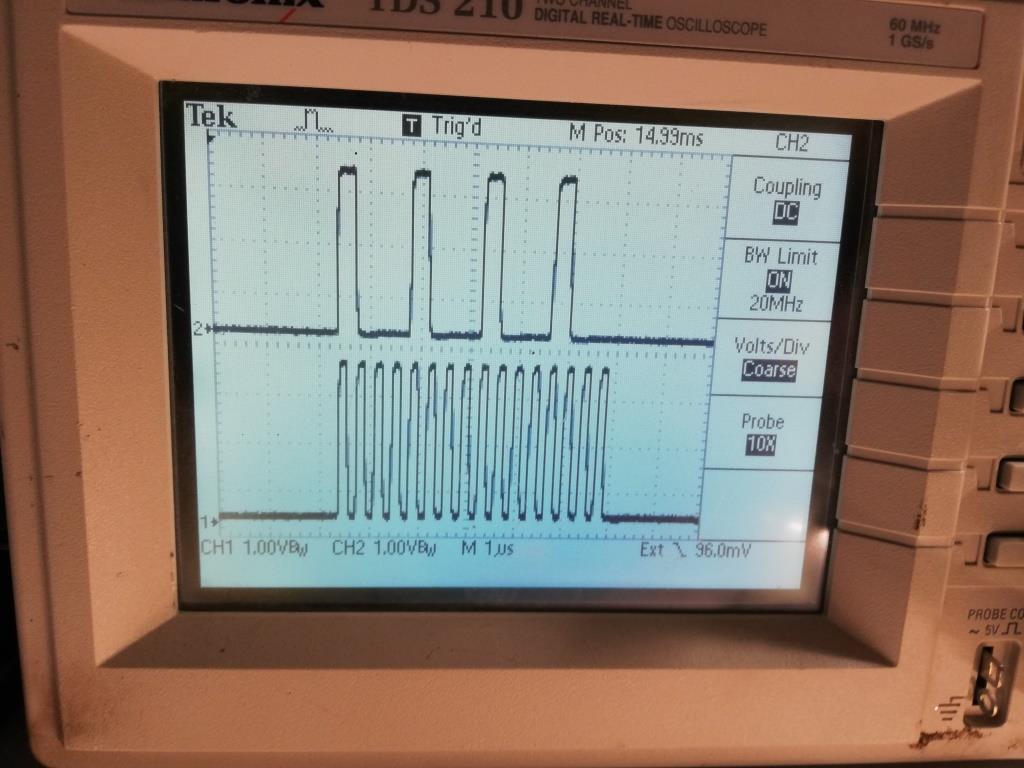

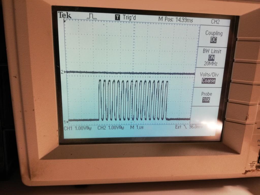

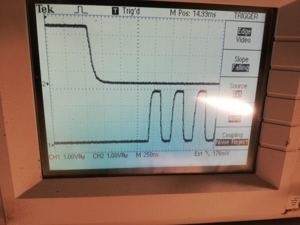

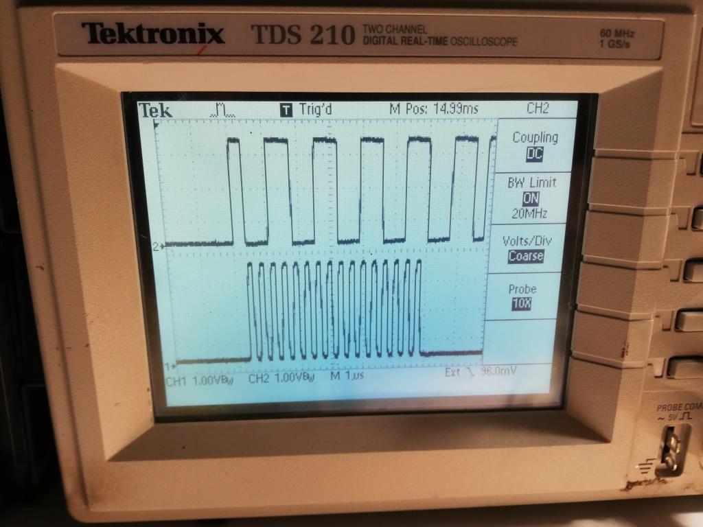

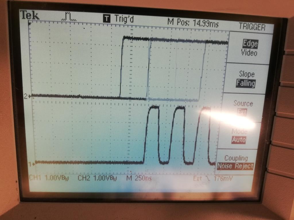

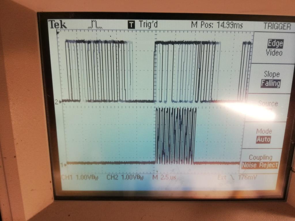

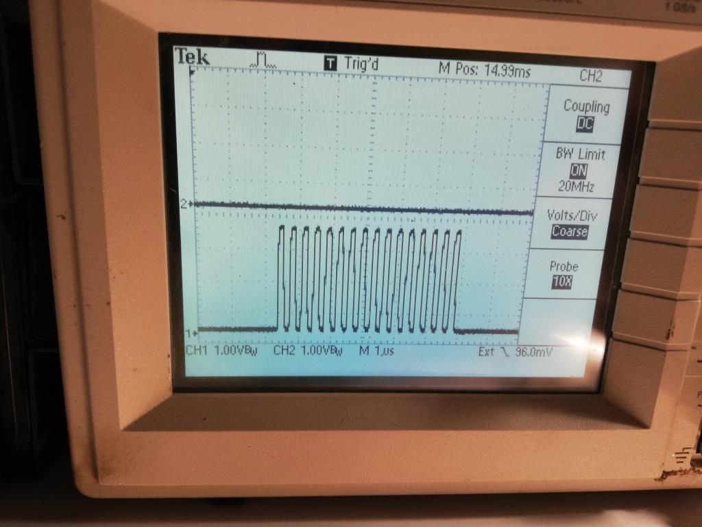

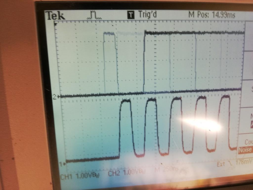

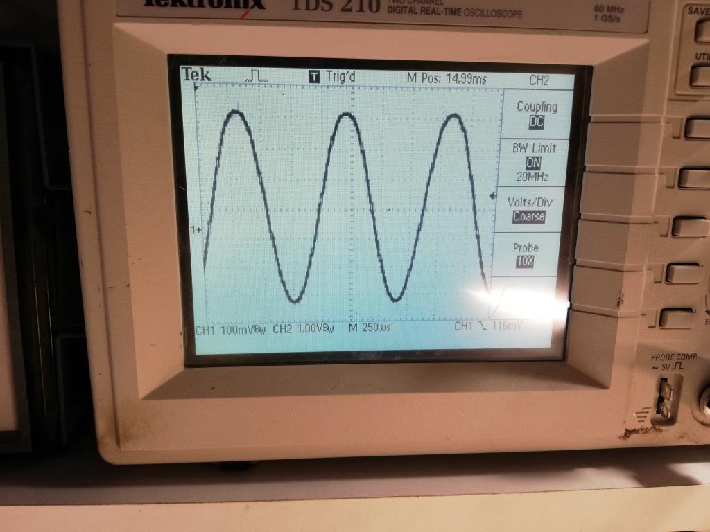

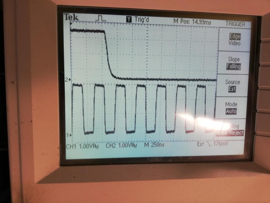

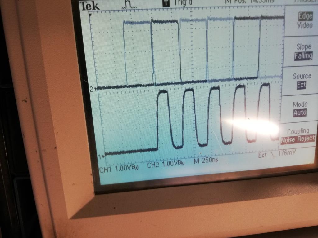

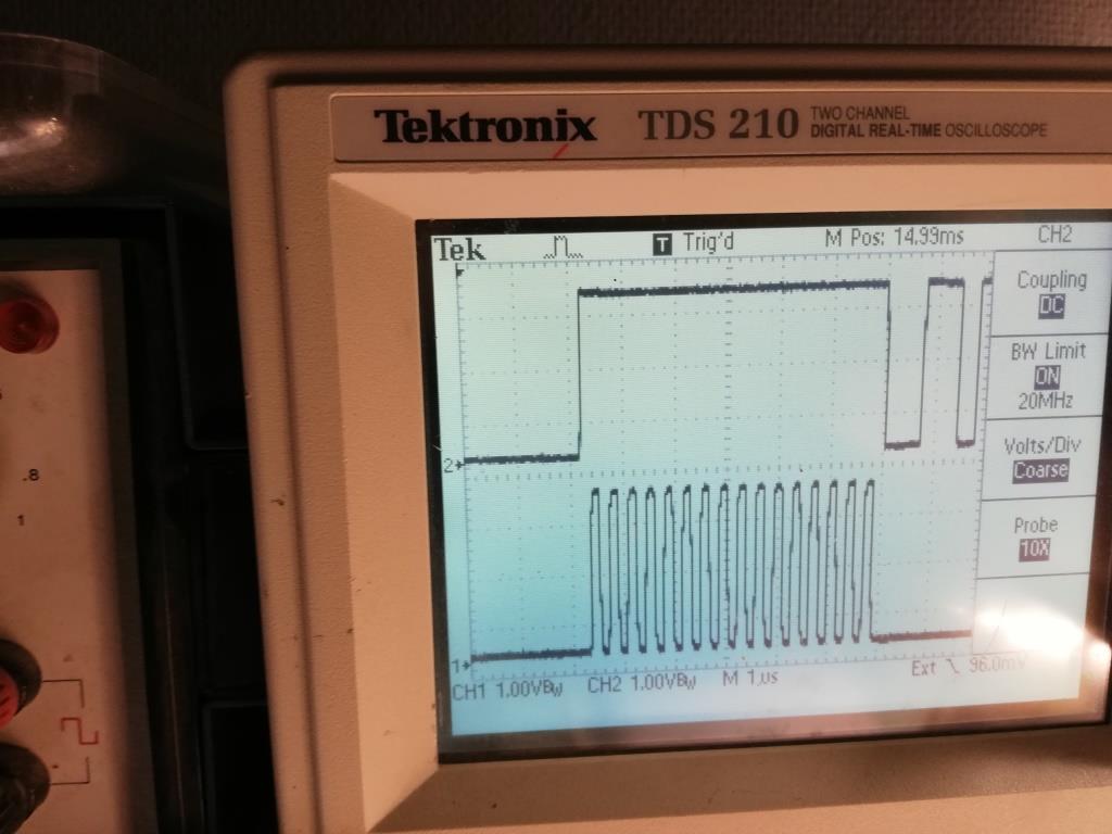

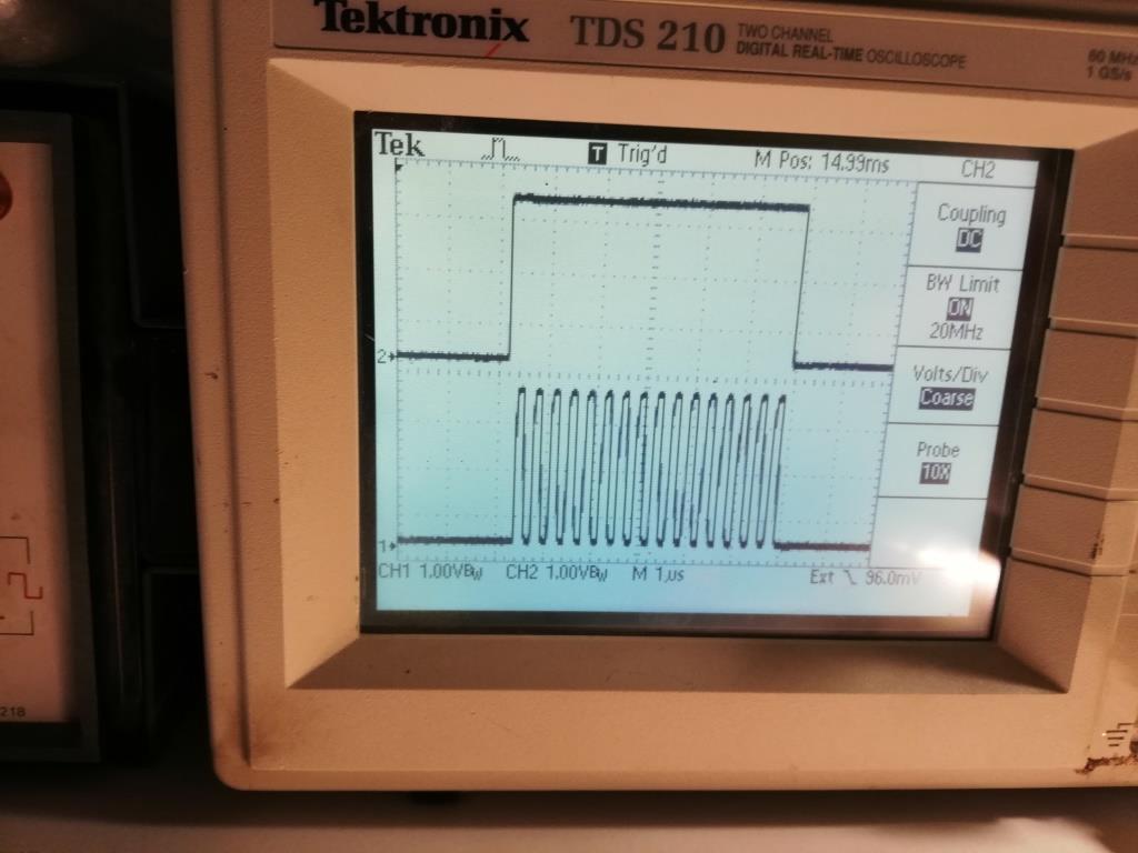

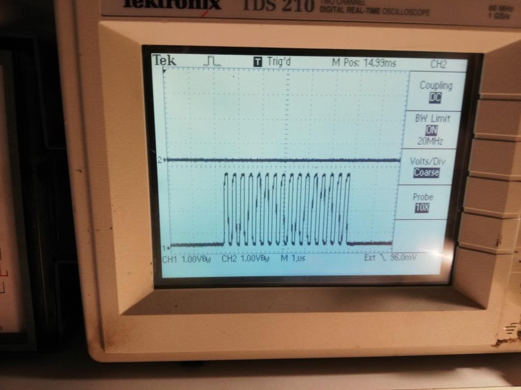

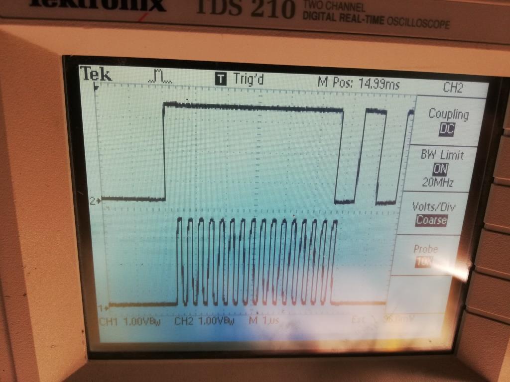

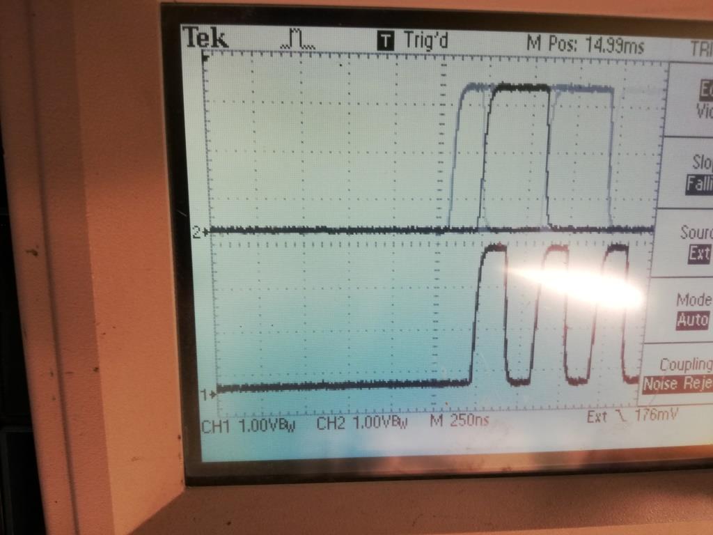

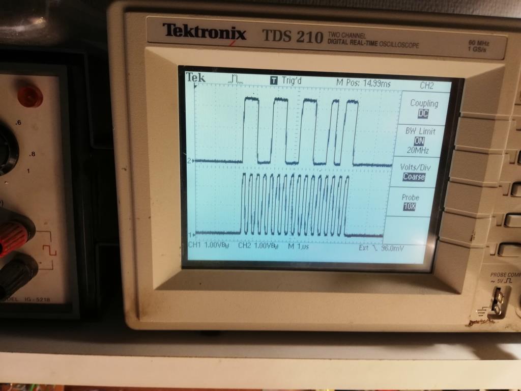

So I finally got to connect the signed magnitude converter to a TDA1541A.
I have a test DAC with Johns I2S to Simultaneous converter and a modified Red Baron TDA1541A dac. Not the same as my main dac as this is a balanced dac but again with Johns I2S to Sim. converter.
So I could just swap the I2S to Sim with I2S to Signed. and disconnect the I/U converter and connect the two outputs from the TDA1541A to each other and a 100 Ohm to GND and a 1KOhm to +5 V.
The converter did not work as planned.
I switched back to the old configuration just to be sure, but that worked perfectly.
I2S to Signed in again and here are the results:
Pic. 9 shows the output with a full scale 1 Khz digital signal.
Pic. 1 shows LE and input clk
Pic. 2 shows LE and BCK01
Pic. 3 shows BCK01 and DOL-
Pic. 4 shows BCK01 and DOL+
Pic. 5 and 6 shows the same with another time scale.
Pic. 7 shows BCK01 and DATAL (U14 pin 1)
Pic. 8 shows BCK01 and DATAR (u14 pin 9)
Just for fun I tried to connect DOL- and DOR+ to the DAC and to my big surprise, if I turned down one channel completely the result was as shown in Pic. 10.
If I connect DOL+ and DOR- to the DAC and only have data in the other channel it shows the same perfect result.
Now I have a headache from trying to figure out what is going on here..:headbash:
Can anybody please help here???
