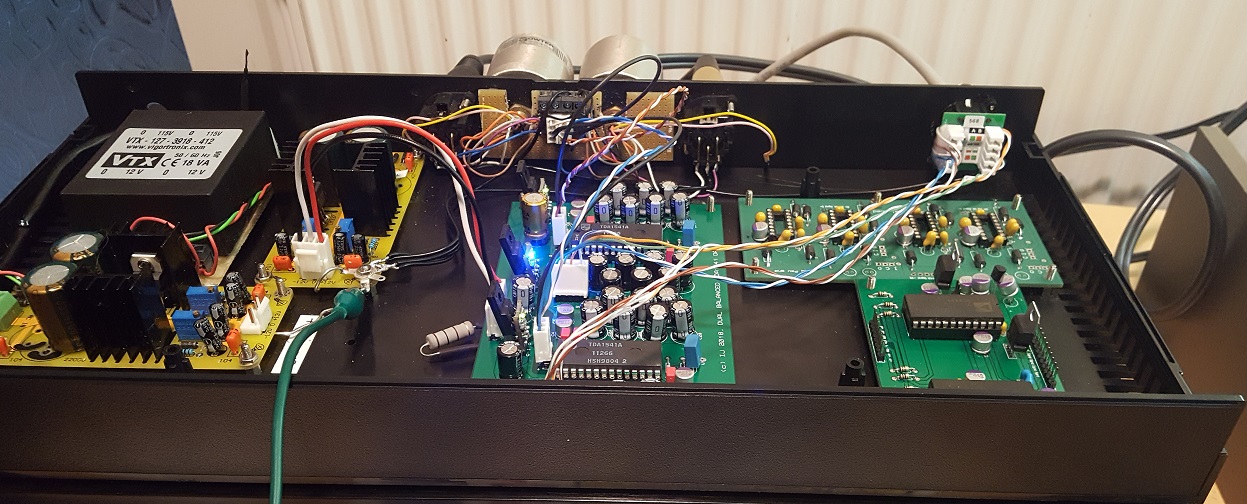

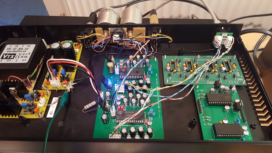

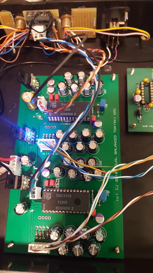

My dual balanced 1541a dac - worked 1st time
At last I received my dual balanced TD1541 pcbs from Pcbway.
I borrowed EC Designs low frequency dem idea and it is running at 89Hz.
Dem caps are Nichicon UKL very low leakage type and there was no waiting for them to charge up.
Power pin decoupling is with Os Con low esr 100uf/16v & 0.1uf Wima.
Dexa low noise regulators are used on the pcb, with adjustable LM317/337 preregulators ($10 each built from Ebay).
The Sowter I/V transformers had to stick out from the rear of the plastic 1U case and the primaries are wired in parallel (across 110R resitors), the secondaries are in series. Then through a 10K alps pot to a Quad 405.

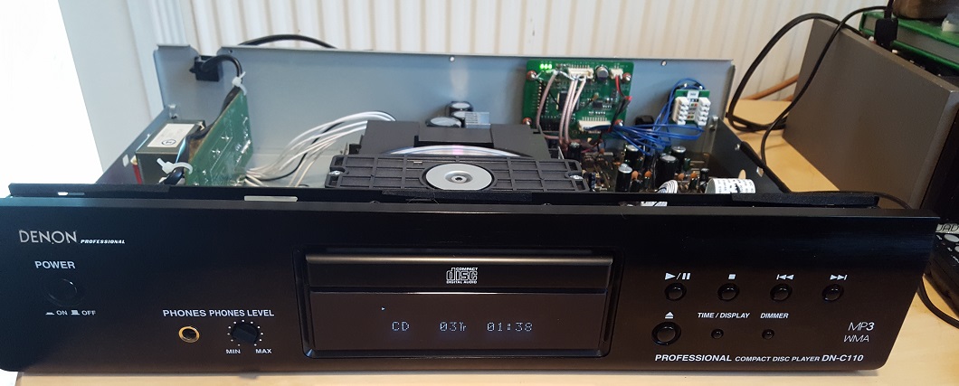

Cat5E STP cable connects it to a Denon professional CD player used as an excellent rack mounting transport in which resides IanCanada's I2StoPcm interface.
I was very pleased when it worked first time and sounds promising though not right as it crackles on peaks.
I've yet to examine the signals with my scope and will fit a shorter Cat5e cable as recommend by IanC. (currently 50cm, 10cm is adequate.)
The other pcbs are: Quad AD1862 and dual AD1865 for comparison and then one of the three will be for CD, and the other connected to a USB to I2S interface for PC audio.

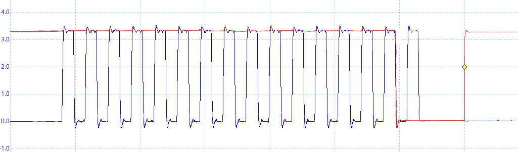

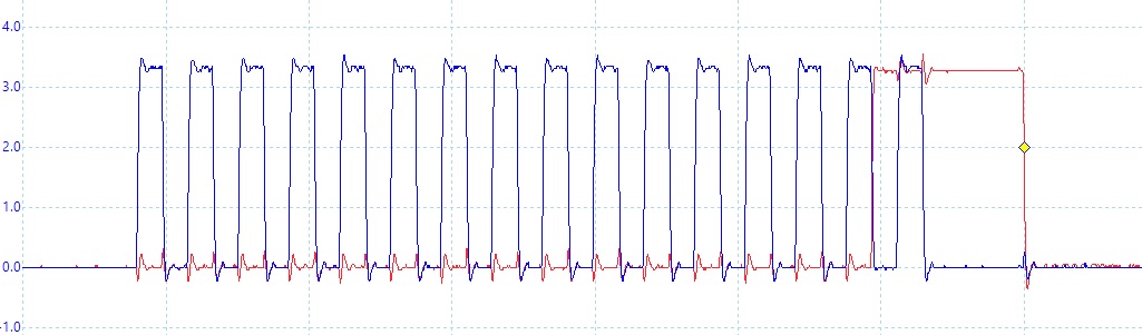

Screenshot
Here's a screen shot of the latch and bck, which look okay to me and of course you can see the clock stop feature of Ian's interface.
I will try half speed mode next and if that doesn't help, I'll move the interface into a Marantz Cd65 1541 based cd player.

Hi batteryman,
LE latches the TDA1541A outputs (simultaneous mode) at the -rising- edge of LE (datasheet spec).
When the red trace represents LE and it runs synchronous with BCK (no scope trigger issue), it latches the outputs -before- all 16 bits have been clocked in.
So if I am correct, all you have to do is invert LE. Perhaps Ian already made a provision for this (jumper setting?).

Hi batteryman,
I am now confused! According to Ian's instructions, the data appears at the output on the negative transition of WE which is what my screen shot shows. But according to the data sheet, this only applies to time multiplexed TWC.
"The converted samples appear at the output, at the first positive going transition of the bit clock signal after a negative going transition of the word select signal."
You are correct in saying that in simultaneous mode, that its the positive going transition as the datasheet states:
"The converted samples appear at the output at the positive going transition of the latch enable signal."
So this might explain why the data is truncated and causing the distortion.
I will re examine the traces when I have replaced the 50cm cat5e cable with a 15cm Cat6 cable tomorrow, and in the meantime I can try Ian's suggestion of half speed mode.

I don't think so. TDA1541A can operate at 14 bits just like TDA1540 and it does work just fine. You wouldn't hear any difference between 14 bits and 16 bits.
I can imagine there is another issue. Can you show us the DATA line (whether it's R or L, doesn't matter) along with BCLK on the same screen? If you can include 3rd graph of LE that would be lovely, but that's not necessary.
Hi batteryman,
Philips TDA1541A datasheet page 4
quote:
When input OB/TWC input is connected to VDD1 the two channels of data (L/R) are input simultaneously via DATA L and DATA R, accompanied with BCK and a latch-enable input (LE). With this mode selected the data must be in offset binary. The converted samples appear at the output at the positive going transition of the latch enable signal.
The format of the data input signals is shown in Fig.5 and 6.

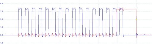

When you invert LE, the positive going transition (latching) will occur -after- all bits have been clocked in. This would meet datasheet specs and should work.
See attached modified oscillogram.
