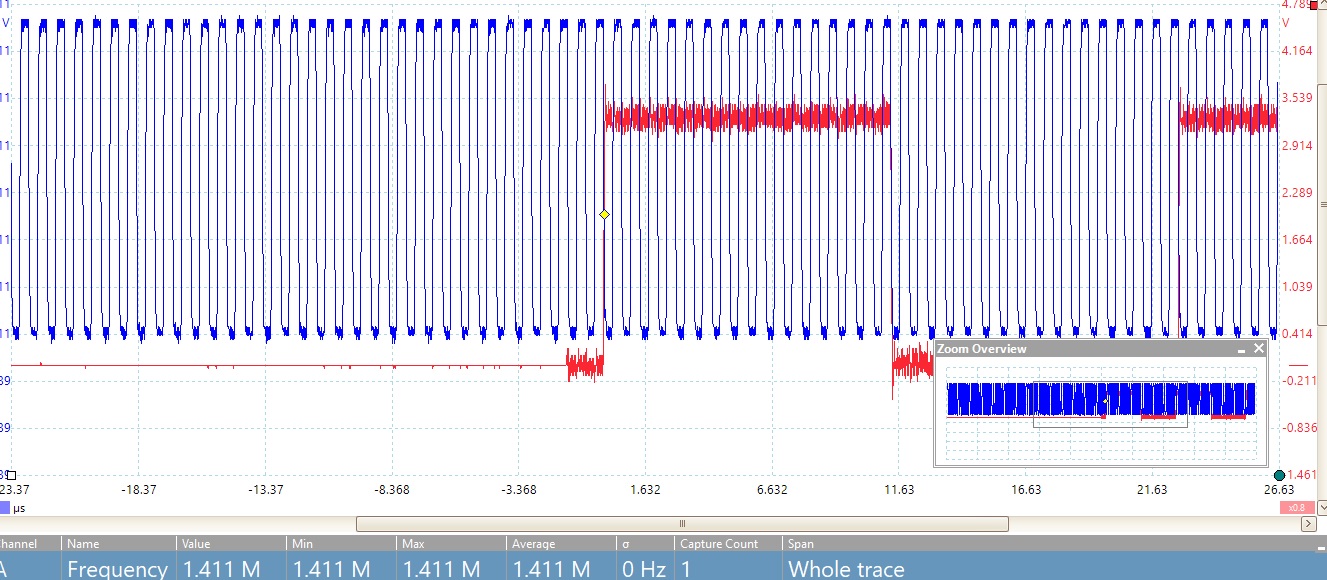

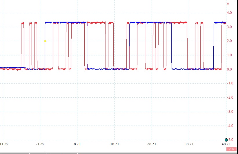

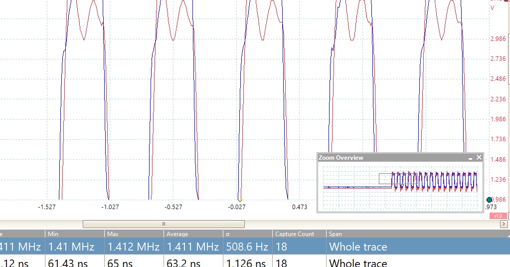

I think the attached screen shots show this to be the case.
Bck = 1.411MHz, WS/LE = 44.1Khz, 32 clock pulses per WS cycle
Master clock from the cd player to Ian's board is 16.9344 rather than the usual 11.289
1st image bck & WS
2nd image D + Ws
3rd, D + bck
1st image bck & WS
2nd image D + Ws
3rd, D + bck

Added screen shot of bck - blue at the converter, red, at the end of 50cm Cat5e cable showing a delay of several ns.

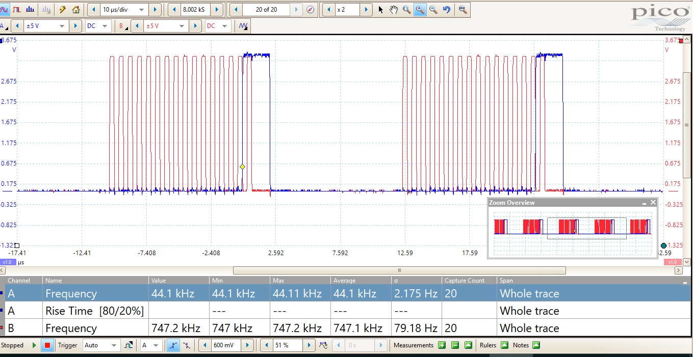

If you have Ian's converter then please take oscillographs of BCK and LE from it when used with TDA1541.
Here they are direct from the output of the converter - same as in post 6653 which were from the dac pcb at the other end of the cat5 cable.
LE is still missing the msb as if its set for 15bits. (I tried the 18bit jumper and sure enough 18 bck are sent but LE then misses the last 3.
The problem seems to be what ECDesgns said - Ian says he is using the falling edge of LE when the dac is using the rising edge. If the rising edge is delayed by 1bck it should work?
