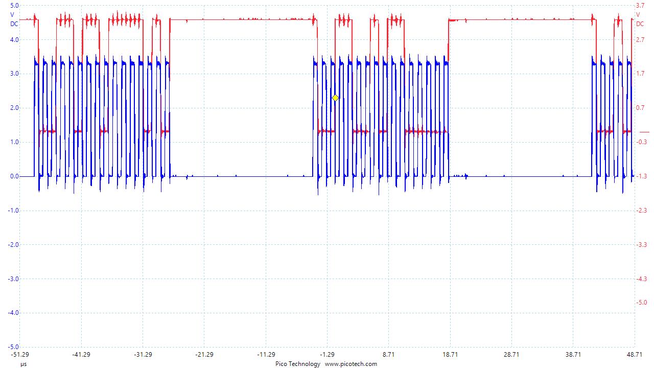

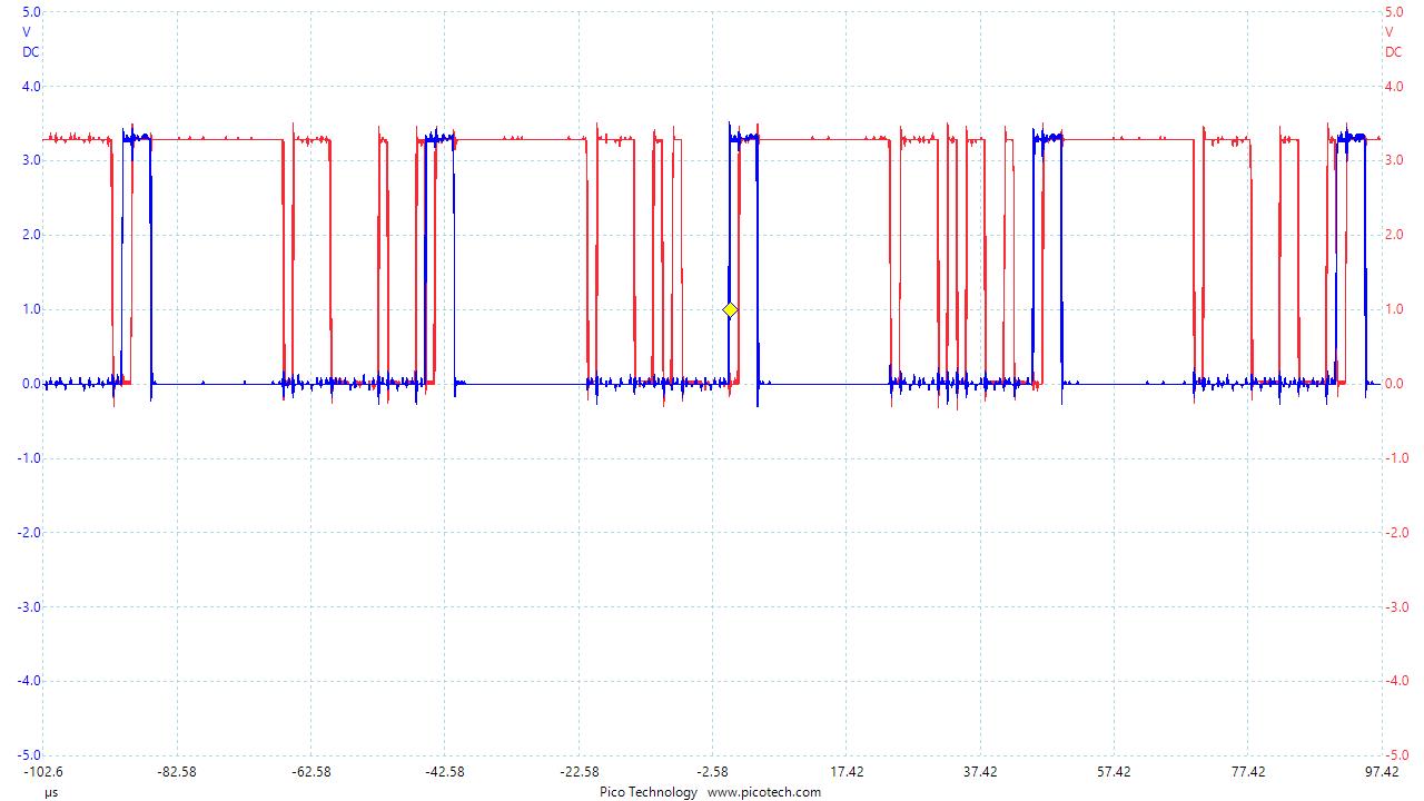

I can imagine there is another issue. Can you show us the DATA line (whether it's R or L, doesn't matter) along with BCLK on the same screen? If you can include 3rd graph of LE that would be lovely, but that's not necessary.
Here are two traces: Data + BCK and Data + LE
I can only assume that the red on the first picture is DATA and blue is BCK. You wouldn't hear a difference between 14/15 and 16 bits, so I knew that wasn't the case. Anyway, I thought so. You can see it's completely wrong. TDA1540 as well as TDA1541 clocks data in on the falling edge of the BCK. Not on the rising edge of BCK like other DACs.
DATA on your graph changes with the falling edge of BCK which means its justified for clocking in data on the rising edge like normal DACs do require it to be. However, that's not the case with TDA1540 and TDA1541.

You can see that DATA needs to change on the rising edge of the BCLK, so it should be stable for the falling edge which clocks it in.

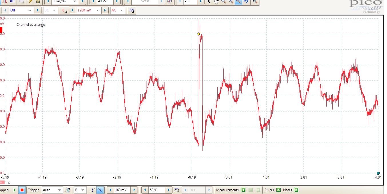

Yes I agree it is wrong but yet it sounds okay until there is a peak. (I do have the datasheet)
You'd never suspect a problem if the recording was done at a lower level or the track was of quiet music.
I have tried using half speed mode and also 18 & 20bit settings and none make any difference either to the distortion or to what I can see on the scope.
I'm afraid there will be many more audible artifacts due to bits swapping, but your brain simply told you that this is how it sounds "right" and different from I2S mode due to those errors.
Your issue happens because MSB (sign bit) is overlapped and you hear some crackles due to signal switching its sign from intended value. It happens to other bits, too, so you might hear certain parts louder than others depending on the luck how the bit swaps its place.

Here's a screen shot of the latch and bck, which look okay to me and of course you can see the clock stop feature of Ian's interface.

I think that is not correct - LE should be one CLK delayed? It is going into conversion before LSB.
From this it look like the 1/2 of MSB lost? The SYS CLK is from rising edge and it has 16 cycles. That is good. The Word is finishing at the BCK end. But the 1st 1/2 of MSB missing...
So with LE with LSB and this, You loosing MSB and LSB, and probably something else is happening wrong.
BCK is have to be delayed by one self cycle or 4/2 MCK periods to line up with datas. That is depends of MCK timing. That is 2 x FlipFlop clocked with MCK input is BCK out is Q from the 2nd FF...
After that You can use 3 x flopflop 74 clocked with BCK for LE to move 1.5 BCK period and recover LSB. 1.5 or 3/2 of BCK You are alredy miss 1/2 BCK at LE, and with delay of 1 BCK for MSB recovery that will be 3/2 of BCK
