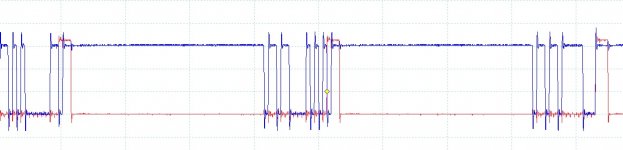

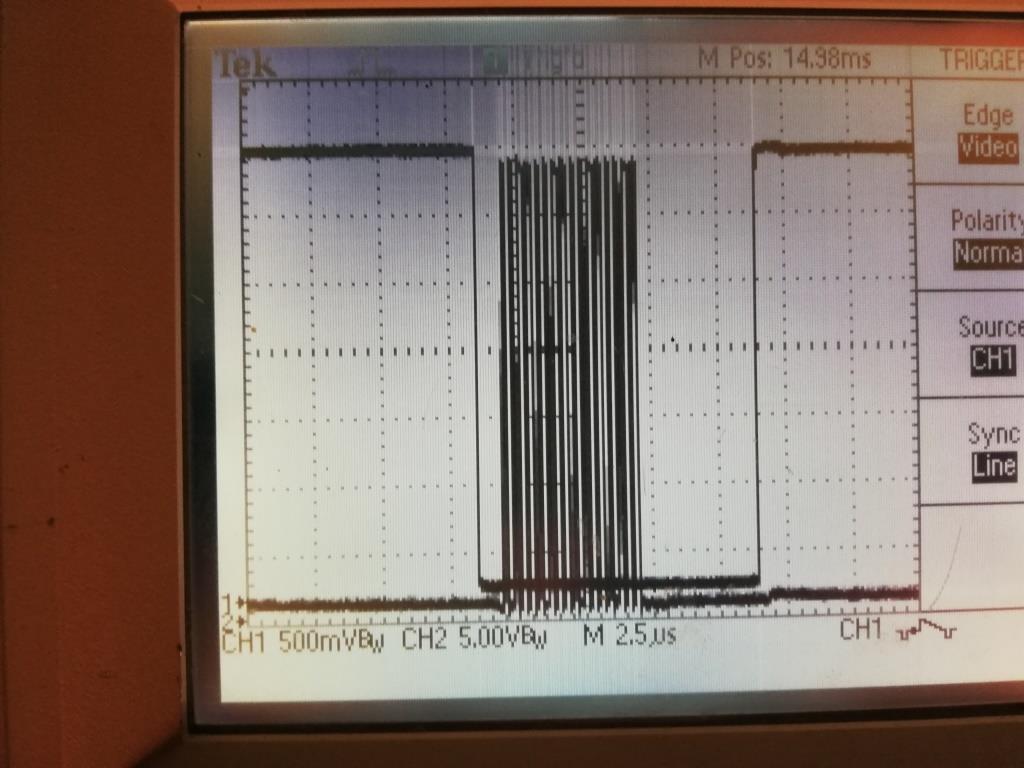

Hi Fellas,
Dont mean to litter the forum with scope shots, but just wondering what exactly is going on here (aside from the noise from BCK on the Analog outputs) It looks like the sample starts before the least significant bit is clocked in? According to the data sheet (TDA1541A) this shouldn't be so - Unless i'm not clear about something. :eek:
Also notice how much BCK is visible on the Analog outputs without I2S attenuation - Hope to change that soon.
Bandwidth limited,
Top trace is BCK using only 50mhz probe - hence the slow rise time.
Bottom trace 11025hz square wave at full scale current output.
Simultaneous mode.
Ryan

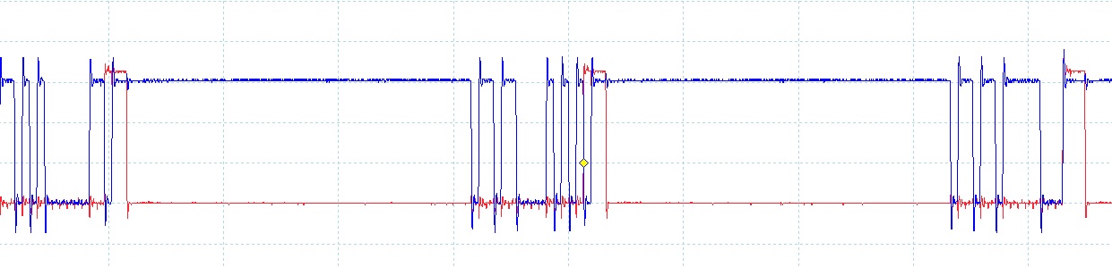

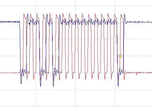

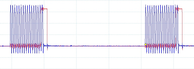

SCREEN SHOTS FROM USB I2S ADAPTOR
Koldby, tried your suggestion of bypassing Ian's board for WS - no difference to the distortion.
Next connected the board to a cheap USB to I2S interface.
Screen shots attached. Still looks like one of the clock cycles is after the rising edge of LE but no distortion heard from Youtube so far. (48Khz)
Does this mean that the I2S data from the Denon Cd player is not actually I2S?
Images: Bck + L, D + BCK, D + L
The first image shows me you did not use the input WS as LE for the TDA 1541 A. You must disconnect the LE out from Ians board , not use it at all.
Did you remember to invert the CLK out of Ians board? That is mandatory. The WS(LE) bypass I described, is only to get all 16 bits converted in the TDA1541A. Try to have look on my Pic of CLK and LE ... LE (or WS as it is called as output from the I2S source)should be a 50% dutycycle 44,1 Khz (or 48) squarewave. The aboth 4 CLK pulse long LE is how the faulty LE looks out of Ians board. Don't use that..
