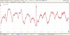

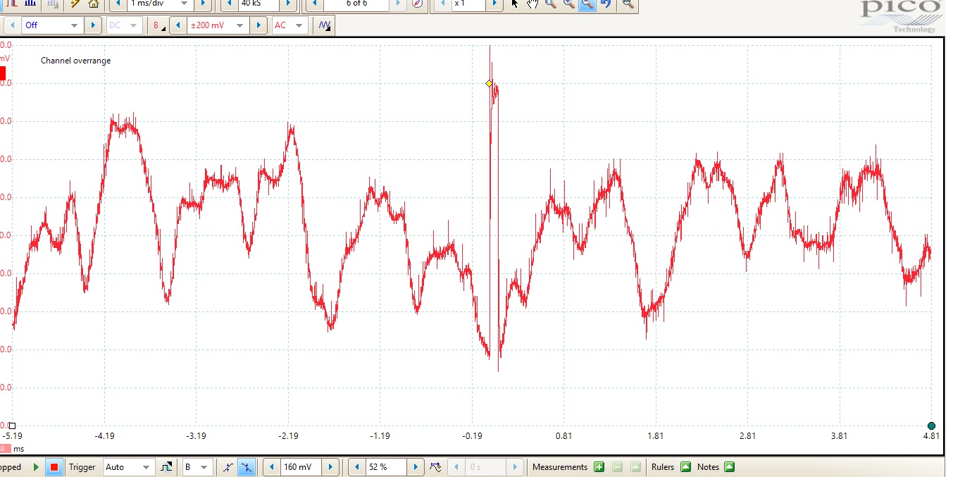

You must have the same problem, as everyone else has when using Ians i2stopcm board: The TDA1541a only converts 15 bits.
The distortion, on the other hand, batteryman describes, IMHO, is unique for his setup, as neither you, I or ryanj has experienced that and I haven't seen it described anywhere else using this i2stopcm board with TDA1541A.
See post 6665 - Hanze Khronye describes the same sort of distortion due to the signal "crashing into the DC rail voltage".

No I do understand this, I was simply trying to find and explanation for the distortion I and two others have mentioned. I.e what is the cause of the audio break up.
I know the data is left justified and the I am aware of the difference between I2S and simultaneous. So what will be the effect of feeding Ian's board with non I2S data, will this explain the distortion?
No one has stated that this is the reason for the distortion and I'd hate to think I have wasted everyone's time if the cause was that the data was not I2S all along. or is it because of the mistake Ian's made with the 16th bit, & clock polarity?
I fed Ians board with I2S and the output looked precisely as yours, so I don't think so. Both 3lite and ecdesign had predicted that this could not be the case.No I do understand this, I was simply trying to find and explanation for the distortion I and two others have mentioned. I.e what is the cause of the audio break up.
It could still be because of the non inverted CLK that produces unpredictable results.
