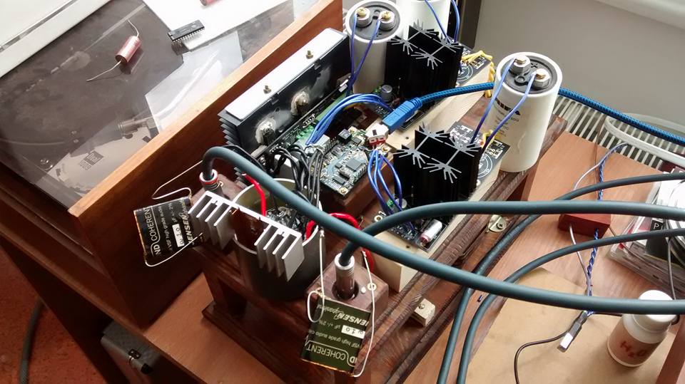

I just found out by accident this threat is full of TDA1543 discussions and to be honest, I'm very glad. I'm a big fan of this chip.
A few days ago, I also warmed the hearts (and ears) of several audiophiles with much experience, who were stunned by natural, liquid sound this chip gives.
My DAC is a bit on the extreme and funny side. 16 paralleled chips immersed in paraffin oil for lazy cooling. Shunt Salas regulators, choke input power supplies, neotech single crystal copper wire, XMOS USB board, pine chassis with grain oriented, Neotech 3PS25 power cable with Valab plugs, Neotech rhodium RCAs. Today I tried putting Duelund copper foil caps on the output
There are a few things that don't give me a break.
-I read more and more than a single chip sounds better than paralleled chips. I am willing to try impatiently . Can you define more precisely? If this DAC has an issue, is it's lack of a wider soundstage
-The chip temperature is very audible. The problem with my implementation is that, the oil heats very much and the sound gets somehow slow, lacks engagement, lacks punch and sounds weirdy. Then if I drain the hot oil and pour a cool batch, first the sound is sterile, but after a minute it gets amazing! And after 10-15 minutes it starts degrading.
-So it will be easier for me to try 1 chip first.. and the cooling will be easier anyway.
Paralleling DAC chips increases interference levels & jitter, possible advantage is averaging between repeating bit error paterns that are typical for R2R and related multibit DAC chips. Most important thing with DACs based on emitter scaling is that all on-chip transistors remain at the same constant temperature. Immersing DAC chips in paraffin oil could possibly help to keep chip temperature more constant.
Voltage regulators are -in- the signal path and therefore have major impact on sound quality. Every voltage regulator “sounds” different as it results in a unique distortion and noise spectrum. Aim is a low, linear impedance with largest possible bandwidth. This requires extremely fast (global) feedback loops in the voltage regulator. Most integrated voltage regulators have slow, instable global feedback loop and resulting sound is horrible (thin and distorted).
One way to attenuate ever increasing mains interference is using chokes in the power supply. This was already used long time ago with tube radios but was replaced by modern equivalents that don’t work properly. The new balanced mains power supply that powers the Mosaic DAC is based on two large chokes the size of the mains transformer for pre- filtering +9V and -9V supplies.
Copper wire is copper wire, exotic copper wire has no audible advantages over plain copper wire. OFC (copper with low oxigen content) won’t corrode from the inside out over time so it offers better long-term performance. New (not oxidised) plain copper wire and OFC copper wire sound exactly the same. Copper oxide has semiconductor properties and this might cause problems. Remedy is using tinned, silver plated, or lacquered copper wire strands.
We live in the most EMI polluted environment ever and it is getting worse fast. So it would be wise to place your DAC in a Faraday’s cage, not on a piece of wood.
It makes absolutely no sense to hook up some exotic mains cable at the end of 10 … 100 meter plain copper wire of the mains wiring in the house. It would be wiser to run a direct connection to the power entry point in your house and use it for audio equipment exclusively.
RCA interlinks are unsuitable for high resolution playback because of Eddy current losses in the bulky brass sockets and plugs. The bullet plug offers some improvement but the RCA sockets in the audio equipment still introduces large Eddy current losses. It is better to use audio interlinks with lower mass (lower electrical resistance).
In the good old days we used DIN interlinks that already had low Eddy current losses, but it seems engineers have forgotten about that.
However we can use mini XLR (closest match to DIN interlinks) or 3.5mm Jack interlinks for example as these have low Eddy current losses.
It is also well known that thinner wires within the interlinks offer better sound quality as a result of lower Eddy current losses.
Coupling caps introduce unacceptable distortion. I expermented with many different coupling caps including Sonicap teflon, V-cap TFTF and Duelund copper foil. The best coupling cap is no coupling cap or DC-coupling. The Mosaic DACs now run on balanced power supplies and have fully DC-coupled output with true GND (0V) as GND reference.
