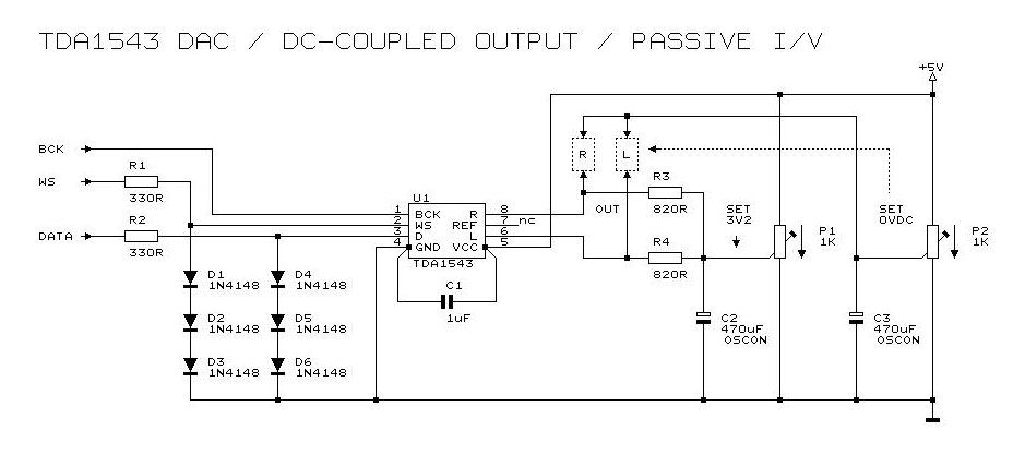

I attached schematic of a TDA1543 DAC with DC-coupled outputs.
P1 is passive I/V resistor bias voltage (adjust to 3.2V).
P2 provides DC-coupled outputs (no coupling cap required). Adjust P2 for lowest DC offset on R and L outputs. This would give around 2.2V on the wiper of P2.

I have a question regarding the DC coupled output you proposed, as I want to try my Dual-Mono TDA1543 with this feature...I understand P2 will set voltage on the "return" AKA "ground" connection of the output RCA, in order that the difference between "signal" and "return" are at 0VDC, but what about the next stage??? Won't the preamp see a (+) voltage on the "ground" also? :confused::confused:
I would appreciate if you could clarify this point.
Many thanks.
M.

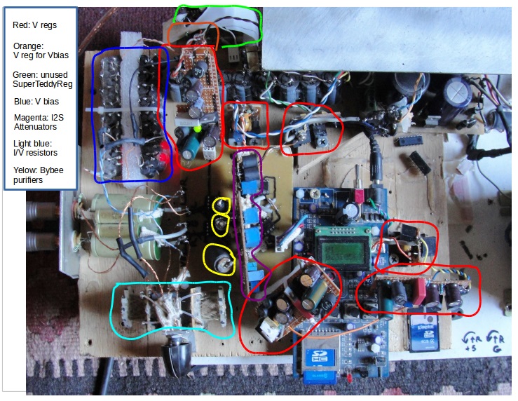

I attach a picture about the present state of my SD card player with dual mono TDA1543 DAC section, with lots of Vregs. The adddition of John's shunt regulators to the SD player's clock and main receiver chip made a big improvement and took out some "digital" sound that was still there. :cool:
I hope I will good news soon ;)
M.

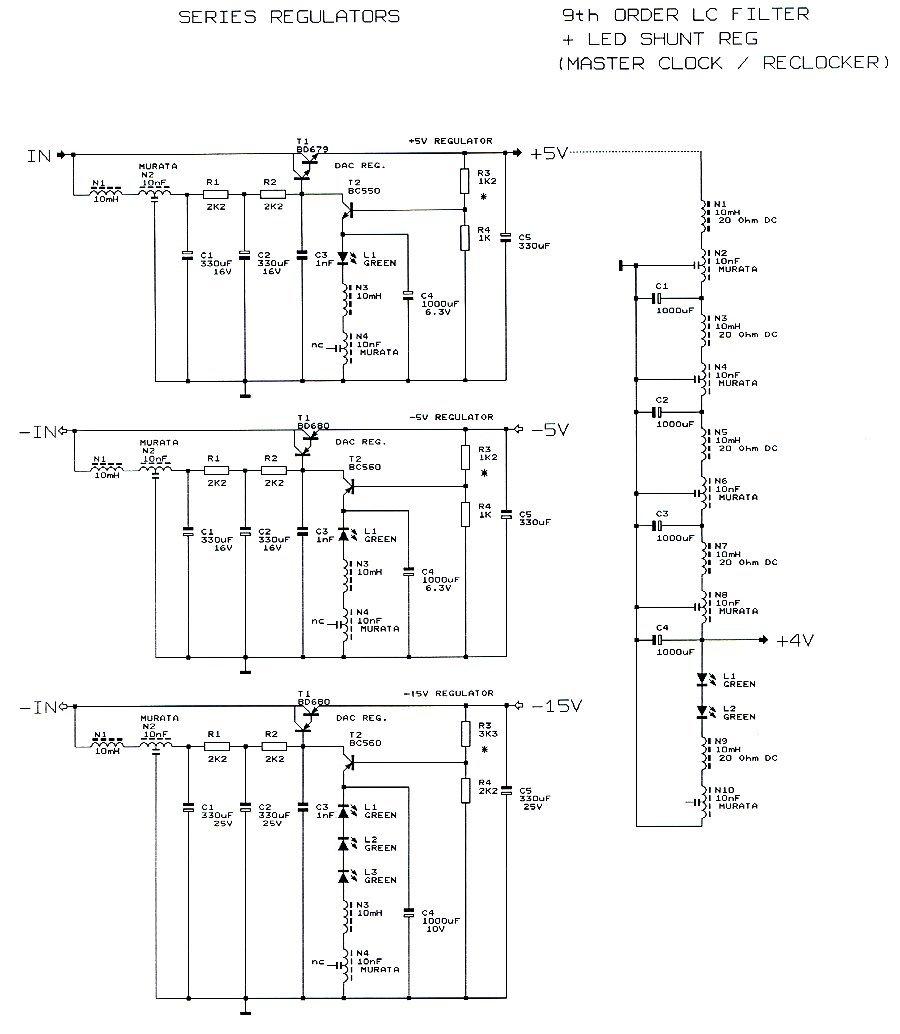

Hi Max
Shunts to main receiver chip !!!!.
I think it's the main receiver chip. Sorry, it is covered by my magic varnish so I can't read what's writen.
I attach the schematics. Vout depends on Vin and R3/R4, or something like that. I added a pre-reg to be on target on some spots.

The upper schematic is the (+) shunt regulator but you have to modifye the R3/R4 or use a pre-reg, given your Vin and your desired Vout, if you don't have the chance of getting the perfect Vout already.
The +4V from LC filter can be used as a very silent Voltage bias for the TDA1543 DAC chips. Use that and a high quality wirewound R for I/V and you will have a worthy DAC.
I took the liberty of compounding a schematic of different schematics from -EC- and that is what I am using now. This is not "-EC- approuved" yet, guys.

Sorry, I should have explained that before. That circuit allows for either powering both, the DAC chips and the V bias from the same quality V reg, using P1 to set V bias, OR using a quality reference as the LC circuit (you can omit P and C if you like) shown above to set V bias independently of the V reg for the DAC chips. For setting V bias you have to consider the value of I/V R. In this dual mono setting I out is doubled so for a 500R I/V that I use, V out is 0.0046*500= 2.3V. I set it to 4.2V to be safe...other idea that I have not tested yet is using only Pin 8 as output, in which case Vout is halved...
I have used VCC as low as 3.8 and I think I prefer lower (5.3 to 3.8V) power as it sounds cleaner. The chips are already warm sounding so the added warmth that high VCC gives is not needed in my view, wastes heat and may add distortion.
Maybe -EC- measured that time ago; I'm not sure...
Note that the circuit allows for AC coupling (return to ground) or DC coupling with P2, which I have not tested yet... :eek:

Hi maxlorenz,
Hi -EC Designs-
The DAC has galvanically insulated supply and the next stage has a galvanically insulated supply. GND (0V) of the DAC is -NOT- connected to GND (0V) of the next stage. The GND of the next stage is connected to RGND (reference ground) of the DAC.
So basically all circuits are connected to GND as usual, except the DAC local "0V GND" is a negative voltage with respect to this GND.
Just imagine your next stage is a multimeter with its own 9V battery supply. The GND of the multimeter (black wire) is connected to DAC reference voltage (say +2V) and the input (red wire) is connected to the DAC output that also has +2V DC (all measured with respect to DAC true GND). Then the multimeter DC voltage reading would be zero.
This approach is different from using a coupling cap. Even the best coupling cap will add distortion and causes loss of resolution.
The output signal now connects directly to the next stage (DC-coupled). GND return path connects to a power supply with very low output impedance that can be bypassed with a low ohmic resistor. When a coupling cap would be bypassed with a low ohmic resistor its degrading will be greatly reduced, but then it looses its function of blocking DC … The RGND approach does not have this problem.
Similar to a coupling cap, every active circuit will also introduce distortion and loss of resolution. The more active circuits / components in the signal path, the worse it will get.
Hi maxlorenz,
Thank you, dear -EC-, for the detailed explanation.
So, for me, the best option is to run the output of the DAC through my high quality TVC...or build a DC coupled preamp/buffer stage with floating supply.
