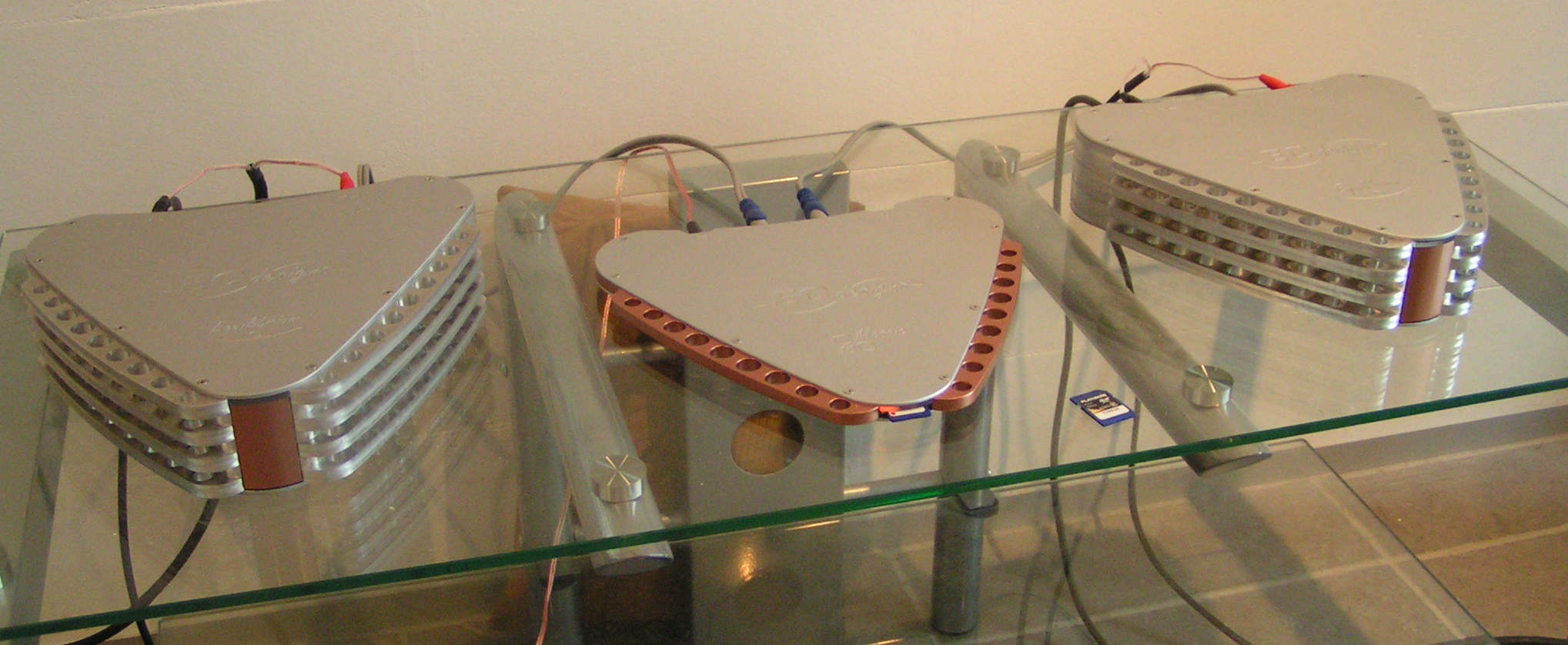

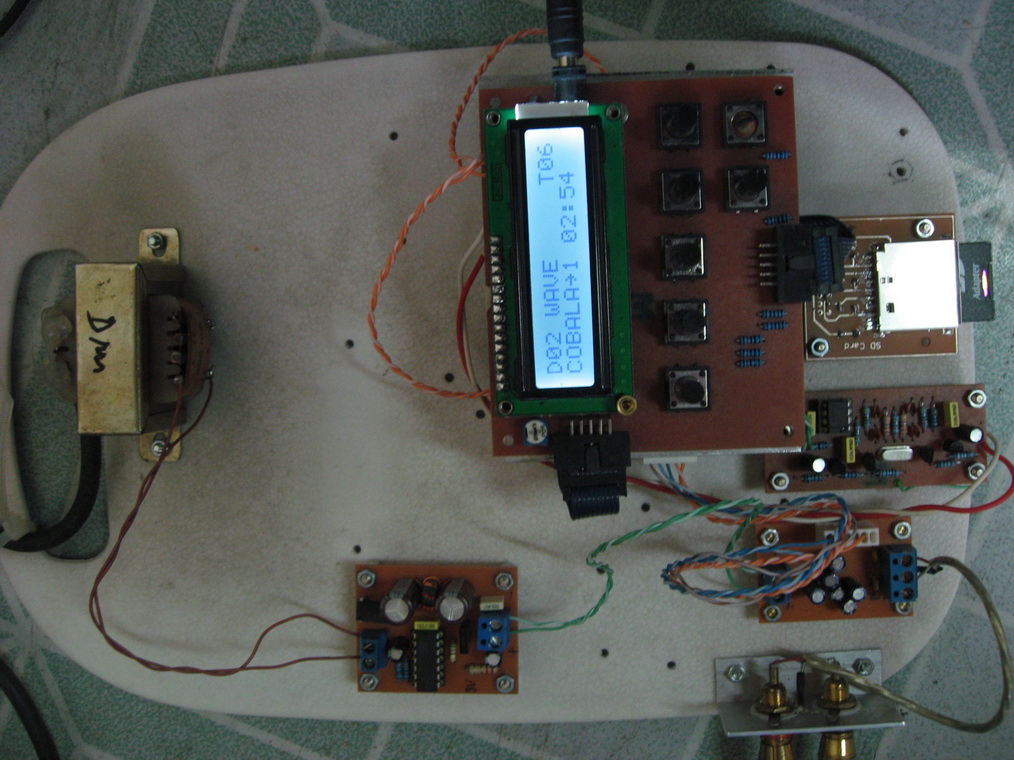

I'm having great fun modifying my new DUAL-MONO DACs, based on the humble TDA1543... 😀
The SD card player coupled DAC is now playing sweet music in the "direct out" (passive IV; removed the transimpedance amp) and with attenuators for the I2S signals (including RR and LL DATA).
Removing the active circuits caused only a little lower bass output, which was excessive anyway, so I don't miss it all, and "all the rest" improved. Terribly energetic this DAC is, yet much more refined than its predecesor.
Next experiments are: using separate quality voltage regulation for each subunit; and since Vout is plenty, using only Rout for each mono wing.
In fact, I am thinking about trying the passive route for my beloved "scrambler-interpolator DI4M DAC", using 4 honeycomb I/V resistors (and 4 V references) and going for the ballanced output direct coupled to my TVC. The perfect match of the VDCout in each fase should cancel at the transformer and spare it...or use output caps, no worry...

Where did you get the SD player from?I'm having great fun modifying my new DUAL-MONO DACs, based on the humble TDA1543... 😀
After all this I have a request for John:
In the past, you have recommended several combinations for the I2S attenuators and I would love to read the philosophy behind, since I only grasped the surface of it. From my experiences with various sources, I decided to keep the series 3K3 resistors and use variable resistor pots for the G and V+ resistors. That way I can adapt and get the DAC chip to "lock" the signal, with different resistance combinations, though from time to time a get in troubles...maybe for low voltage sources it is better to use lower series resistance...
From my measurements, High state is (+)1200mV and Low state would be something under (+)800mv, for a signal amplitude of (+)400mV, pk to pk. Correct me if I am wrong.
Can you comment about the variables to consider and choose the optimal resistor combination and achieve perfect function?
I would be (I am) very grateful. 🙂
Best wishes.
M.
-EC's- greatest fan. 😎
Koldby
Google QA 550 SD card player.
Here a discussion:
http://www.diyaudio.com/forums/digital-source/150199-qa-550-sd-card-16-44-1-wav-transport.html
M.

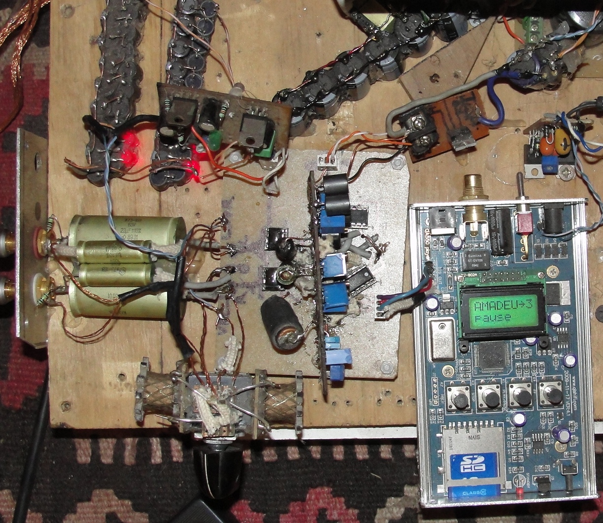

What kind upgrade do you have in mind ?
I build similiar player from koon (member of diyaudio)
I was thinking about improved Vregs for the main chip and the clock, and also about adding buffers for I2S.
Maybe someone can recommend the best buffers: here I have 74HC125 at least.
Best wishes,
M.
