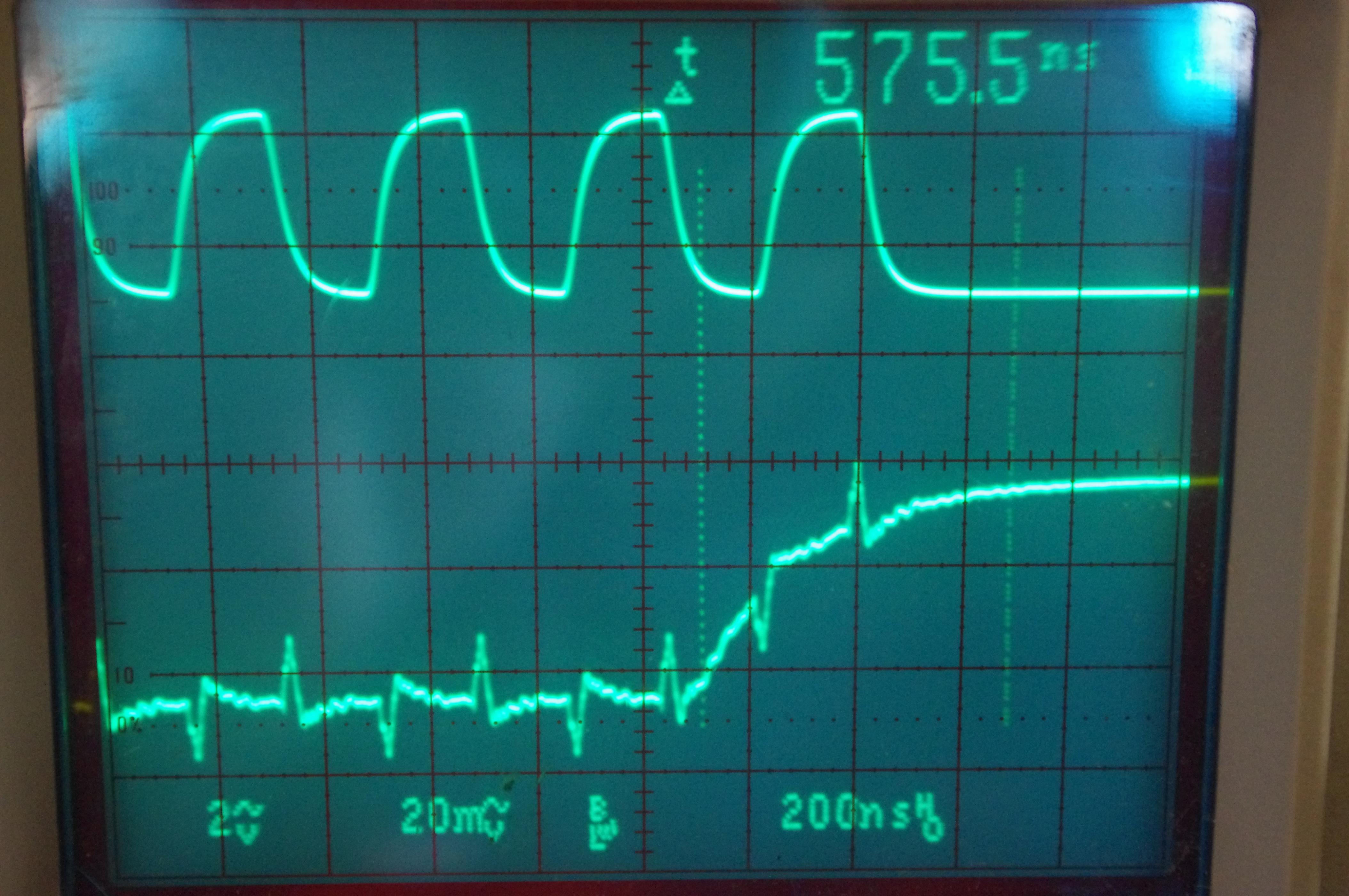

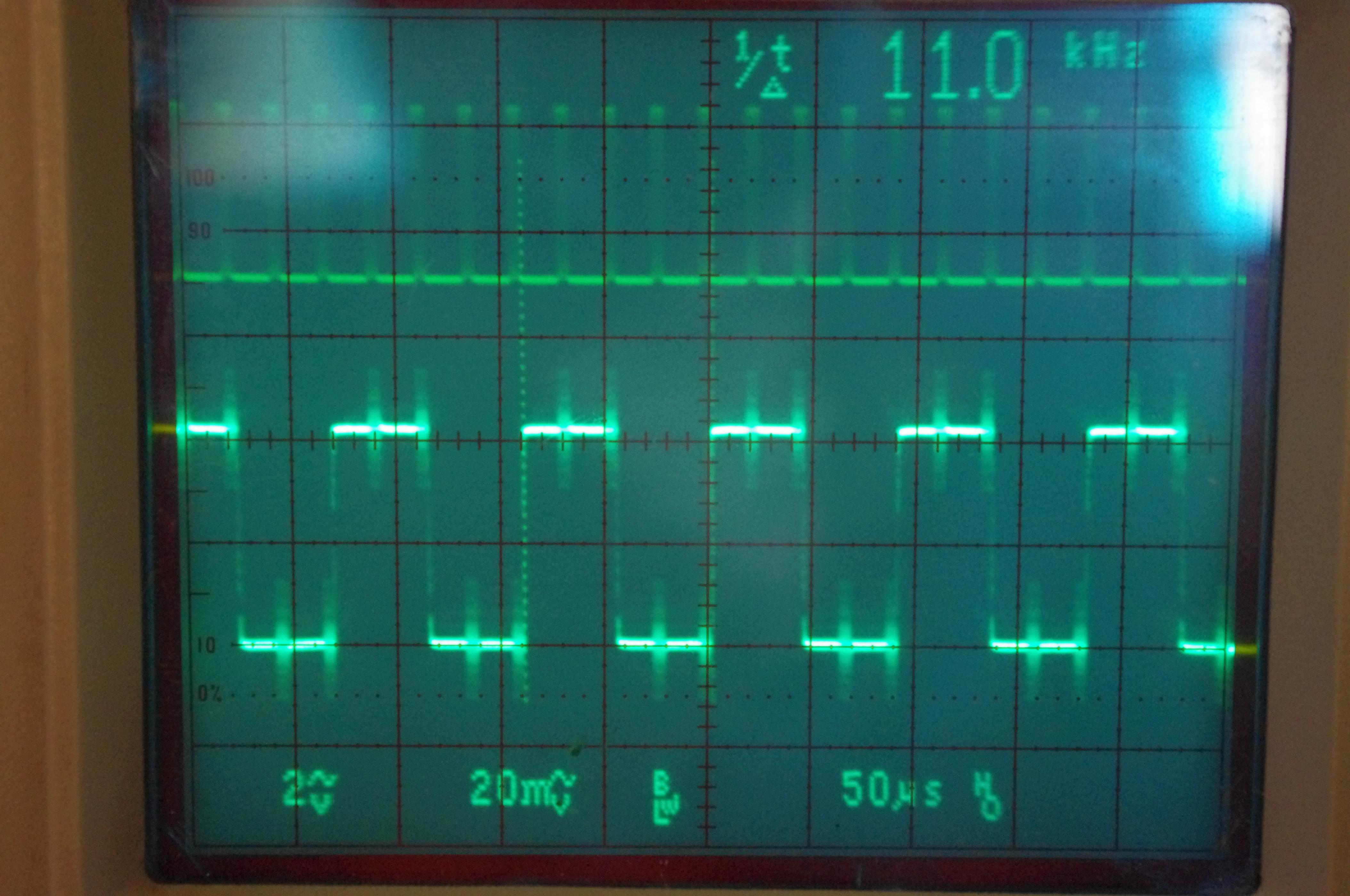

Scope shots
Hi Fellas,
Dont mean to litter the forum with scope shots, but just wondering what exactly is going on here (aside from the noise from BCK on the Analog outputs) It looks like the sample starts before the least significant bit is clocked in? According to the data sheet (TDA1541A) this shouldn't be so - Unless i'm not clear about something. 😱
Also notice how much BCK is visible on the Analog outputs without I2S attenuation - Hope to change that soon.
Bandwidth limited,
Top trace is BCK using only 50mhz probe - hence the slow rise time.
Bottom trace 11025hz square wave at full scale current output.
Simultaneous mode.
Ryan

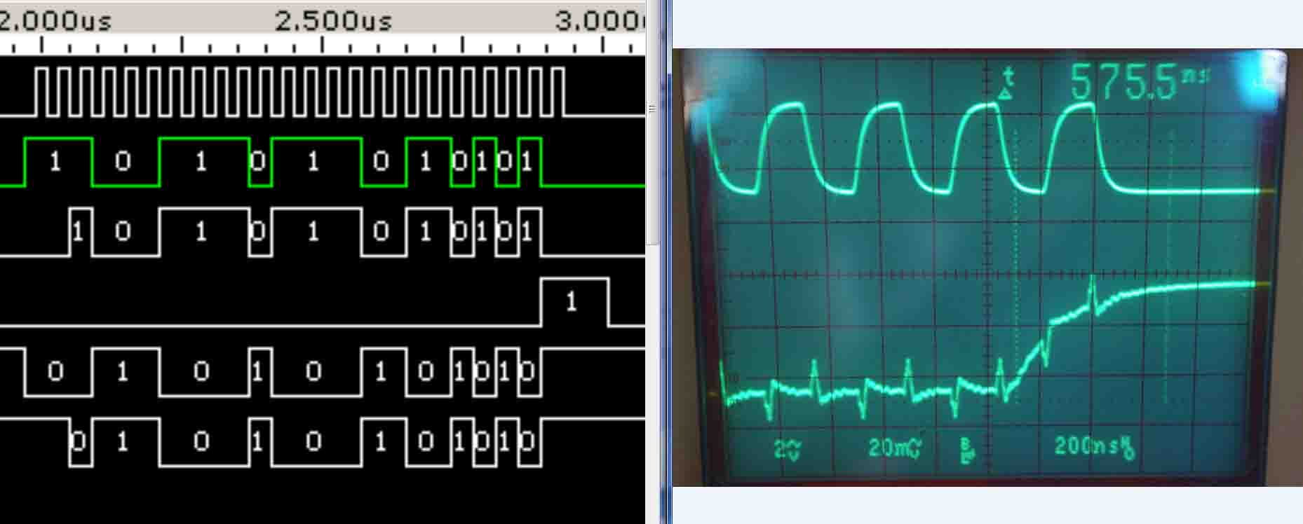

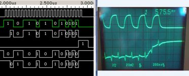

Hi Guys,
Seems offset binary format works a bit different than time multiplexed mode. The sample is triggered on the positive going edge of LE - latch enable. Ian Canada has provided some logic analysis of what his PCB is doing. Looks like my scope shot shows what should be expected. Nothing to worry about. 🙂
Image to the left:
BCK
DATA L
DATA R
LE
DATA L inverted
DATA R inverted
Image on the right:
BCK
Analog output - 11025hz square (corresponds with LE on the analysis)
