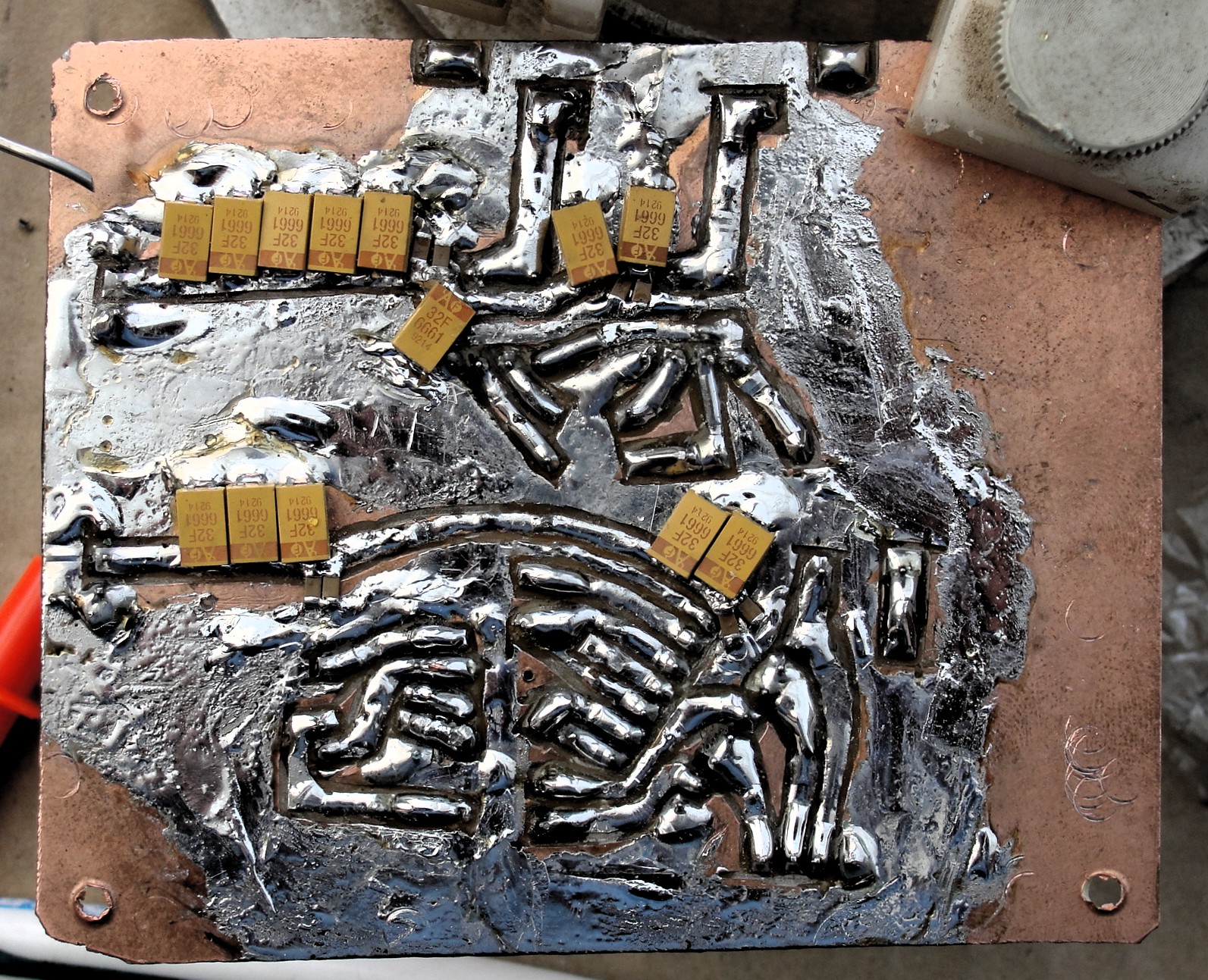

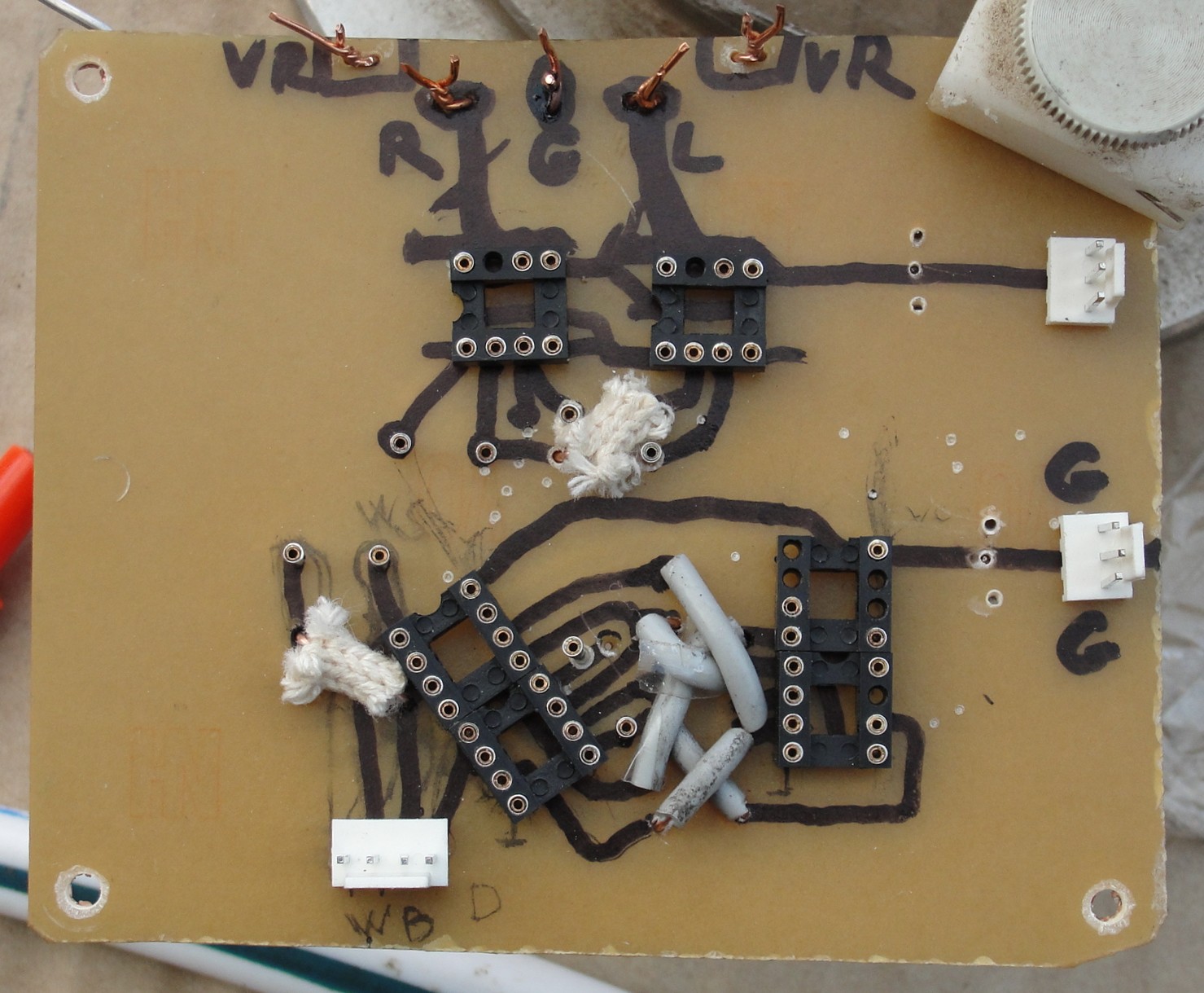

Yes dear Eldam, I am better than CNC machine tool, hehe. I used a "Dremel". Not ellegant but eficacious.

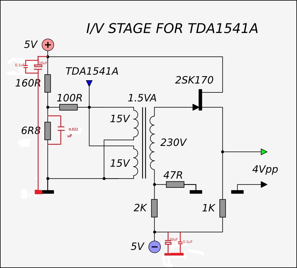

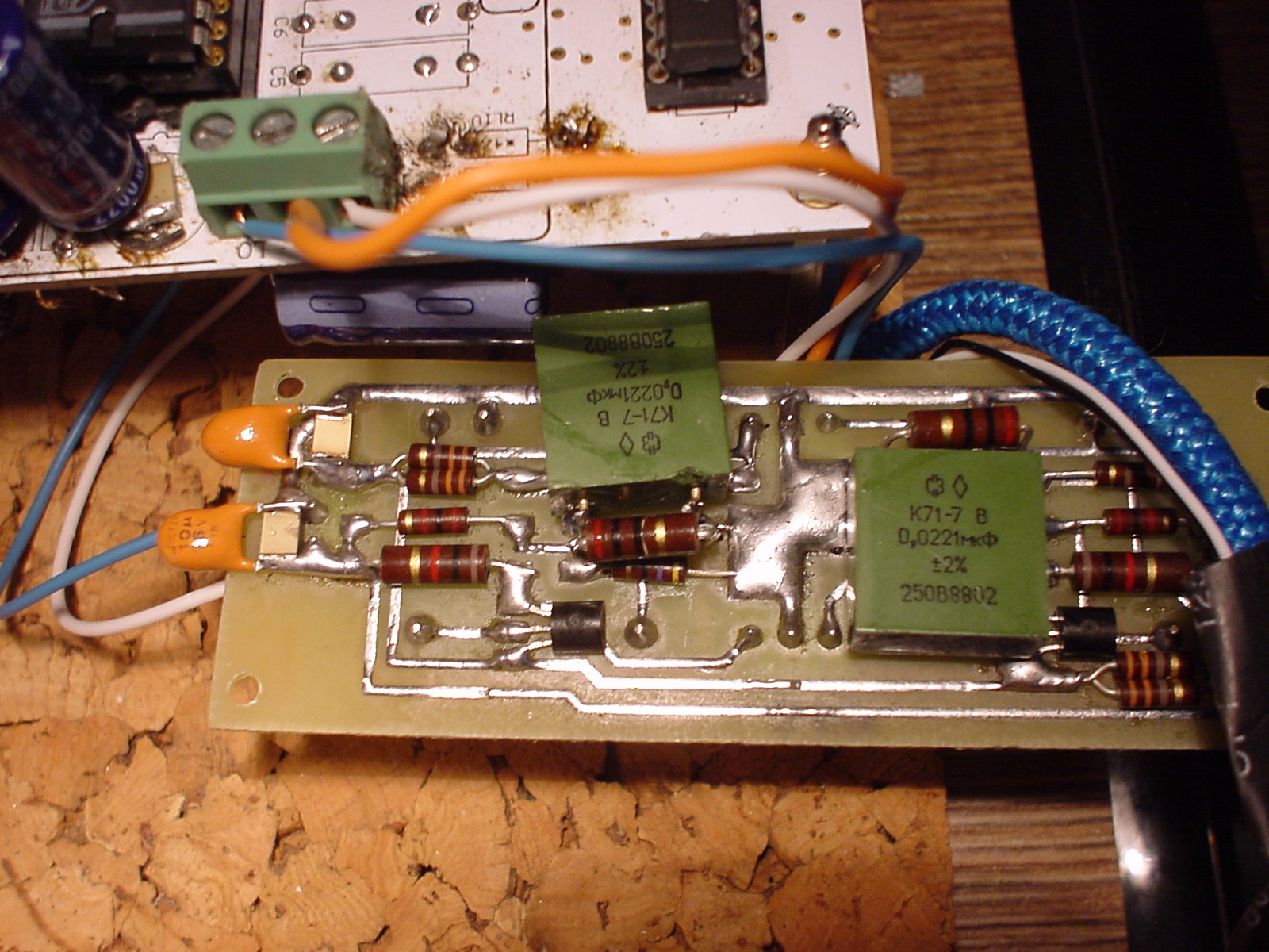

I have implemented the suggested shema and I am happy with it, thanks. Some minor changes, all resistors OHMITE nonmagnetic carbon comp, litycs VISHAY SAL, bypass Pana solid,Russian styrol NOS.
As soon as I can afford it will order better trafos with same or similar ratio.
Ignat

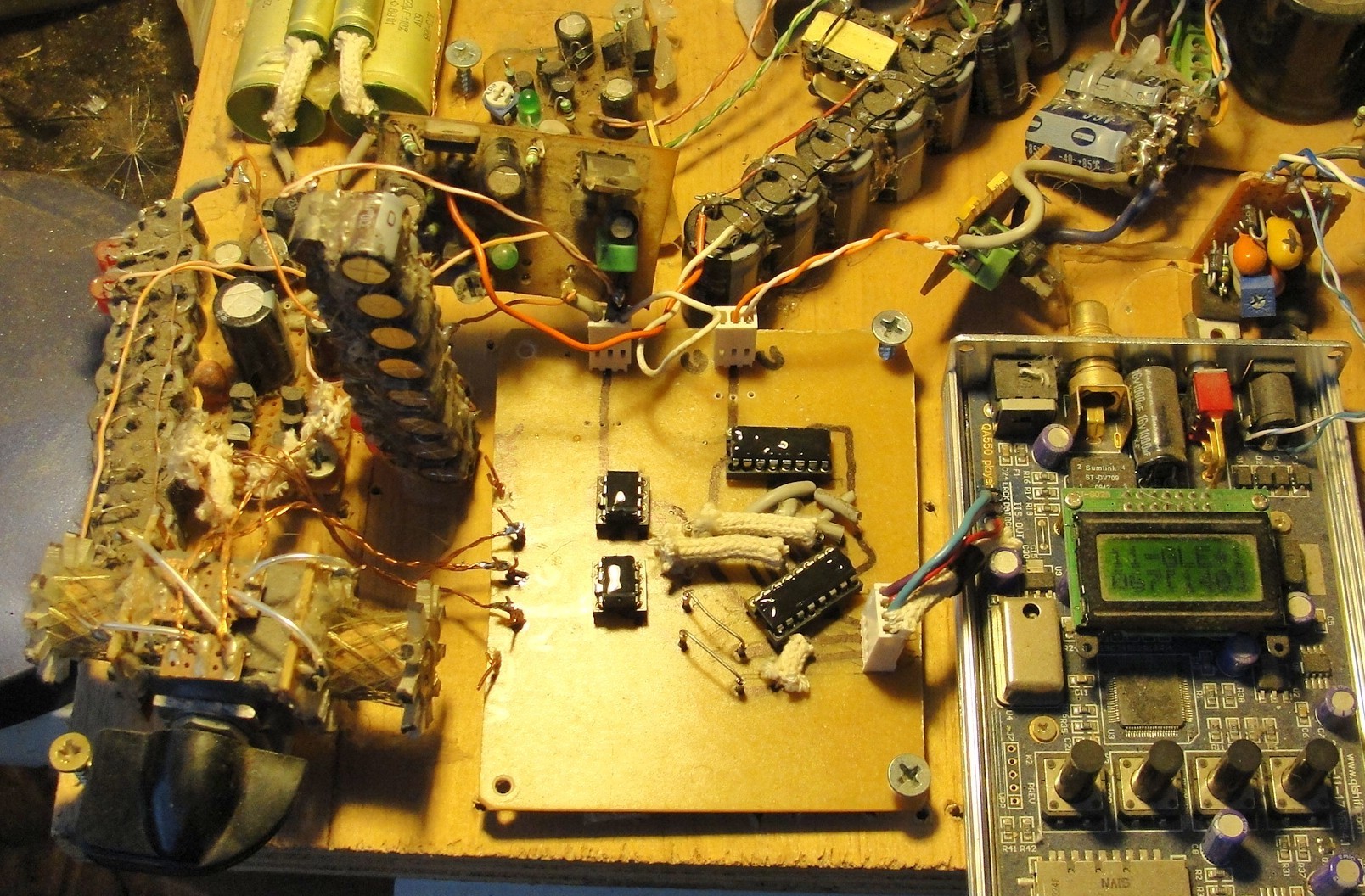

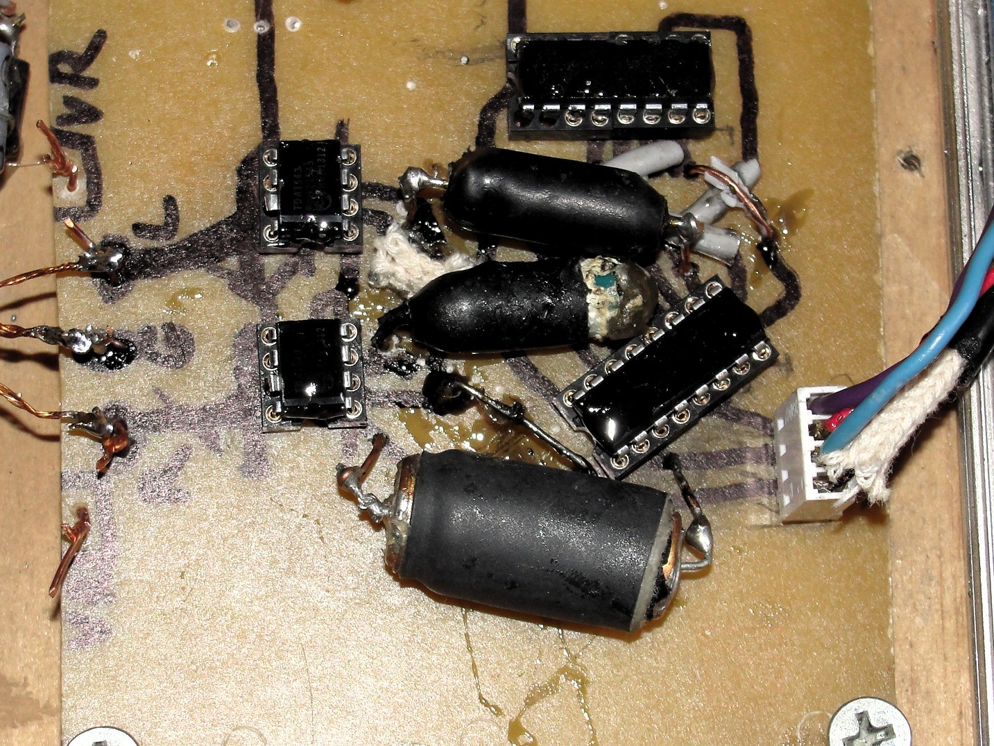

Second DUAL-MONO unit...
without problems this time.
This goes into the SD card player with "variable resistance-transimpedance amplifier" output, but I think now that it is excessive and perhaps I shall go direct out though "variable resistor" and maybe DC coupled with John's idea.
Sounds very powerful, but I miss the Bybee's in the BCK and DATA lines from the previous DAC.
I have still to add the 1uF film caps on the power pins of the DAC chips.
How to select the best 1543 DAC chips without expensive equipment??? 😕

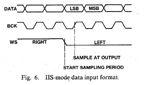

Hi maxlorenz,
The I2S interface is a necessary evil with all existing DAC (chips). I2S switching noise spectrum crosstalks through the on-chip circuits and changes the DAC chip output spectrum and related sound signature. This impact is rather big and it contributes to the typical digital sound signature.
I2S attenuators and I2S signal bandwidth reduction help a little bit but won’t solve this fundamental issue as the on-chip circuits copy and distribute the I2S switching spectrum.
Late 2014 when I used DAC chips for the last time, I used a different I2S clocking scheme and two DAC chips. This reduced the impact of I2S switching noise by 75%.
Now with Bybees...

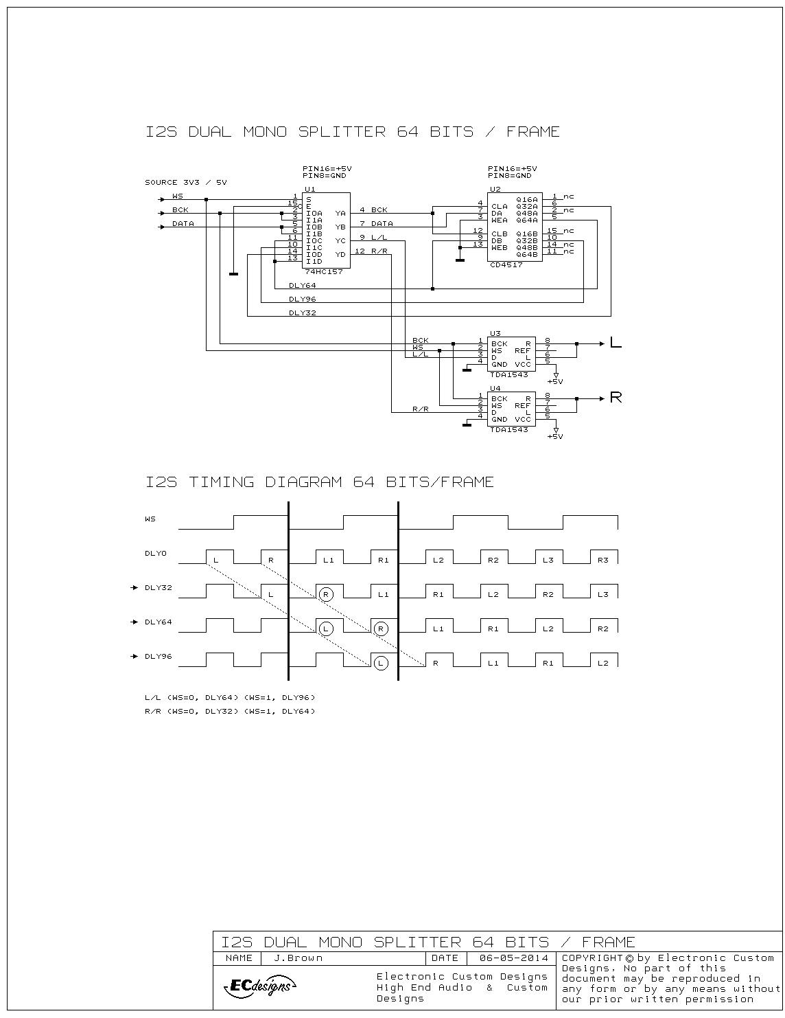

1) can we know the different cloking scheme you referred to above?
L channel DATA is clocked in R input register of TDA1543 #1.
R channel DATA is clocked in R input register of TDA1543 #2.
So all L & R data is clocked in with 16 clock pulses when WS is “1”. Only the Right channel of each TDA1543 can hold data as DATA can only be clocked in when WS = "1".
Then BCK and DATA signals are shut down completely (total switching silence on the chip). Since I am only feeding clock signals to both TDA1543 chips during 16 of the available 64 pulses I reduce average switching noise levels by 75%.
In order to latch the outputs of both TDA1543 chips I multiplex a LE signal on BCK that produces a single LE transient after WS has gone low.
So the BCK input of both TDA1543 chips acts as both, BCK and LE input. This all is within the permissible specs of I2S.
By reducing on-chip switching noise by 75%, on-chip jitter levels are also reduced.
This requires a suitable I2S to quasi simultaneous mode converter. L & R signal data needs to be lined up too, this requires some shift registers.

OooK. I'll try to digest your "silence mode" DAC arrangement... 😕

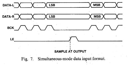

I seem to recall the TDA1541 datasheet talked something similar to this...edit: figure n°7 of the presentation paper to the IEEE by H. Schouwenaars at al.
