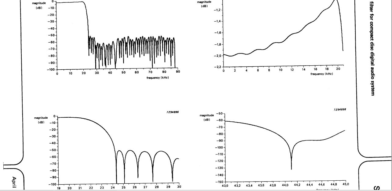

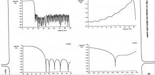

SAA7220 filter characteristics
See attached SAA7220 filter characteristics. I was aware of the peak inserted from forum poster comments on the Analogue Devices application note AN207. http://www.analog.com/static/imported-files/application_notes/383160163AN207.pdf
I'm still looking at the charts for the overall characteristics but leaning towards 'worse than I thought'.
It looks like Phillips took the SAA7220 innards and put them into the early stages of the SAA7320 (DAC3). I don't know if any of those actually got to market. Strangely the SAA7320 has the option of 4XI2S (instead of the 1 bit dac) for 'high-performance'.
Isn't this SAA7220 curve the slight "lift" that many search for in their non-Oversampling filters?
I have attached the note from the SAA7320 datasheet which I believe includes the Saa7220 filter in it's internals.
I think you mean the sin (x)/x Roll Off. I'm not sure on that one. The SAA7220 datasheet also refers to a +5% DC offset.
Its a lift but its much slighter, due to this being for 4X OS, not NOS. So only around 0.8dB lift is needed.
