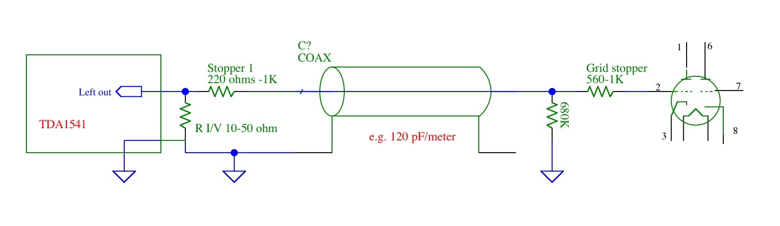

Now I can't calculate: but the influence is beyond the few hundred kHz. There is "nothing" parallel to the I/V. So there is no influence in the "passband", which is audio.
Something is wrong /could be my understanding/ - the I/V resistor stays there and the voltage goes straight to the grid of the triode -if he stopper is from the grid to the ground it is in parallel ?? or I am mistaken.

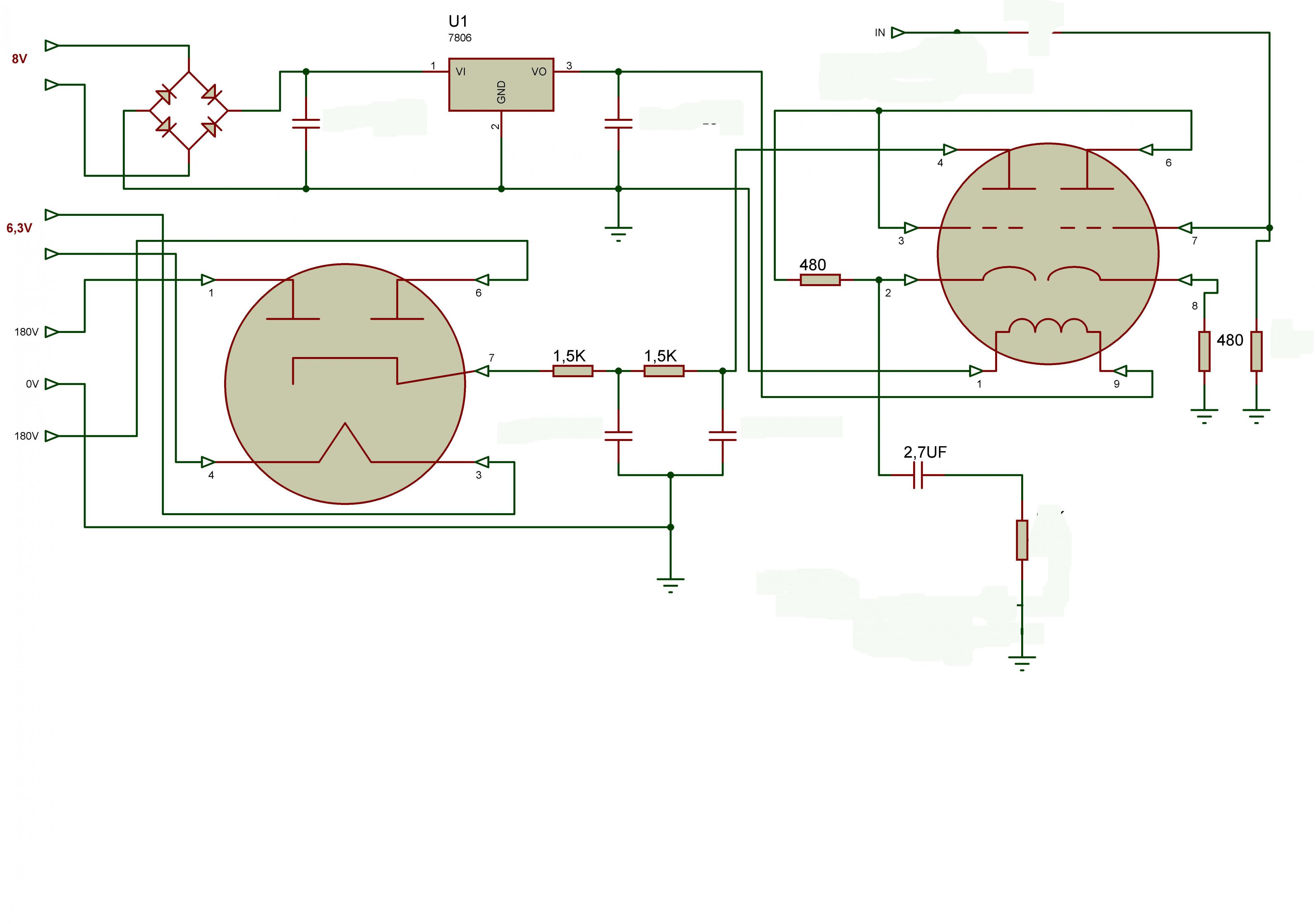

Just for your reference - my very simple tube buffer /in my case with Bendix 6385/ - just a principle schematics - to be revised.
Ignat

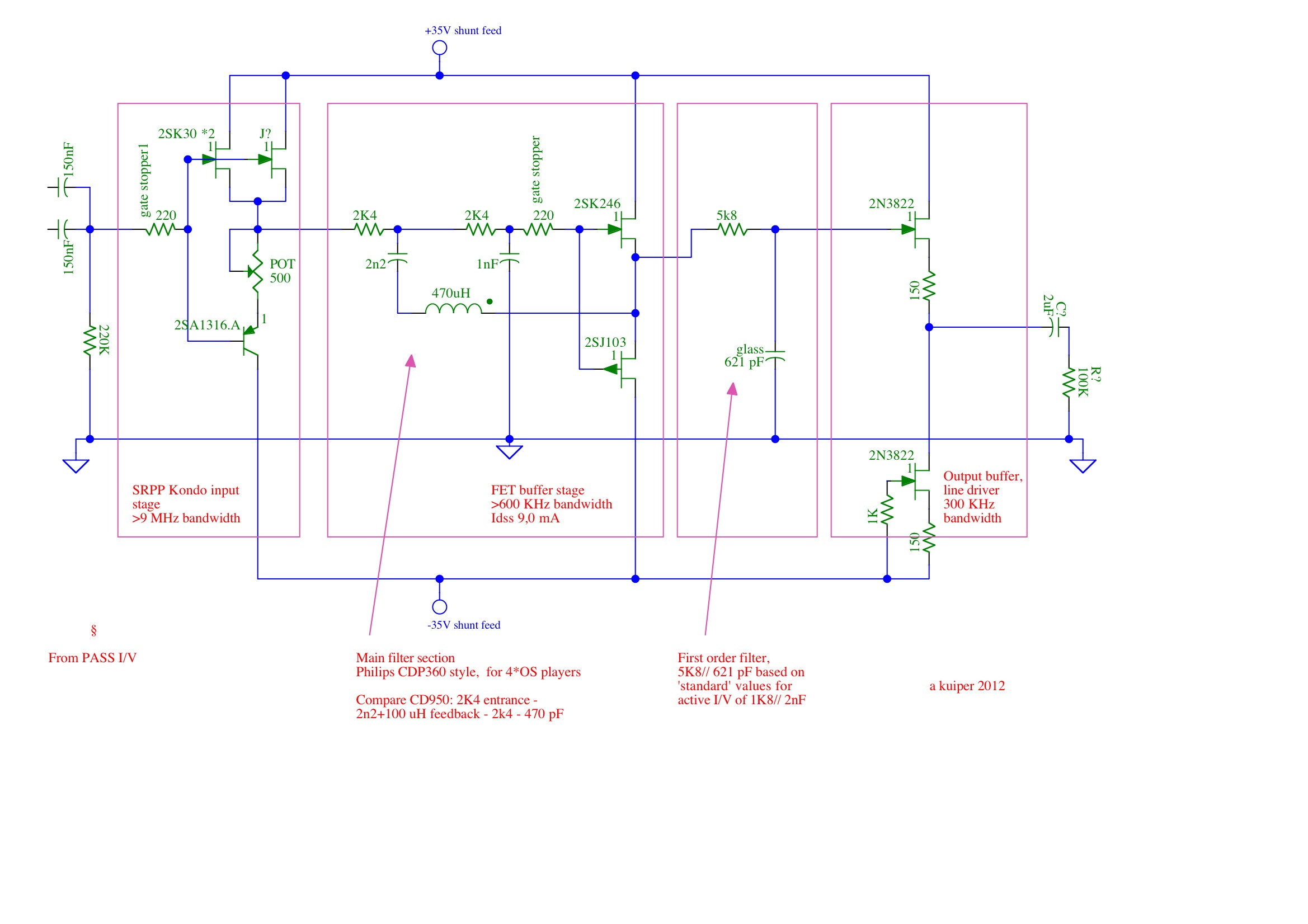

I attach a design record.
The first stage is called a Kondo stage. The whole filter amplifies: none. Bandpass : around 21 kHz.
albert
Note: This filter derives from the standard Philips concept of the TDA1541 players. It is such that it maximally compensates for the SAA7220/TDA1541 combination that already has a small uplift around 20 kHz to compensate​
My problem of writing took much words.
here is my idea:
The Stopper1 prevents extreme HF noise to be propagated in the connected line. I have depicted a coax, which also serves such a purpose. And the drawing suggests not using the shield as interconnect for the earth.
albert
  • I:V connection.jpg
    I:V connection.jpg
here is my idea:
albert
