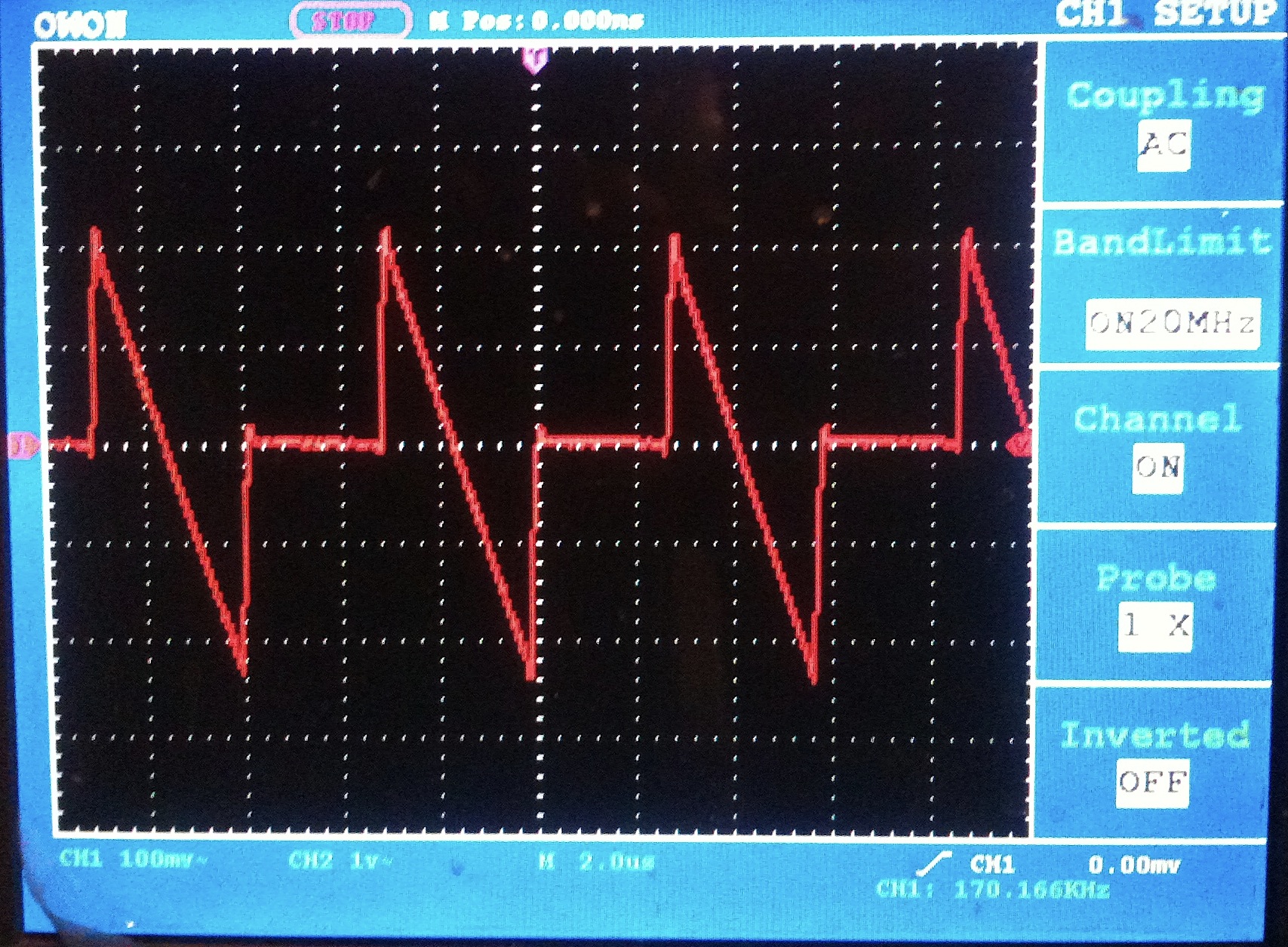

I will measure with the scope dem signals, in factory proposed circuit WO dem R it was just like it should be...
So it is working with TDA1540 too.

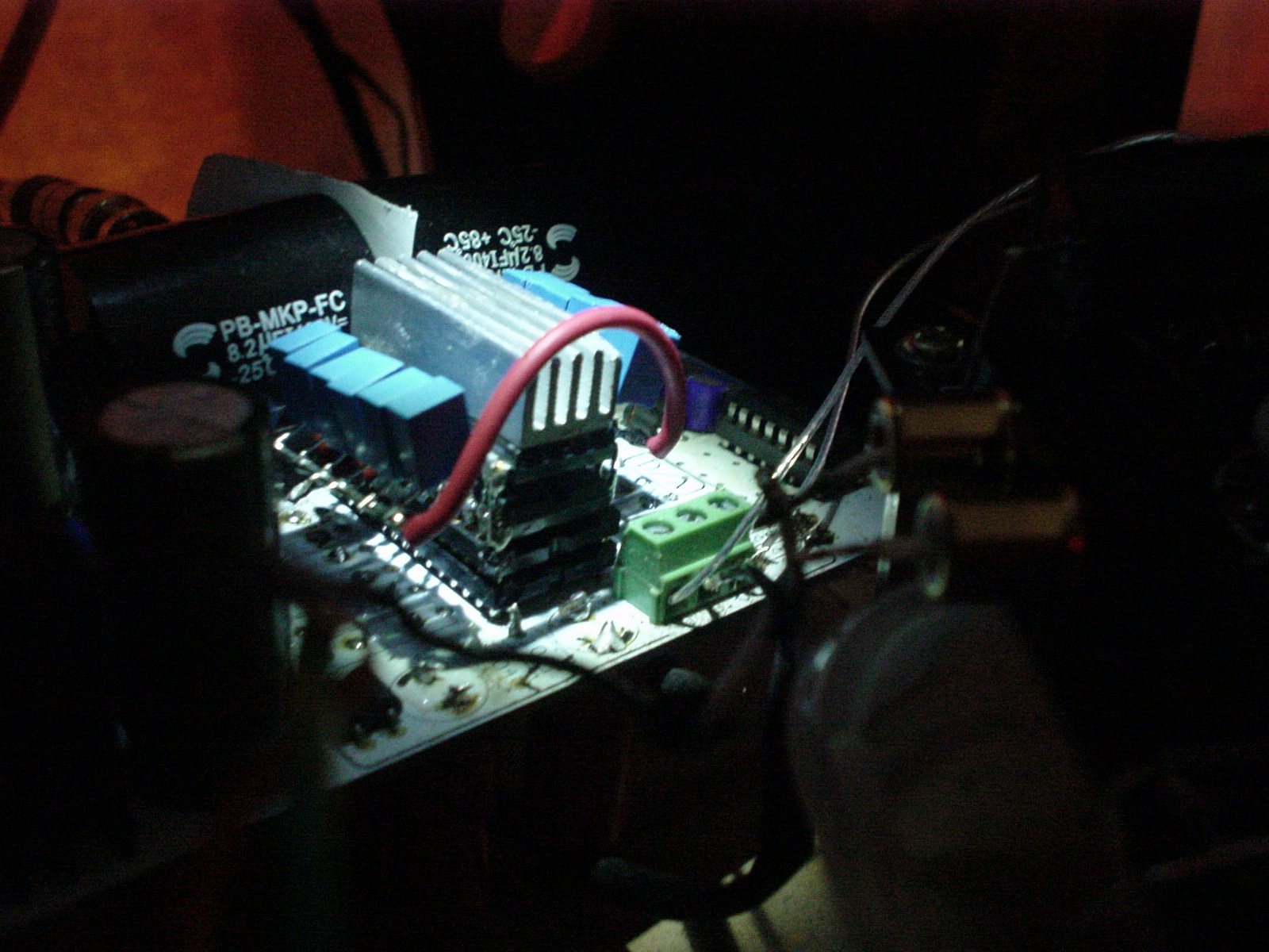

One thing could be of the interest for TDA1541A funclub. The temperature.
Once I have some CD players with the TDA1540. And the chips are somehow get more than warm?
in my simple set up the chips are just slight warm (maybe because of the open experimental housing)
But I made experiment and I mount each TDA1540D on the bigger heatsinks.
temperature decreased additionally, and I think that the sound is more clear and even with less distortion?
So I recommend that for the TDA1541A too - to mount on the heatsink - bigger.

Hi Zoran, do you mean we have to apply heavier heat sinks ? What about the temperature required /or suggested/?One thing could be of the interest for TDA1541A funclub. The temperature.
The temperature of My ceramic TDA1540D is about or little bit under body temp.
it is hard to tell (I will try to measure) without any heatsink and in open housing.
I put all the elements at one and chip to another side of the board, so I have all space to aproach to heatsink. I didnt put the thermo white fluid for better heat conducting, (dont want to poluting chip from the top - yet...)
As the temperature lower the sound is clearer, it is better to be under room temp but there is hard to acheive, so please tru with just possible to mount as bigger as it could heatsink.
You will spot the diferents 🙂
And I am pretty shure that is can addressed to TDA1541A chip too.

for instance it will be nice to have the heatsink like Yours BUT with tha same flat area like on the area to chip top comtact, then You can mount bigger heatsink over?

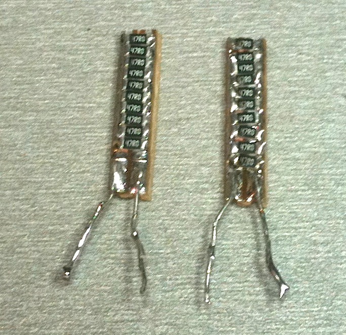

I made some quick Riv from smd Rs, there are 10 x 47R in parallel for 4,7R Riv
first version, now I am using (red one in the pic) 20 x 100R for 5R
booth version with simple jfet BF245 2mS set current injection.
You can see the heat sink on the top of the dac chip.
and factory just 820pF simple ceramic dem cap signal at dem pins measured.
