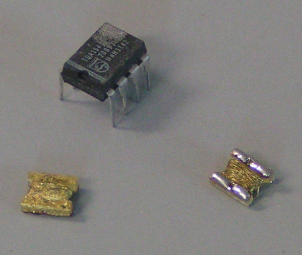

The reason I/V resistors change the output spectrum and related sound is that these are driven by low level, large bandwidth signals.
50 Ohm passive I/V resistor with TDA1541A resuts in 200mVpp full scale and LSB corresponds to 3uV.
The Rhopoints consist of two counter wound windings with non-ideal magnetic coupling, so these are stil inductive. Noise properties (mainly depends on weldings) on the other hand are excellent.
What we need for transparent sound reproduction is an I/V resistor with lowest noise and lowest inductance.
Here is an article about resistor noise:
Resistor Noise » Resistor Guide
Good wire wound resistors offer even lower noise compared to bulk metal foil.
The weak spot is the welding or bonding between resistor wire or resistive element and the lead wires. This may be (one of) the reasons why bulk metal foil resistors disappoint as I/V resistor.
During development of the new projects I built my own 50 Ohms non-inductive (twisted bifilar winding) wire wound SMD resistors. Attached picture shows the tiny wire wound resistor that is placed on a CNC milled PCB coil former.
