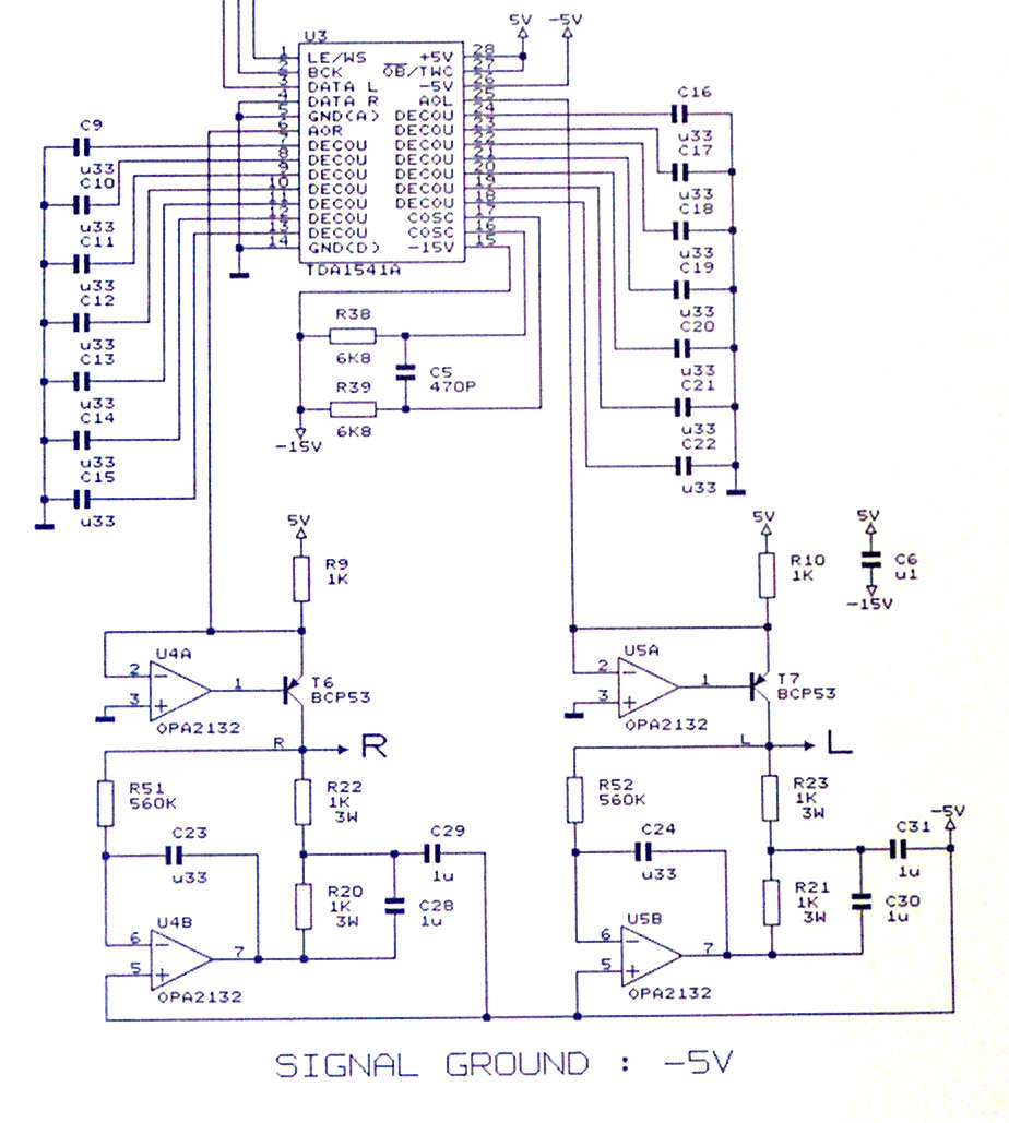

Anyone use op amps on the output of the tda1541?
I used OP-amps in a dual DC servo circuit (attached picture).
It was used in the final TDA1541A projects SD2 and UD2.
Signal ground is connected to the -5V supply that serves as “ground reference”.
T6 and T7 are current buffers that feed I/V resistors R22 and R23. R20, R21, and C28 ... C30 serve as spectrum shapers (experimental). When spectrum shapers are not required, remove C28 … C30 and short circuit R20 and R21.
U4A and U5A are used as DC servo that keeps DC voltage at the TDA1541A output at zero.
U4B and U5B are used to keep DC voltage on the outputs at -5V. This way there is no DC between -5V “GND reference” and outputs so the coupling cap can be eliminated.
This circuit fully meets TDA1541A output compliance of +25mV and -25mV.

Hi, I would be interested to know 3 things regarding this "never seen before" implementation :)
does it have the standard 2 VRMS output voltage?
what are the power supply voltages used by you for OPA2132 , is it +/- 15V?
can this OPA2132 be substituted for an OPA2134?
thanks
Hi merlin 2069er,
How about this? Right from the TDA1541 spec sheet.
When you look at the beginning of this thread at post #5 you will see the twin DAC. Here I used an OP-amp based I/V circuit similar to the one in the Philips datasheet.
The major problems with OP-amps for this application are bandwidth, settling time, and limited bias current in the Op-amp output stage.
Similar to coupling caps, every Op-amp sounds different and no OP-amp will offer transparent sound.
If I had to choose an OP-amp for I/V conversion, soly based on perceived sound quality, I would probably choose the OPA627:
http://www.ti.com/lit/ds/symlink/opa627.pdf
One could attempt to design a discrete OP-amp in order to improve perceived sound quality, I used a discrete OP-amp for I/V conversion in the DI4M DAC (attached picture).

Hi Alexandre,
Ahh, now I see the HF current path, it´s through C29 and C31. Don´t remove those, fellows!

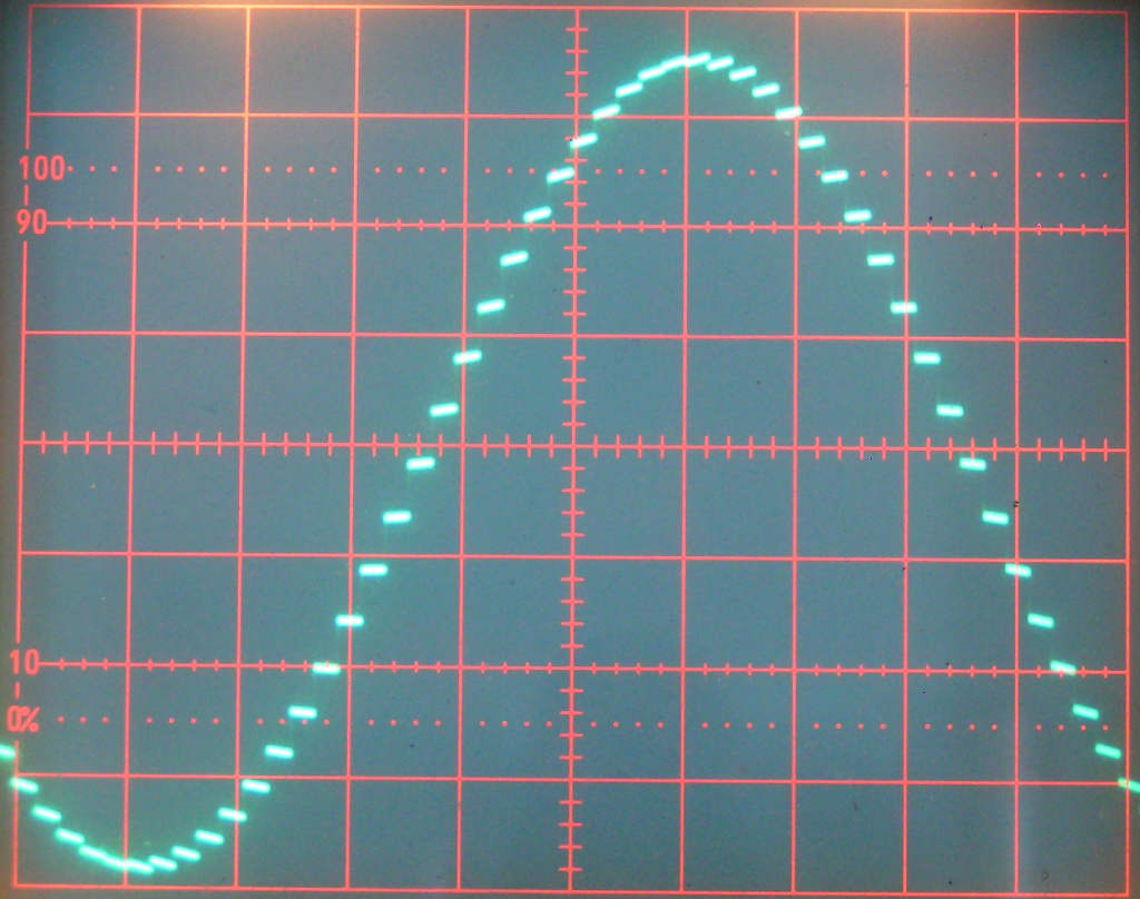

R20, C28, and C29 are part of a spectrum shaper (reactor). It changes the shape of the zero order hold signal into a sawtooh shape.
I attached a picture of the resulting signal (1 KHz)
The sawtooth shape is obtained by charging / discharging C28 / C29 with a constant current from the DAC chip.
The amount of “tilt” can be changed by the value of C28 … C30.
For plain zero order hold output signal simply connect R22 / R23 to the output of U4B and U5B and remove R20, R21, and C28 … C31.

But John, if you remove C29 and C31 the I/V resistors R22 and R23 would have one terminal connected to the DC servo only, leaving no good HF return path!
Let me expand this... Without those caps the path for the changing current through the I/V resistors now includes the opamp, which it didn´t before. Now, the current will go through the output transistor inside the opamp and out the opamp -V pin... correct?
Instead of "the changing current" I should say the HF components. I do understand (a bit, not yet enough) what I´m saying here... Looking forward to learn more of course, that´s why I care to post this.
Not sure how relevant it is in practice though, maybe the path through the opamp would be good enough (low enough impedance at said high frequencies) considering that the levels and frequencies of the HF components coming out of the philips R2R dac are not that high, compared to other DACs.
