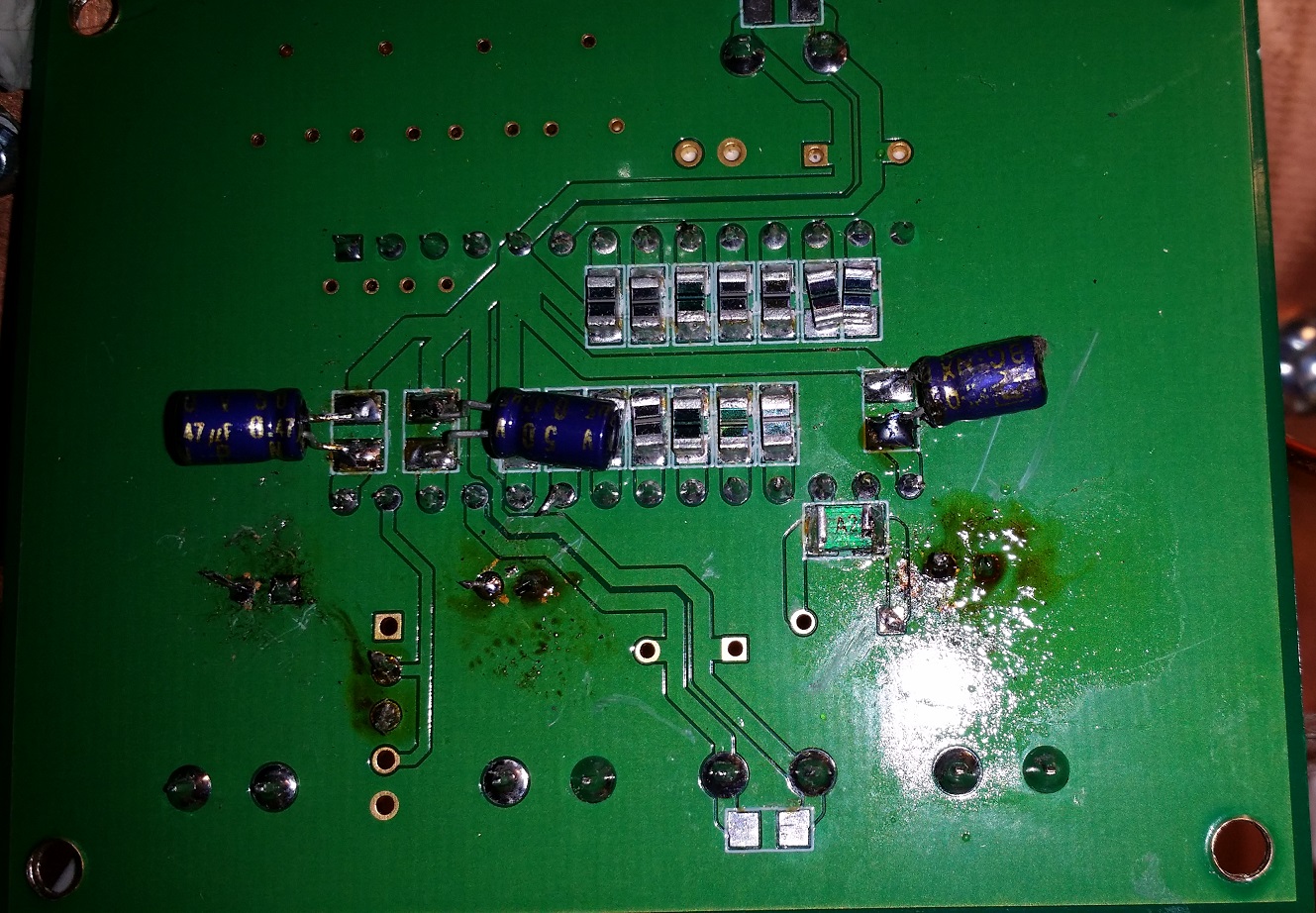

I removed the SMT film caps on the 1541a PS pins and replaced with..
-0.1uf BG NX HiQ on the -15v. Turns out this was the last one on hand.
-0.47uf BG NX HiQ on the -5 & +5v pins
These are fresh caps that take 100 hrs to settle. However out of the gate I can tell there is improvement. Just more organic. Less machine. Strings bite. A little more quiet between notes. Slightly more precise stage. Wood has a little more wood and brass.. well more brass.

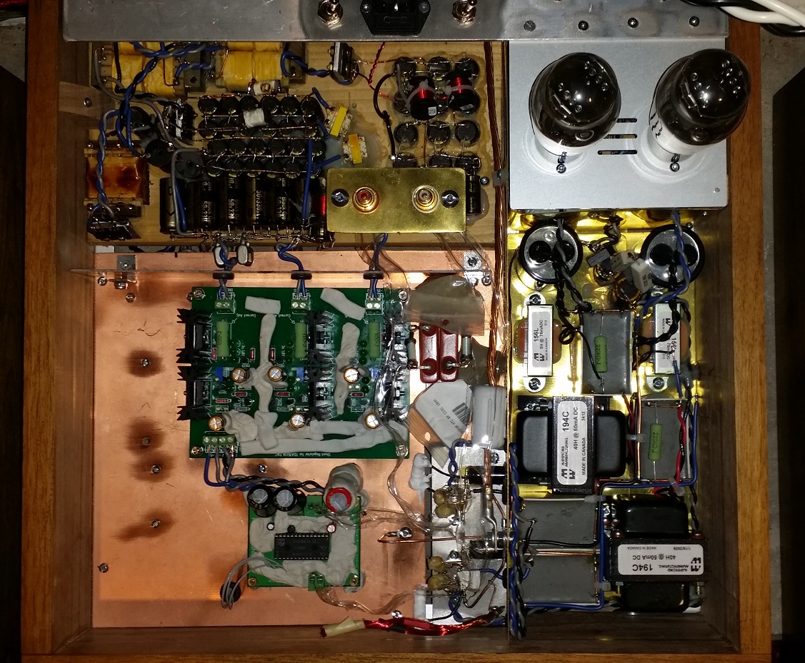

For reference a pic of the bottom and then the entire set on top showing PS's to the 1541a and the tube output. All the digital is below a copper ground plane and dac with its regs is the only thing in its own little copper faraday cage. Nothing as elegant as John's design or execution, but heavily influenced by this great thread.

The 2 big caps after the shunt are 16v BG FK 470uf on the +-5v supplies. These were a nice sound add at the time I still had the Oscons on the pcb. They are soldered, so sorry to disappoint, but unlikely to mess with them. The larger red cap on the -15v rail is a pair of BG NX 1000 wired in Super E style. I will try these in and out as I don't recall they made an improvement and they could be reused elsewhere.
I will say the current setup is sounding pretty good.. much better than with the smt film. Everything way more natural with improved sound stage. Every instrument sounds real and stands by itself instead of getting mushed into the others. Thanks for sharing your experience.
