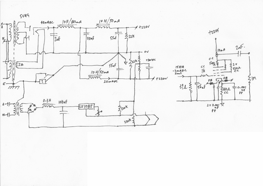

Some people might be a bit confused by Niamex's use of the 68R I/V resistor connected directly to the output pins of the 1541A dac chip
Just a remark - in my setup the current travels from the chip to the grid of a tube and the 68R is just there - between the grid's pin and the heater,s ground - it was recommended somewhere in the thread.
All the current goes through the 68Ohm resistor, as the grid dosent draw any current.
This is the I/V resistor.. depending on how you bias the tube (say -0.13V) you might get some grid current but with such low value of 'grid leak' the bias offset will be minimal and also I'm lead to believe quite linear in its effect/non-effect.
Of course, the lower value I/V resistor, the more gain is required.. and S/N factor becomes an issue. Consider d3A which has (apparently) the noise equivalent of a 70ohm resistor, mu of 77 and Rp 2k. 33-47R I/V seems about right. This is what I have playing right know. CCS loaded, minimal bias.. and it very good, to me, with my biases and issues.
The added bonus is that you can use 6688 which is a $5 10khr SQ Euro tube, E280F also but not $5. You need to be careful with oscillations. I can give some tips on that if you think it will help.

My Take - others will disagree.. DC heat the tube, schottky bridge CM 10R then 33kuF to LT1085A as CCS regulator.
Load the tube with a CCS try 5mA to 8mA, take output from 'mu' or upper resistor of lower ring of two transistors for Zout 1/Gm or there abouts - 2.2uF coupling cap to keep phase shift negligible at low frequencies and also keep output impedance (XC) low at the same.
Mu is like a 6922, 33 or so.. bias with tda1541A current through 39ohm, grid leak.. add 22ohm to each cathode.. use one triode per section D/A output left/right. No bypasses on cathode.
Add 220 carbon composite between I/V resistor and series grid. For good measure add 50R carbon composite between CCS plate load and plate.
You could bypass cathode resistors 22ohm with 0.001uF poly but with Gm being low enough, you'd be likely ok.
Thats a nice tube.. I'd swap for WE396A any day.
Use a tube rectifier with a heater for slow ramp up.. let A supply heaters come up first.
If you can, choke input (meeting critical inductance) to 100uF then LC split 10H to 55uF or such to each branch and you're laughing. Bleed 10mA across each final filter to help lower noise… and on one branch form a voltage divider to raise the heater (faux) centre tap to +35VDC or so, bypass with 2 to 10uF.
You wont look back..
.. Yeah ok you will. but it'll be fun.
Shane

Hi Shane,
Please share your schematics.
Goh
Hi Goh,
As requested.
This one is for d3A but 6688 E180F drops right in (e280F also).
You could probably reduce cathode resistor to 22ohms, perhaps even 10 ohms.. easy enough to play around with. The main idea is using the -2mA current offset from the 1541A to help minimally bias the tube, credit to Thorsten for the idea. The removal of the CCS injection scheme (to null for 0V at the 1541A output) probably also had some positive impact.
No doubt there are better circuits out there.. but this one is quiet, has good drive and low output impedance and was fun to build ( I cant solder solid state bits very well)
Shane
