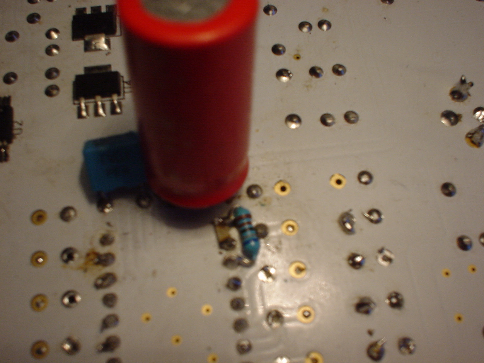

I now use a 100pF SMD mica cap from Cornell Dubilier
This capacitor should be placed as close to pin 16 & 17 as possible.
I attached a picture of the SD2-player prototype.
You can see the two MELF resistors and the mica cap close to pins 16 & 17.

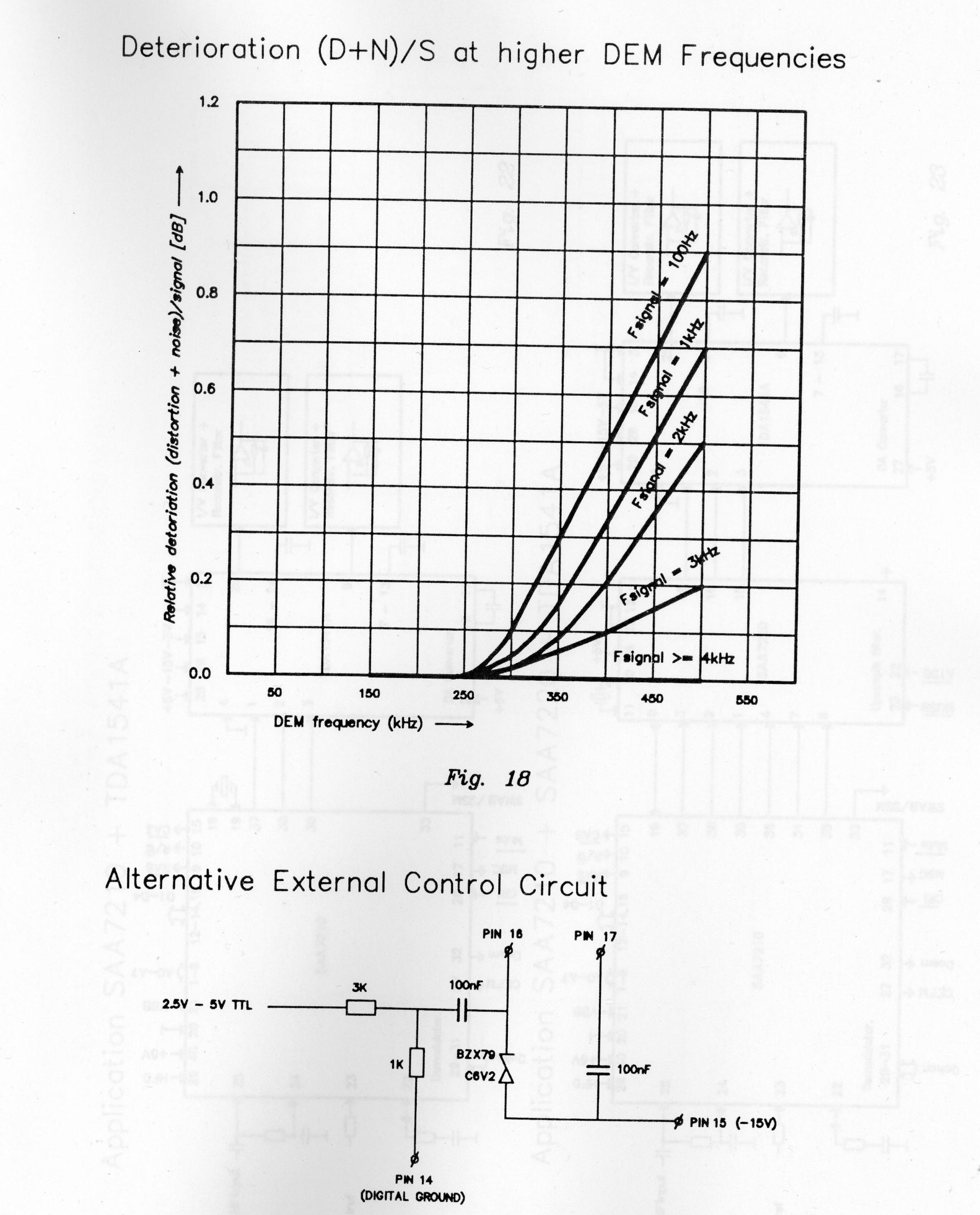

Hi Ceglar,
DEM (Dynamic Element Matching) is a technique to obtain highly accurate bit currents from circuits that have tolerances. This eliminates the need for expensive LASER trimming. Other advantage is that as DAC chips age (and tolerances increase) the DEM circuit will maintain high accuracy over a very long time period.
In the TDA1541A the 6 MSBs are divided from a reference current source using DEM. The remaining 10 bits are divided using passive current dividers only. So a reference current is divided into 16 binary weighted (1, 2, 4, 8, 16, 32 and so on) DC bit currents.
One can read in the TDA1540 datasheet how this DEM circuit works (attached pdf). I suggest to read it first
DEM clock frequency is set by an external timing cap (datasheet value = 470pF). Ripple on the active divider outputs equals f DEM.
So with 200KHz DEM clock we have 200KHz ripple frequency. The remark in the datasheet that outputs that are composed of two summed currents has lower ripple frequency is wrong. Practical measurements on many different TDA1541A chips showed this.
The DEM circuit needs 4 DEM clock pulses in order to average between 4 almost equal input currents from the passive divider that drives the DEM circuit.
When f DEM and WS frequency are roughly the same (176 KHz @ 4 * oversampling and 200 KHz DEM clock rate) it is essential to filter out this ripple current with the 14 external filter caps. This is necessary as the DEM circuit cannot complete a full DEM cycle within one sample period.
When f DEM roughly equals WS and no filter caps are used, we get a different bit current for the same bit after every DEM clock pulse and this causes bit errors and distortion.
When f DEM frequency is at least 4 times higher than WS, the filter caps can be omitted as a complete DEM cycle is completed within one sample period.
Running TDA1541A in NOS and using 200KHz or higher DEM clock frequency allows the DEM cycle to complete within one sample. So oshifis remark to omit the filter caps is valid. The 200 KHz ripple is well outside the audio spectrum and thus inaudible, however, SN ratio gets slightly worse as a result of switching spikes and ripple that are not filtered out.
In the final UD2 and SD2-player I use 900 KHz DEM clock rate with NOS. This means that I can complete 5 DEM cycles during one sample and I could get away without using filter caps. But I added 330nF filter caps (that result in extremely low ripple and switching noise with this DEM frequency) in order to maximise SN ratio.
DEM relies on -exactly- equal time intervals between subsequent DEM clock pulses. Since this cannot be realised in practice, second best is only allowing small amount of -random- jitter on the DEM oscillator.
The big problem with the TDA1541A is that the DEM clock gets frequency modulated by the DATA content by means of the locking effect. The locking effect occurs when two almost equal frequencies lock and there is sufficient crosstalk between both signals. So one signal “pulls” the other. With the TDA1541A this effect results in high deterministic jitter on the DEM clock, resulting distortion.
By adding two 6K8 resistors the trigger threshold level can be manipulated and the DEM clock signal amplitude is increased from 1Vpp to 3Vpp. This makes it far less sensitive to interference and deterministic jitter and noise on the DEM clock can be greatly reduced. This is -essential- for highest bit accuracy.
For those who only want to know component values:
Dem timing cap value: 100pF (approx. 900 KHz DEM clock rate).
Filter cap (14 *) value: 330nF SMD 1206 film (make sure to use shortest possible traces / wiring!).
Resistor value (for 3Vpp DEM clock signal amplitude): 6K8.

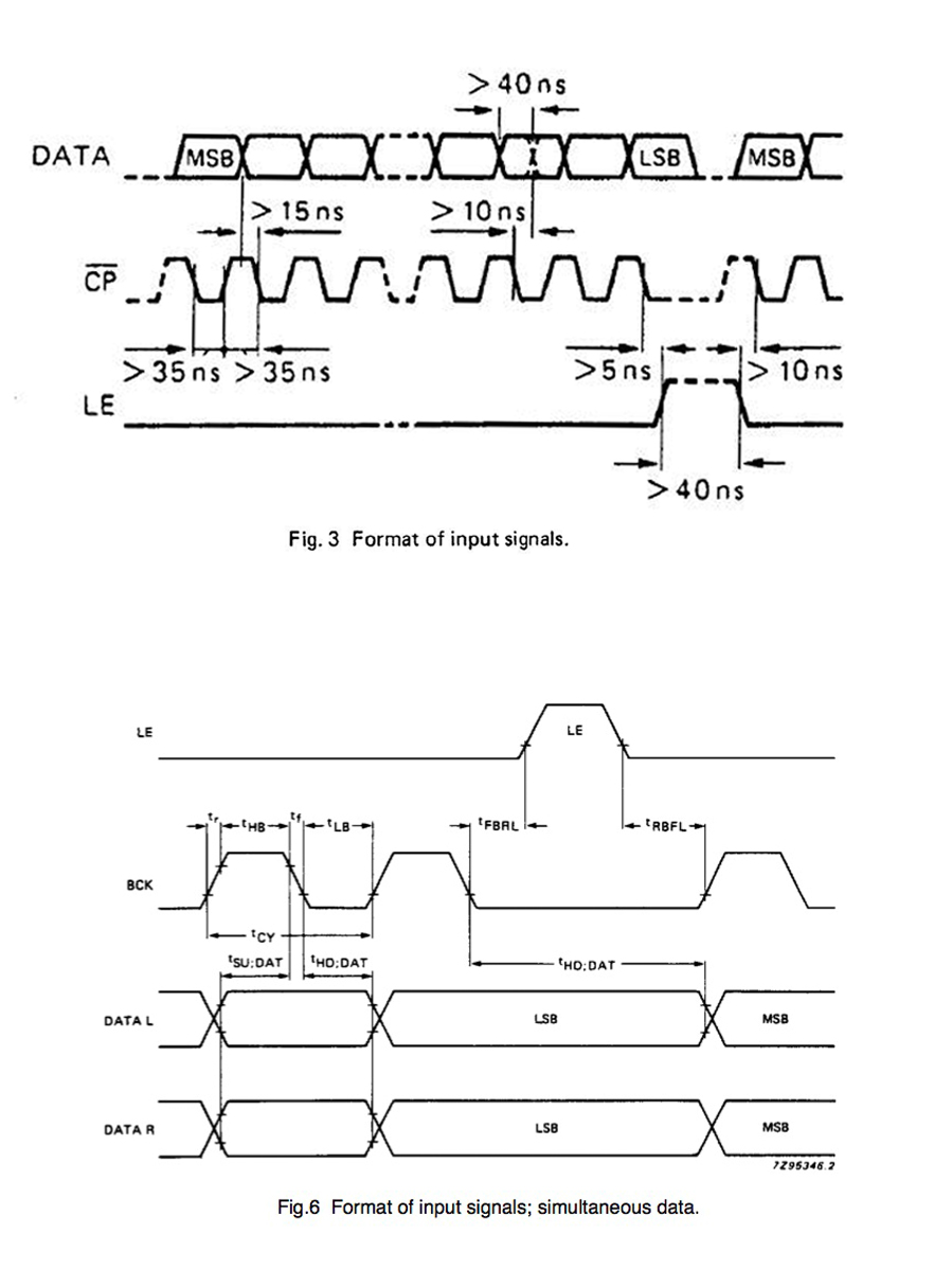

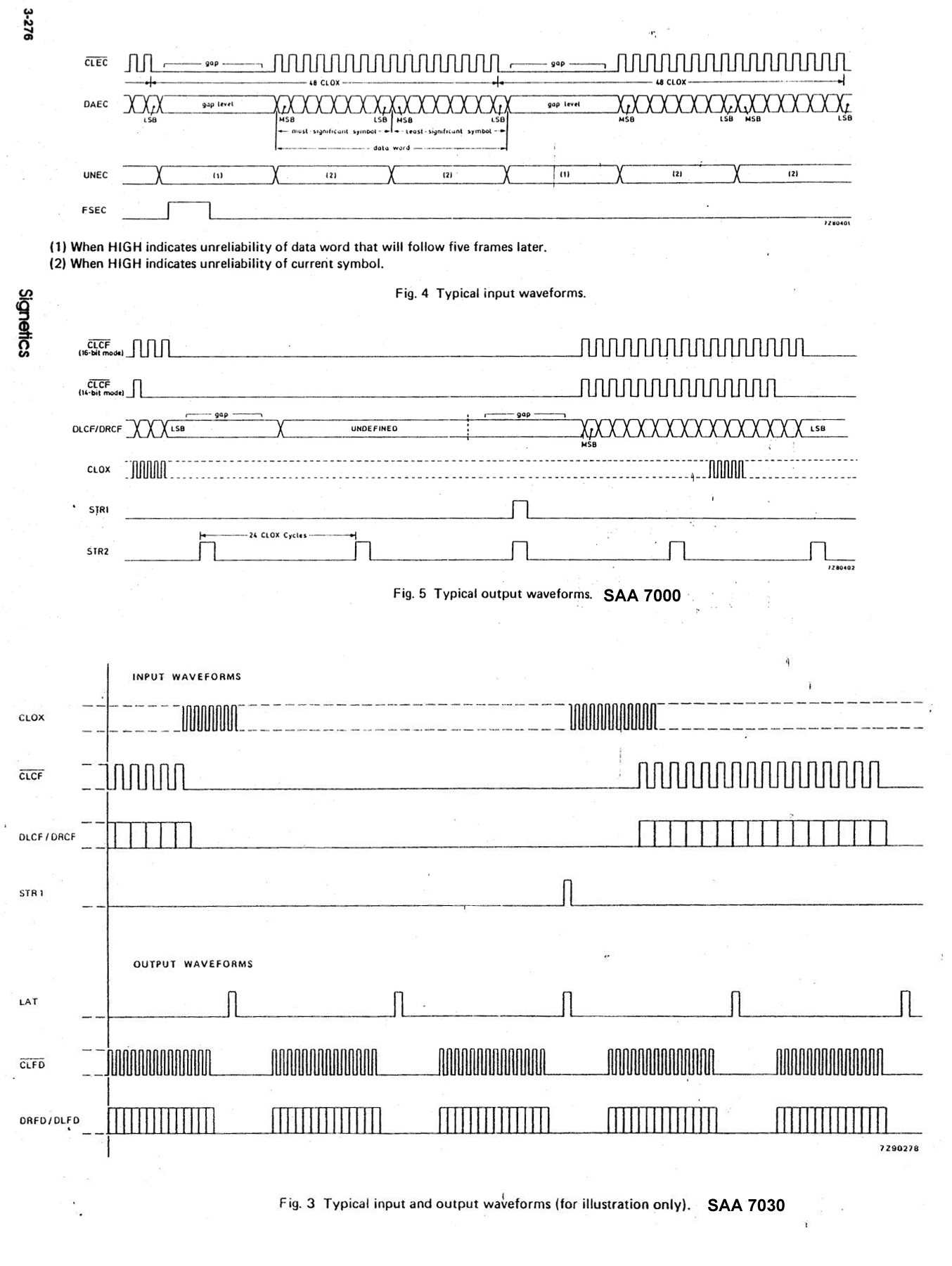

Thanks Ceglar for the book jpeg pic and answer 🙂
Thanks EC, I am trying to prepare some TDA1540.
But I am litle bit confused by the datas...
1. Is the format of input signals for TDA1541 same like for TDA1541A in Simultaneous mode, except of word bits 14bit?
2. Is the SCK (BCK) inverted, compared to TDA1541A?
in TDA1540 datas marked as -CP?
3. could You please draw a logic timing of the 3 line input bus for TDA1540,
because it is pretty unclear in the pdf...
sorry for multi Q 🙂
