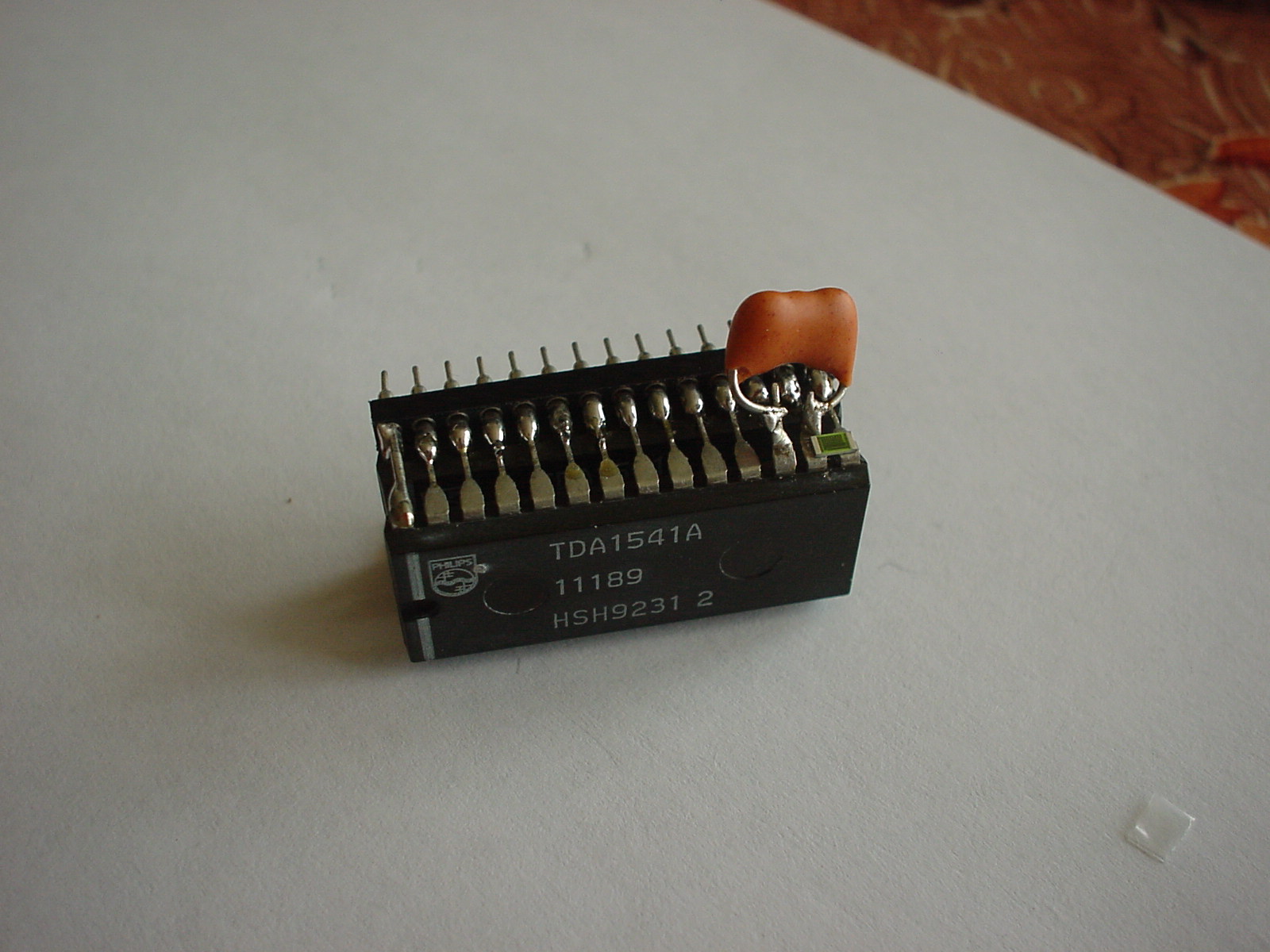

right, it is MELF /at least two of them/but 6k6 even thou 😡

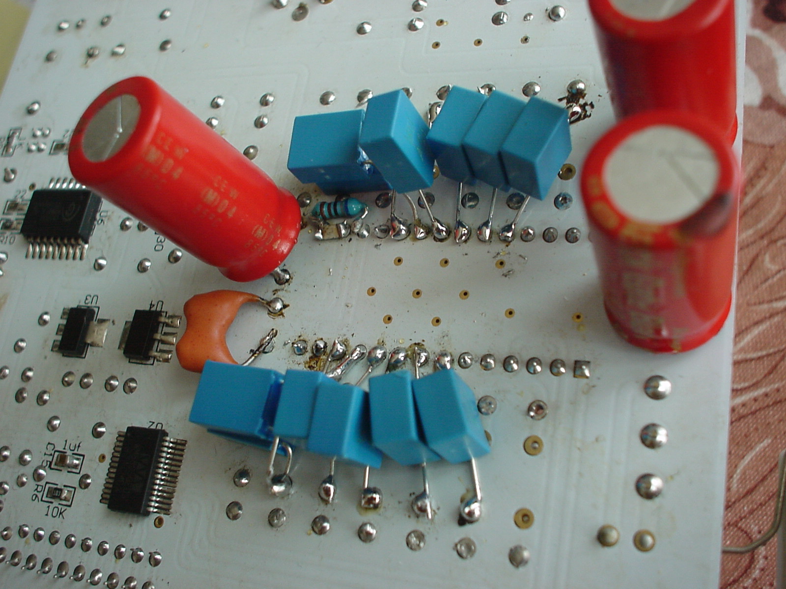

Hi Oshifi,
Could you tell us again please the DEM values you use with the 14 decoupling caps unpopulated ?
Your conf is on my listening waiting list as you & John said it adds sweet (at the price of a little loss of precision)...

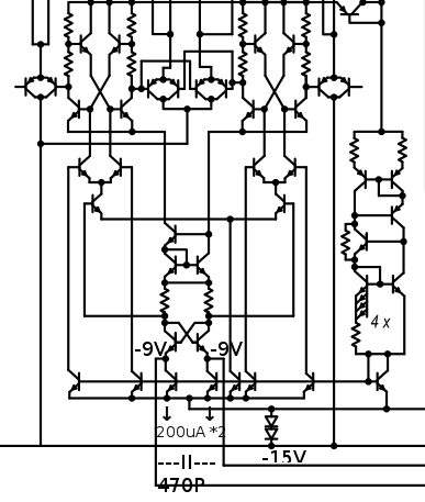

The waveform is the same as John's in post #5060. My DEM capacitor is 510 pF, the frequency is 172 kHz. My goal was to achive auto-lock to 4x sample frequency, but it did not occur.
