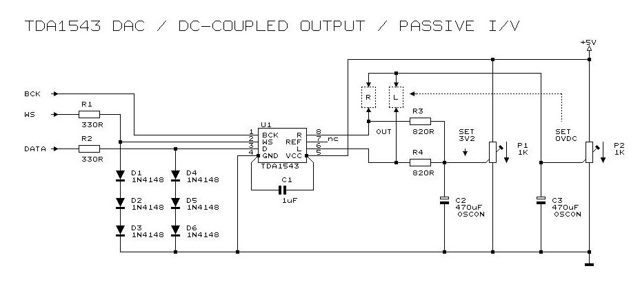

im sorry for being obnoxious but i keep needing to bring up this tda1543 circuit.
i've tried it twice now, one on a 6v battery power, and the other on an8006, both with dddac's resistor values (910ohm), p1 set at 3.8v (it does seem to get cleaner all the way up to 4.7v tho) p2 set at 2.3v (2.2 sounds neutral while dddac's recommended 2.5v sounds warmish thick)
the whole circuit certainly sounds impressive with better dynamics and clarity than the regular passive version but with the dc coupling, harmonics are definitely thin that it feels no different from listening to a delta sigma dac. sure enough, disabling the dc circuit brings back the rich harmonics yet takes away that explosive dynamic.
i'd like to know what is the main cause for the increase in dynamic. my beginner's intuition says that it's because the circuit is somewhat of a semi active, and that the series resistor is what sucks away the harmonics. i'd like to know if the same benefit in dynamics can be achieved with a separate 2.2v circuit feeding the ground.
i've also tried doubling the value of c2 to see if it affects the lost dynamic but the result is negative.

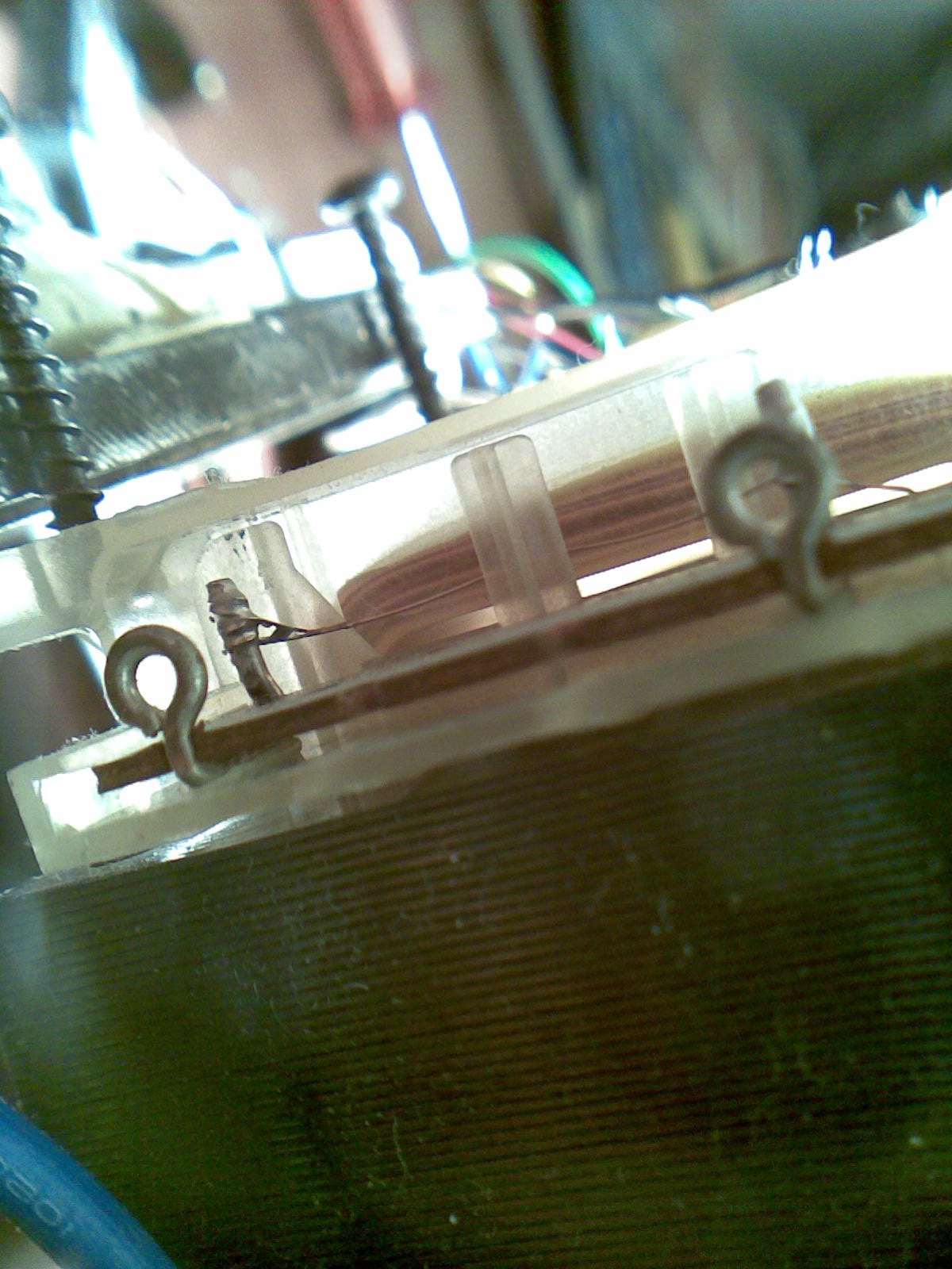

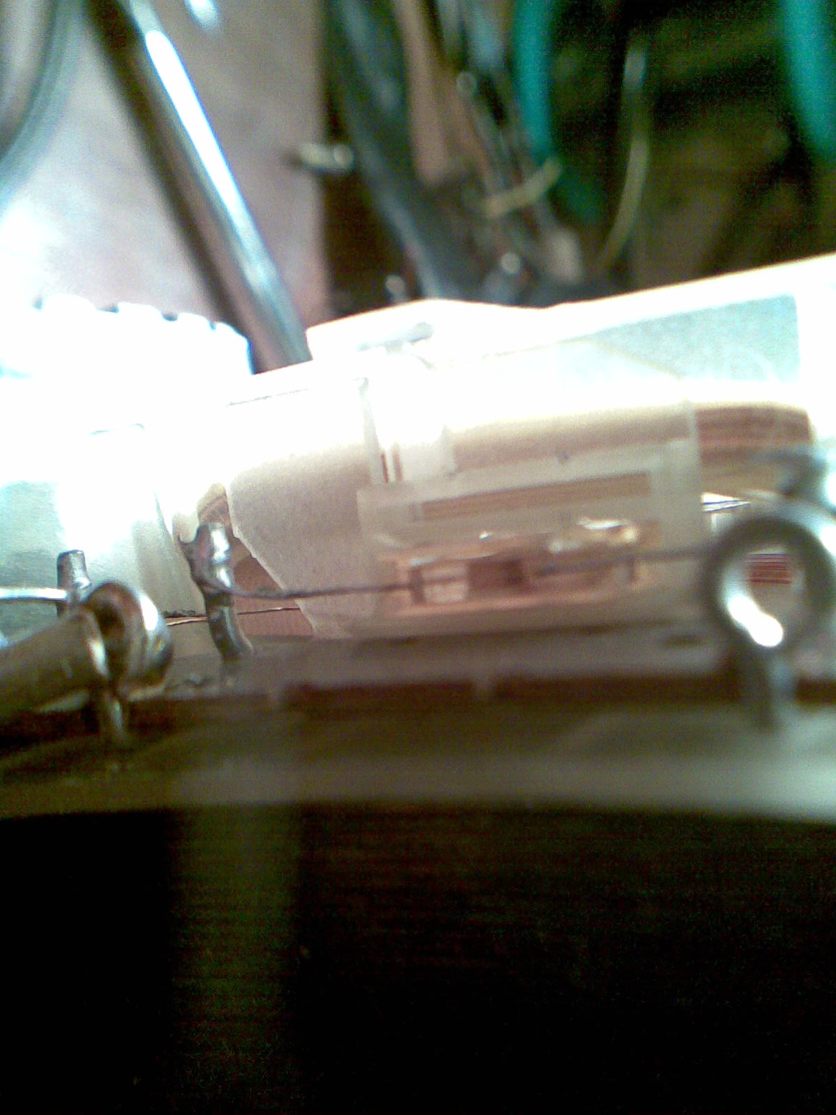

To feed my 1541/XMOS build, I am choosing a transformer.

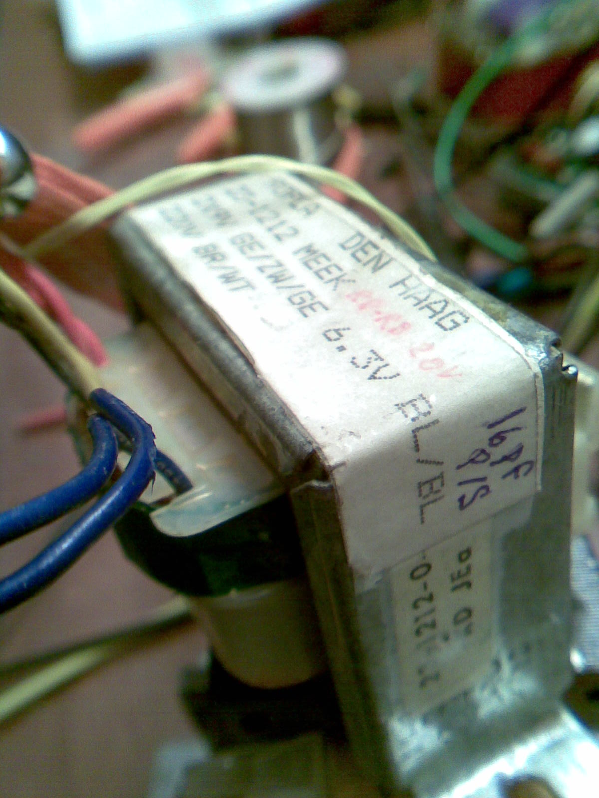

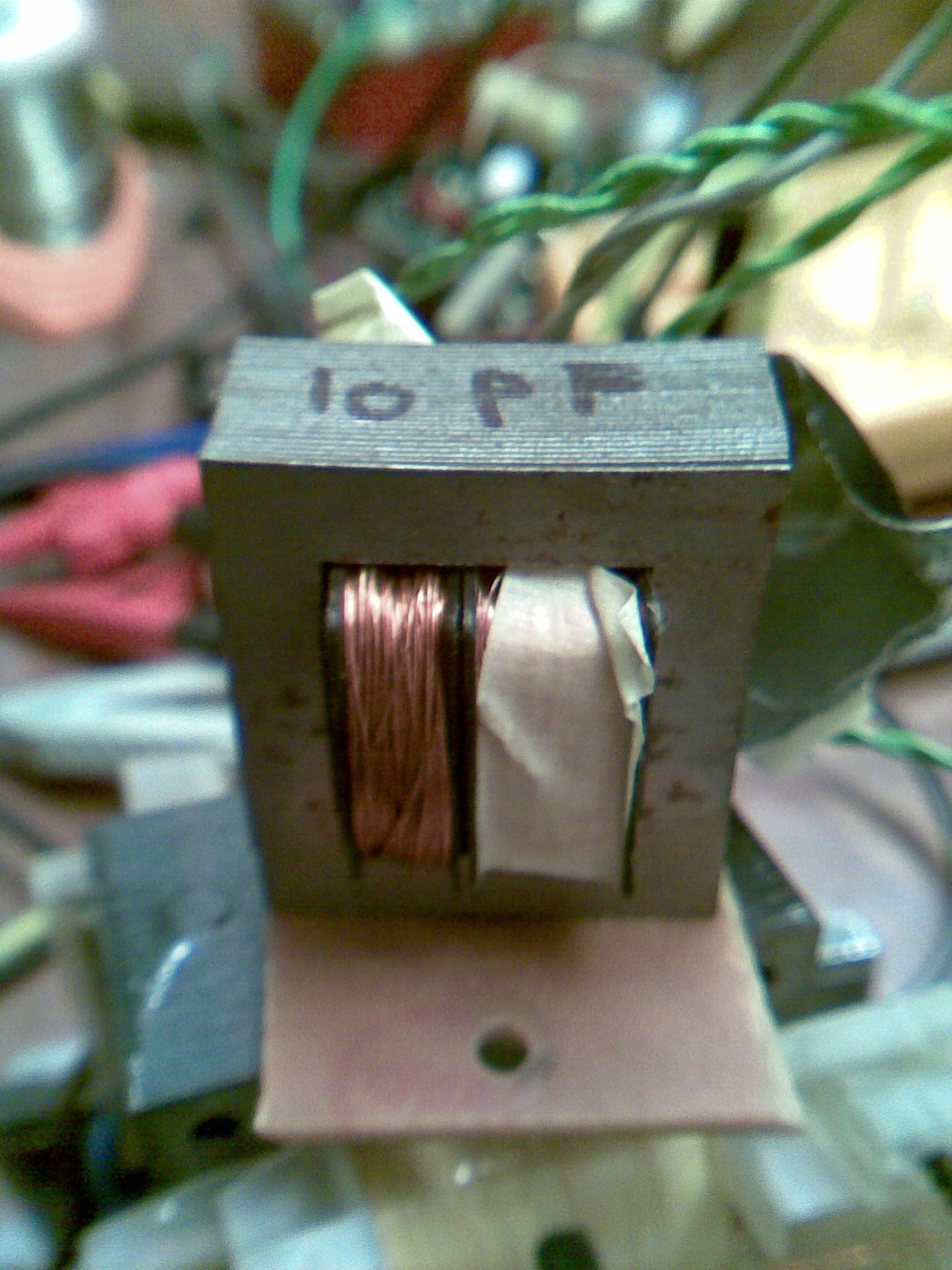

I have been working on a power supply, selecting transformers. Some versions have split bobbins, stacked side to side with each other; and on testing this gave a very low capacitance between primary and secondary: the small one being 10 pF and the bigger one from Ropla as low as 16 pF.
This I compared with a 'standard' square transformer (bobbins consisting of layers on top of each other) and toroid transformer, having typical 200/250 pF and 400 pF capacitance between P/S.
Lo and behold: also this was a very low capacitance type, like 25 pF, even though the layers were placed on top of each other like a normal square transformer.
The trade secret is told by the following pictures: There is a big air gap betweem the primary and secondary, and no, that is not for efficient cooling.

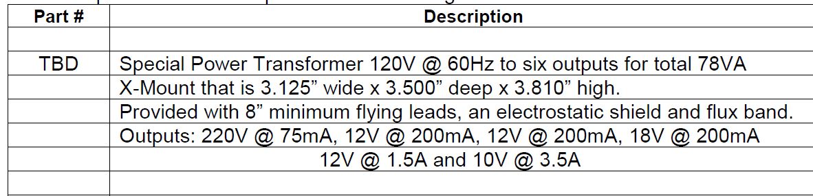

Hi all,
I'm cleaning up my project parts from the past few years on the TDA1541A since my project is finished and my "dream machine" is running nicely.
I was not happy with the transformers I could find, and wasn't thrilled with using several in a chassis, so I had Hammond custom wind some for me. I had 4 made to meet the minimum NRE charge. Here's the specs:
* Flux band for very low/ no leakage
* 6 windings total
220V RMS, 75mA
12V, 1.5A
12V, 200mA
12V, 200mA
18V, 200mA
10V, 3.5A
I have only 2 for sale.
Also, over the last 12 years, since becoming interested in the TDA1541A, I have accumulated quite a few TDA1541A chips, of which I'm also selling. The collection includes *one* Double Crown and some R1 devices.
If anyone's interested, please PM me for a list, prices and other project items related to the TDA1541A only.
Thanks to everyone in this thread over the years for making this a great and rewarding project to work on!
Gary

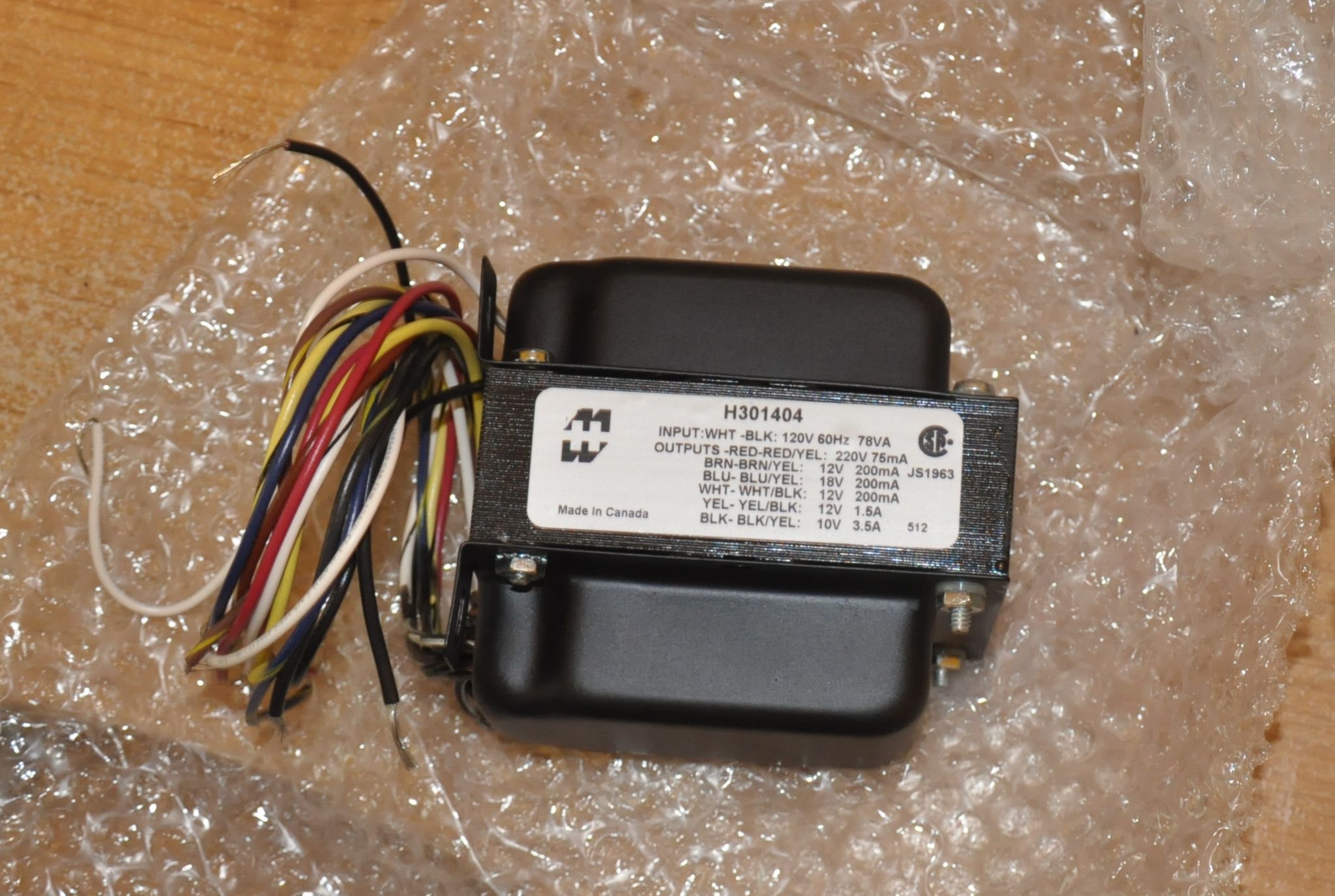

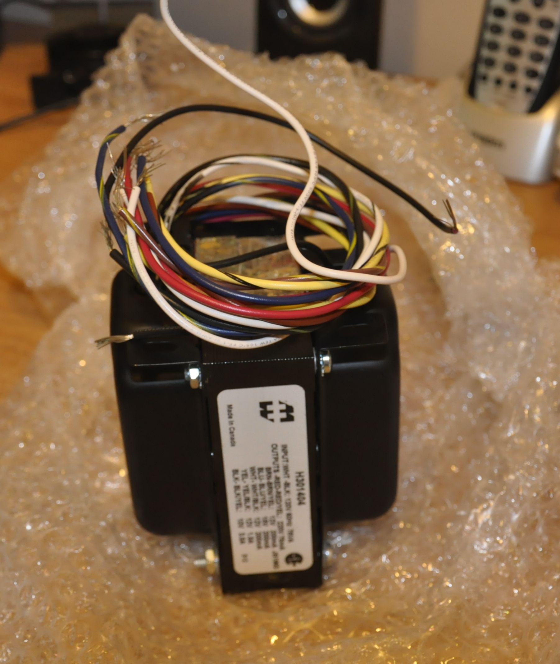

Hammond Custom Transformer for TDA1541A DAC
For those who have inquired, here's what a custom transformer looks like. Single solution is ultimately better that multiple transformers in a cabinet. Note the copper flux band running the circumference of the transformer. The transformer runs cool and very quiet, DAC performance is outstanding with no sign at all of 60Hz (or harmonics) noise injected in.
Size is as shown.
Gary

Output coupling cap needs to be added to block DC. The hybrid coupling cap that performs closest to DC coupling was composed by paralleling 2.2uF/250V Monacor MKT, 3.3uF/250V Monacor MKT and a 40pF Teflon trimmer (set to max. value).
Thank you for very interesting work!
I have implemented your nice IV-converter and it works fine on the test bench. But now I want to hear it in my system and got some questions:
The output must be taken over the 500R resistors and with +5v as reference, but when connecting to my amp this will be connected to amp ground...problem?
Normally a capacitor output has a bleeder resistor to gnd on the output side to discharge cap, should this be connected to gnd or +5v?
Can the 500R be changed to 680 or 1000R if I need more output and what are the limits, drawbacks?
Hi Skorpio,
The I/V stage built around the 2SK170 is outdated, one of the problems is that it exceeds TDA1541A output compliance.
The adjustable DC reference voltage takes care of this. It consists of a 1K trimmer with a 1000uF cap between wiper and GND, and another 1000uF cap between the wiper and +5V.
The voltage at the wiper serves as GND connection for the RCA sockets. This works as long as this reference voltage is not short-circuited by other connected equipment.
The trimmer is set for lowest possible DC voltage reading between the wiper of the trimmer and both RCA outputs.
This design requires no coupling caps, it ensures highly transparent playback with optimal bass response and ease of mind that one exceeds the performance of the best film caps available.
Not with the 5V supply. When the supply voltage (for the I/V stage only!) is increased, to say to 10V, it is possible to double the output amplitude by using a 1K I/V resistor. Disadvantage is that the selected bit currents no longer flow back into the 5V supply like the unselected bit currents do. This leads to higher ripple voltage on the 5V supply and increased on-chip jitter levels.
