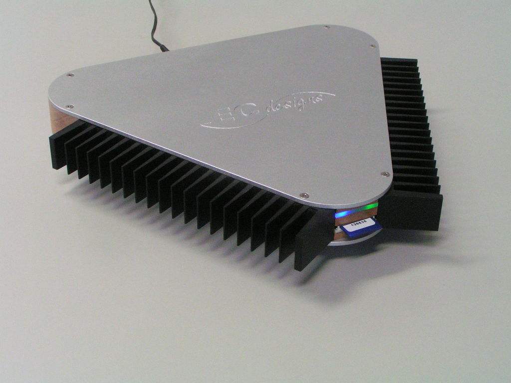

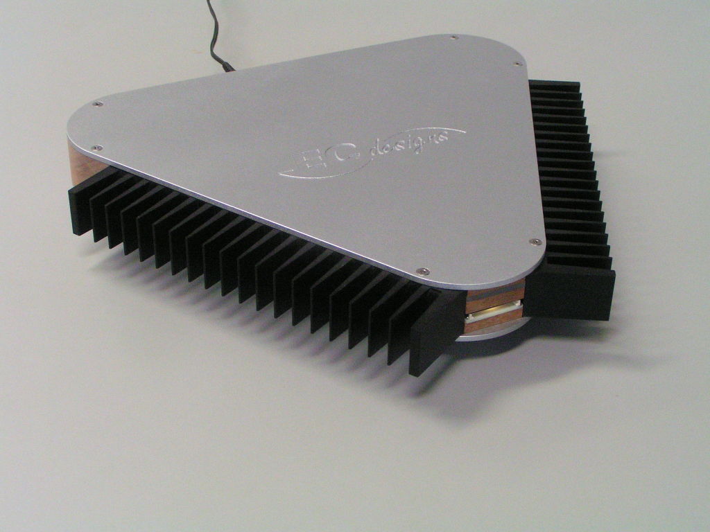

I will only offer the SDV1-player now (with integrated shunt volume control / variable passive I/V resistor).
The final SDV1-player and final MB1-monoblocks now look like this (attached pictures).
So John is the final SDV1-player mentioned above same as the SD1 SD player on your site?
