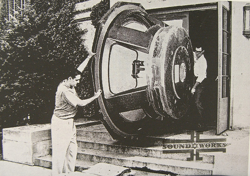

World's loudest speaker - Was 3000 by Wyle labs

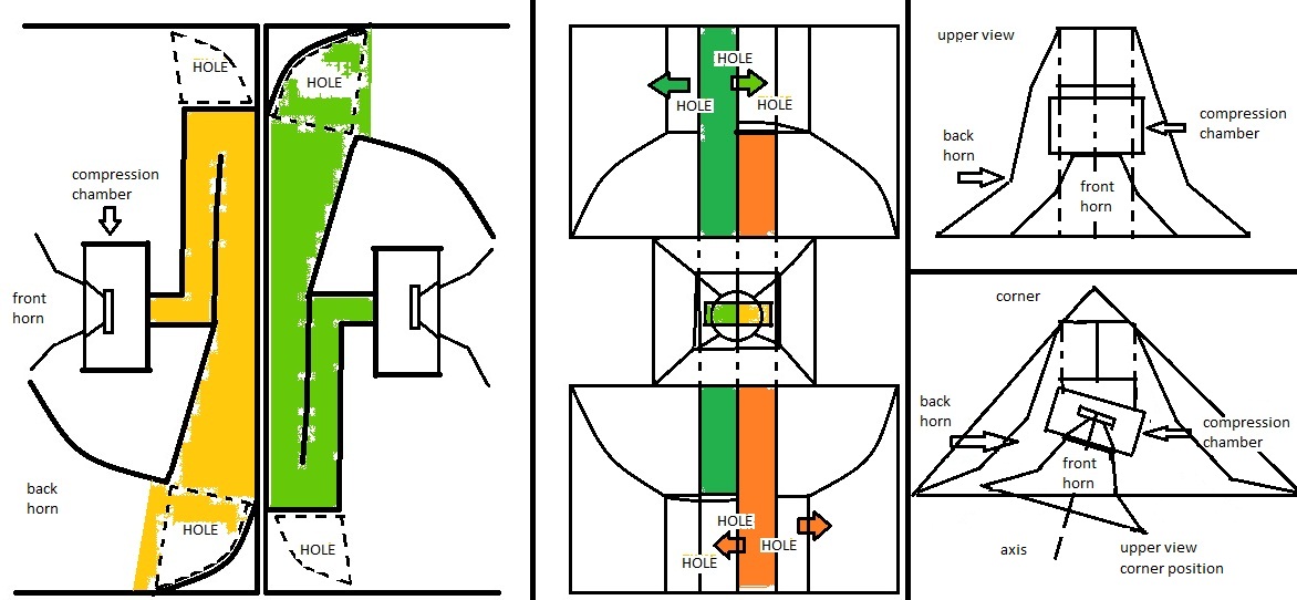

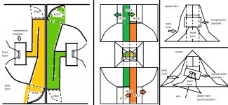

Attached picture shows practical problems that can be encountered when building larger (horn) speakers.

I attached a diagram of my last project which will use an Audio Nirvana Super 10 which has resonance at 31Hz...
Fortunately, I like to listen my music (mainly dead people's music) at low or medium volume, most of the time.
